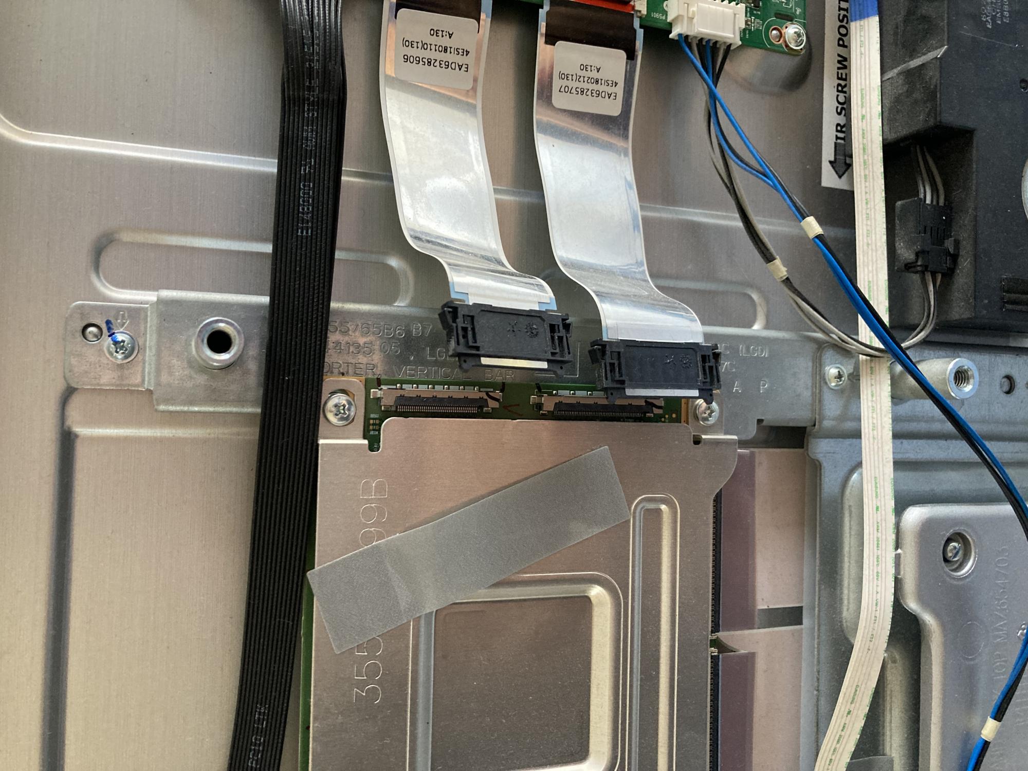

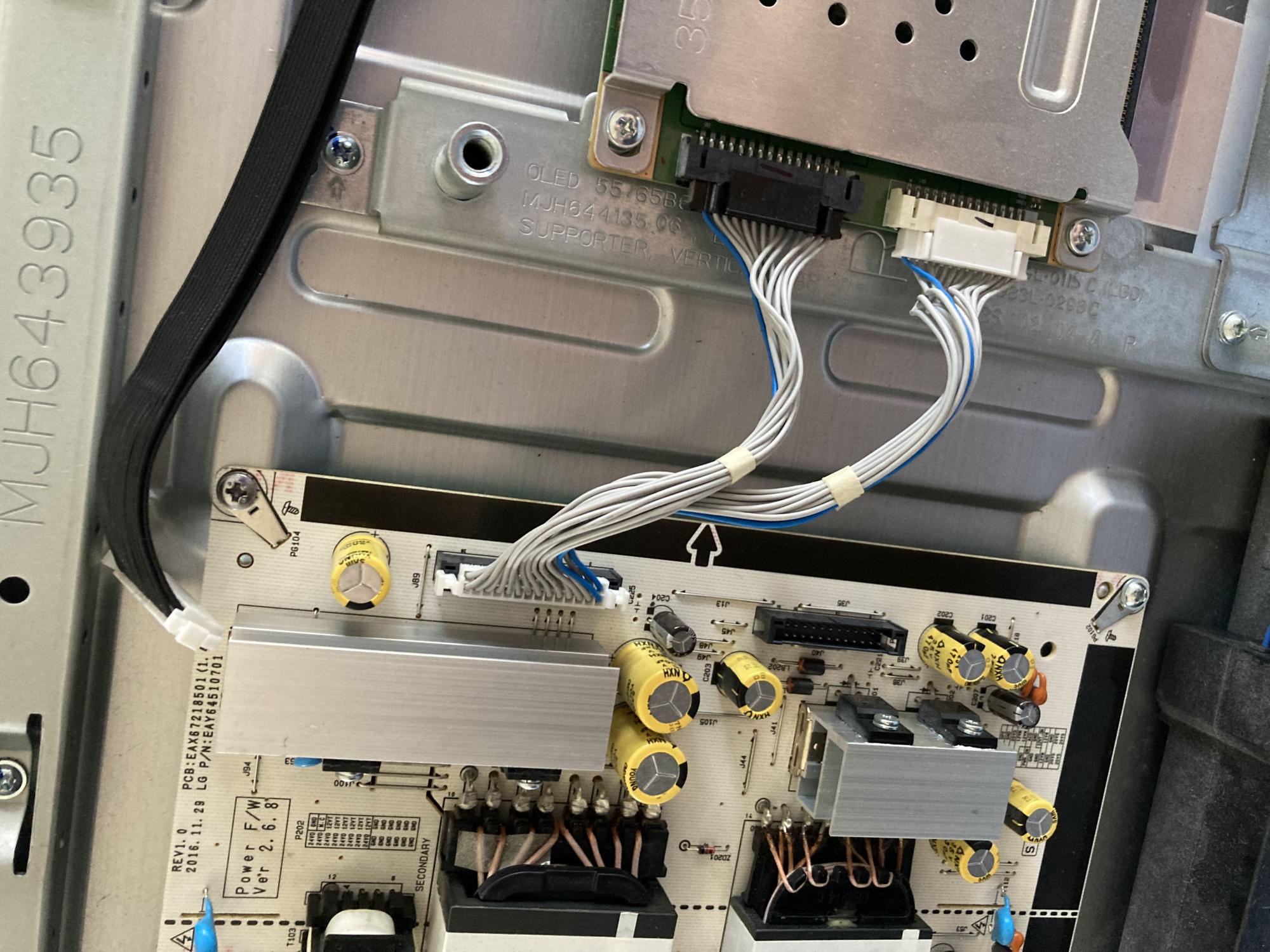

      Re: LGOLED55B7V Clicking and dead screen.
      Yea I understand that Davi which is why I asked!
      There is 2 photos below of cables currently detached. P201 from power board to main board and 2 ribbon cables from main board to tcon.
      This is as you wish?
        With the cables as shown in the photos the result is the same.
          Originally posted by Diah
          you have short cell on the Panel module .. SOS signal come to MB turn off the set if you disconnect only the black cable between the Power boards and the T-CON ... it will start and stay on ( sign are the Audio Optic port lit red ) none repairable ..
          I have also tried this test as well Diah and get the same result. There is no image displayed and no standby light.
          So could this be a fault on tcon?
            With everything plugged back in. When using the RC to try and power on I get a very faint vertical line on the entirety of the screen about 1/3rd of the way in from the RHS. I can also hear the relay switching and have the same 3 LED blink then the relay again switches.
            But at no point is a screen test visible or do I get a green indicator replacing the red standby light. So to me it’s not even trying to function correctly.
            Am I fighting a losing battle here? Or do I order replacement tcon/main boards? They’re not cheap! @davi @diah what are your thoughts please?
            Thanks.
              don't spend cent on it.. scrap it... you have OLED Cells short on Panel.... TV turn off because the T-CON send SOS SIgnal to MB MICOM to order the power boards to turn off... avoiding the panel get in fire caused by OLED cells

                  Wait donny.. don't think someone is god and knows everythink..
                  i'm at work now so i might not follow you but i do, only to take a small break..
                  i don't know why you detach cables from psb to tcon, them are needed to feed the tcon as i already said, i don't remember well but if in this way you don't see test, it's probably because there is another 12v supply line that runs in the MB to Tcon cables, so what you have to do is to keep them detached but locate the 12v pins on one of the two cables, there are many and next to each other, and solder a thick wire (0,5sqmm) from 12VT/PSB to TCon 12V pins from MB..
                  if you give up it's your decision but it's stupid at this point..
