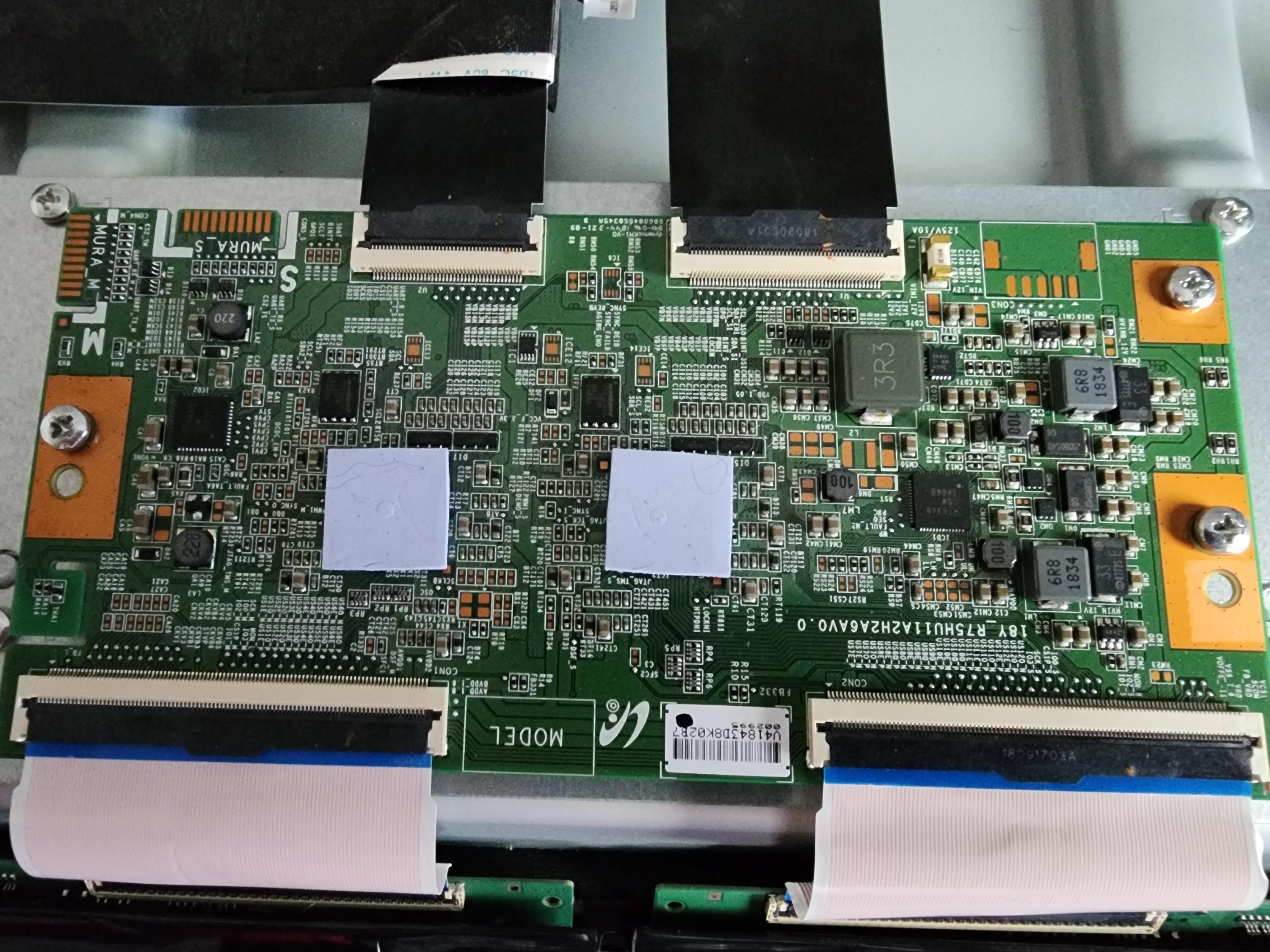

                  Can you put up good clear pictures of both of them, the whole boards?

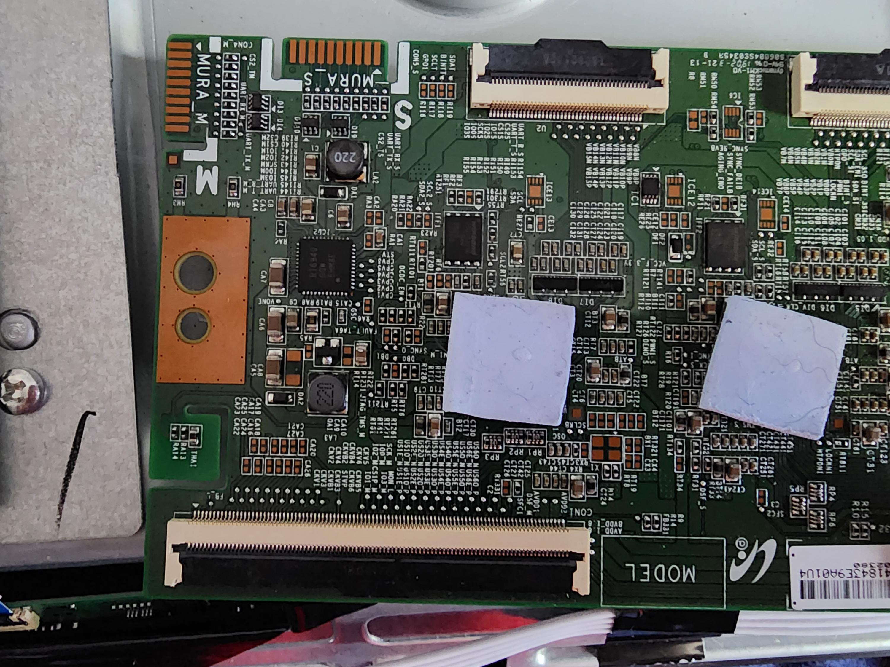

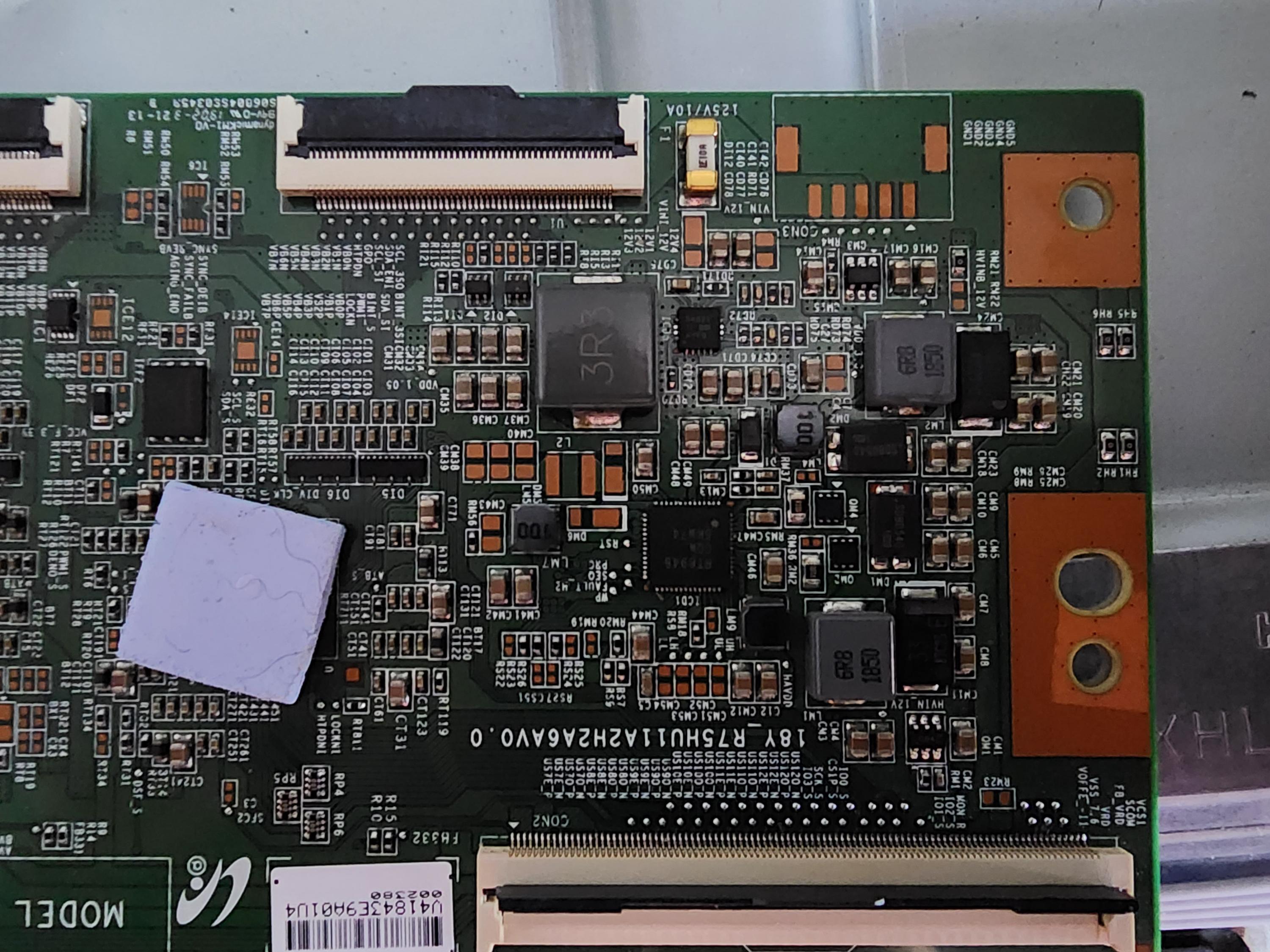

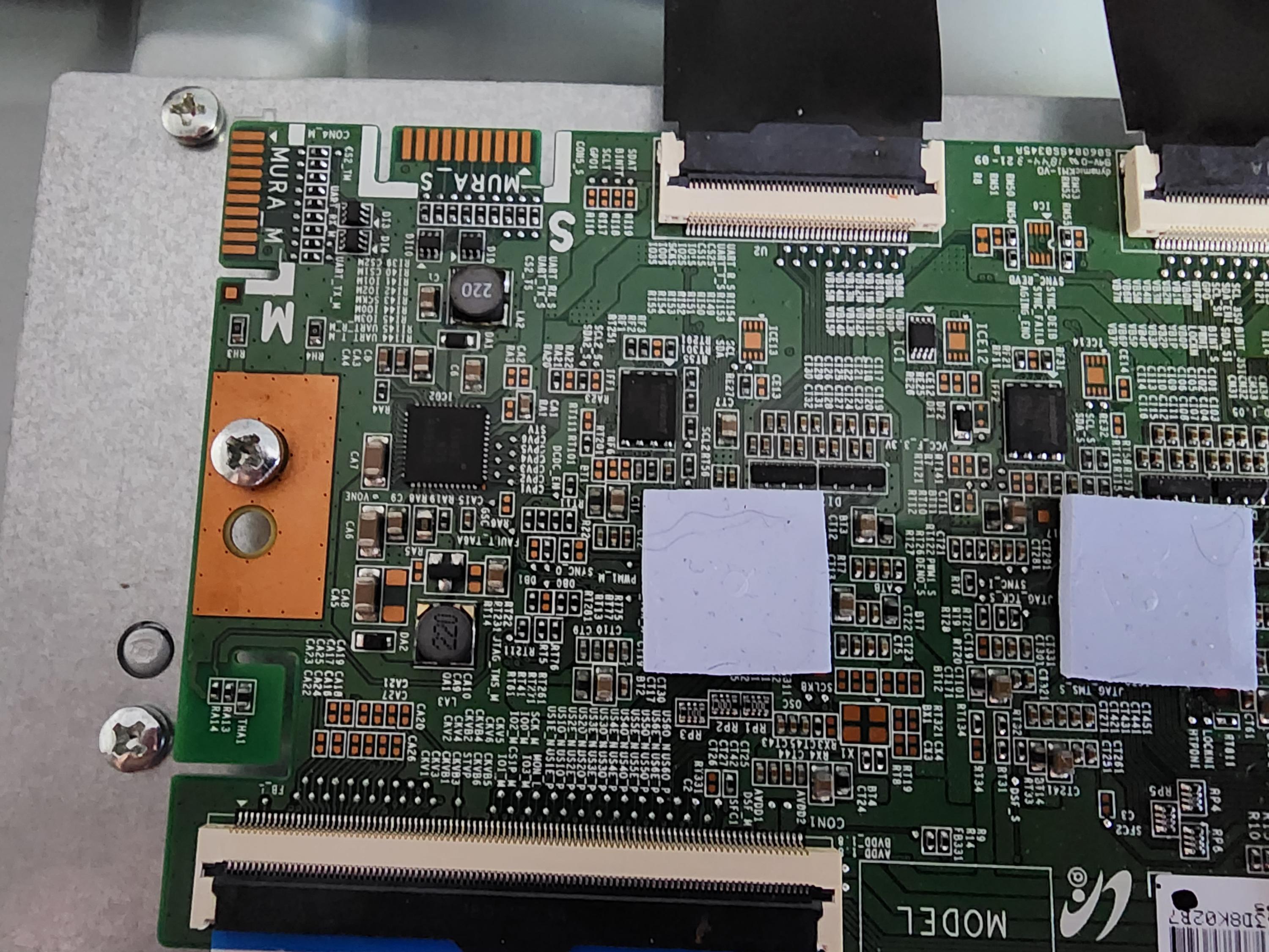

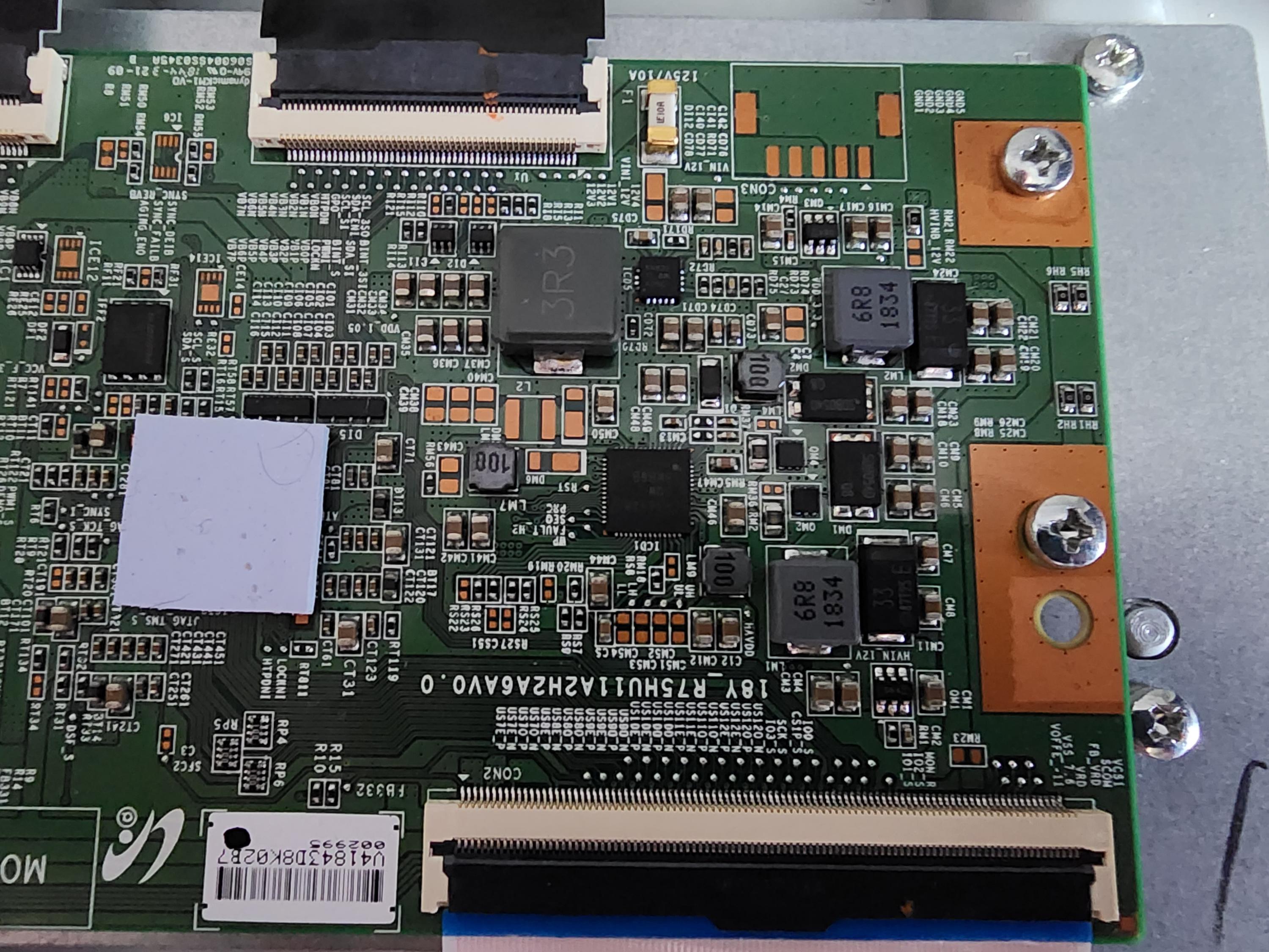

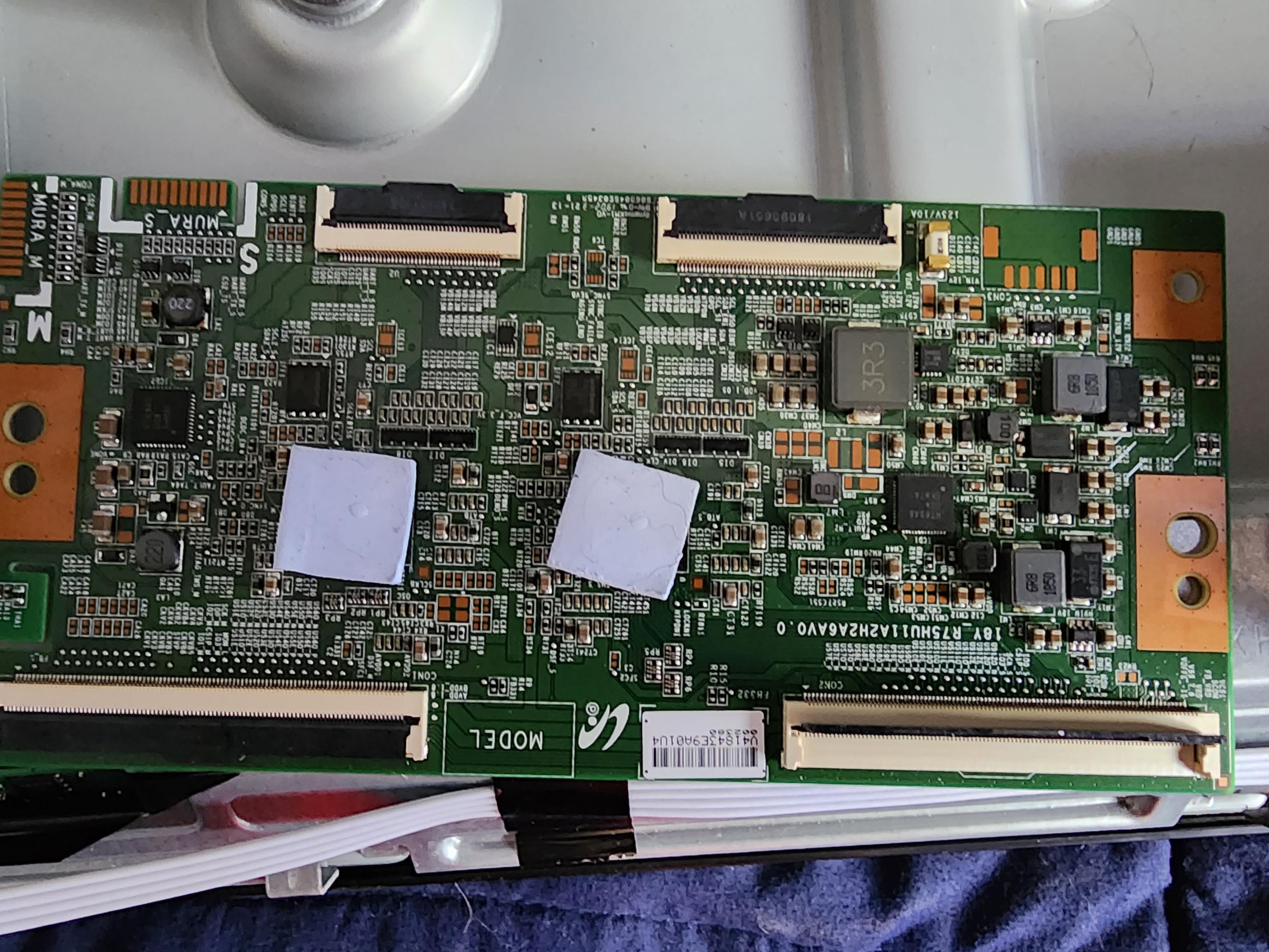

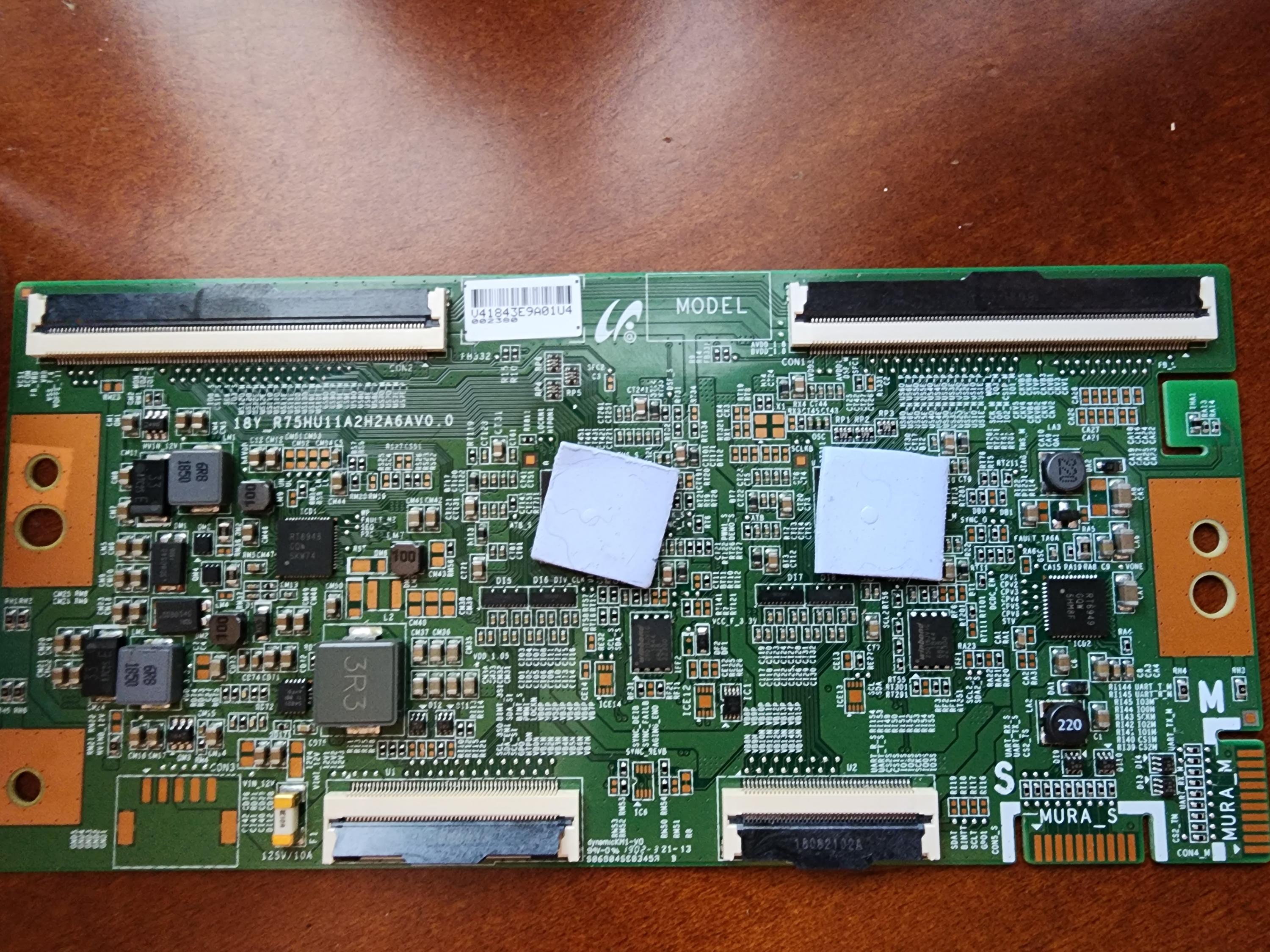

                      The first 3 or the ones with screws attached is the replacement. This wasn't the original.

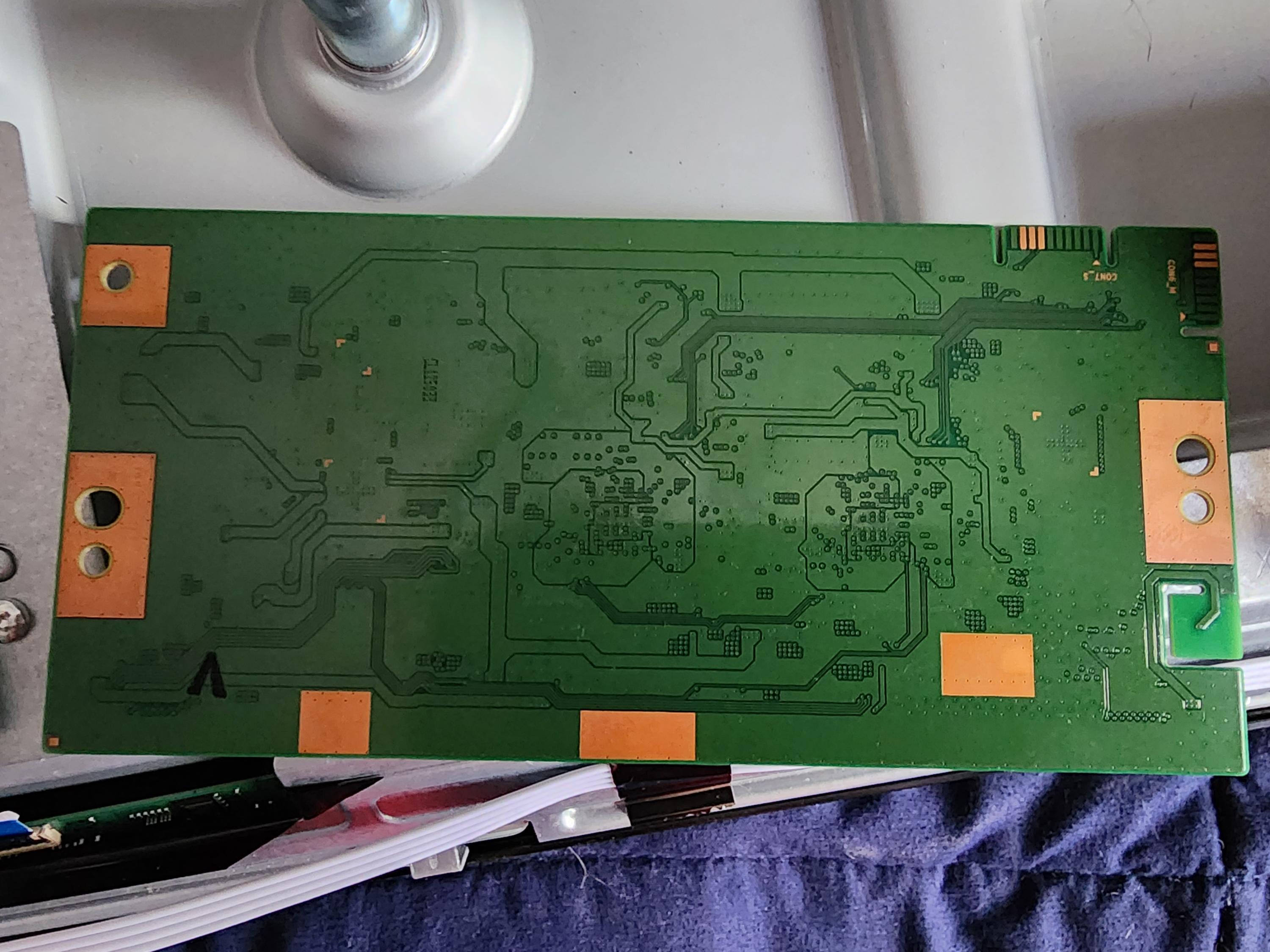

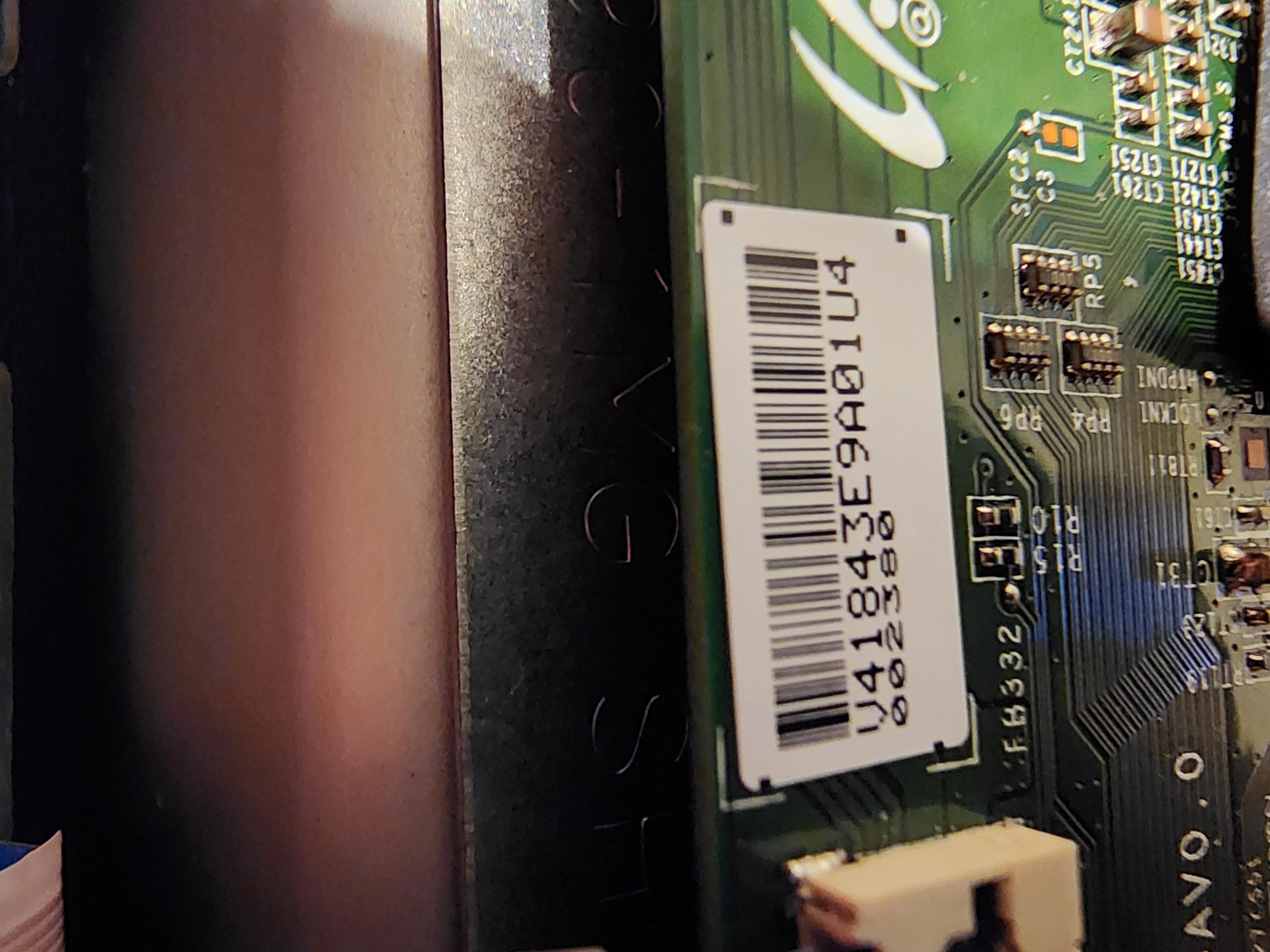

                      The second is the original without screws unattached. Took a picture of the origin backside also. No additional stickers on the boards
                        Re: Tcl 75r615

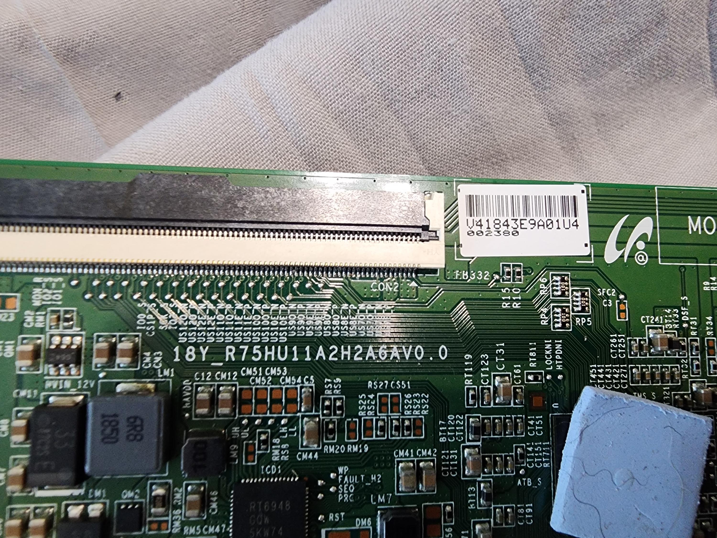

                        The only difference that I see is the numbers under the barcode of the white square there are a little different, replacement V41843D8K02B7, original V41843E9A01U4, I'm not sure if that is enough to make it incompatible or not, maybe another member knows or has had this same situation.
                          Re: Tcl 75r615
                          That’s the right tcon. They are both for a Samsung panel. There is another tcon for this model TV but it was for auo panel which you don’t have.

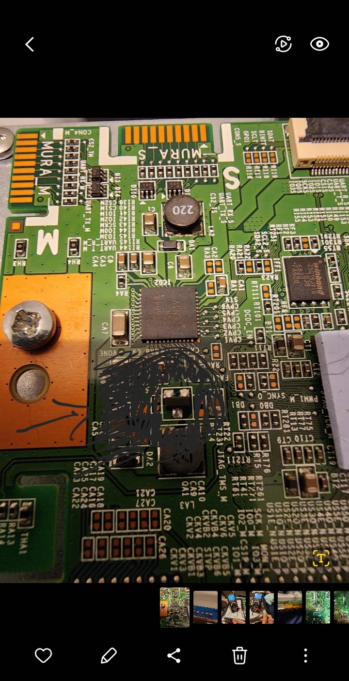

                              Still doing some testing for maybe bad tcon. I have found this video that is 7 years old and not the same board but it shows a component with drain/source/gate and it shows how to test it. With the TV on this part is getting voltage. It says when video works it'll get voltage.
                              https://youtu.be/yTnkOfwBGGE
                              I have the tcon and it has only one of these components. It's tests fine on diode and continuity but when TV is on it gets zero volts. I have two TCons and gets zero volts on both.am I onto something here or does it really tell me nothing.
                              I have also tested several voltages past the tcon onto the panel and get 3.3v in several places and get voltage all the way down both strips.
