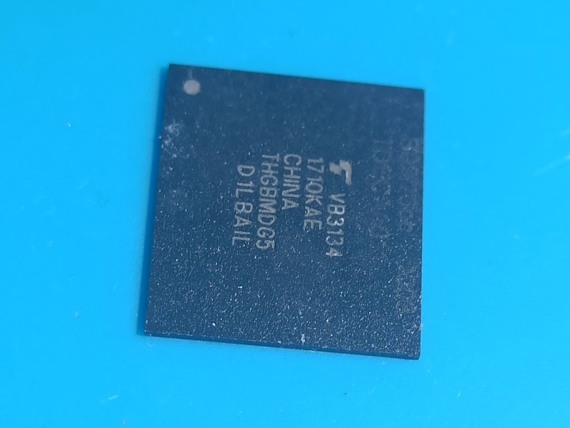

    Hello.
    Have this ic emmc from some TV. i need to identify it and point how to reflash it, with cheap programmer.

    Re: need identify emmc chip and point how to reflash it
    Thgbmdg5d1lbail (eMMC Toshiba 4Gb).
      thanks. do u know any easy way to flash/read it? some cheap progammer
        The cheapest one, in my opinion, is XGecu T48 + an adapter for eMMC, there is a more expensive T56 or RT809H, or through a card reader under Linux, see the topic here
        https://4pda.to/forum/index.php?showtopic=1043267
