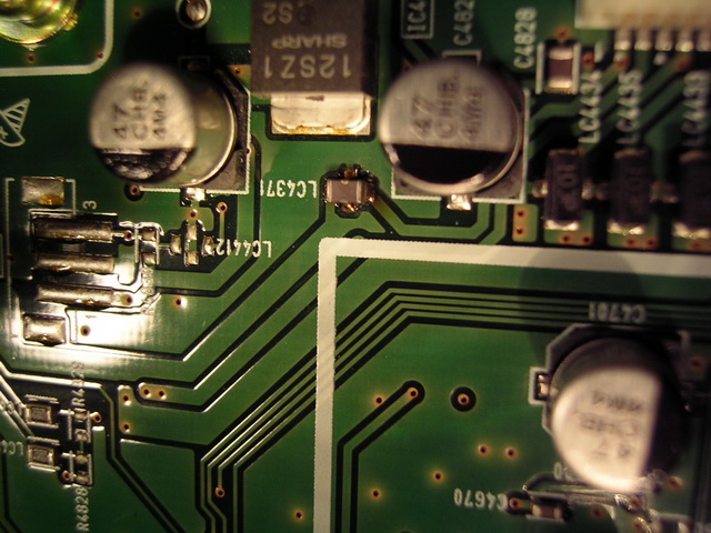

        Re: Panasonic TH-42PX25 Digital HD Plasma dead
        I kept being puzzled by the drop in resistance when the PA2 was connected. With the meter set to chime mode for low ohms, I started plugging PA2 in on an angle to see if I could narrow what pins it was shorting on. I noticed it was at the low numbered end and set out to test those pins.
        I used 1 strand of a multi-strand wire to probe the plug (like threading a very fine needle) and the other end of the wire to the socket. I figured I should have no more than 10 pins to test from this 40 pin connector. To make it even easier, one whole side of the connector pins are grounded, so this going to go more quickly than expected.
        The first pin was the one which made the meter chime. I tested 2 more to be sure, but no others caused the chime. I had found the clue to the problem.
        This is the (only) white wire in the connector. All others are blue. It is the BT30v supply generated by IC7581 on PA. I still have not figured out how it was causing the low ohms reading. That chip is not energized until -switched- 9v is applied, and the switched 9v line is open past Q7501 until the power switch is pressed...? I just don't see the connection? (no pun intended).
        Followed the trace once it left the connector on DG. Found the problem within a minute. (good lighting and a pair of reading glasses)
        A chip L-C appeared cooked as the pics show. I continued following the trace to the interconnect to H. Across the H board to the TB module connector. Opened the TB up and followed it inside to a 563 (56k) chip resistor. With that value I determined that the chip L-C must have failed by itself and was not from an overload in the circuit beyond it. Max current draw with 56k is <0.5mA.
        Not having one of the chips handy (can't even identify it from the Panasonic number and it's not called out on the parts list), I decided to improvise. I found an old scrap board about and removed a 1mm, 0 ohm shunt from it and installed it on the DG.
        Back together an plugged in, I had 9.3 volts on the 9v line. Switch on and away she went!
        Now to solve the current issue of the horizontal lines...
          PlainBill,
          From what I have read, I'm afraid this is a bad DG board after all. I am not certain as there is no specific picture like this. If it is a bad DG, the cheapest I have found is about $250, with some prices as high as $850. I might go the $250, but only if I can be certain that that will correct the problems and no other boards will be required.
          I know this was a $1200 set 6 years ago, and I do like Panasonic products, but saving for a new set may be a better idea.
          From your statement, I have requested Wizard to come look at the thread and give his opinion.
          Thanks again for your time.
          Q

                  Can I ask how you managed to remove the LC and replace it? I tried this one time and all I got was burnt finger tips and a sense of frustration.

                    #29
                    Wizard -
                    The service manual does not explain the boards, just names them. The description in the chart is "DIGITAL CORE, MICOM". Part number is TNPA3177AC. From the block diagram it is labeled "Micom, Digital Signal Processor".
                    It is interconnected via with:
                    H - REAR TERMINAL
                    DT - ATSC INTERFACE
                    DV - HDMI A/V INTERFACE
                    D - DIGITAL SIGNAL PROCESS (Pulling the connector from DG to this board produces a blank screen and the words "NO SIGNAL" in yellow on the screen.
                    Please also, your opinion on the set in this post:
                    https://www.badcaps.net/forum/showpo...8&postcount=11
                    Mockingbird -
                    A bit of flux, a hot tinned iron, and a pair of tweezers. The chip actually stuck to the iron when it came loose.
                    I did the reverse when replacing it and used the flux to hold it steady. I used the tip of the tweezers to hold it to the board, tinned the iron and just touched each end.
                    Q
