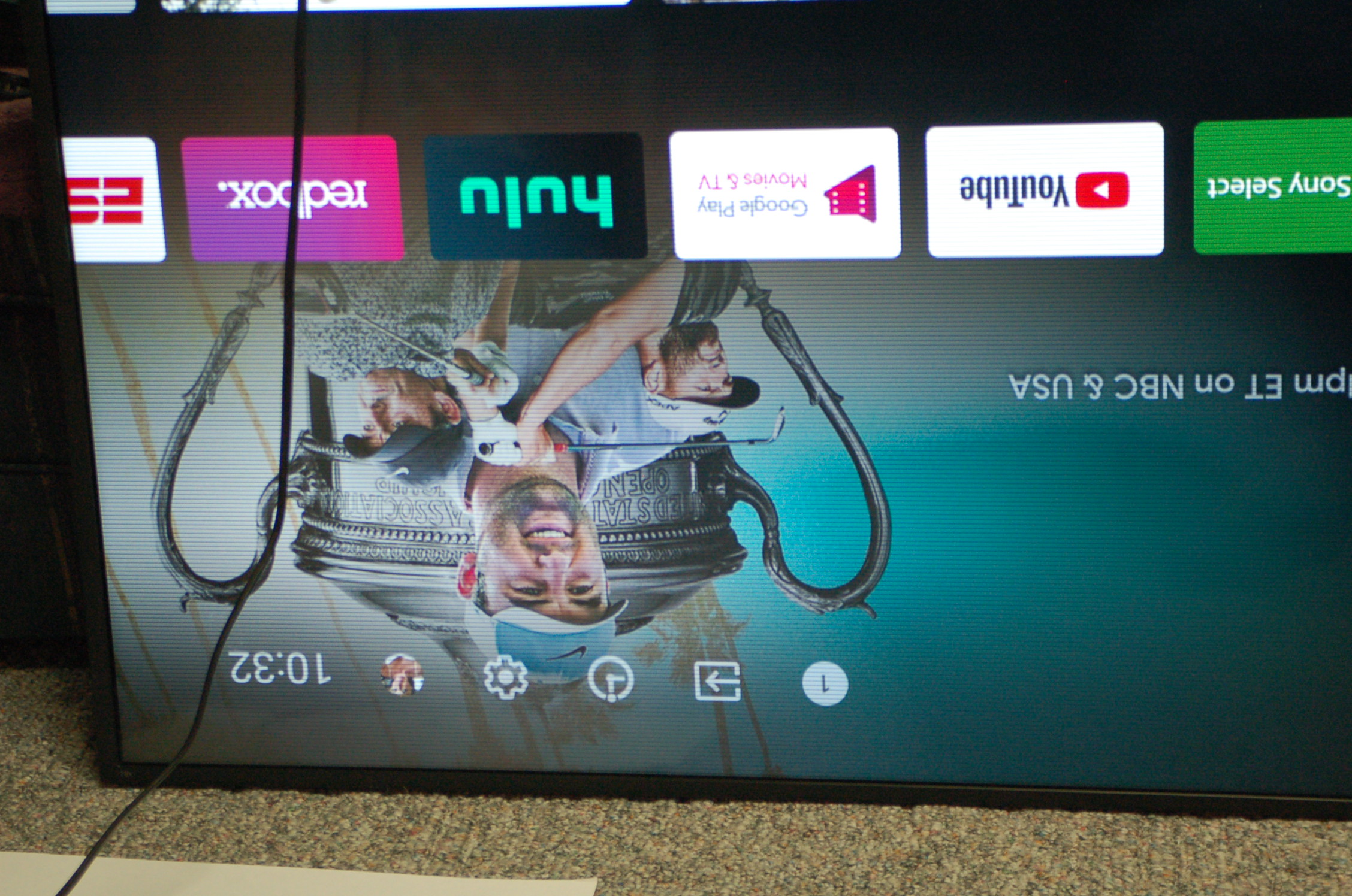

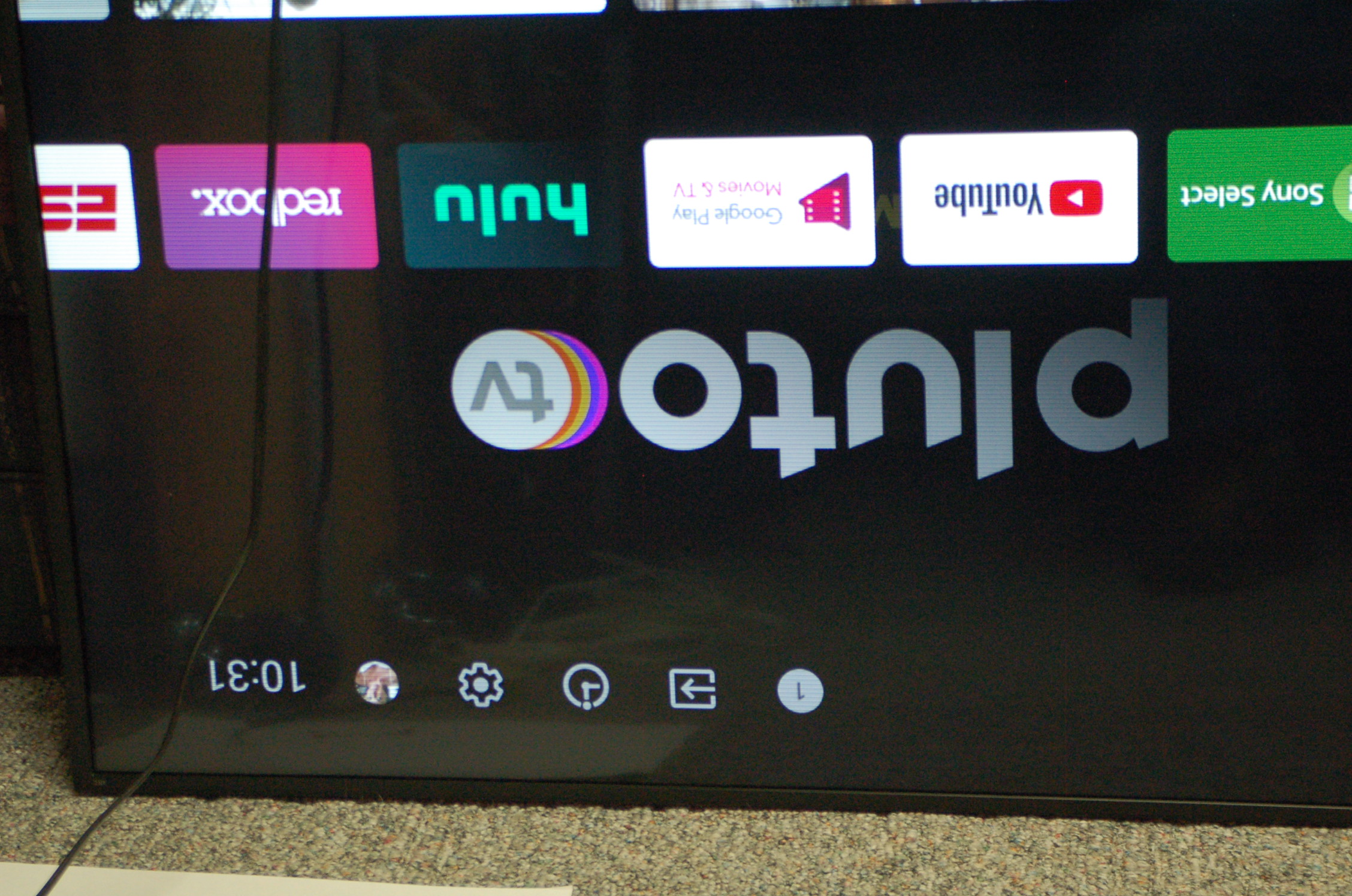

Sony XBR-65X750D Horizontal lines bottom of screen

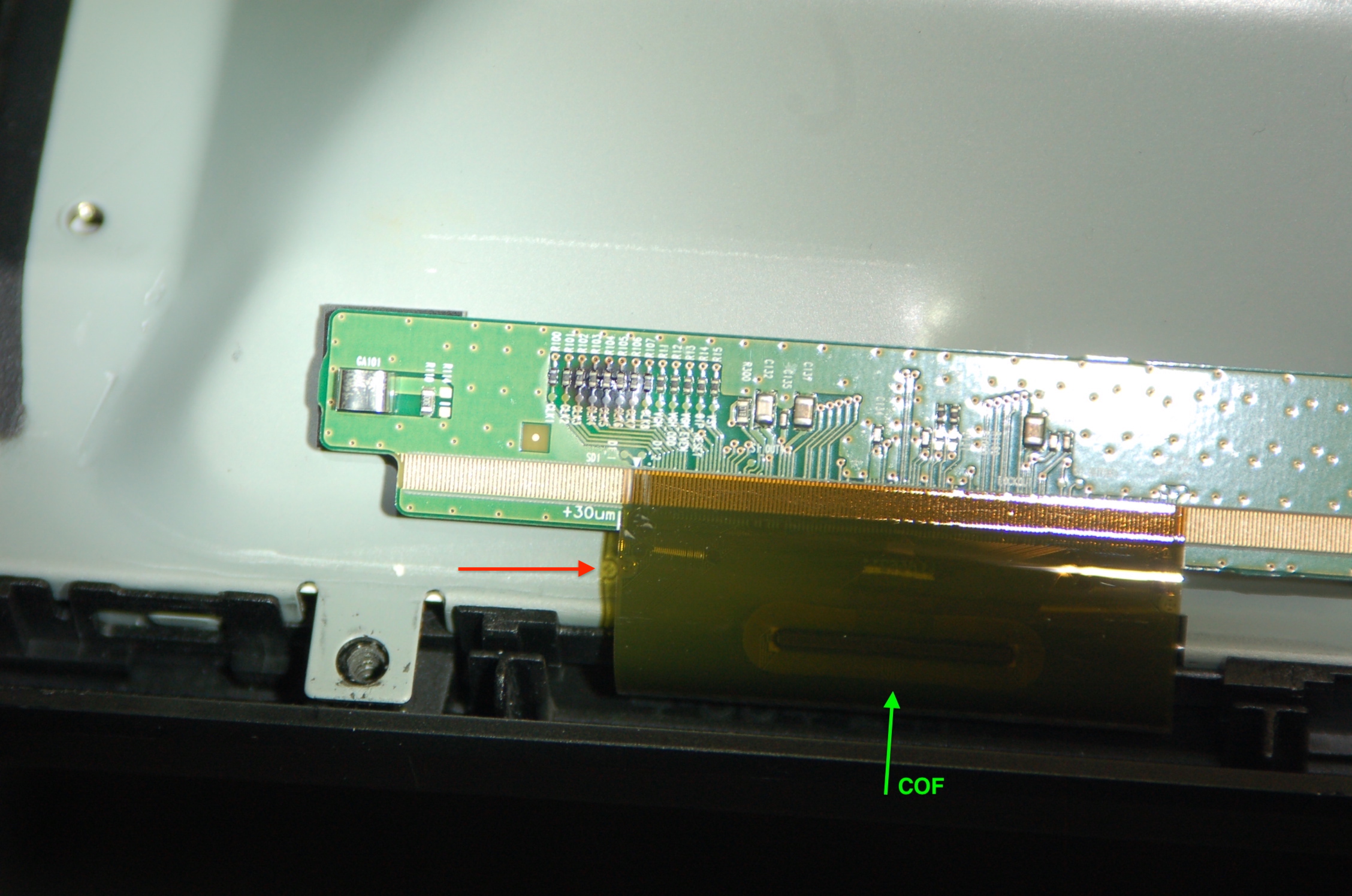

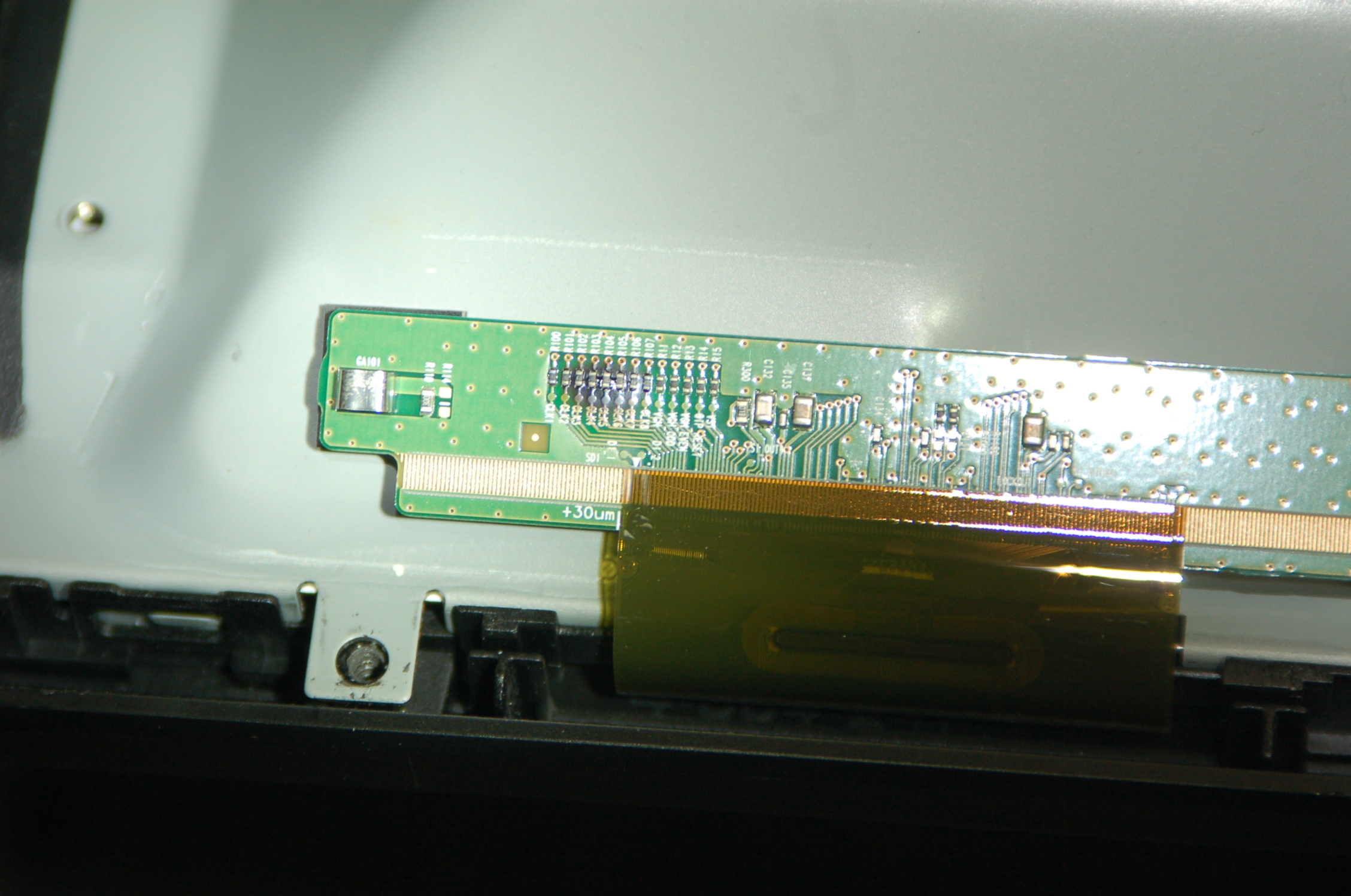

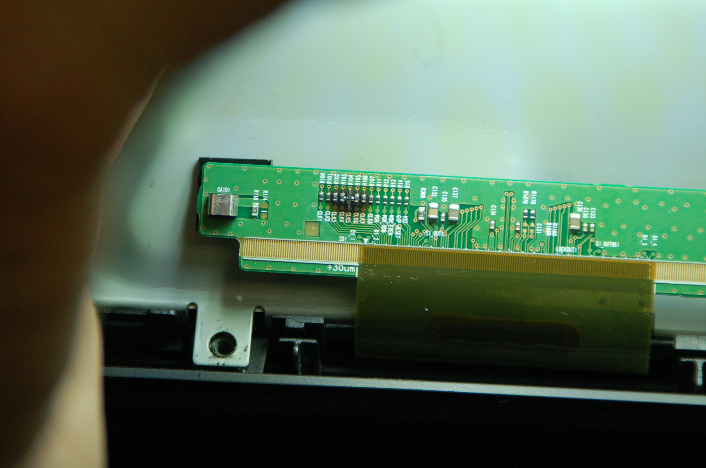

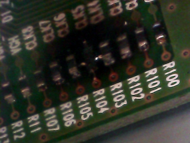

    Hello howardc64, Well, I think we found the problem. While I was using the strips to mask the ribbon cables from the T-con board, I smelled a burning component smell. When I finished with the testing, the TV appeared unchanged from before. When I completed the disassembly to uncover the buffer boards I found 1 or 2 burned resistors on the buffer board. I took some pictures attached below and then tried to clean with a q-tip which resulted in the worst burnt resister crumbling and falling away. It must have still had some value because after checking the TV again, the picture is worse with more lines. I don't think the burnt resistors are the problem but rather a victim of another failed component somewhere else. Any suggestions? Thanks
    • howardc64
      • Jun 2017
      • 653
      Re: Sony XBR-65X750D Horizontal lines bottom of screen

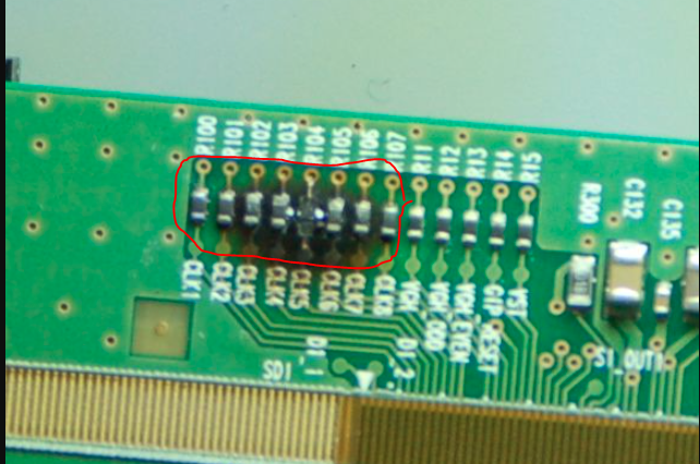

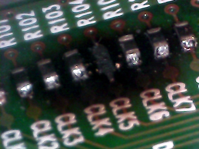

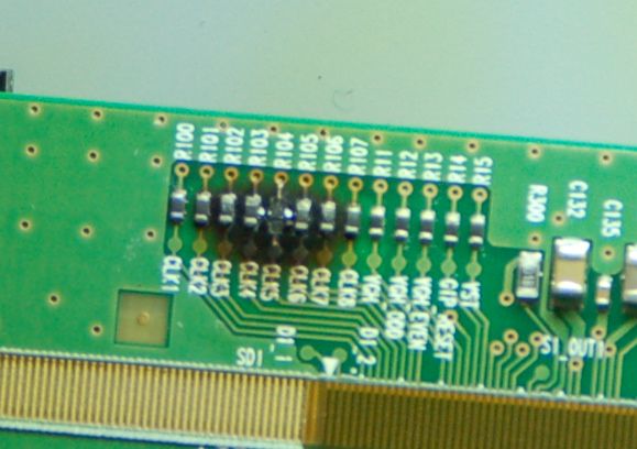

      Label shows CLK1-8 with 5 being burnt the most. I believe these are the gate driver lines. Resistors might be 0 ohm (check others)
      You might have damage/short in the COF (although the pic doesn't seem to show any damage).
      Inspect COF (Chip On Flex) closely There is a bunch of logic in there and many lines run between buffer board and the panel. Sometime there are shorts on COF and will show some damage marks (compare with other COFs for appearance) I fixed one with COF damages. Pics here
      https://www.badcaps.net/forum/showpo...72&postcount=7
      Other people have posted worse looking burnt COF pics but I can't find any at the moment.

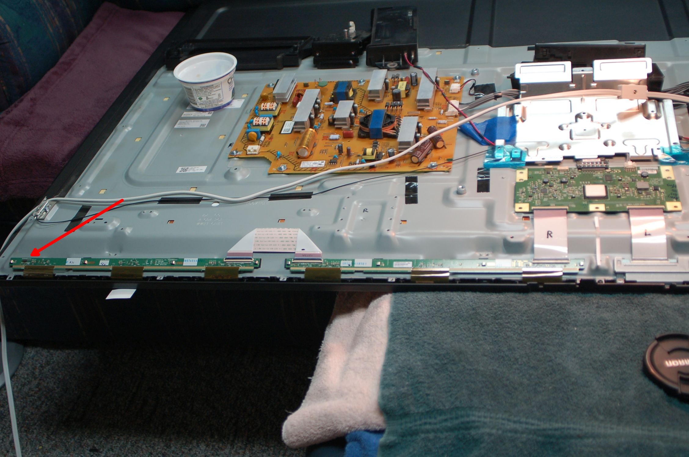

      Pic also shows another flex cable below the flex COF is on (red arrow in my edit of your pic) I've never seen that before. Would be interesting to see if any damage in there if you can lift up the buffer boards and see.
      You should have an identical bank of CLK1-8 resistors all the way on the other end of TV. Check those, take a pic, and measure resistance across each CLK1-8 resistor. We can use these as reference to compared with the ones around the burn mark
      If you haven't already, look through my Samsung panel signal summary earlier to understand the general background on gate drivers.

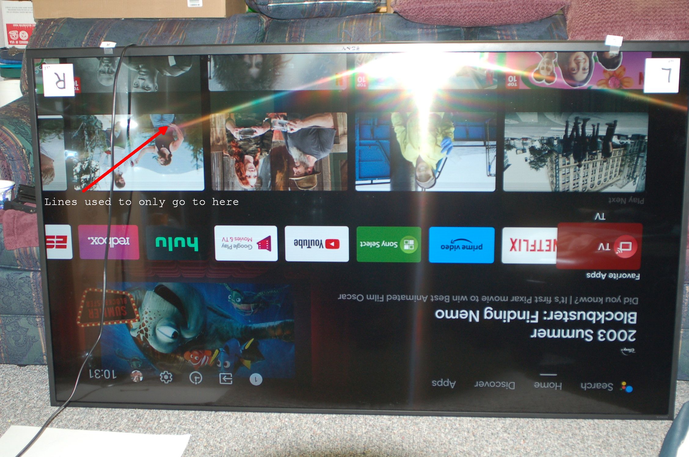

        Hi howardc64, The picture showing "another Flex Cable" is only a shadow from an extra light source to get a clear picture of the burnt "resistors". They are so small it is hard to get a good picture of them. I even took some pictures through a magnifying glass to try and get better pictures. I haven't checked the resistance of the "resistors" yet but if they're zero ohms, wouldn't that just be a fuse? These fuse/resistors are so small that I'm not sure how I am going to be able to replace them.

          Yes, tiny and magnifying eye wear + microsoldering (or really thin tip) soldering iron necessary.
          Thanks for confirmation the image below the flex was just shadow.
          Start by checking the duplicate set of CLK1-8 on the buffer board on the other side of the TV for resistance (for reference). Driver signals goes up both side of the TV. Controls signals for which row to display. Only 1 side need to work for a perfect picture.
          • ggil44
            • Aug 2011
            • 105

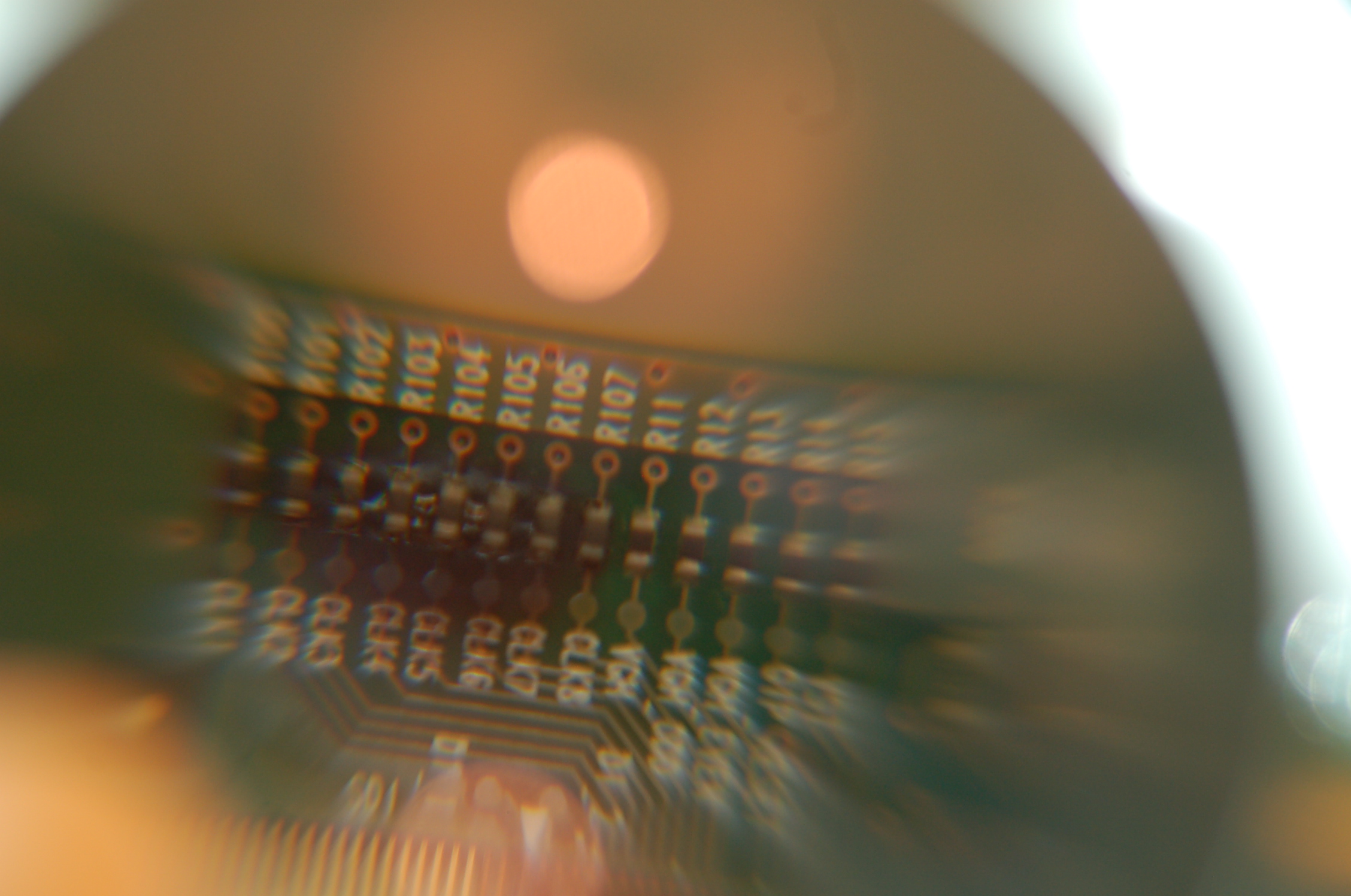

            Thanks, I found that resisters R100 - R107 are 100 ohms and R11 - R15 are 300 ohms. I measured the resistors on both sides of the TV (buffer boards) and like you said, they were the same. The one next to the burned out one measured 103 ohms so I think they are still functional. With the on resister missing I noticed that there were more horizontal lines and they were extending half way up the screen now. I am guessing if I can successfully solder a 100 ohm resister in the burnt out spot, that I can at least reduce the lines to the bottom 6" again. I found a digital microscope at a store a little while back and tried it here, see attached photos.
            • ggil44
              • Aug 2011
              • 105
              Hello again, you said something that I needs more explaining for me. " Only 1 side need to work for a perfect picture." So are the lines generated on the TV because there is a fault on both sides of the buffer boards? Sorry, I'm a novice.

                you might check lines on R100-R107 against adjacent lines on good side to see their behavior (probably no continuity?) and see if same on the burnt side. Just in case burnt damage has shorting the lines against each other somewhere.
                Yes, theoretically if R100-R107 are for gate driver lines, it can be unsoldered on one side of the panel and will still work perfect. But thats theoretical and we unfortunately don't have schematic OR know the complete damage (Just R104 or also other areas...)
                Note the ohm readings taken are all in circuit. if resistor was 0 ohm, then in circuit test maybe can conclude its 0 ohm. Since you read 100ohms, don't really know if its the resistor or another circuit path. Surest way is to remove a good one (or unsolder one side only) to test. But this is quite challenging of course without all the microsoldering tools. I suppose can try 100ohm first and measure after soldering.

                        Try measuring burnt out resister circuit with nearby other resister circuits. You'd want to make damage didn't create any additional shorts. Use the identical circuit on other side of the panel for reference on correct measurements.
                        • ggil44
                          • Aug 2011
                          • 105
                          #32
                          Looks like 100 ohms are right. I didn't find any short circuits with the burnt resistor. I tried using a soldering iron to remove the resistor on the LG buffer board but it didn't work so I used my hot air station and achieved success. I decided to pull a second resister just in case and I took my eyes off of the resister for a second and it was gone so I de-soldered another one. I stumbled across the lost resister about 10 inches away. Didn't think the hot air gun would blow it that far away. I feel over my head because everything is so small. Those resistors are not much larger than the period at the end of this sentence. Regards,

                            Some magnification aid and steady hands are necessary. Hot air on these tiny components probably need require some experience to not send it flying.
                            If don't have hot tweezer, a wider knife tip soldering iron ti can heat both ends of the resistor simultaneously for removal. Board traces are also tiny and easy to lift so require care when soldering it on.

                              Installing a new resistor will most likely not help here (it will burn out again), the problem is in the panel itself, you just need to remove all the remaining ones (CLK1-CLK8), the image may more or less be restored.

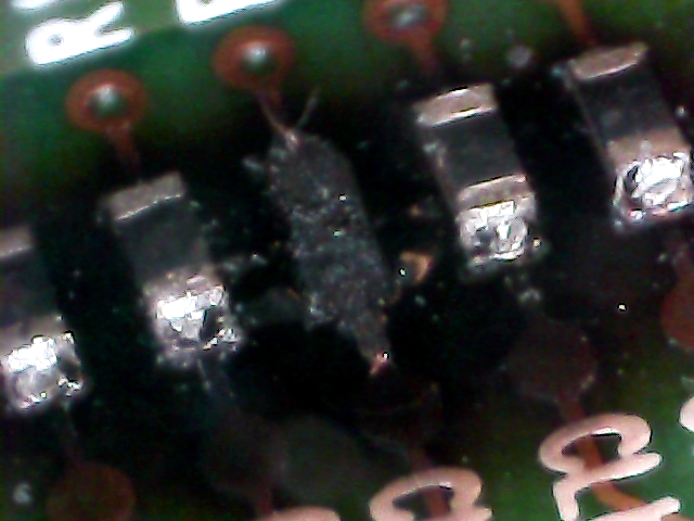

                                  Well, after 3 hours of trying to solder that microscopic resistor to replace the burnt one, I have found at least 8 ways that it won't work. The “pads” for the resistor have burnt up with the resistor so I have to try to solder a thin wire from the test point to the resistor or to the space where the “new” resistor will sit. What I found is when I have successfully soldered a wire to one side of the resistor the resistor is so small that when I try to solder the other side wire, the first one un-solders and falls off. That and being so small that the wires stick to the soldering iron, also, the resistor sticks to the soldering iron do to capillary effect of the molten solder. Trying to maneuver that tiny wire into position so that it won't short the very small distance to the other side of the resistor takes the hands of a neurosurgeon. I had finally soldered looped wire to both sides with the thought of cutting the wire when in place but when gently pulling the wire to ensure a good solder joint, the soldered end of the resistor came off. Like the Hee Haw song goes, “if it weren't for bad luck, I'd have no luck at all.” Anyway, I am going to step away from this for a few days so that my frustration can drain away and maybe figure out another way to do this that could work. Thanks for the help. Regards,

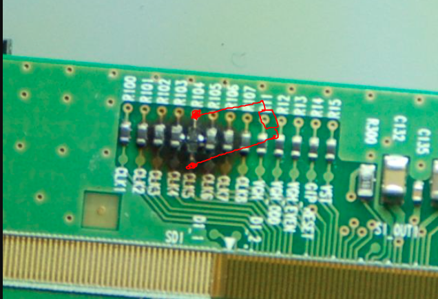

                                    But I agree with lotus on post #34. CLK1-8 are gate driver lines. Theoretically disconnecting these on 1 side is no harm since other side of the screen has a duplicate set of circuit. Its interesting disconnecting 1 by removing the burnt resistor made picture worse. This might suggest there is a failure somewhere the burnt up that resistor. Could be the in the COF/panel.
                                    Theoretically removing CLK1-8 from the burnt up side should allow the TV to work properly. But of course we don't know where the damage is and how it changed the circuit. Of course this is a bit scary because if pictures got worse, you currently don't have the tooling+skills to put back the resistors.
                                    Another way to disconnect CLK1-8 (sent from t-con) on the failed buffer board is to find which pins on the t-con connector they are and block it out. The way to do this is to do continuity checks between CLK1-8 resistors and t-con connector to find the correct pins to block them out. This doesn't require irreversible desoldering but requires a bit of probing effort with fine OHM meter probe tips.

                                      Why such torment, you need to clean the heels for verification and tin them and solder the usual low-wattage resistor (0.25w) 100 Om to them and that's it.

                                          Hi, While I am waiting for the 110ohm ¼ watt resistors to show up in the mail, I decided to “tin” the resister contact points with the most pointed soldering iron I have. In the process, I de-soldered the resister next to it but it did appear to have one end broken already. Anyway, I am posting the picture as it shows on the TV now in hopes that it might give a clue to a possible cause of the problem(s). Originally, I was experiencing horizontal lines only 6 inches up from the bottom, now I have horizontal lines over the entire display. Please see attached pictures of the TV (upside down). The first picture shows where the horizontal lines used to stop. Thank you again for the help.
