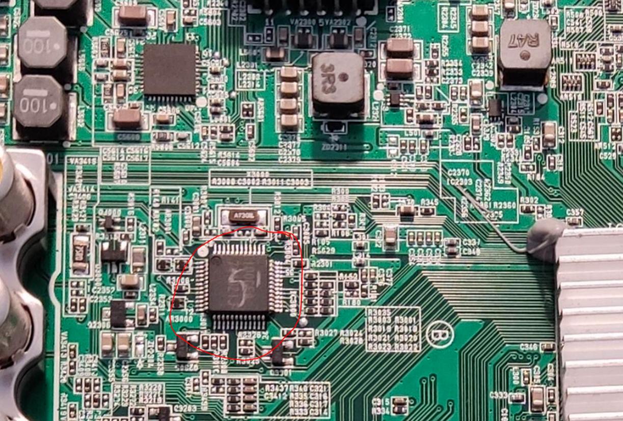

      Re: Anyone with experience repairing a bad MAIN board?
      Originally posted by Davi.p
      Sorry if i don't read entirely the discussion, i put my thoughts, my attention is towards 2 elements of this board, 1 is the microcontroller with a pencil mark on it, its firmware could be corrupted, it holds the standby software that is responsible of the state of the enabling signals that starts the smps dcdc stages, 2 is the dc dc that feeds the uC, probably a sot23 with 3,3v output near the uC..
      I don't think the uC can be executing any program as I can't find any voltage across the board that can be fed to supply a uC, I can only see 8.7V
      I agree that the dc-dc close to the uC could be bad, I will see if I can find the IC model and hopefully it has external (no BGA) pins
      Thanks!
        Originally posted by lotas
        Micom (multicontroller) is a separate processor (it contains its own firmware), which controls the power supply of the DC / DC converters and the standby power of the entire board.
        So according to what you say this IC could be managing the whole sub powers of the main board? Where is this IC? Are you seeing it on this board?
        Thanks a lot!
            It has a separate 3.3v power supply, somewhere next to it there should be its own 3.3v converter. And you need to find this voltage in general.

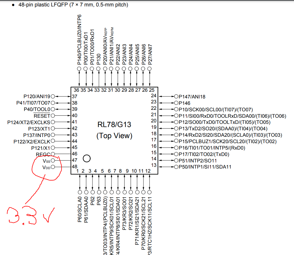

                    #29
                    Check if there is voltage between pins 47 - 48, should be 3.3v.

                      #30
                      Checked. Nothing-> 0v
                      Like I said before I haven't found any single voltage on this board other than 7.8V.
                      Also VSS in this IC is not connected to chassis ground, is this normal?
                      Thanks!

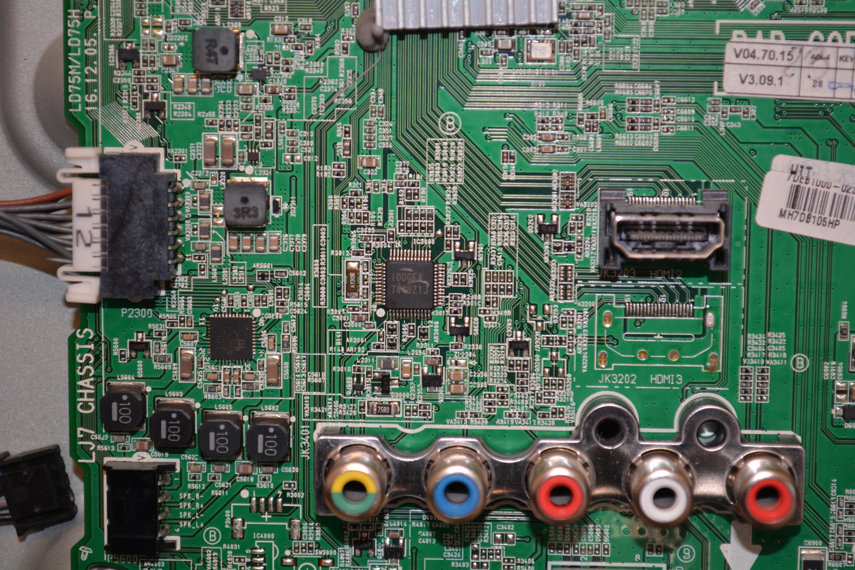

                        #31
                        A high-quality photo with a high resolution of this area can be posted.
                        • edugimeno
                          • May 2017
                          • 581
                          • Spain
                          #32
                          Absolutely. This is the best detail picture I've been able to get with a "real" camera.

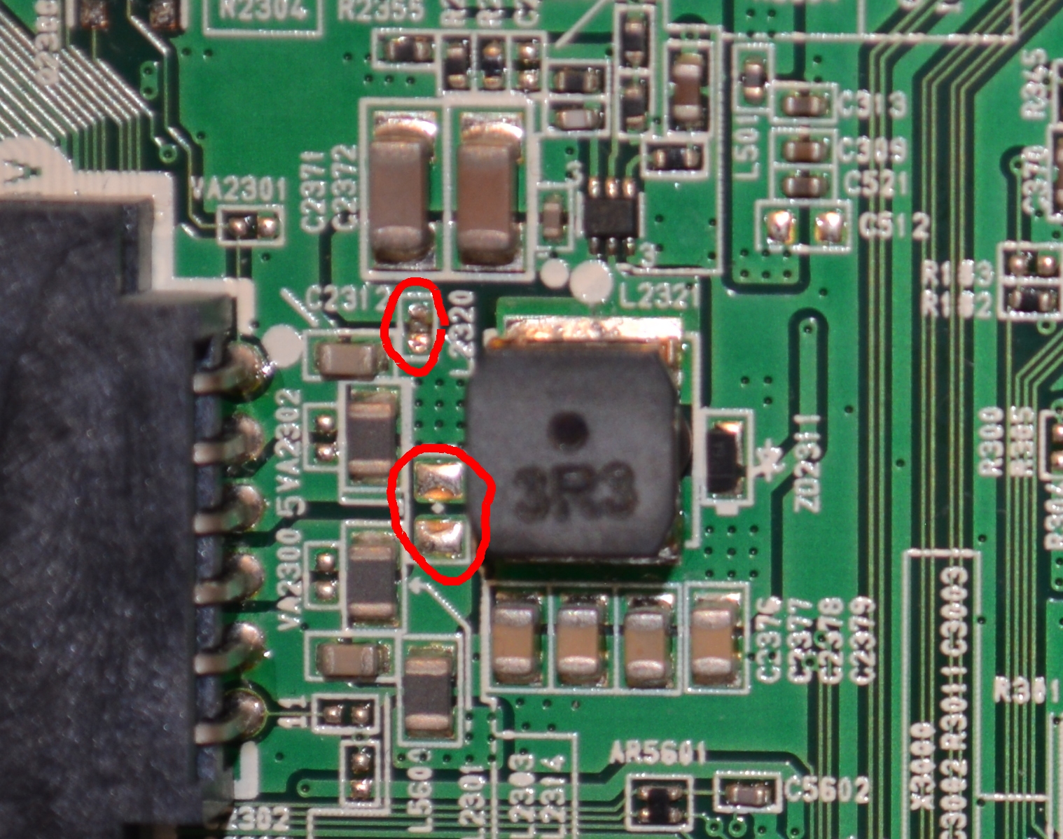

                                    #37
                                    What do you think of this part? Looks like coil on top is fried? I tried shrting with what I could (thin pliers end tip) but got no light on st-by-led and got a really little smoke line for under 1 second in that area...
                                    Also the other coil (bottom) is not probably assembled but just wanted to point it out...
                                      edugimeno you have misunderstood almost the entire discussion, i repeat for the voltage regulator that feeds the uC=microcontroller=micom (that is another processor) : probably a sot23 package with 3,3v output near the uC..

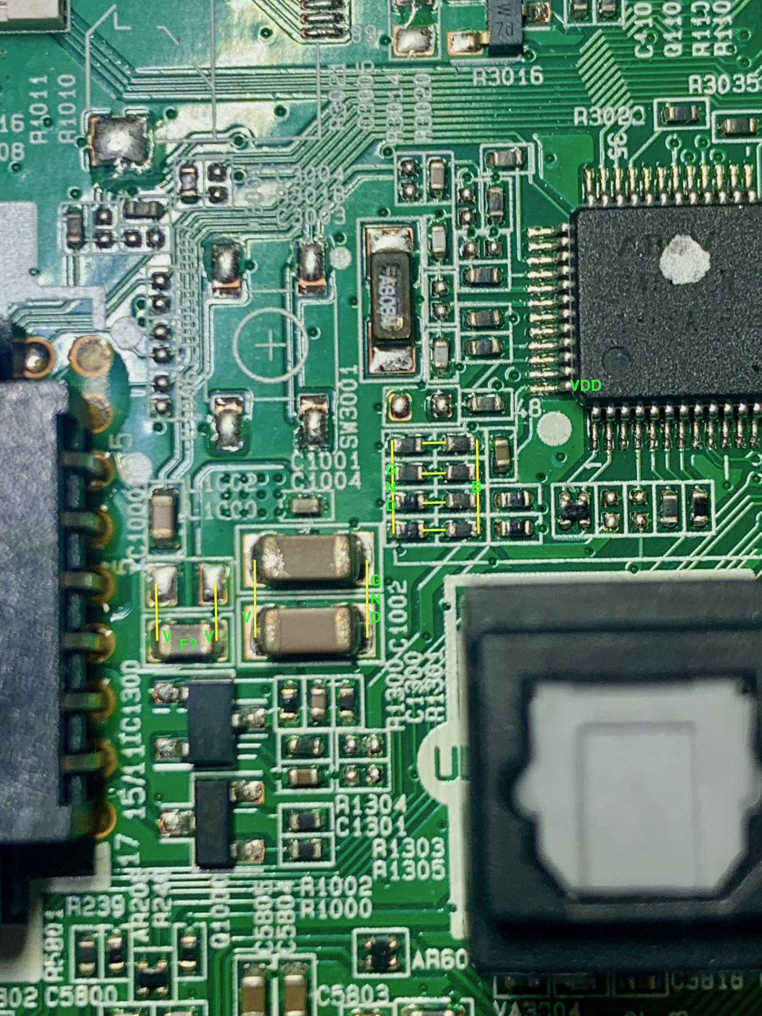

                                        There are very few components between MICOM VDD and 12v connection (providing 7.8v in standby mode) to the PSU. I used diode and ohm mode to figure out the circuit on my board. Looks like 7.8V is converted to 3.3v through a bank of resistors. Here is a pic of my board. Your board maybe different and have sot23 providing 3.3v per @Davi.p in post #38 (However, that sot23 could also be a reset monitor per schematic in post #33 p40, here is link to reset monitor datasheet )
                                        VDD = 3.37v
                                        B = 3.37v = VDD
                                        GND is ground
                                        V = 7.8v in standby = 12V connection from PSU
                                        F? looks like a fuse
                                        Anyway, the key is to trace from PSU connector to see where 7.8V trace go to. Look up component and try to understand where 3.3v conversion is done. Use diode mode and ohms mode to figure out what component is connected to what.
                                        If you have a fuse (F?) like mine, maybe it is broken?
                                          Yes, this is a small choke L2320, voltage passes through it, which means that something is short. check with a multimeter on each side where this inductor is located for resistance relative to gnd.
