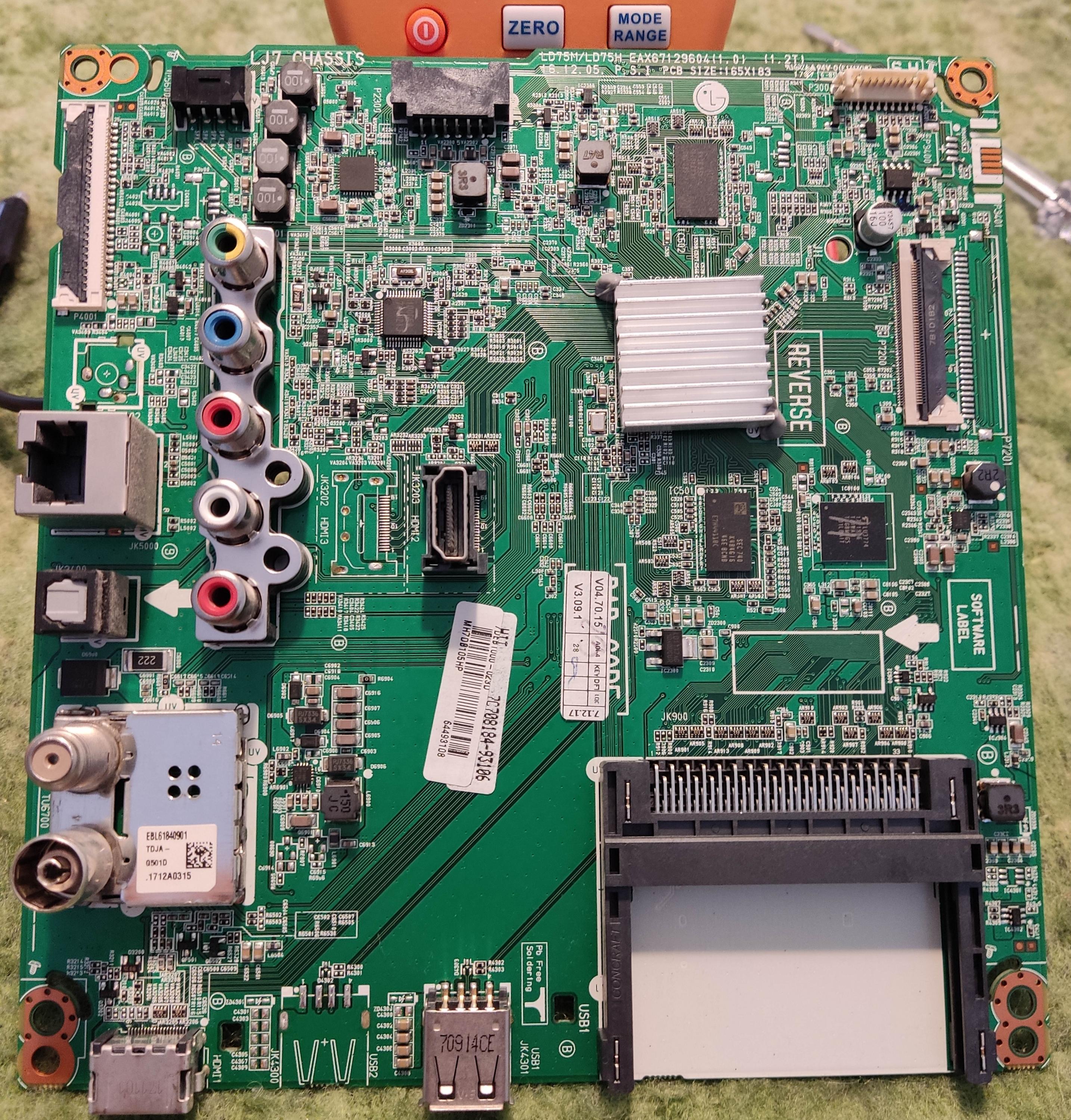

    Hi There! I already had another post with this but it got no attention from anyone so I'm starting a new one with a probably more descriptive subject
    I have an LG 43LJ594V that would not even power up the stdby led. I checked the PS board and its 100% good. Provides 7.8V when STBY and 13V when ON, I checked it forcing DRV_IN input to high.
    So all the other subPS's should be in the main board. The TV won't show any life in it'¡s stby led, won't turn on when pressing the phisical ON button nor the remote. My guess is that some subPS inside the MAIN board is bad.
    I checked all capacitor and none shows any short. Also checked all D's and Q's and no shorts
    I tested several points in the whole board and 7.8v is the only voltage I can find.
    I have never tried to repair a main board, anyone can provide a hint on what to start with?
    Thanks in advance!

    I recently debugged a HiSense main that turns out to be a dead eMMC. It had all power rails but no activity (not even standby light) A good way to get a quick power rail status on the main is to probe all the inductor/coils. I think most if not all DC voltage output on the main has a coil/inductor on the output side. Just put meter in DC volt, ground on metal chassis and check either side of the inductor(s). Note that the generation side of the inductor may have AC components so will see that if in AC mode but in DC mode, will read same on both sides.
    You'd want to see the following
    ~1v for CPU
    ~3.3v for lots of logic
    ~1.8v for eMMC
    ~1.5v for DDR memory
    ~5v for USB+WIFI+IR
    Let us know how many of these voltages you see. I labeled all the inductors A-J on your board.

      Most of the dc-dc converters are OFF at this time. I only get voltages at the one you labeled J (near the tuner) and the voltage matches the main PS voltage, 7.8V (which doesnt make sense to me, why would a subPS be generating another voltage equal to the main voltage already provided?)

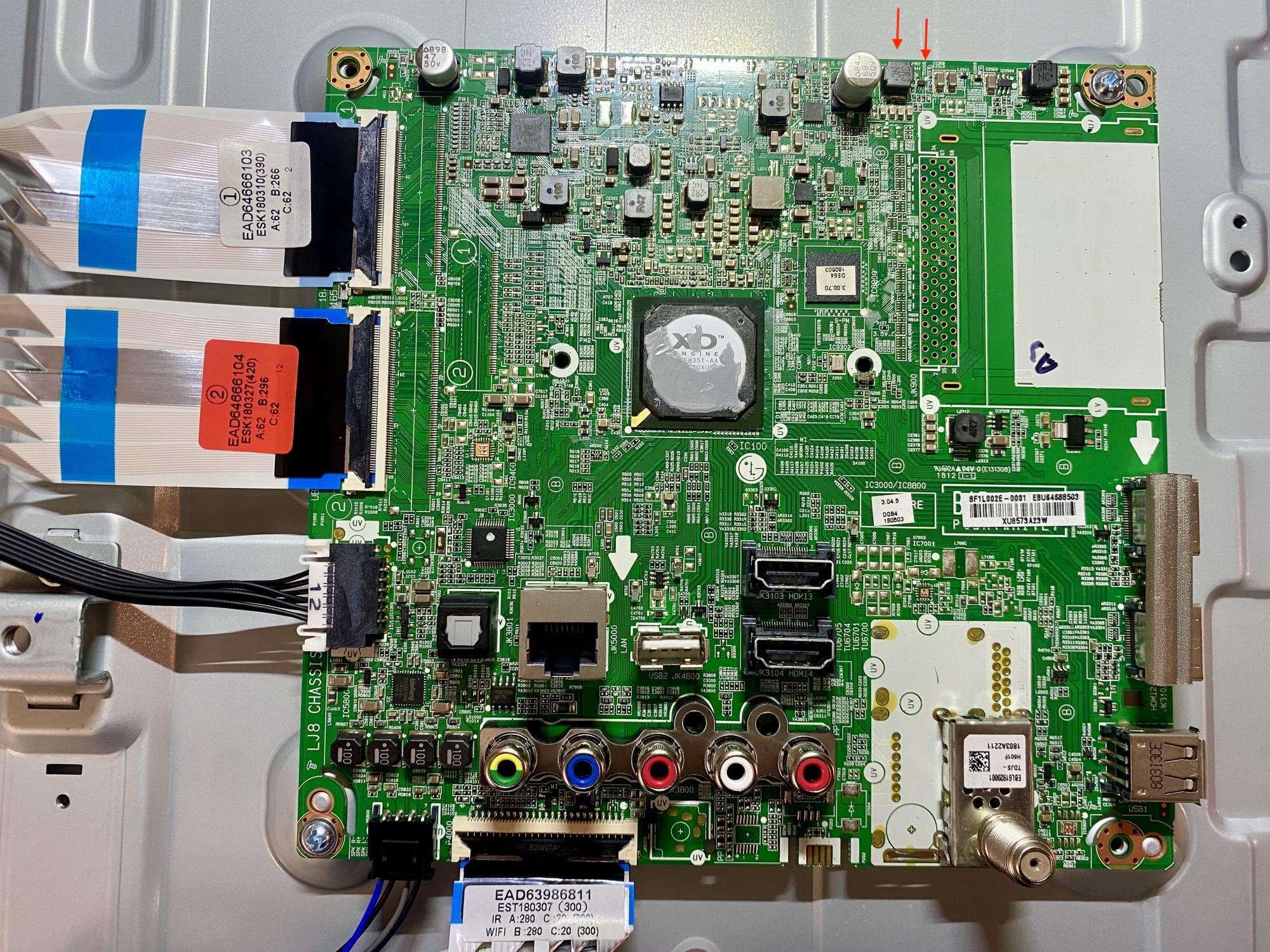

                I have a similar year working LG with same SOC (XD engine)
                • Your main SOC on p43 on service manual (link in post #5)
                • Mine main SOC 3rd pic from top ( see pic below, repair post link my failure was due to panel buffer board shorts)
                On my working LG, voltage readings during boot are
                Stage 0 : Initial Boot after plugging in AC without turning on TV power switch.
                PSU
                • PS_ON = 3.3V
                • 13V = 13V
                Main
                • 1V, 1.5V, 3.3V, 5V all present on coils
                Stage 1 : 20+s After Initial Boot plugging in AC without turning on TV power switch.
                PSU
                • PS_ON = 0V
                • 13V = 7.8V
                Main
                • Only 3.3V present
                When you first plug-in AC, you never see Stage 0 condition? I believe 3.3V PS_ON requires CPU to boot (which probably require most of main voltages) to turn it on.
                On my main board, 3.3V coil and 6pin DCDC chip marked with red arrows

                      I see, in my case I think I have confirmed that the PSU is good, according to another service manual I found. Iy said that when PWR_ON and DRV_ON are left low, main voltage would be 7.8v meaning standby condition (this was checked) , but when you pull PWR_ON to high, PS voltage rises to 13V, and then when you pull DRV_ON high, BL LEDS will turn on. All this was checked correctly so I called this PSU good.
                      I haven't found any other voltages in my PSU other that the main PS voltage (either 7.8v, or 13v if I forced PWR_ON), but that's it, no "new" voltages generated inside. I don't even understand why the provided voltage is present at a coil, it was already generated outside! A DC-DC converter would be using that voltage to generate a new one!
                      I guess the led/ir board requires either 3.3v or 5v and none of this voltages are present anywere in the board so this is first thing, it can't even detect the turn on signal...
