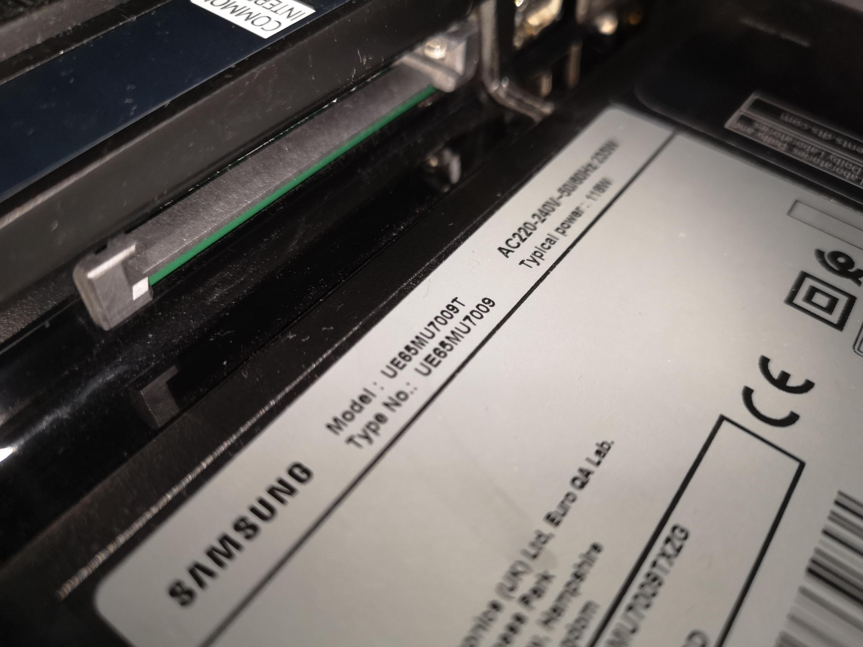

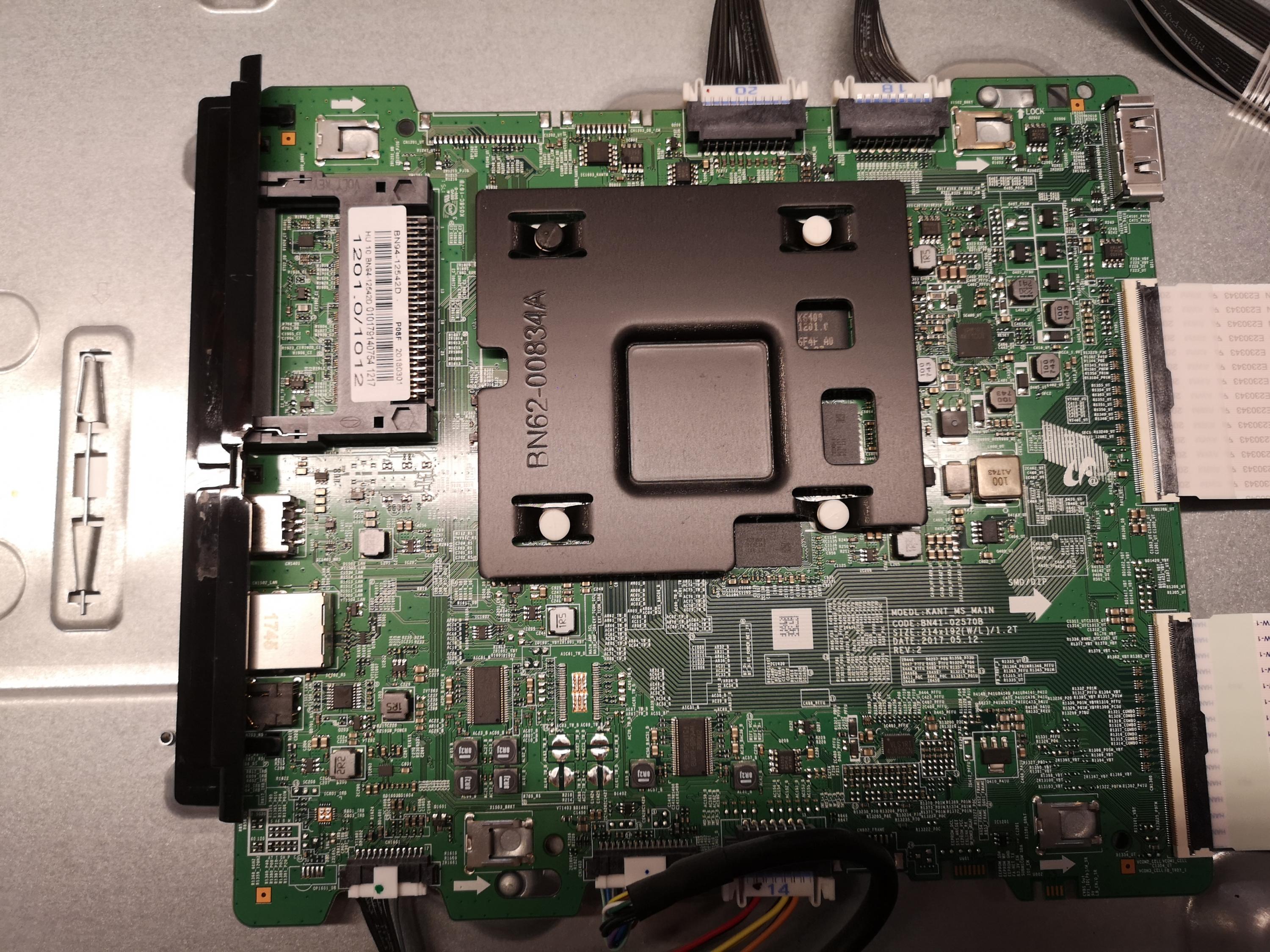

                    #69
                    Re: samsung ue55mu6192u dead signal LED
                    thank you Lotas for check,
                    but i still have the problem with the TV.
                    The TV will not turn on, there standby light shines pulsating dimly, then brightly, and so on in a loop.
                    If the dump is OK, what else could it be?
                    My model TV:
                    - UE65MU7009T
                    Mainbord:
                    - BN41-02570B
                    - BN94-12542D
                    Maybe another idea?
                    • lotas
                      • Jan 2016
                      • 4881
                      • Russia
                      #70
                      Well, here you need to check what the power is draining, check the resistance on the DC/DC converters relative to the ground, what is the voltage on the 8 pin of this spi flash 25Q40 (it should be 3.3v).
