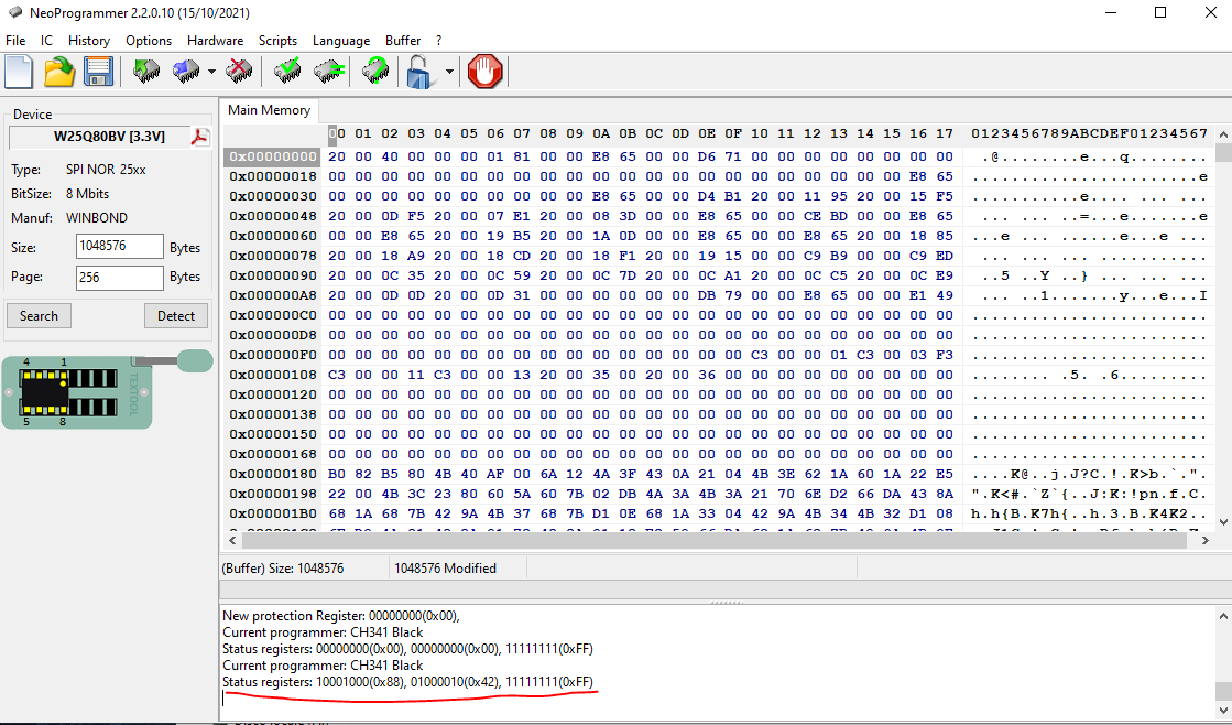

        Try, do not forget to install and write down the Status Register (0x88, 0x42) after recording.
        • giova96
          • May 2023
          • 38
          • italia
          Re: samsung ue55mu6192u dead signal LED
          Status Register?
          In what sense? I did not understand
          I don't have much practice
            Hi Giova, which program have you used for taking the dump?
            If you're using asprogrammer see the screenshot in attachment.
            Press the button on the side of the lock, show registers and then set the checkboxes for having 88 and 42 in the status registers.
            p.s: sono ita anche io, ciao!
                See my edited message above
                Basically you should find a form whre you can edit status register 1 and 2.
                If you can't find it in your program maybe you can try using "asprogrammer"
                  Try
                  • giova96
                    • May 2023
                    • 38
                    • italia
                    done (maybe )
                    i will go to try now
                      Originally posted by giova96
                      done (maybe )
                      Looks fine and good luck!
                      Just a question based on your screenshot: why do you have W25Q80 instead of W25Q40 in your device type?
