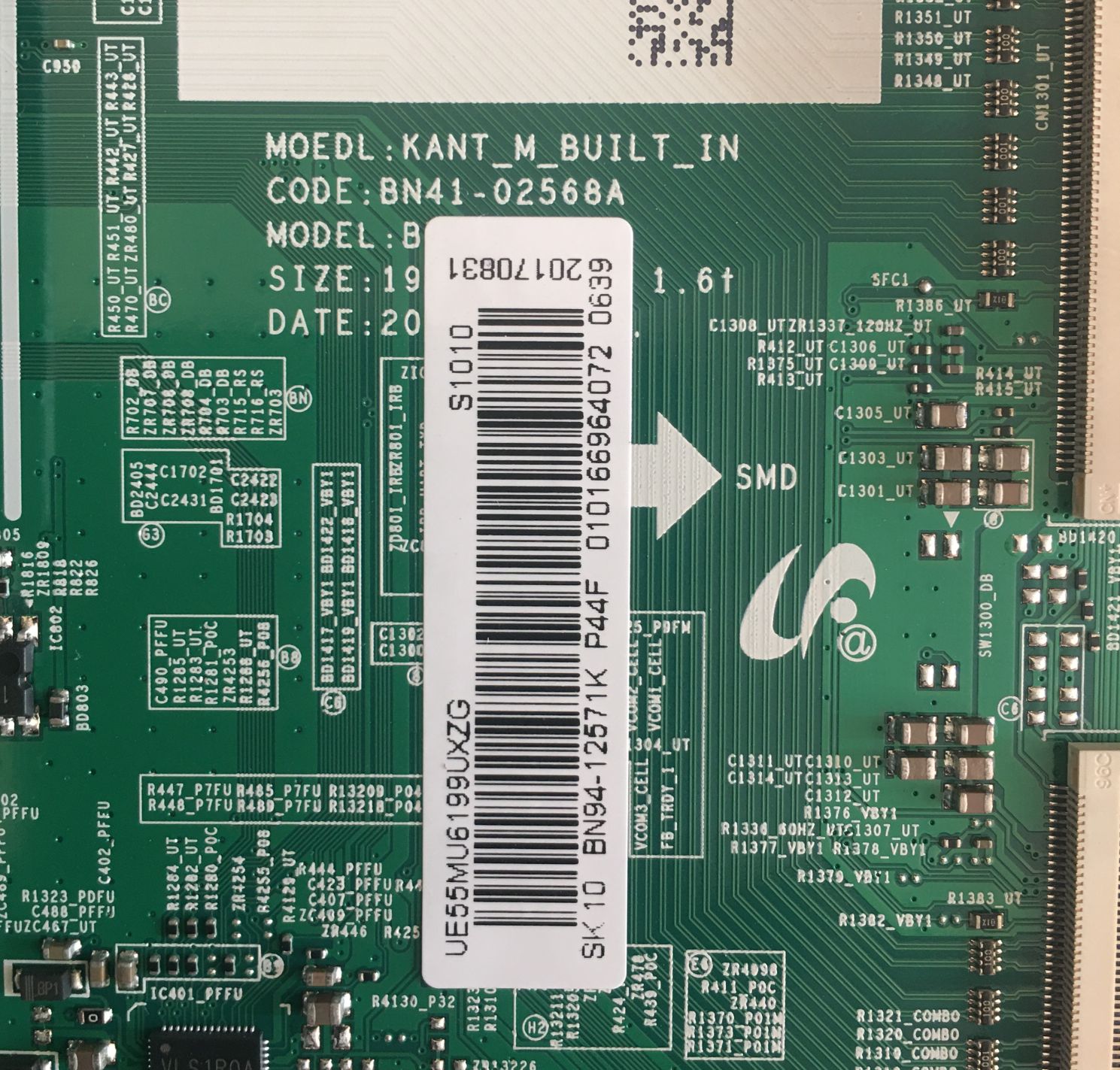

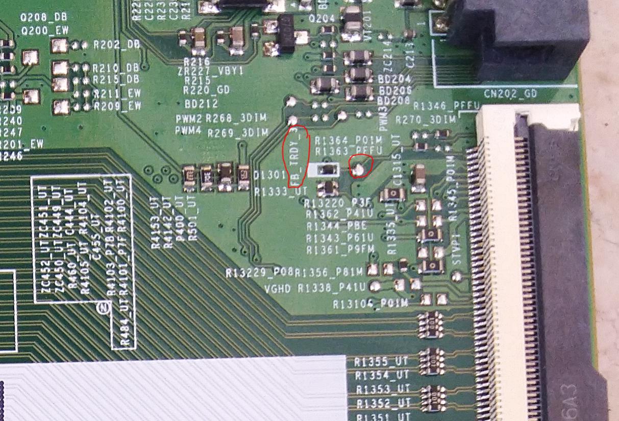

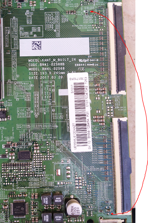

    Put a jumper on the motherboard between FB_TRDY_1 and FB_TRDY_3 and then you can determine which half of the panel is not working.
    In which area do I find these acronyms? I would like to avoid making changes to the card purchased (paid a lot) so that I can return it in the worst case

      Post a high-quality photo, close-up, where the connectors for connecting lvds cables are located.
      I understand that you have the same behavior as on your own motherboard, on the new one you purchased.
          • giova96
            • May 2023
            • 38
            • italia
            #45
            Re: samsung ue55mu6192u dead signal LED
            what happens once connected?
            risk of damaging the new card?
            • lotas
              • Jan 2016
              • 4888
              • Russia
              #46
              Nothing will happen to your motherboard, this is so that the motherboard understands that you have two lvds cables connected, with a jumper it will now display an image on either side, with one cable disconnected. And you can determine which half is not working for you.

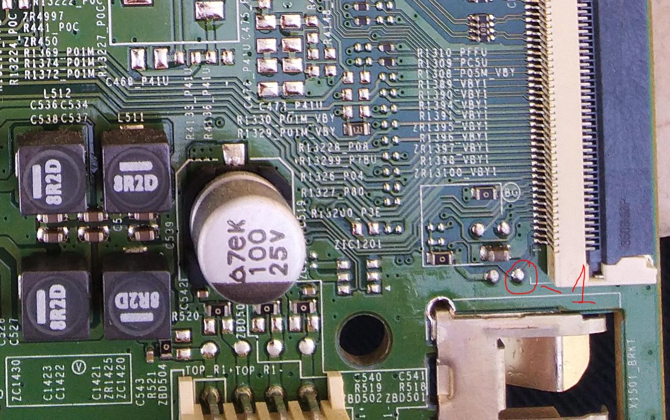

              • giova96
                • May 2023
                • 38
                • italia
                #47
                so made the jumper, can i connect both lvds or just one?

                  And all these manipulations must be done with the TV turned off from the outlet.
                  Why, put a jumper and disconnected one cable, checked, connected the first, disconnected the second and checked again.
                  • giova96
                    • May 2023
                    • 38
                    • italia
                    #49
                    okay
                    in this way I exclude that the right panel has problems?
                    if the panel is good, do I have to change the correct card?

                      Well, you check, then it will be clear, maybe the T-CON (25Q80) firmware is not working or the panel for it does not match.
                        https://www.youtube.com/watch?v=az2v...ovanniMarrocco
                        https://www.youtube.com/shorts/NzWfdCQDrnk
                        did as you said, this is the result
                        do i connect both lvds ?

                          Yes
                            Yes
                            it works, you see!
                            I let it test for an hour before putting the lid back on
                            Do you think I need to make some changes in the service menu?

                              If the panels (matrices) were the same, then nothing needs to be changed.

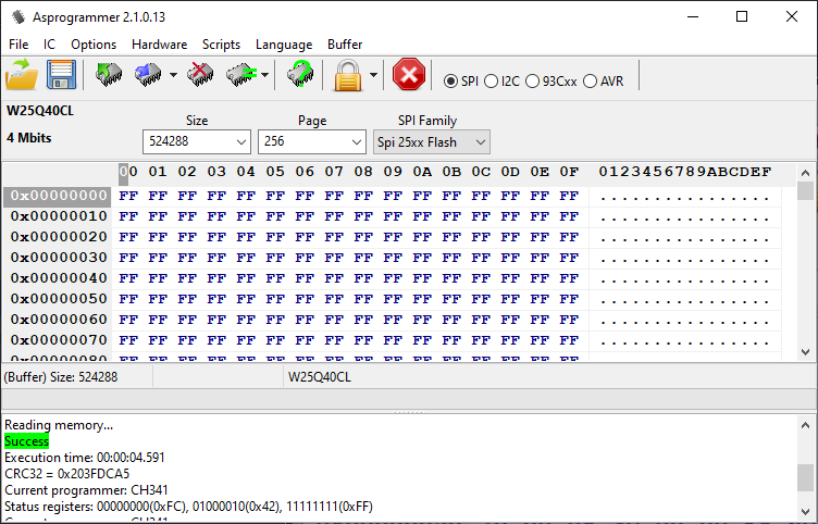

                                        I suspect I have a problem with IC1604 dump integrity too.
                                        Can anyone (lotas?) check and correct if needed my dump?
                                        All info are in photos attached.

                                          Try.
