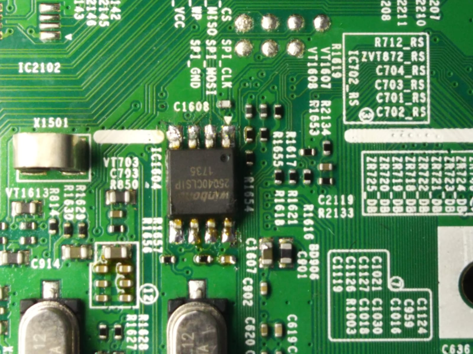

    when reprogramming memories one must always make a backup of old fw, now if you have that you must provide it to Lotas
    Maybe I explained myself wrong
    the third place file is its original without having made any changes
    the wrong file of 50" I wrote it on the new ic not on the original
    today I deleted the original and rewrote the copy that lotas gave me

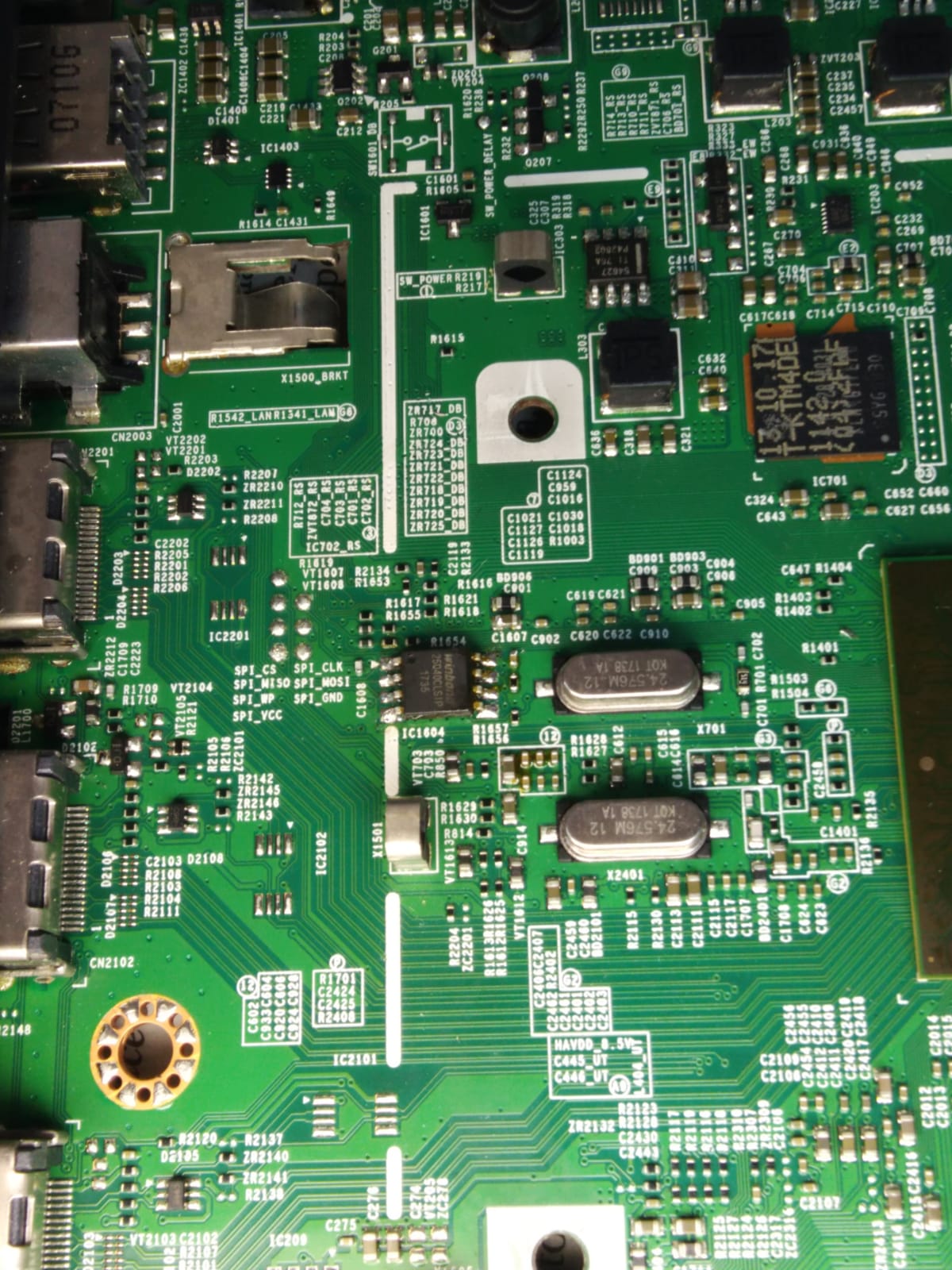

      It's strange why you don't have 8 pin power. 3.3v, it should be permanent, maybe something was damaged when the flash was dismantled, take a high-quality photo of this area where this flash 25Q40 is located.

        I can't do any better than that
        however all night without power, as soon as I connect it the LED lights up and responds to the commands from the push button panel but the TV does not start, in the meantime I feel that the CPU heatsink cools down, the whole thing lasts 30-40 seconds and then dies again and never turn on again
        at that moment all the voltages are present, then the usual defect that disappears at 3.3v and the 13v drops to 8.8v
        I think it's a cpu problem in the end

          This usually happens when the software version of 25Q40 and eMMC does not match (do you have this exactly the original, native dump from this TV?), Try reading the dump from 25Q40 again and post it here, I'll see how it was recorded.

            the original dump is the one in the third post
            I have now rewritten the 25Q40 with the version you sent me

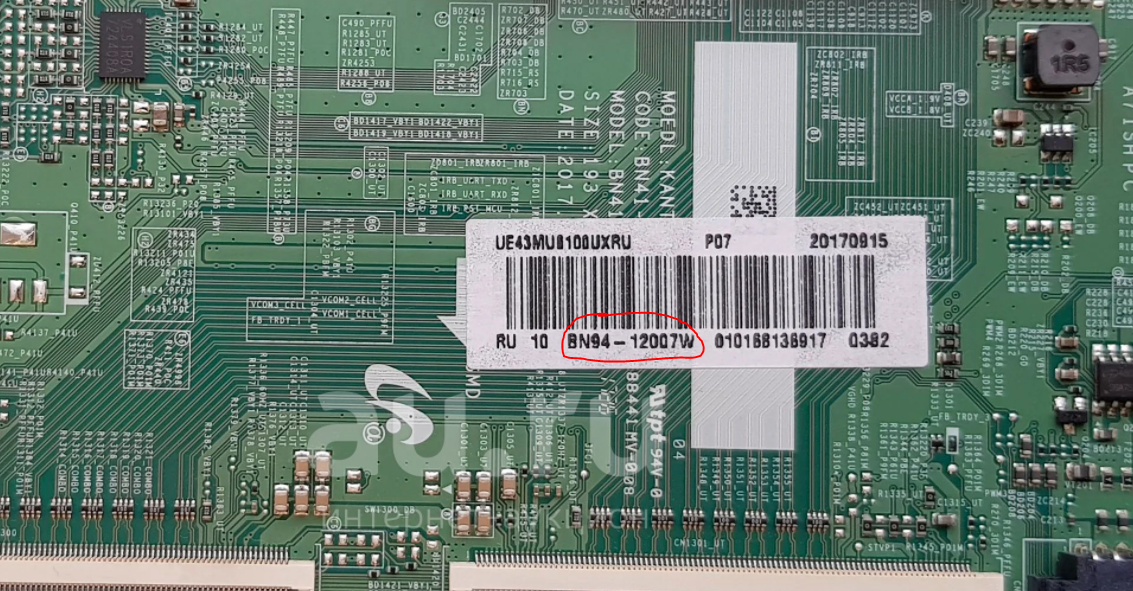

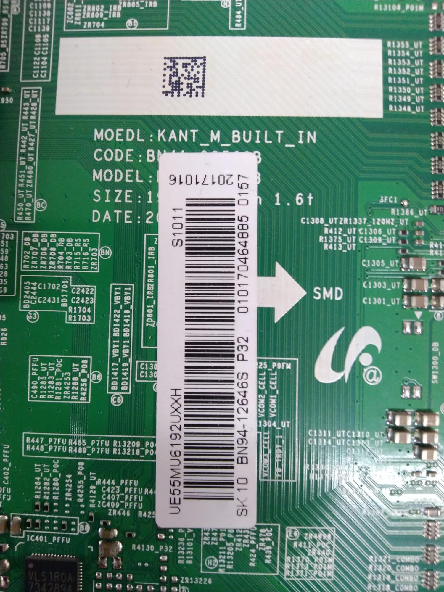

                            This is my number
                            bn94-12646s
                            do i have to find this on the new one?
                            • lotas
                              • Jan 2016
                              • 4892
                              • Russia
                              #34
                              Re: samsung ue55mu6192u dead signal LED
                              Yes, try to find it by this number, if you don't find it, you can look for another one, but it is desirable that it be from "55" inch.

                                    I bought a motherboard that was identical to mine
                                    instead they sent me this saying that it is compatible
                                    the TV does not start anyway, it has the red LED active and tends to turn on the backlight (I also hear a tick sometimes)
                                    card received UE55MU6120 BN94-12645A
                                    my board UE55MU6192 BN94-12646S
                                    should work for the seller...
