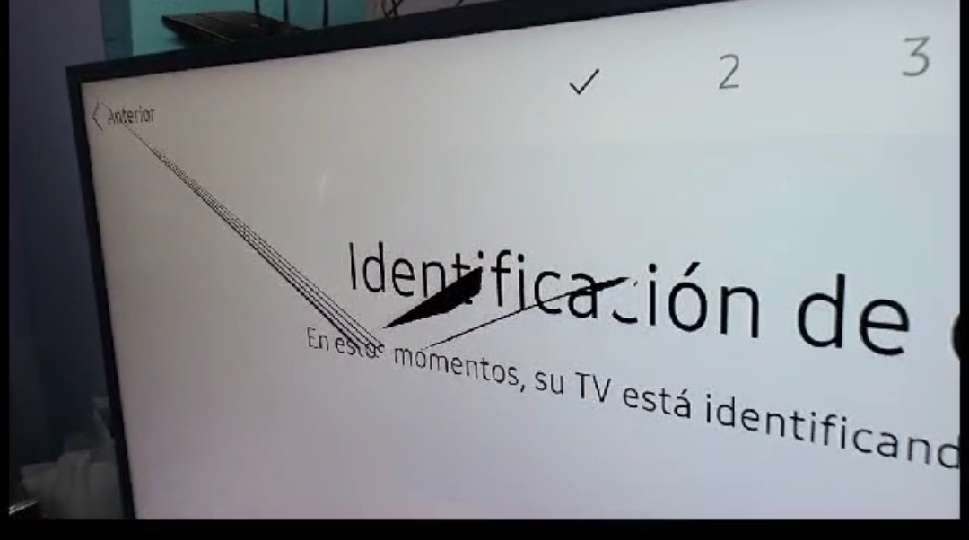

    Good afternoon! Let's see if anyone knows who can help me with this. attached photos. sometimes these strange black figures appear on the panel, in various areas. I have never seen this error. thank you

      Re: Samsung UE43RU7406 strange black figures
      Originally posted by Raulnn
      someone?
      no one can answer yours questions.. only you self... if the this black line /points move up and down when you click on screen then its dirt under the glass if not then its panel burn cells.
        thanks for answering. those strange figures appear and disappear, and different ones appear in another area. I think it can't be that. I forgot to put that information
          This is a software issue...
            I think similar. Or maybe graphics hardware has some failure. So replacing main board is most likely.
            Damage pattern doesn't look like panel (no vertical/horizontal lines)
                Thank you all for the answers. How could I rule out panel or main? I have thought about disconnecting a flat cable from the 2 that go to the panel, to see what happens. and then another. If the failure is in both cases, it could be the main board, and if it only fails in one of the 2 cases, it would be the panel. is it a good strategy? thank you
                  I think its a software issue. Usually emmc goes faulty. Pretty sure a new mainboard would solve this problem.
                  Usually the menus are scrambled with big and assorted letters.

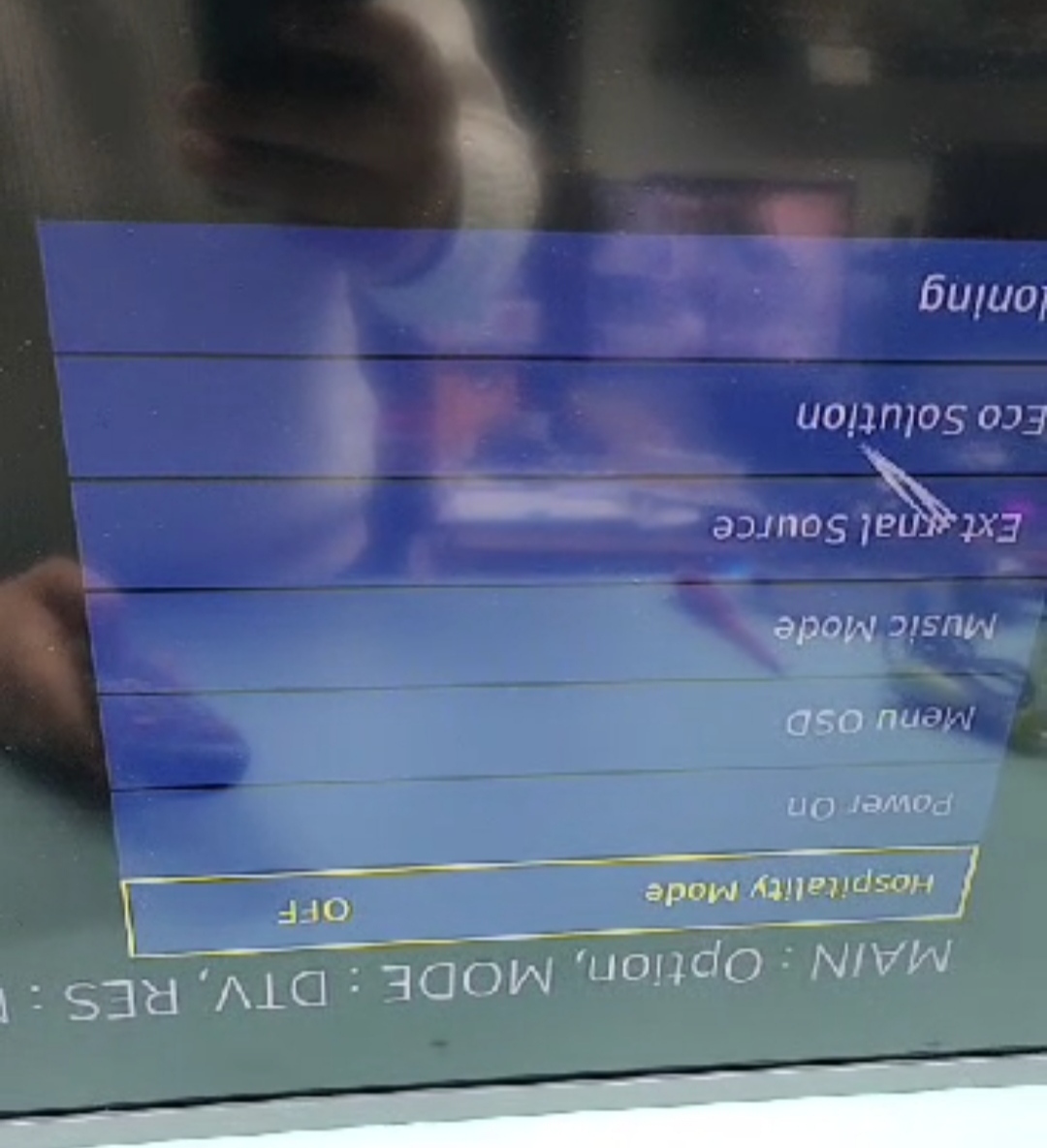

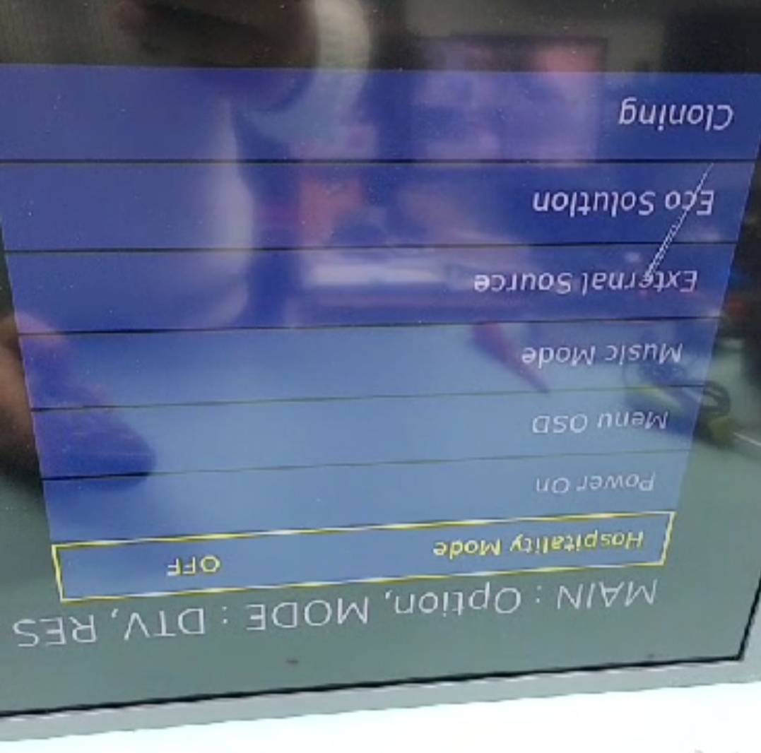

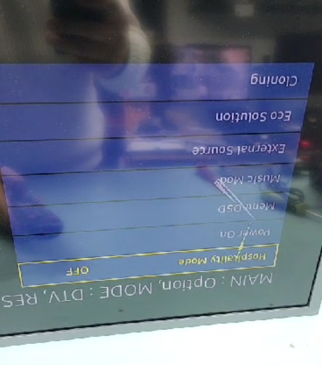

                        Unfortunately, on the screen of the service menu, the errors continue to appear. Is it a sign of panel failure?
                          Post more pics from the menu. You should match the bn94 code. Matching BN41 code can work sometimes but its a hit or miss.
                          • Raulnn
                            • Nov 2022
                            • 103
                            • España
                            The photos
                            • Raulnn
                              • Nov 2022
                              • 103
                              • España
                              If you notice, in the service menu, the strange figures are white or yellow. they are no longer black
