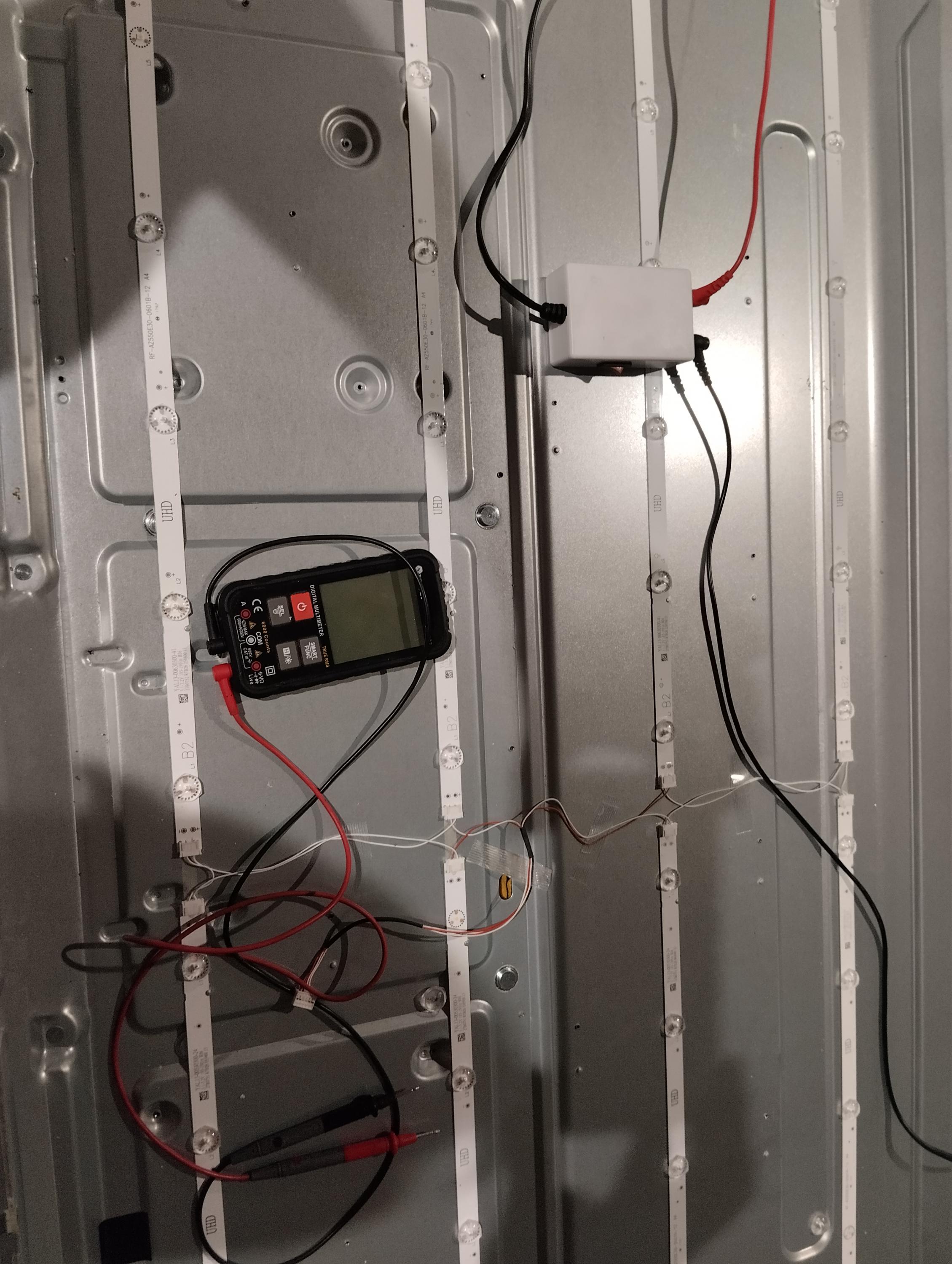

    So bought a led tester and both lines measure the same
    57.4v
    There are 44 leds.

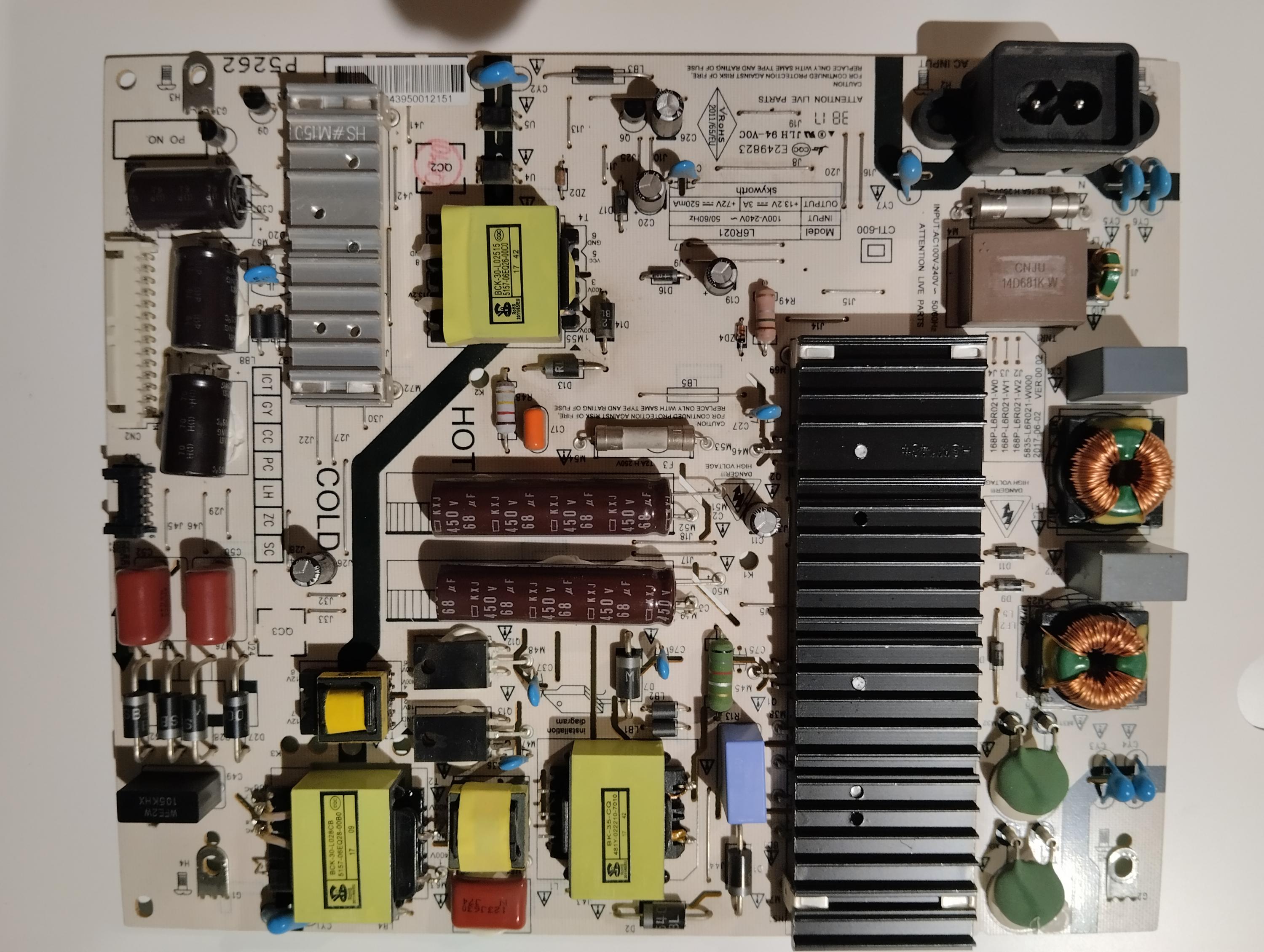

    I have all the correct voltages on the connector .
    But im only getting around 18v on the socket where the leds go on both sides.
    Measure resistance on the connector i get 32 kohms.
    I went to the icdriver i have 13 volts on vcc
    I get the 3. Something whem power on but i have no voltage geting out.(ic is a BD94121F).

      Thanks for the aswer ,but they all lit with backligt tester
      Measure then individualy and they all light the same brightness .
      Am i missing something here?🤔

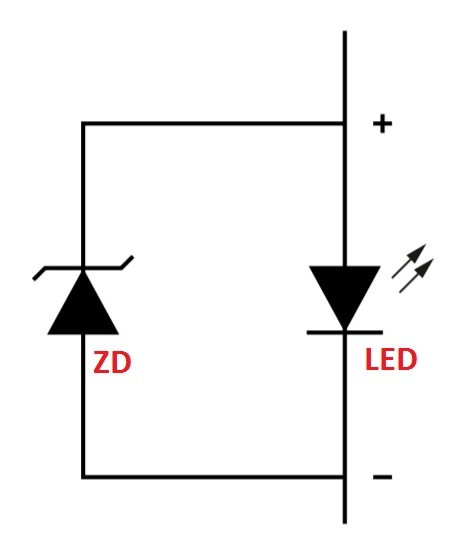

          @handsworth give you the correct answer..
          LG use LED units built in in reserve way protection zener diode. tester cant figure out if they are open or short. you need with yours DMM diode mode test each in reserve way to lit on dim and other way to read diode round 0.650

                Actually i did that test ,the first rime and open the tv and i plug the tv with the diffusrr and screen not connected and they lit up.
                But im no expert and i tought they were good so closed the tv reconnected everything and tested but no backlight again.

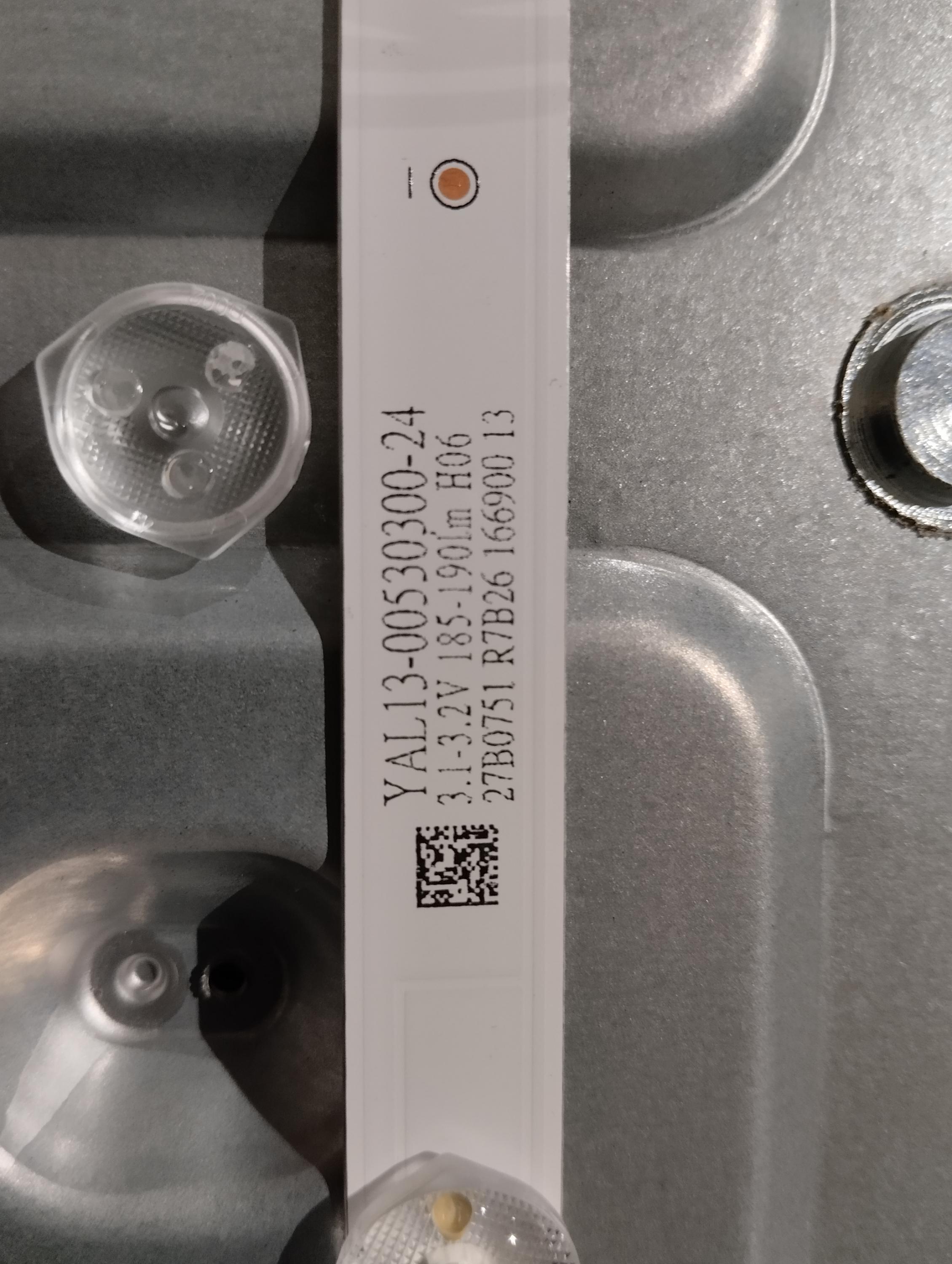

                So i tested the strips again with the tester but i connected both positives from ech string and no more light... On one of the strings
                Opened again and one of the leds was bad.
                Ive ordered new strips,so fingers crossed

                    Reverse way.. see LED with ZD diagram used by LG LED TV

                      Ah ok wlready did it i have 2.4v in foward and nothing on reverse

                        What’s the purpose of having zener diode in parallel with LED?
                        Wired this way would require each diode to have its own driver no??
                        Ahhh. Edit! Reverse polarity protection! Of course!
                        What does a zener diode do extra that a normal LED can’t though seeing as they both serve to protect from reverse polarity?

                          Thanks to all ,problem solved .
                          Leds change and tv works fine.
