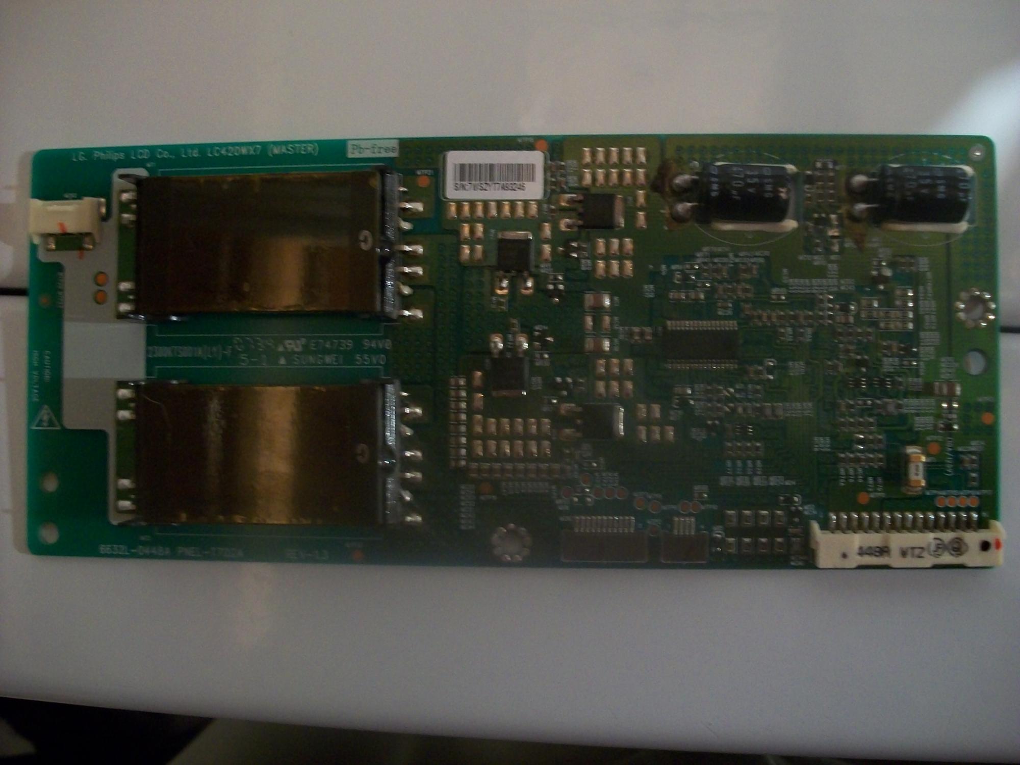

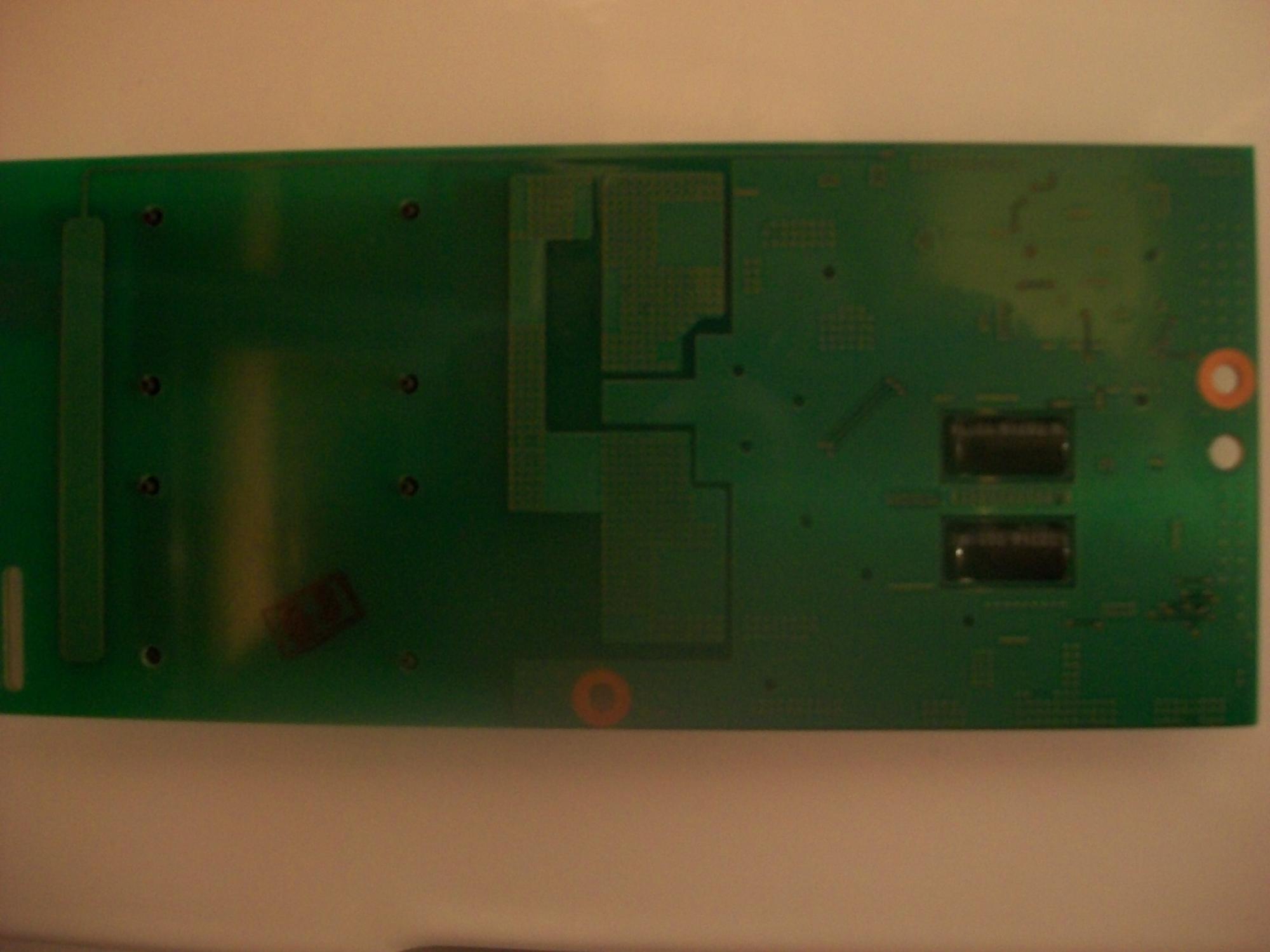

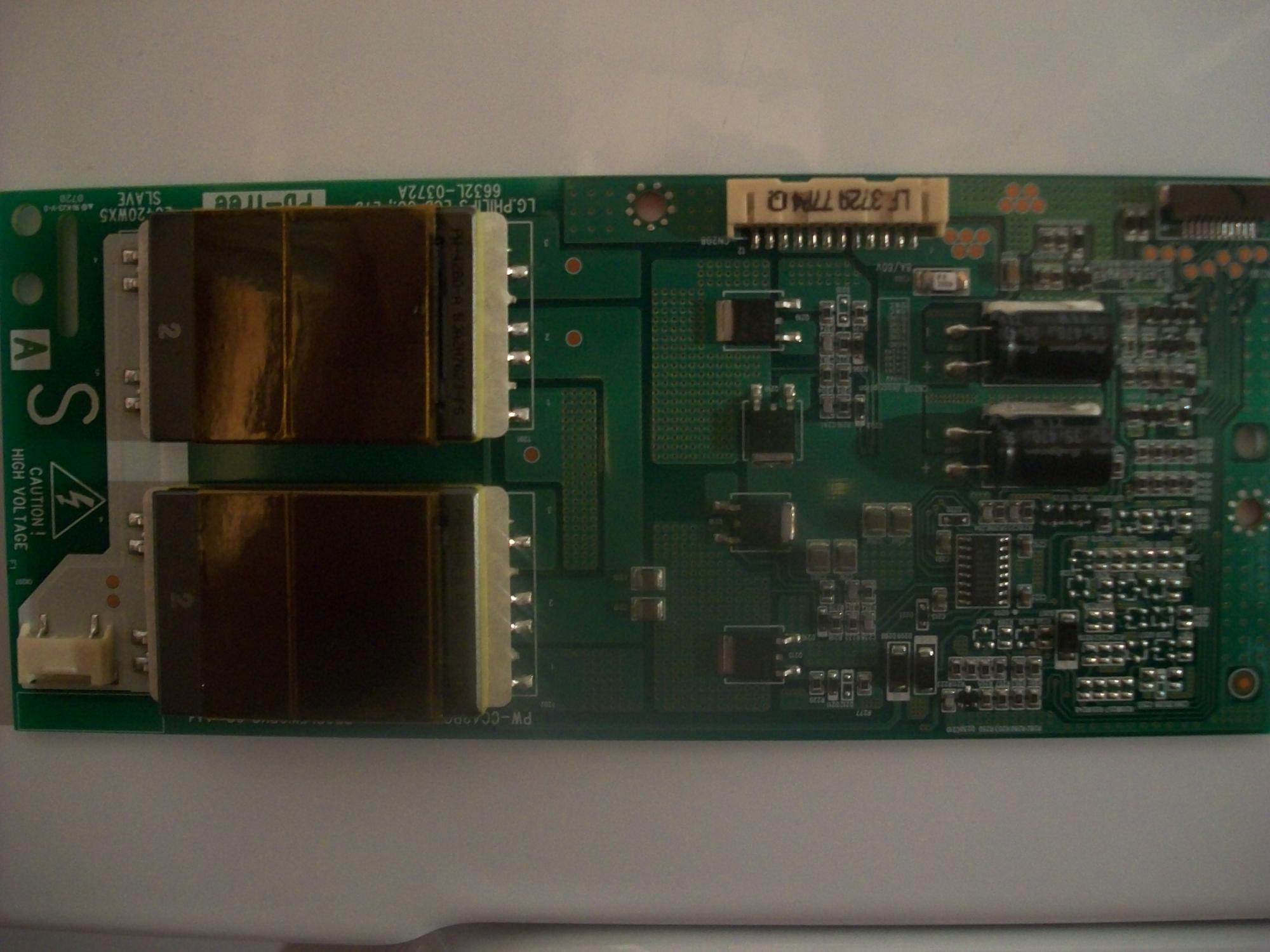

      Attached are some photos that I hope are more helpful. If not, let me know and I'll try again with a different camera.

          Originally posted by Fodder4Thought
          Ah. That sheds some light on things. I hope I don't have to replace the Master board, too, but that's a more desirable outcome than having to give up on the TV entirely.
          Here is some information that ties in with my earlier post.
          The board you received from Shopjimmy was a 6632L-0372A. According to Electronica USA that is for a L42WD22 (among others).
          The original board was a 6632L-0449A. Again, according to Electronica USA that is for a L42WD22YX6 (among others). Note the difference in model numbers.
          According to an eBay auction, the boards must be used in matched pairs. And another eBay auction has the repair kit for $18.
          I would NOT recommend buying a new master to go with your slave; get the correct slave, or repair the one you have.

                    Update:
                    I spoke with ShopJimmy, and they told me that (surprise, surprise) I'd mistakenly ordered by model number, rather than part number. So, I ordered the right part (and will return the other soon), and installed it when it came in the mail.
                    It lives!
                    While I kind of wish I'd gotten the repair kit and fixed the old board, I'm more than satisfied that the replacement board fixed the TV.
                    Thanks for all your help!
