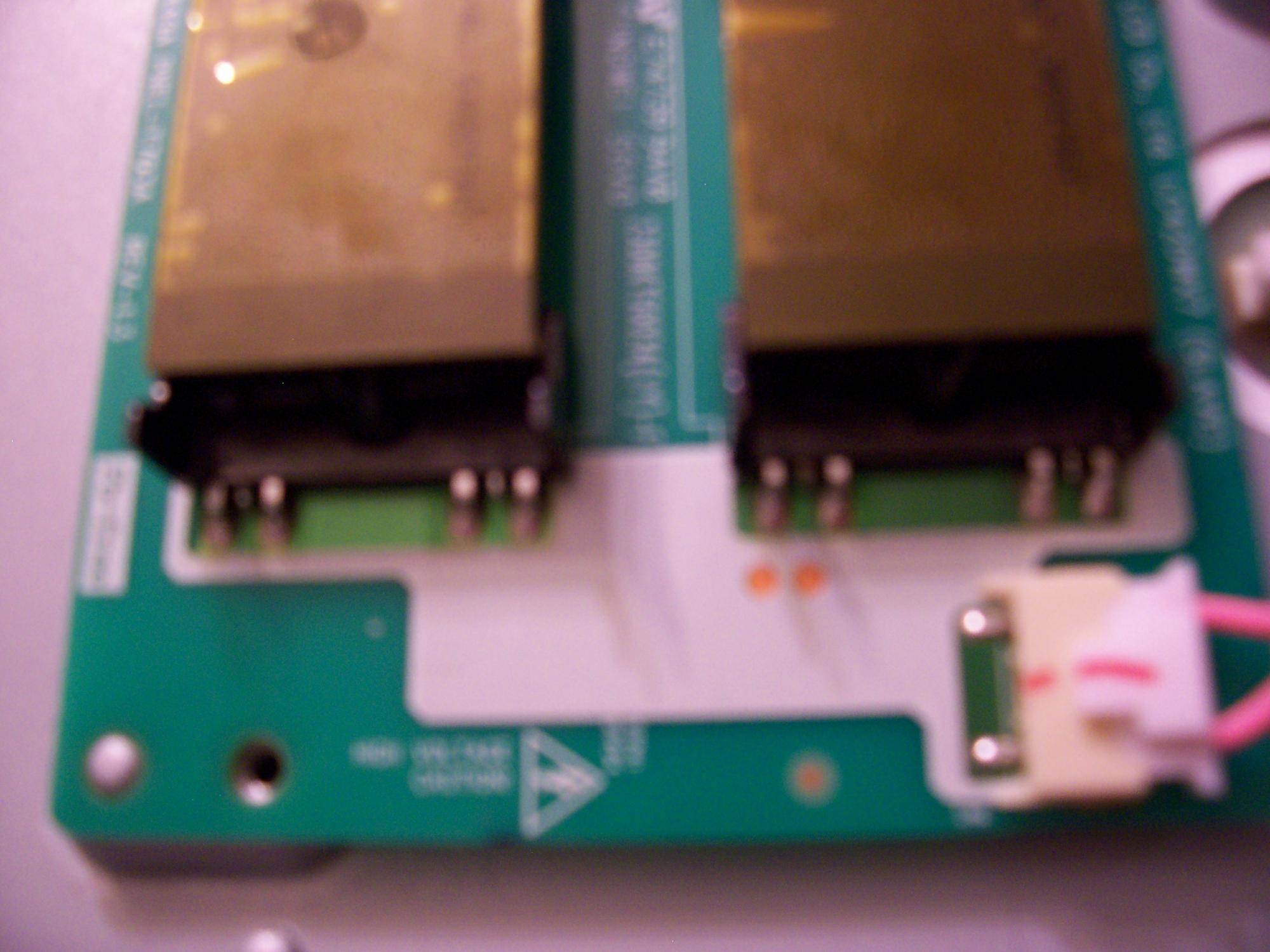

    The transformers being the rather large rectangular objects on the inverter boards pictured in the post above? Sorry, I am ultra noob. =)

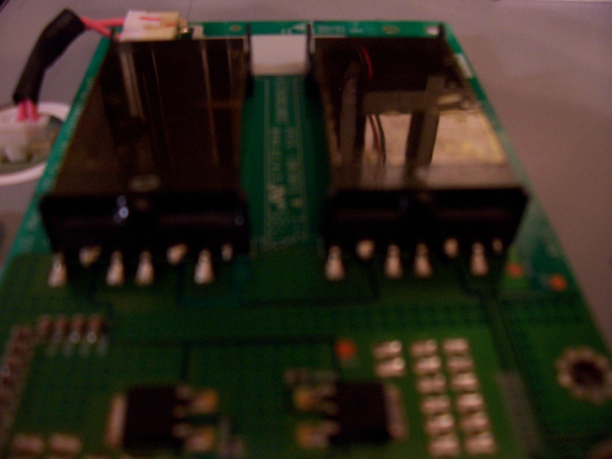

          Ok here's the transformers. Since I can't find a decent (maybe discernable to me would be more apt) schematic. Can someone point out to me which are the Primary and Secondary leads?
          Oh and I unfortunately do not have a ring tester. I want one though! =)

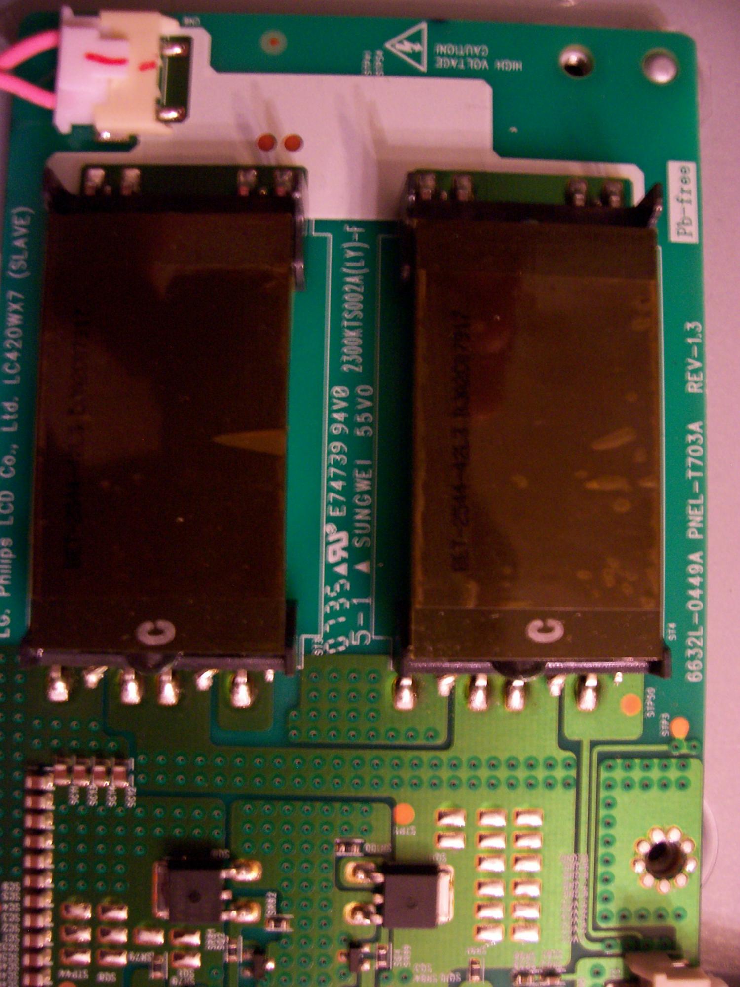

              I was testing the transistors and found 2 bad (no signal) on the Slave Inverter board. They are designated Fairchild 1h28sr FDD 8447L.
              • Doming0
                • Sep 2010
                • 56
                Re: RCA L42WD22 No Picture
                The Master Inverter seems ok from tests run thus far. The slave board has an additional bad zener diod.
                Question.. should I unsolder the transformers in order to test them? Also, how would I go about checking the multi-legged IC's in the middle of both boards?
                Once again, I thank all of you for your help. I'm learning as I go here and hope to one day shed my noob status. =)

                    After additional testing it seems the Pico fuse is shot as well. I will test the IC's this weekend. From everything that seems to be wrong with the Slave Inverter and the amount of parts required to fix, would it be better just to order a new one.
                    The master seems ok but the slave seems fried beyond repair IMO.
                    EDIT: I needed to switch things up from running tests, so I decided to change the caps in an AOC 17" LCD that a friend gave me off the recycle pile.
                    Changed 3 caps, and I'm using it right now to type this. =)

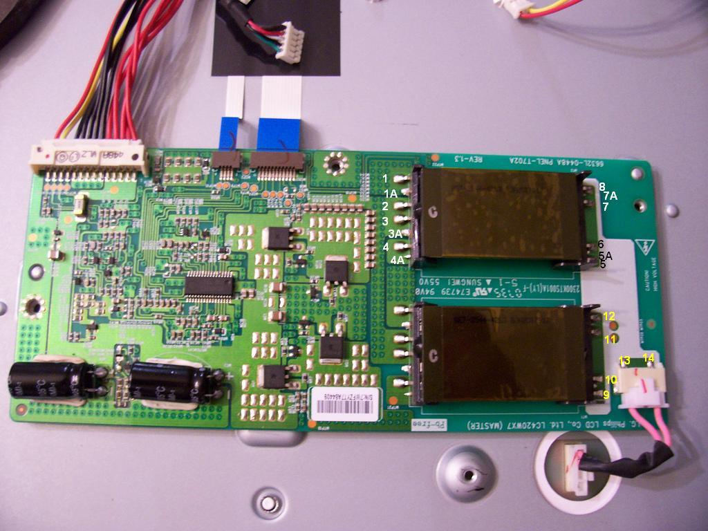

                                    Ok, here we go again. Just finished up following the same diagram as in the url stated.
                                    Attached you will find the testing done for all 4 transformers.

                                      #38
                                      The transformer numbers look consistent, however, the only potentially strange readings are the 16 ohm ones.
                                      This transformer test doesn't find shorted turns. A ring tester will find that.
                                          Unfortunately I do not have a cool ring tester.. would you know where to get one on the cheaper side?
                                          Regarding the 16 ohm readings, they may be strange but they are also consistantly strange across all 4 transformers. I wish I knew what it meant! lol
                                          The numbers are interesting, but I don't see any indication of how you numbered the pins. Further complicating the issue is the lack of clear pictures showing the ends of the transformer. I've marked up one of the pictures and would like some points cleared up. One problem is none of the readings fall into the range I would expect for secondary windings. I would expect the secondaries of the transformers to read in the range of 1K - 2K ohms. 16 ohms implies a much heavier wire than I have seen on an inverter transformer.
                                          For starters, I have marked 'terminals' 1A, 3A, 4A, 5A and 7A. These may be wrap points for the windings, or they might be soldered to the circuit board. The pictures aren't clear enough to be certain. Visually, are they soldered to the circuit board? Resistance readings are not necessary.
                                          On the other end of the board we have more confusion. We have 4 pins on each of two transformers, but only two obvious output pins. What is worse, from the pictures it appears all pins are soldered to a common plane, which makes very little sense. To illustrate, Pin 1 is very obviously soldered to one plane. Pins 2 and 3 are obviously soldered to a different plane. Pin 4 is soldered to a third plane. Also obviously the center two pins of the lower transformer are connected to the center two pins of the upper transformer. It appears likely that the upper left pin of the lower transformer is connected to pin 1 of the upper transformer; certainly all of these planes have features which suggest they handle power - drive to the transformer windings.
                                          Which pins on the right side of the transformers are visually connected together?
                                          The next step is more complex. Set your DMM to the resistance scale. Put one probe on point 14 - one lead of the output connector. What are the resistances to points 5, 6, 7, 8, 9, 10 ,11, 12. If any of these read open (greater than 1 megohm), repeat using point 13 as the reference.
                                          Background - I have seen at least one design that appeared to use a two stage inverter. A high voltage section sat on the power supply, wires ran to transformers mounted at the CCFLs. So, could you post a single - over-all shot of the back of the TV?
