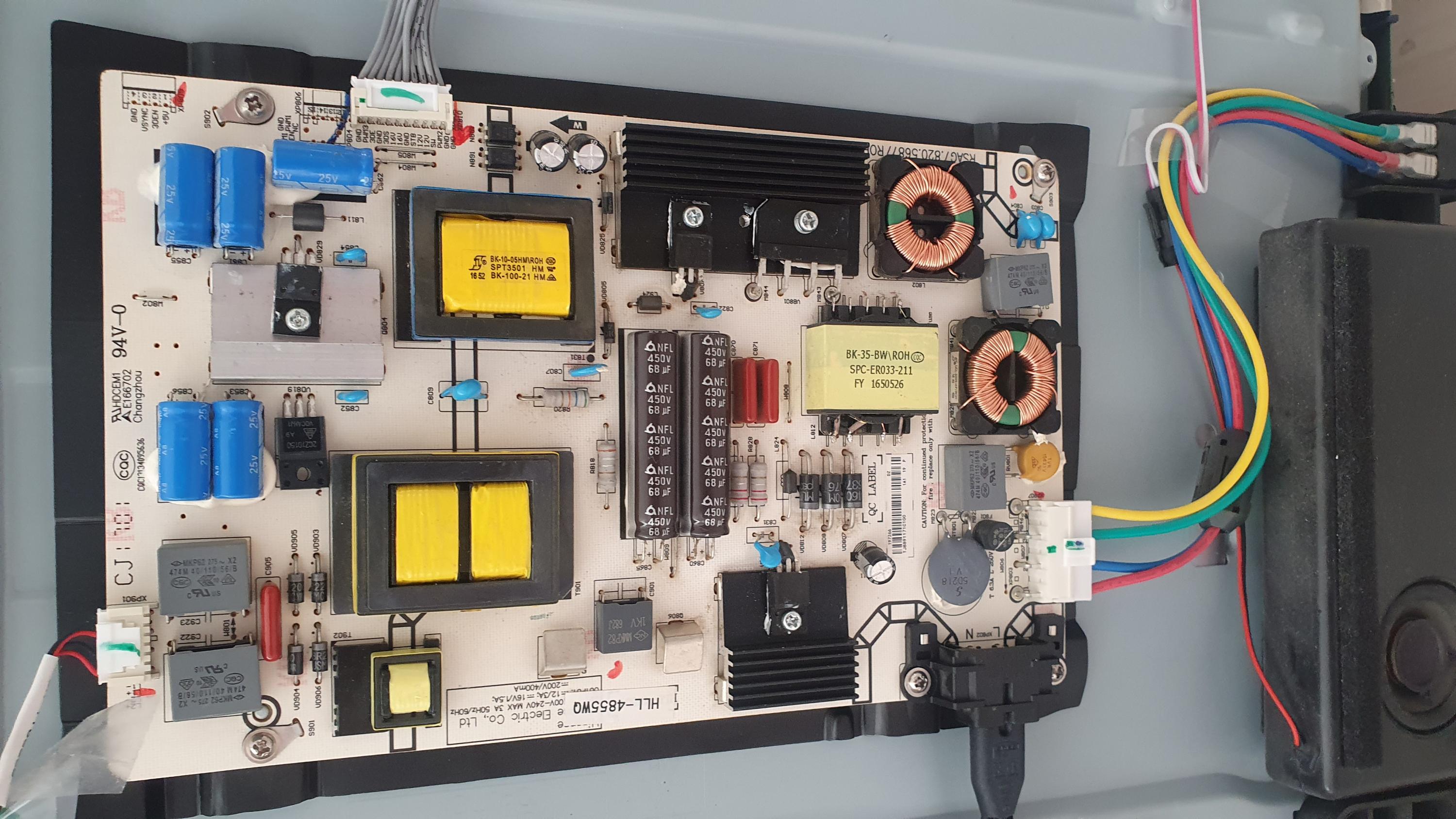

    Hisense rsag7.820.5687 no power no standby light
    Hi!
    I have a power supply and on the TV no standby and no power. Have already installed a replacement power supply but the same problem.
    When I test both power supplies the main capacitors while plugged in, I get 0v.
    What could be the reason for this?

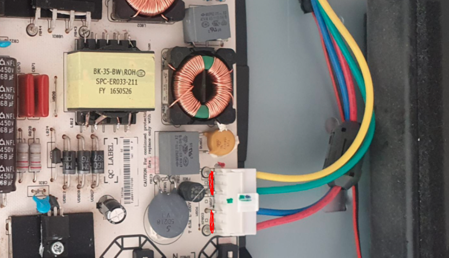

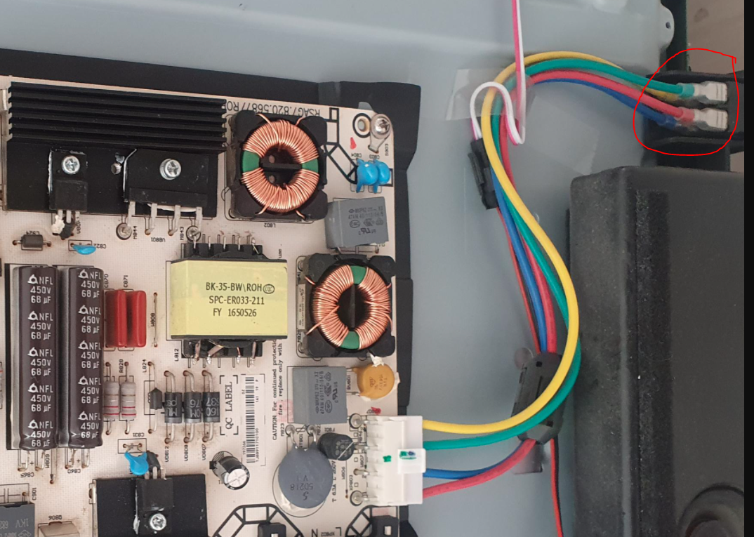

    Re: Hisense rsag7.820.5687 no power no standby light
    Is it a switch? Check if the contacts are jumpered on it.
        Then, when turned on, red with blue and green with yellow should be closed.
              But back original psu and get this voltages
              19.6
              19.6
              0
              0
              12.15
              12.15
              0
              0.004
              0
              0
              Standby at 0.004 way to low. There is a buzzing sound on psu. Does this correlate with standby voltage?
              Values are same connected or not with Mainboard.
                One easy thing to check when powerboard is noisy, is check all the solder joints and reflow any that look suspect, being careful not to bridge anything, some can really be hard to detect, a wiggle of the joint can detect a bad solder joint too, examples of bad joints: https://www.google.com/search?q=bad+...ih=607&dpr=1.5

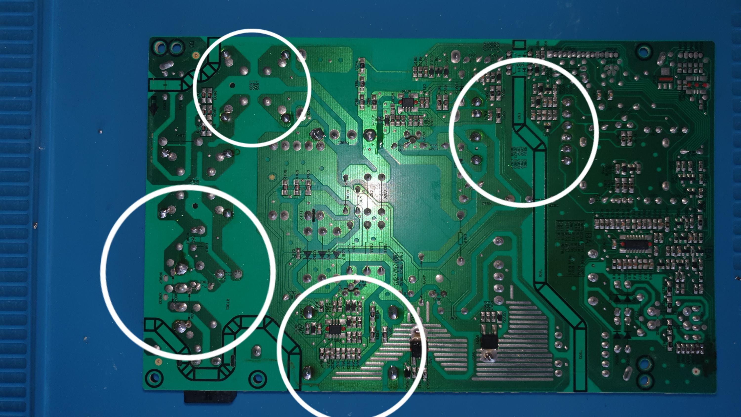

                        Resoldering some joints fixed it. But there is still a loud buzzing sound while tv starts.
                        And even if its turned off, there is a buzzing sound too.
                        What can it be?

                          first time i hear Hisense get cold / crack soldering joint... any way... plug the tv out from wall... and play with its Switch on / off how much you can... it could be the switch its contact not in tact so there are sparking.
                          for further show us the place you re soldered.
                            Uploaded and marked resoldered Pins.
                            Turning on off switch doesnt fix buzzing sound
