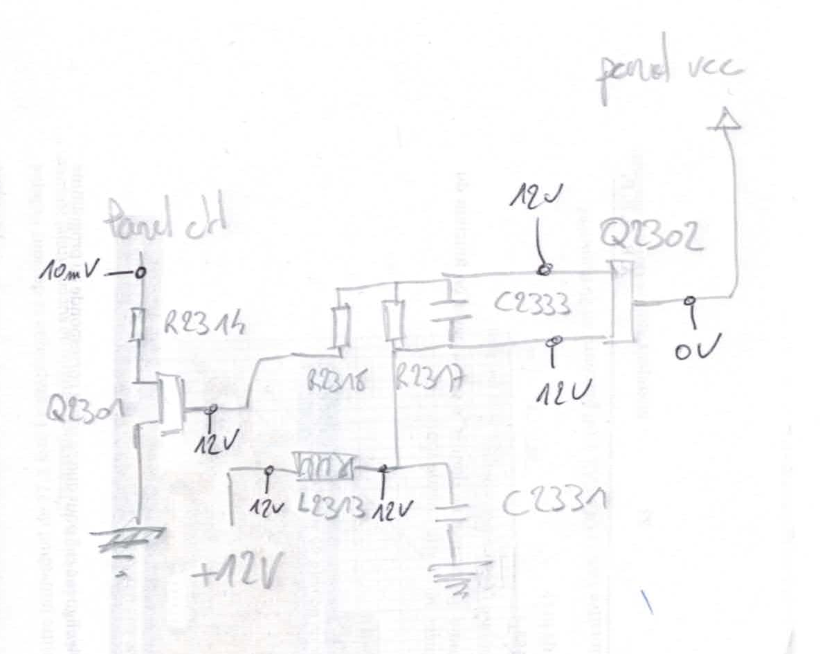

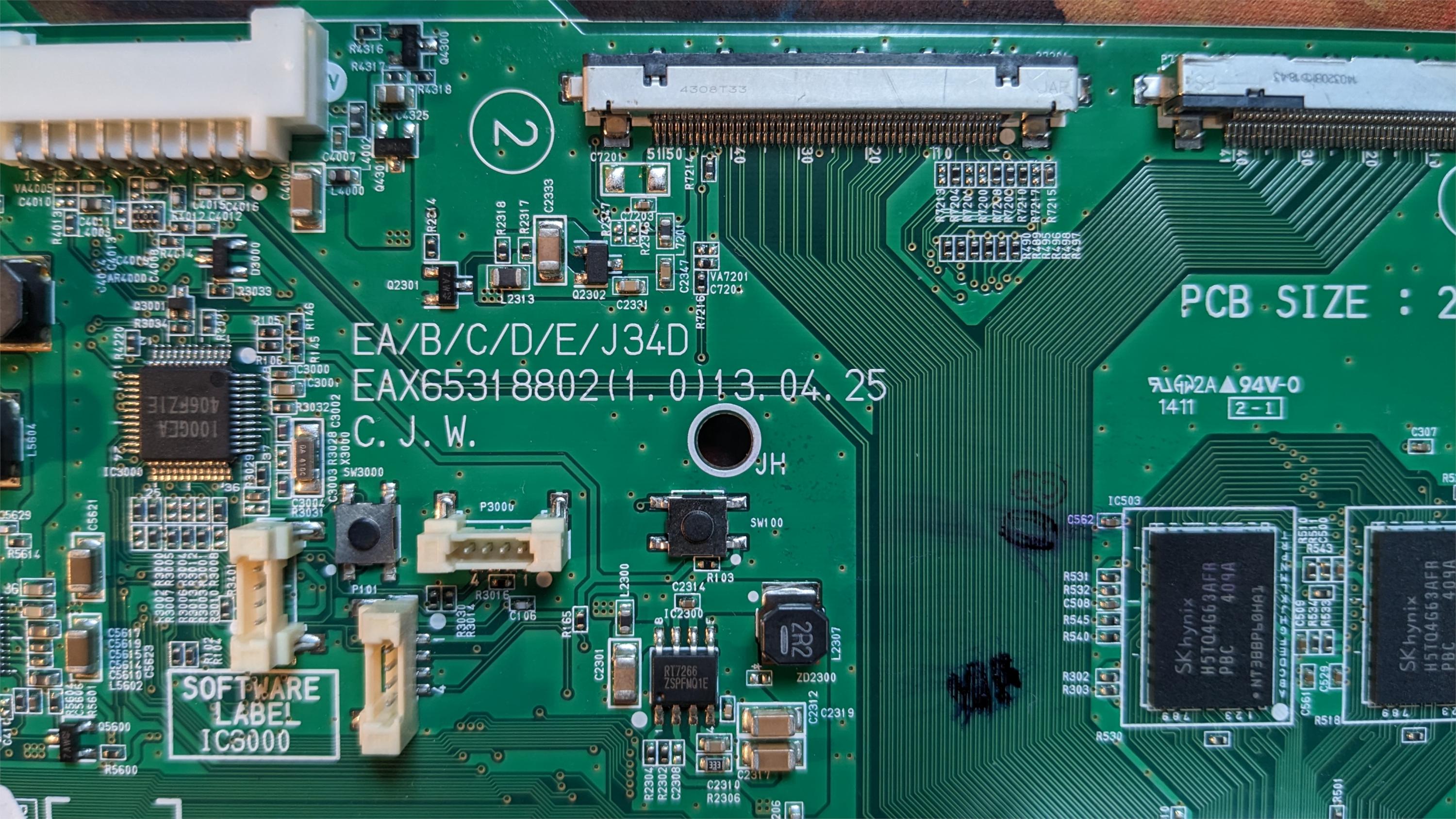

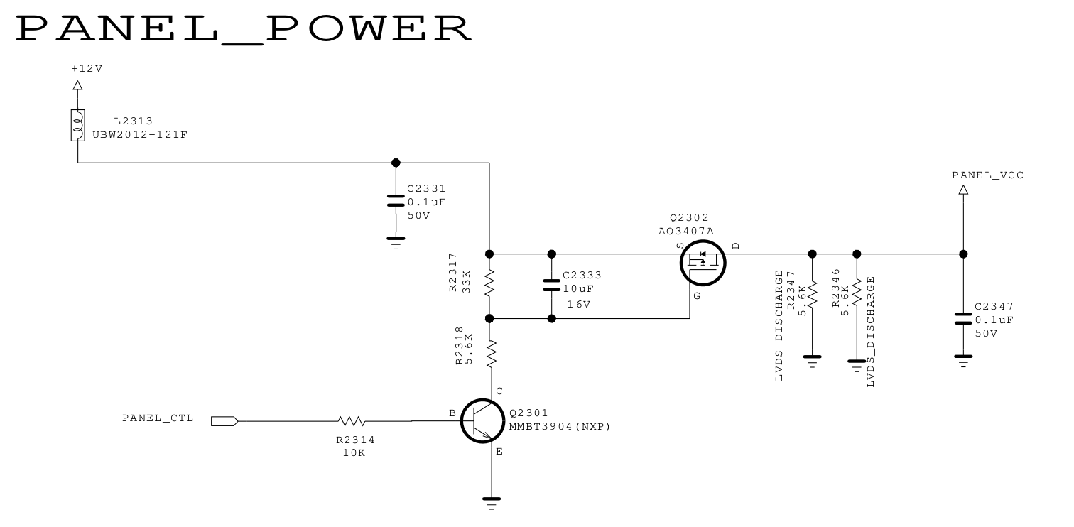

        ok guys. so here are a closed picture of the panel vcc circuit (this is a spare card have, R7216 is still there).
        Please also find attached my measurements. I guess all is correct, but PANEL_CTL is near 0v. PANEL_CTL is PIN4 of MICOM.
        I also put the schematics, in case you dont have it.
        I dont know whether panel_ctl should be up after / before inv_ctl. But anyway, both are near 0v.

          #44
          Re: LG 55EA970V OLED / black screen
          check C2347

                #47
                Originally posted by Diah
                check C2347
                @Diah : With digital multimeter in capacitor mode, I measure 0.190 uF for C2347 on all 3 MB I have.
                (MB totally unplugged, no power). Obviously I didnt unsolder the Capacitor from board.
                I ve also test in ohm mode, value goes from 0 to ~4Mohms, so the capacitor seems to charge then block current, as (I think) it is supposed to.

                            Now I'm wondering what the purpose of little headers P3000 P3001 P101 is. All of three have 4 pins and I can see in schematics that for P101 at least, there is some UART routing with GND, +3.5, RX and TX. That sounds familiar to me. I will try to plug a RS232 console cable on that, and see if something comes out at 9600bps. There are some mentions of RS232 tbshoot in manual of a quite similar LG board, however my MB does not have an obvious RS232 connector (DB9 for example).
                            Are you guys aware of troubleshooting this way ?
