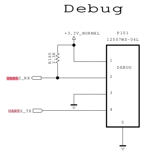

        if you see only garbage there is a possibility that there is a level shifter on board, check if there is a chip called something-232 or whatever that is connected to the serial port, check its datasheet, possibly it is a regular rs232

              The PIN is just labelled GPIO23 / UART2 directly from LG chip "IC100
              LG1154D_H13D", then this little circuit (see attached). So I guess it is 3.3v TTL and my usb-serial should be fine. Maybe the chip enters debug state only with the debug pin to UP. Dunno.

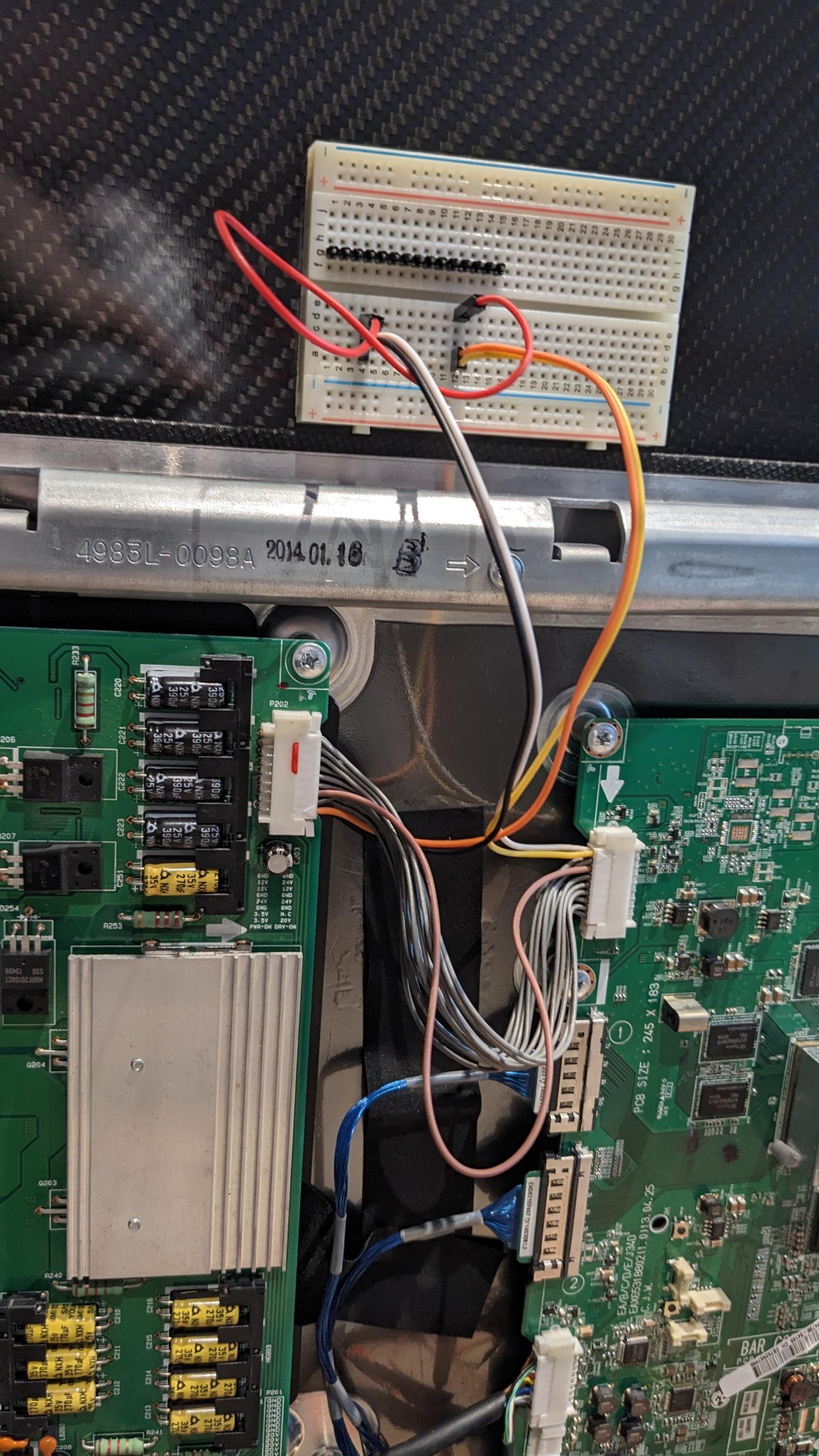

              I've made some tests with PWRON connected to DRVON on PSU side, connected to DRVON on MB side, and connected to both (see picture). But nothing, still no 12v output on LVDS on MB side. However I still can measure 12v on some transistors (as earlier tests).
              I've checked the ribbon that goes from PSU to MB, it is fine. And regarding socket on PSU / MB I've also tested as far as I can (some pins are difficult to spot), and that seems fine. and remember I've checked with 2 different PSU, 3 MB and 2 TCON :-)

                Re: LG 55EA970V OLED / black screen
                did you remember i asked you to do all test after we move load from MB... disconnecting wifi module & Bluetooth module at IR section... & speakers out

                  Wifi bluetooth module is disconnected
                  As well as camera module
