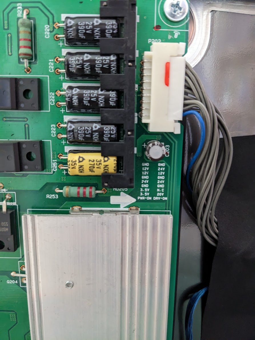

    • power supply out voltage is fine at 3.5v 12v and 24v pins on the main P202 connector (picture attached)
    • when powered on by remote I can hear the relay "click", the LG logo lights on, then the PWR_ON pin switch to 3.5v at P202 connector (picture attached), but no screen display (and no sound)
    • the DRV_ON pin remains at 0, so there is no 20 volts at the bottom connector (P201)

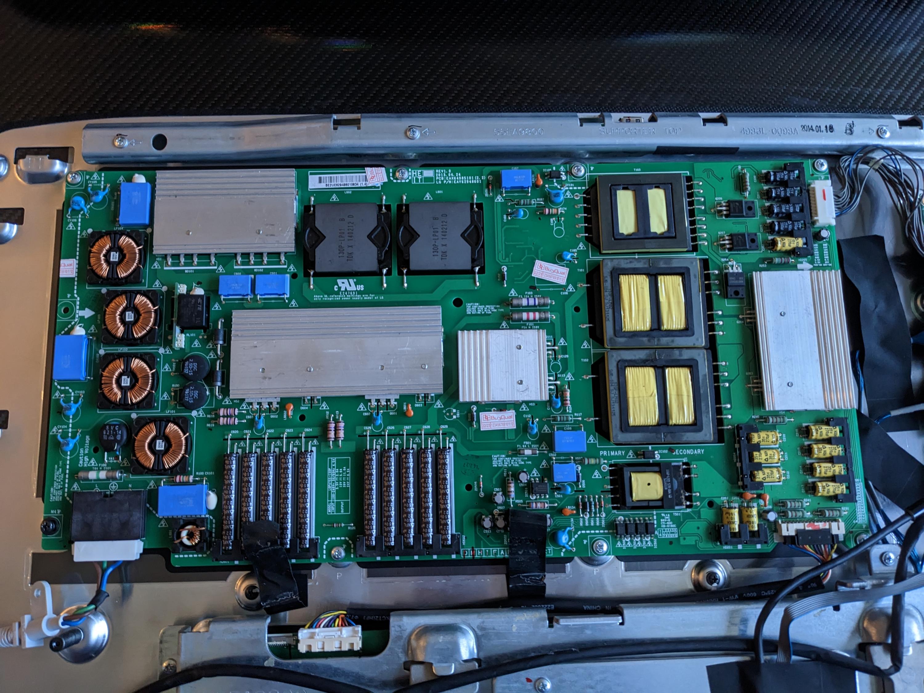

    I had chance to also get another power supply board, so I've changed it too ... with the very same results.
    I've followed part of the SMPS test document, but I can understand what component can be faulty. Is it possible that as the TCON remains unpowered, the main board considered it as faulty and turned into a "fail" state, refusing to start ?

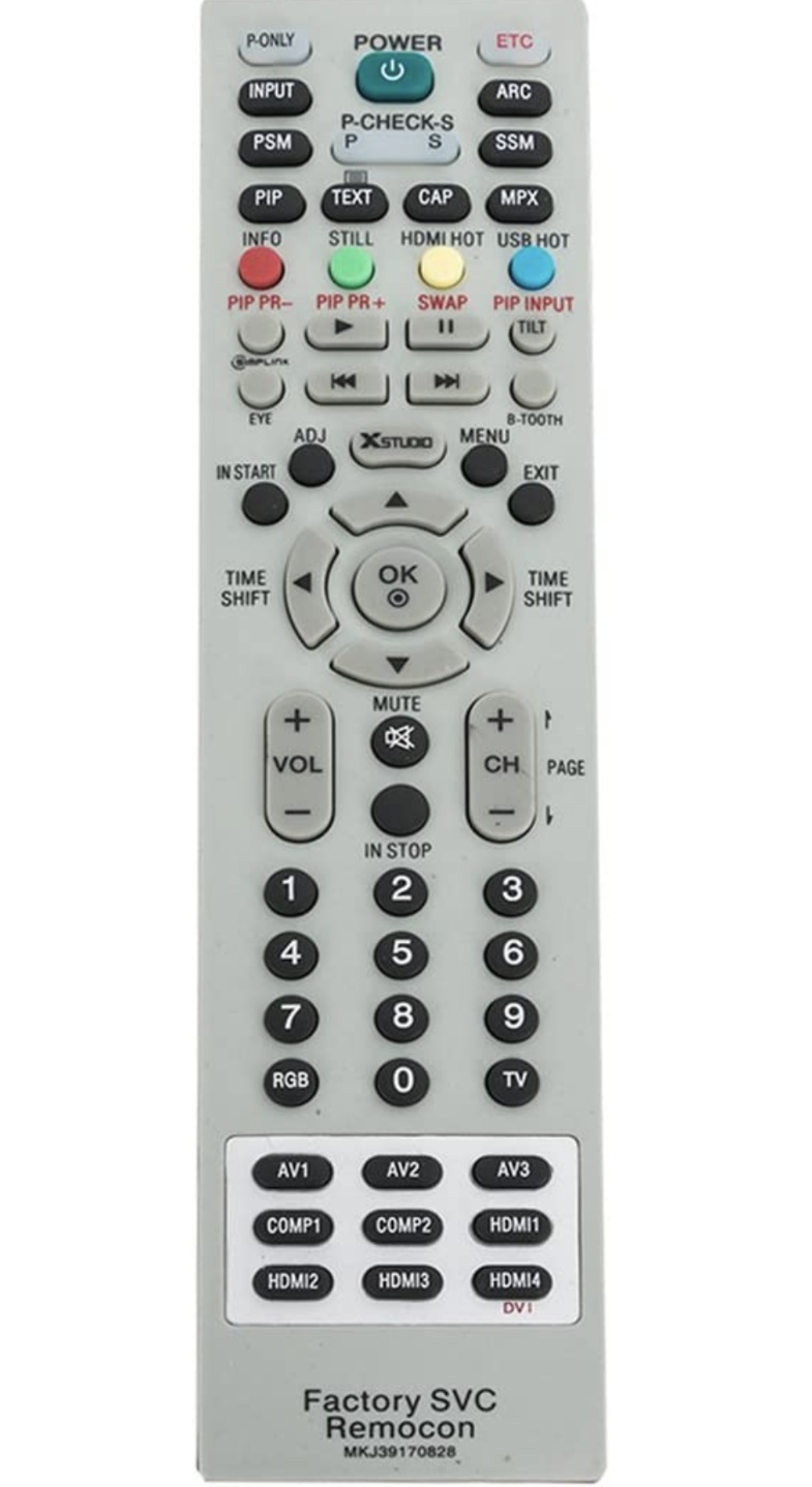

              RC seems fine as led blinks with every button press
              And the TV powers on when using power only and power on buttons. However it doesn't seem to accept any other command.
              Mine is VINABTY MKJ39170828 (image attached)

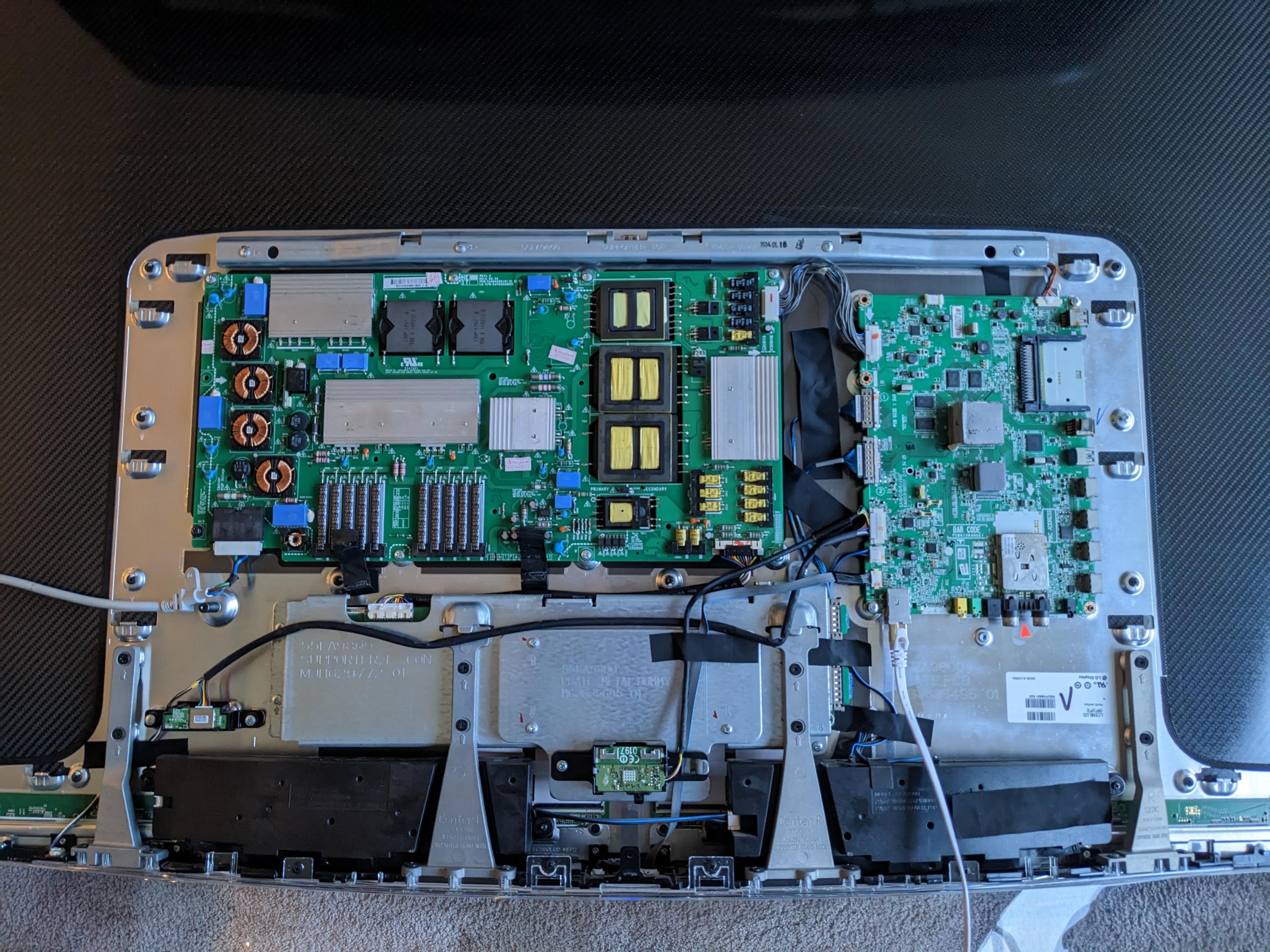

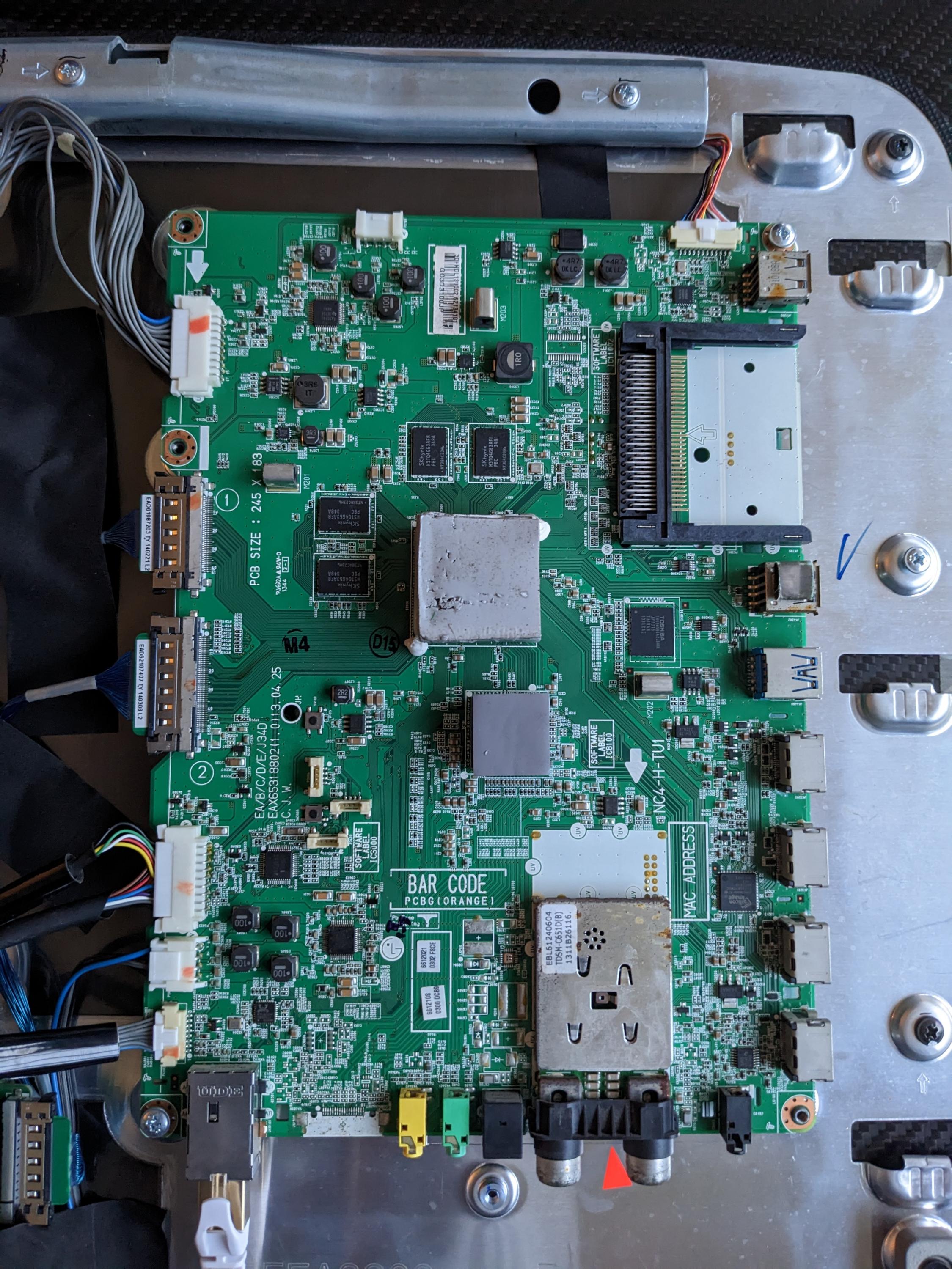

                Here are the pictures, hope you can see clearly the details.
                I try to expose the ribbons so as you can figure what go where.
                This mb is the used one (some rust on connectors), but mine is fine.
                The white ribbon at the bottom of mb is my rj45 to switch

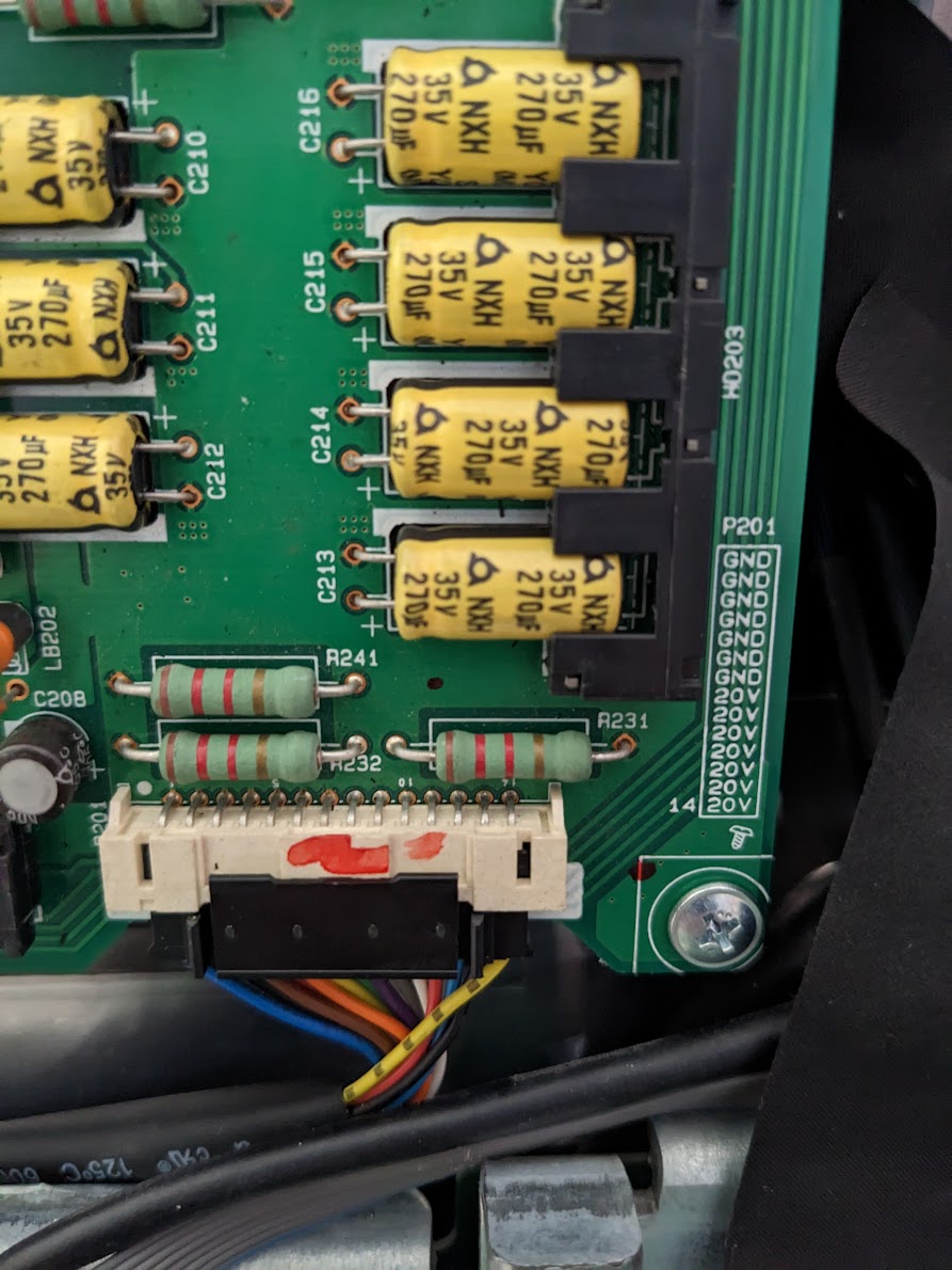

                  I've just made the test for the pwron+drvon @3.5
                  I measure 19.9v at the p201 connector (tcon power supply). So I guess my PS is okay.
