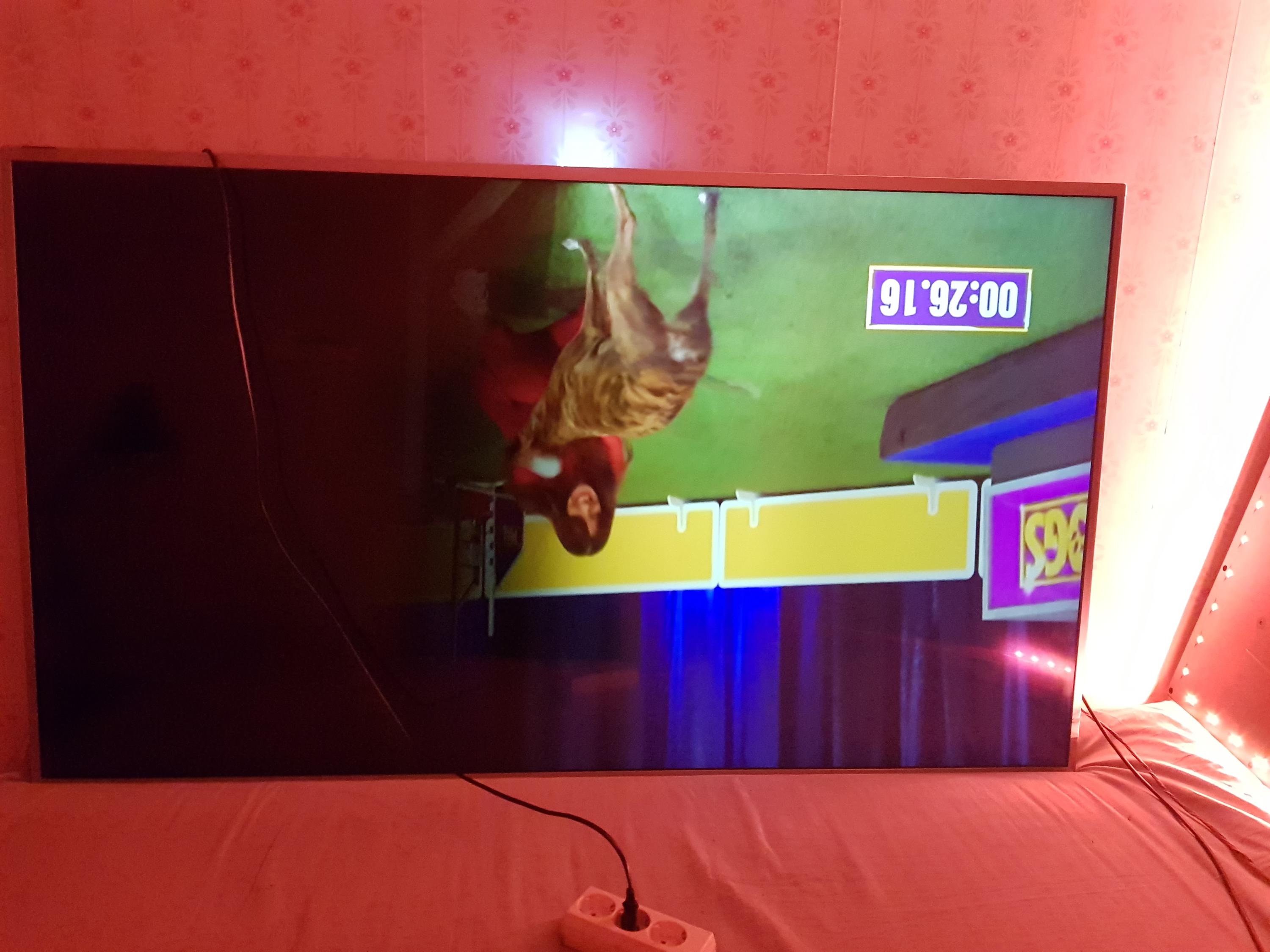

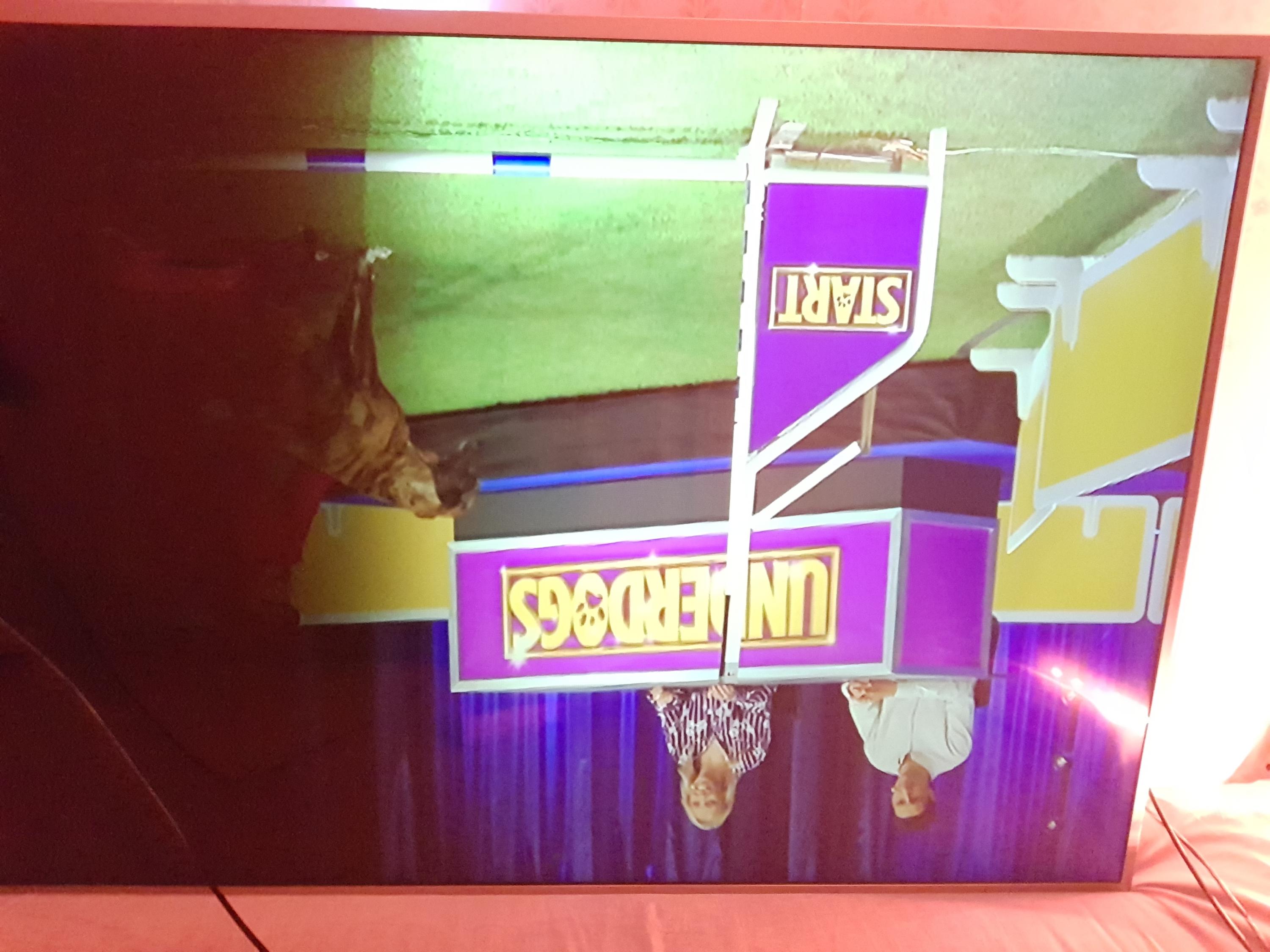

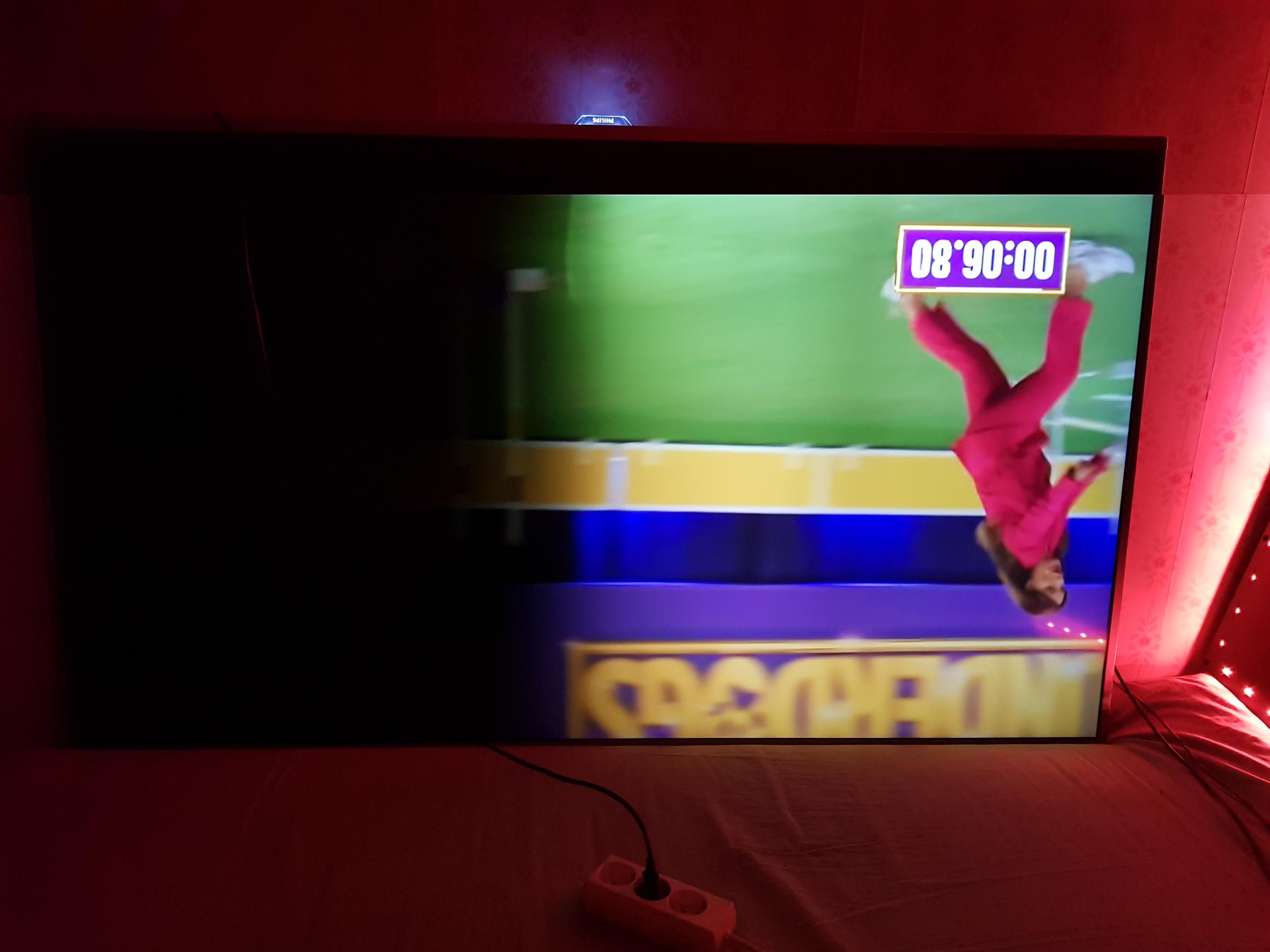

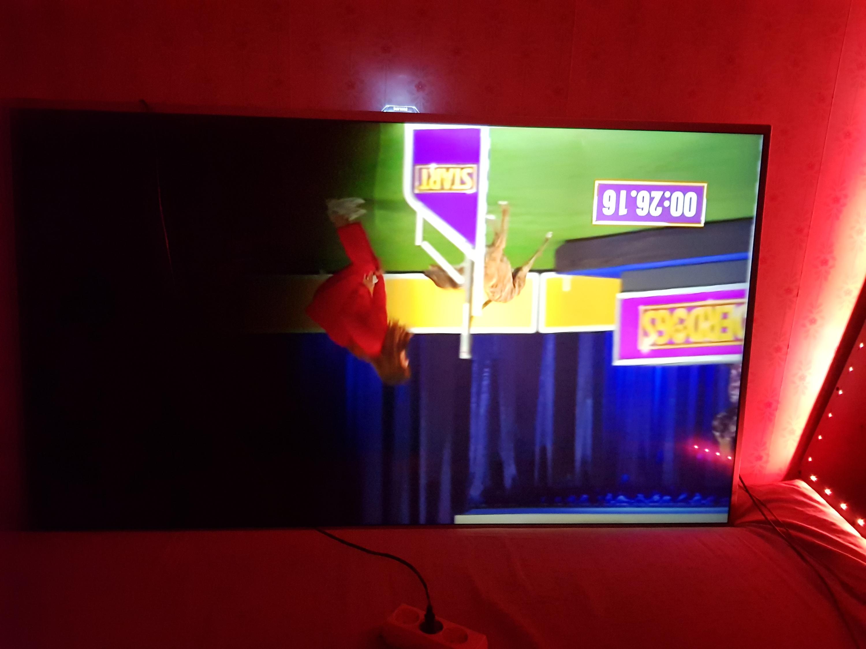

          #44
          Re: Philps QLED Q60B Model:QE65Q60BAU
          ok here an update of the situation with some pictures
          tv looks to work as it should with only half screen and sound what do you think?

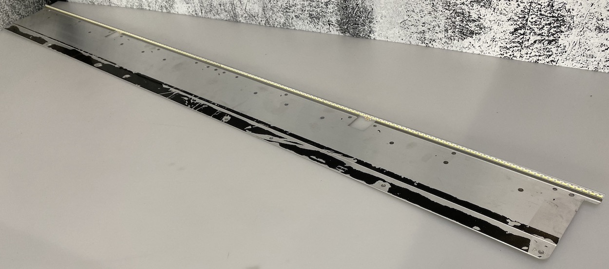

                #47

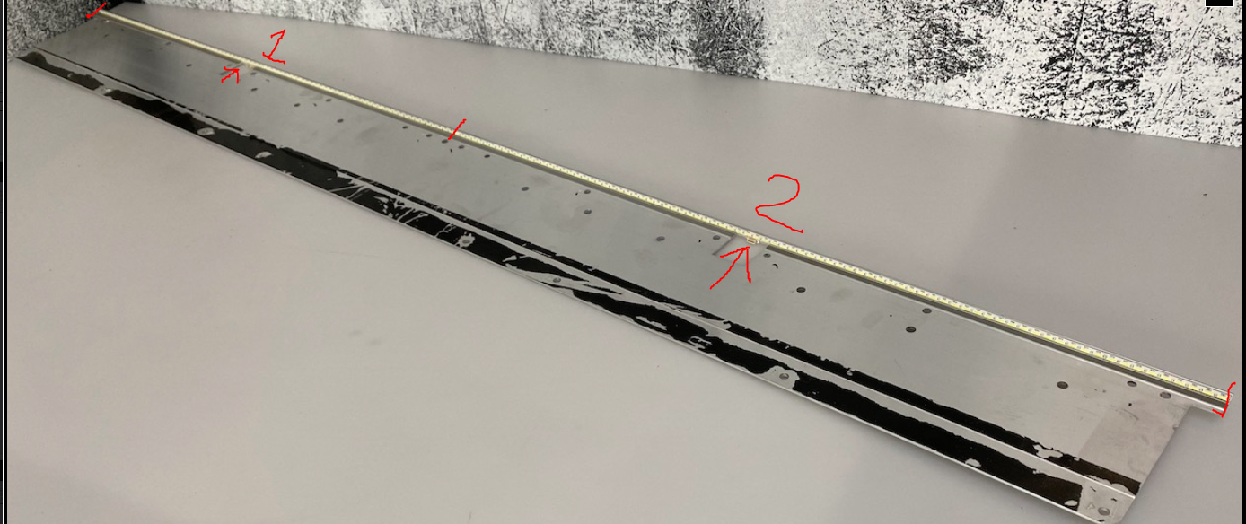

                One of the two bars does not light up.
                https://aliexpress.com/item/4001094271260.html?
                • Davi.p
                  Hobbist Tech
                  • Sep 2009
                  • 4514
                  • Italy - Milan
                  #48
                  Self restoring software? Never heard.. i'm thinking about power supply problems or humidity problems..
                  • Diah
                    • Feb 2013
                    • 6494
                    #49
                    are you blind???? my post No #2 before your fantasy come on...
                    before he had BL issue on right side.... now the total right side off. so no more shutdown... be happy you get this... with out software playing... repair BL only
                    he have separated left & right

                      #50
                      so it's just two bars in this tv? maybe better to buy two bars in case something happens ahead
                      Once again, I want to thank you ,Davi.p,Diah,nomoresonys and Maalobs for the amazing help I have received : solution plus the links. No this thread is not over yet except I have to wait until I get the parts from Uncle Xaopin to show the result meanwhile I invite you to another thread that has not received as much support but is somewhat more kneey to solve :https://www.badcaps.net/forum/showth...light=bohaboha You are all very warmly welcome to contribute your skills because they are needed
                      • lotas
                        • Jan 2016
                        • 4802
                        • Russia
                        #51
                        Yes 2 led

                            #53
                            The main problem is waiting for you ahead, it is to remove the "65" panel itself without damaging it and not tearing the cables that go from the slats to the glass....
                            • lotas
                              • Jan 2016
                              • 4802
                              • Russia
                              #54
                              Originally posted by bohaboha
                              thank you very much but that seller is selling by lot of 10 or is it possible for 2p
                              Look for their number "E-LED-CL-650-084-V2", you will find more, I posted a link to see what they are.

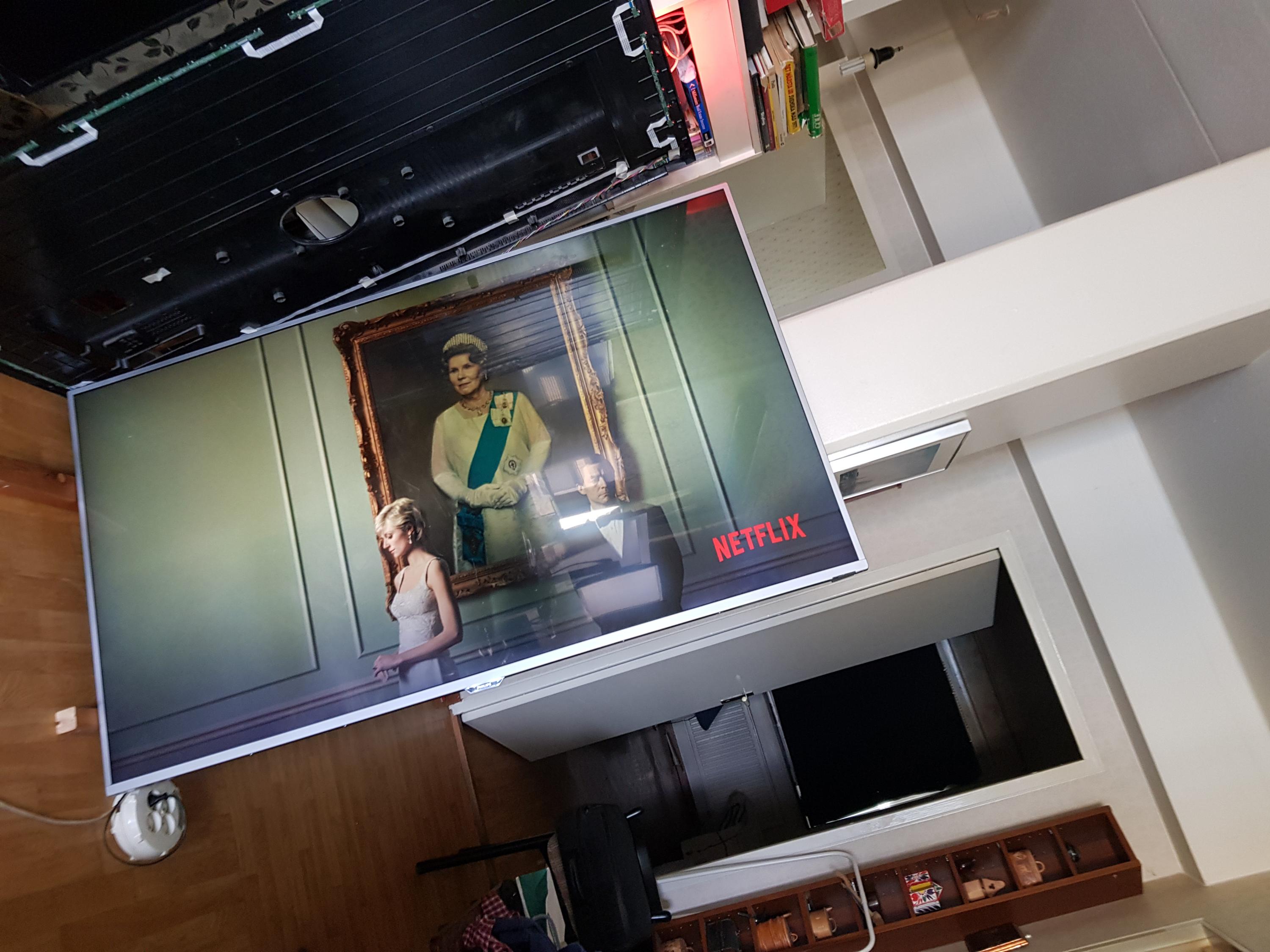

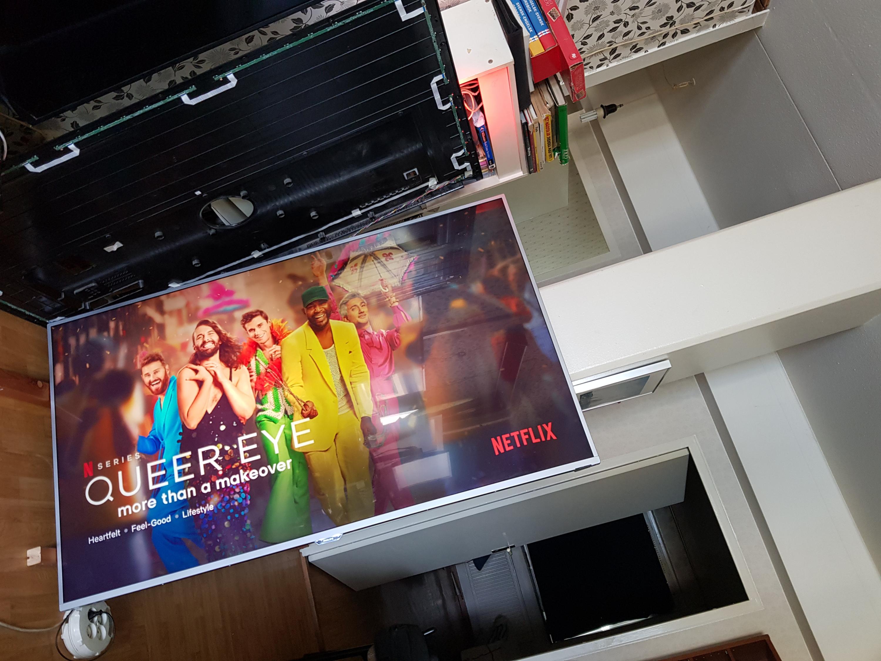

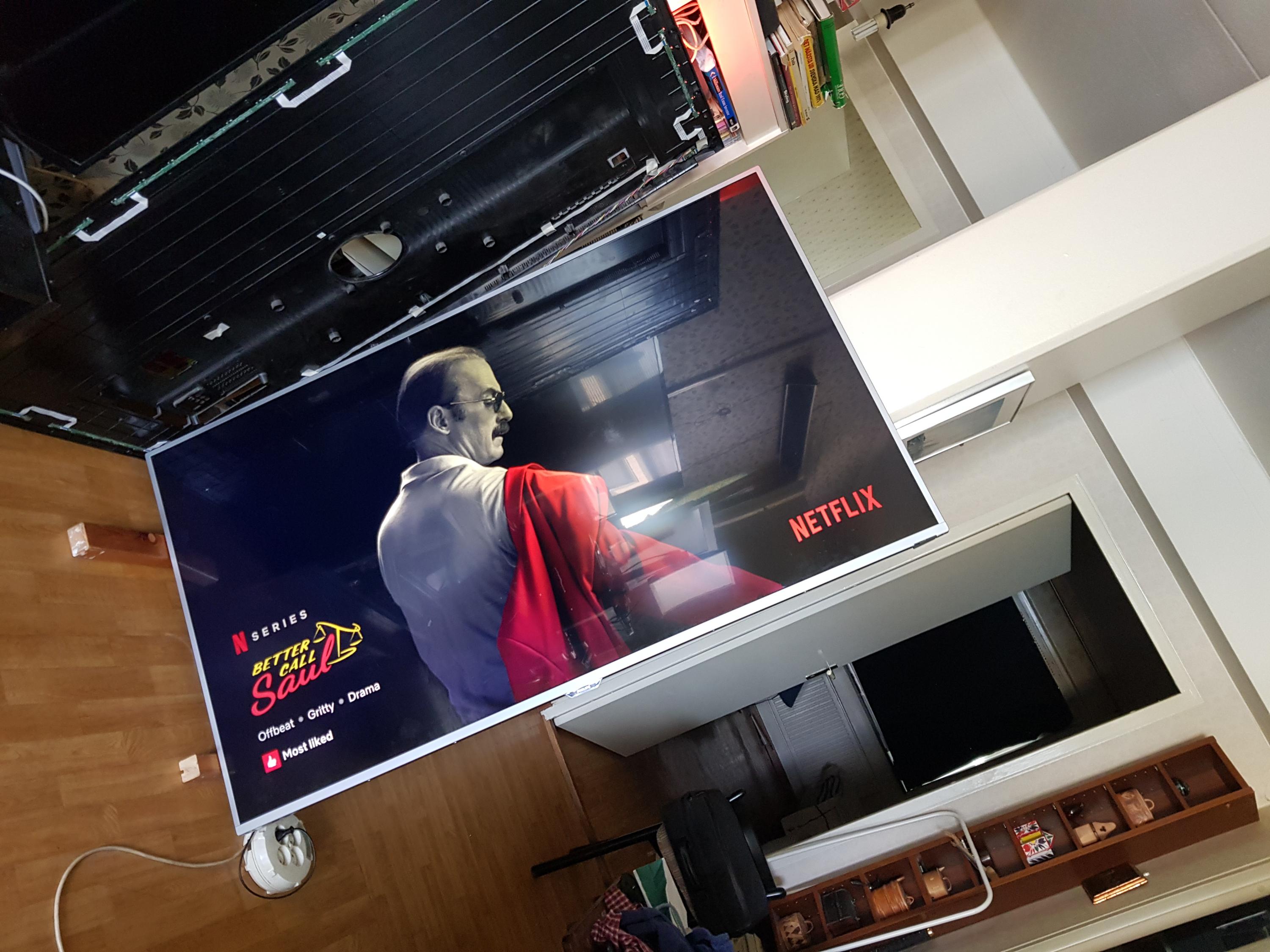

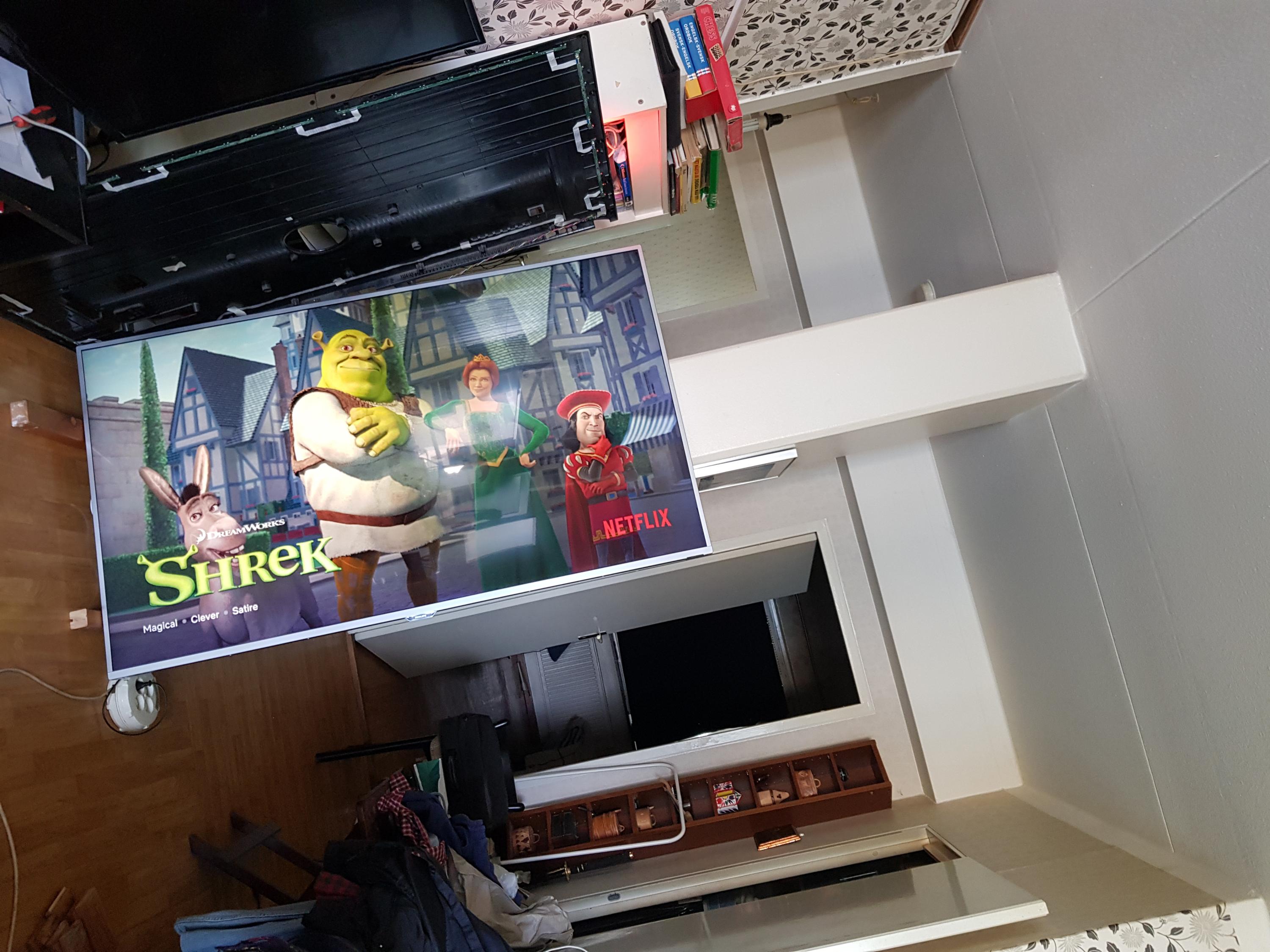

                                      Hi everyone now the backlight kit has arrived and the TV is repaired and ready first I want to thank everyone who helped with this repair. it wasn't easy to fix even though I did everything myself. there were some strange things : Polarising film the thickest is cracked from the bottom edge and it has small firing points because it sat directly on the joints I have not been able to do anything because I have no replacement
                                      but i think if i lower the strength of the backlights it will help. and as soon as I find an equally big TV then I fix it- again thanks for your help
                                      This is the result
                                      • lotas
                                        • Jan 2016
                                        • 4802
                                        • Russia
                                        #59
                                        Everything is fine!
                                        • Diah
                                          • Feb 2013
                                          • 6494
                                          #60
                                          bring down the LED BL setting less than 50%.. so you will not facing this trouble again
