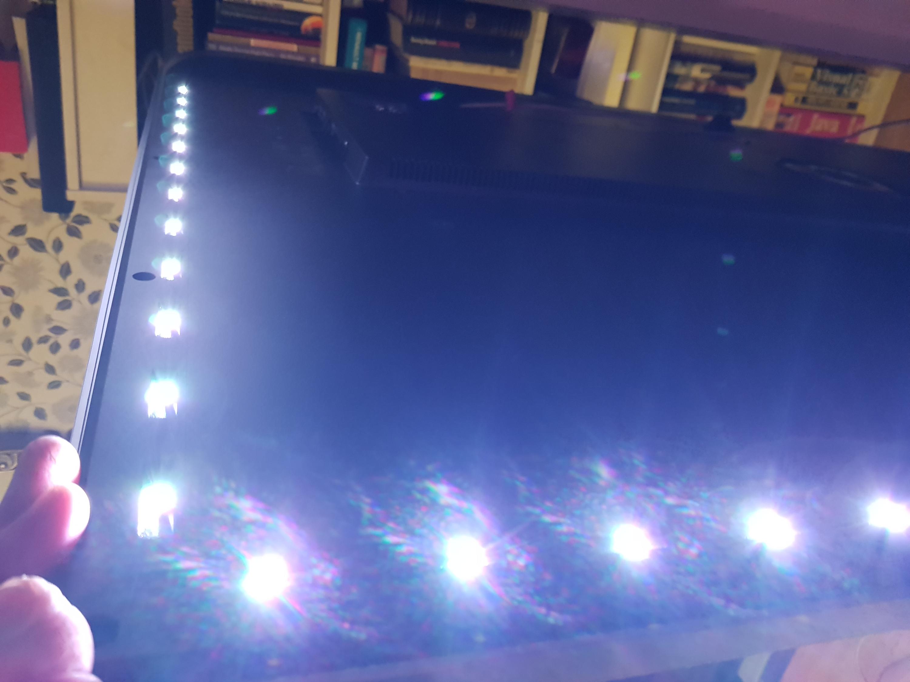

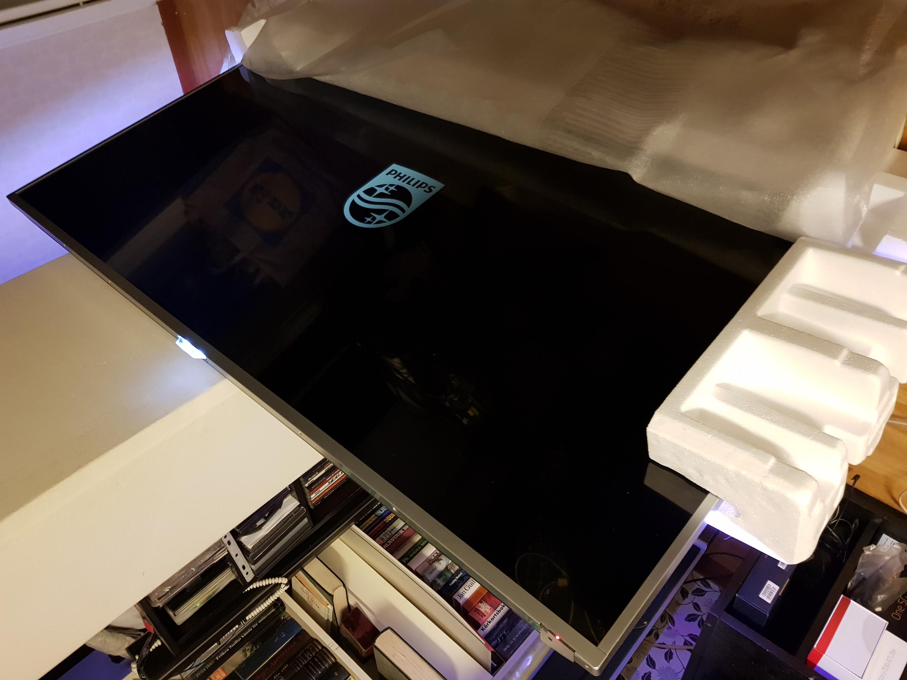

    hi all what do you guys think about these symptoms ? so soon as i plug the cord it shows the logon nonstop like in a loop .tries to turn it off with the remote but it does not respond i have to remove the cord to turn it off. a big heavy new TV for which I seek advice from you before I open it.found in the environment cabin in original package with remote control and electric cord maybe transport damage it looks to be unused.
    the screen looks to be ok or what do you guys think?
    Any advice or suggestions are greatly appreciated.

    Re: Philps QLED Q60B Model:QE65Q60BAU
    yours photo its look there are issue at LED BL so some of logo dim
    post stable focused video on the front screen at start up
      Hi is it possible to post a video here? hope these are better and you can see that it shines brightly behind
        post it as zip but small zise

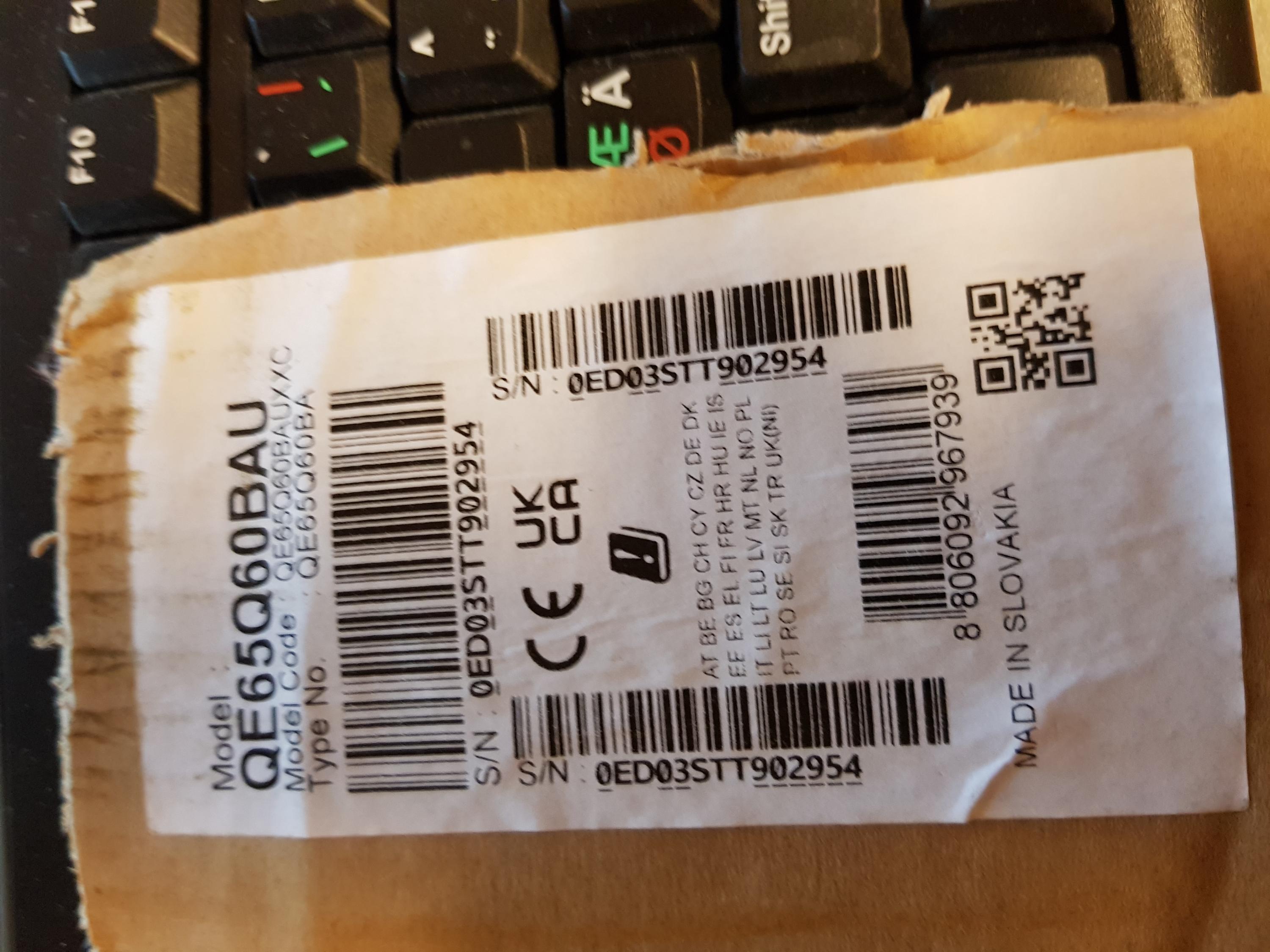

            Model: QE65Q60BAU is a model from Samsung, Philips should have a different designation.

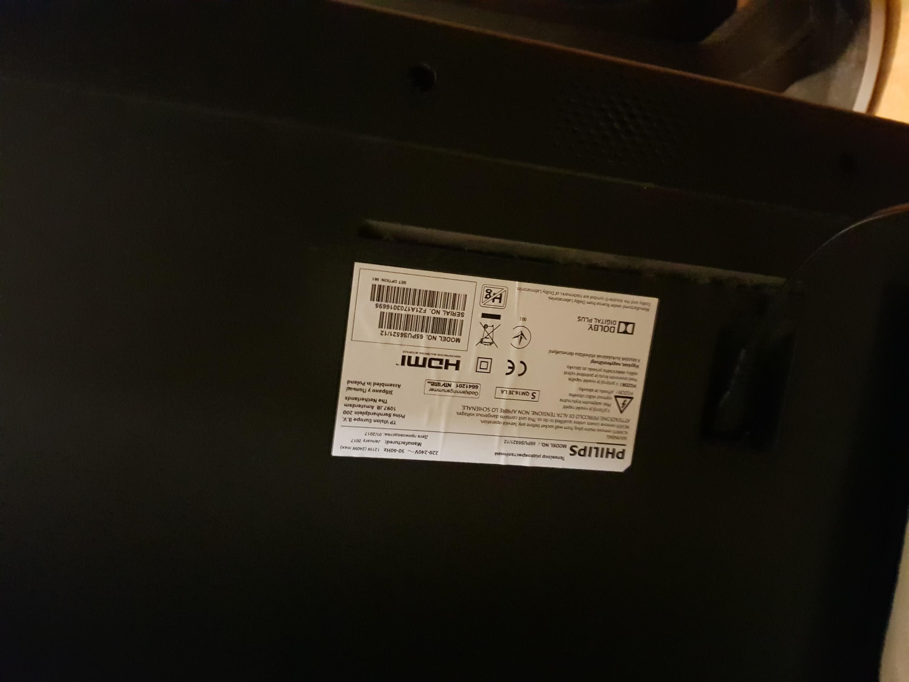

              These are the signs that are on the package and on the back of the TV

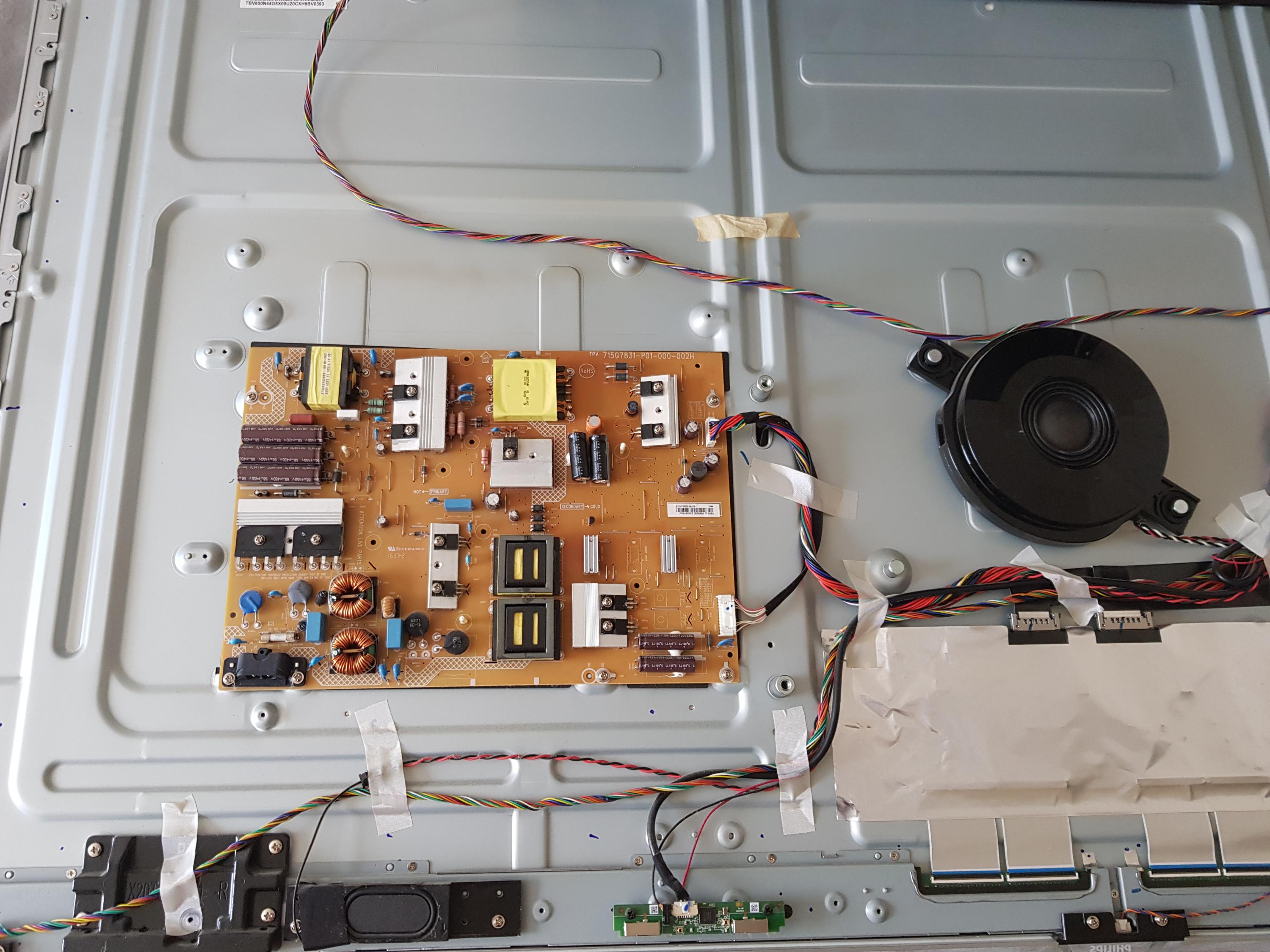

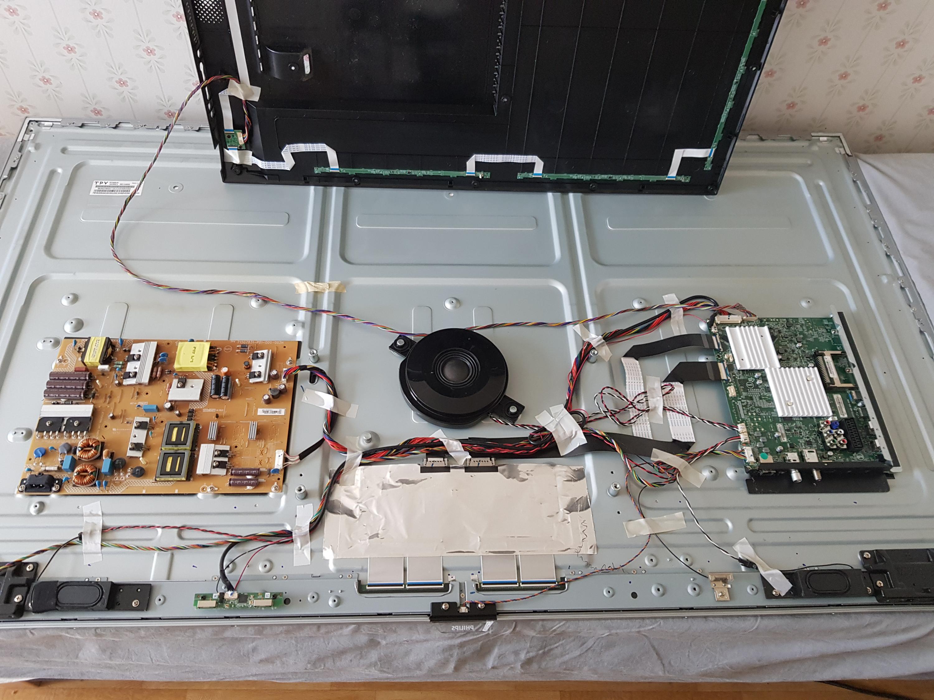

                yours TV from 2016... find friend to help you to take out the screen apart you have BL issue.

                  The box is not native, it is from Samsung TV. Your model in the photo.

                    Hi Lotas you are very observant and you are right now I see that it is a completely different designation :65PUS6521/12
                    can i change the title so that it is correct for the others . it is a free found television if it is Samsung or Philips most important is to find the problem to enjoy it if possible. want to download a Video to show the behavior on this tv and maybe get some help from you guys to fix the error
                    it's pretty big and heavy to handle but you might give me some clue as to what might be wrong with it

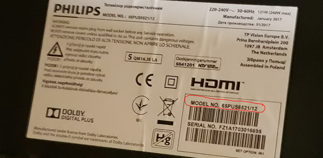

                        Post the correct model code for other one's reference, please, not photo... You probably have bad backlight togheter with bad mainboard, hard battle!
                        • bohaboha
                          • Nov 2012
                          • 1031
                          • sweden
                          Re: Philps QLED Q60B Model: 65PUS6521/12
                          the correct model code is here:65PUS6521/12 but i do not know how to edith in the title

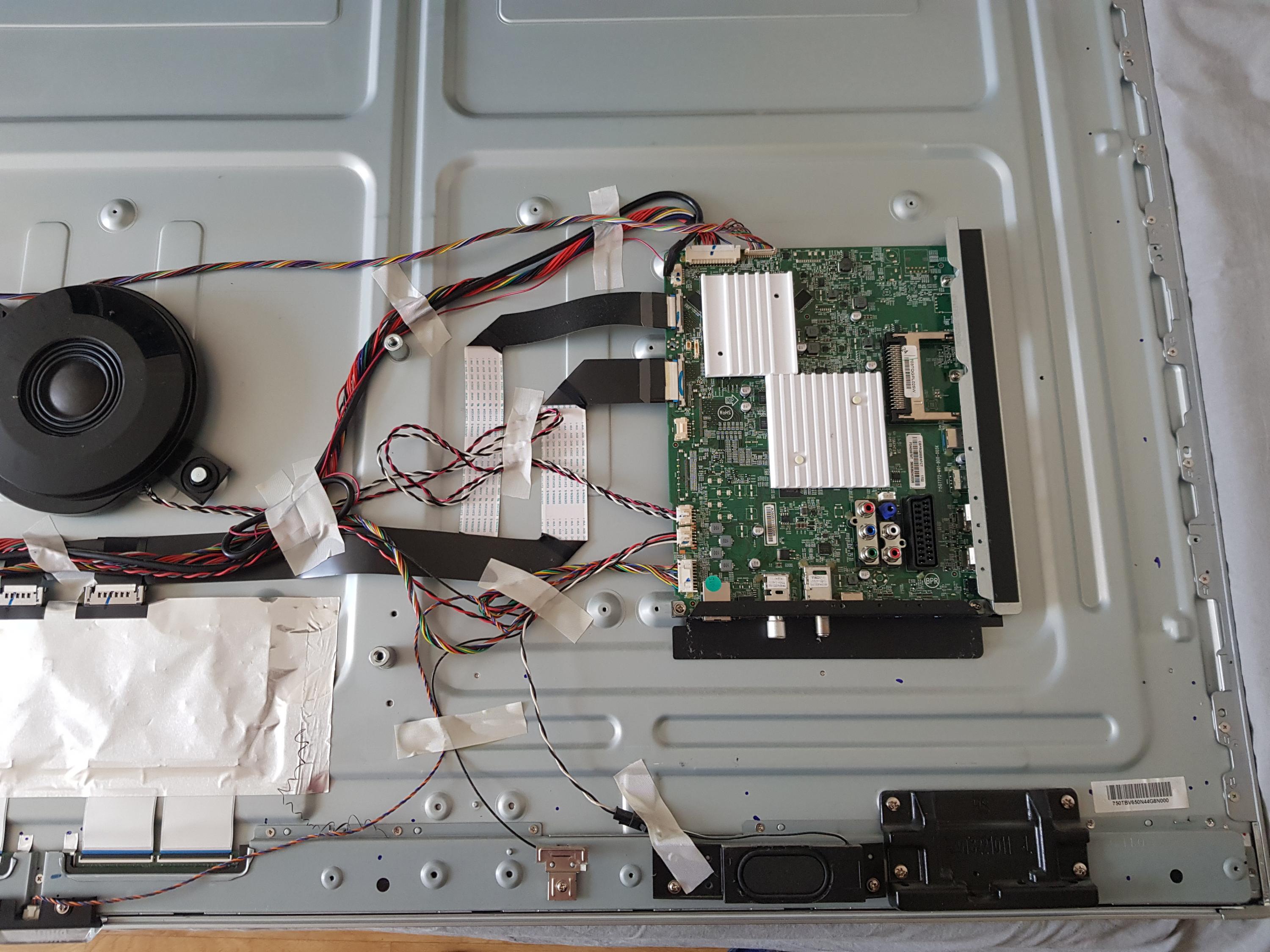

                                You first need a service firmware for this chassis for recovery, if it doesn’t help, then you will have to look for a working motherboard, since you are unlikely to be able to do anything with an eMMC dump.

                                      Find this firmware "QM163E_0.16.56.0_upgrade_loader" under usb. (Its size will be 1.12GB.)

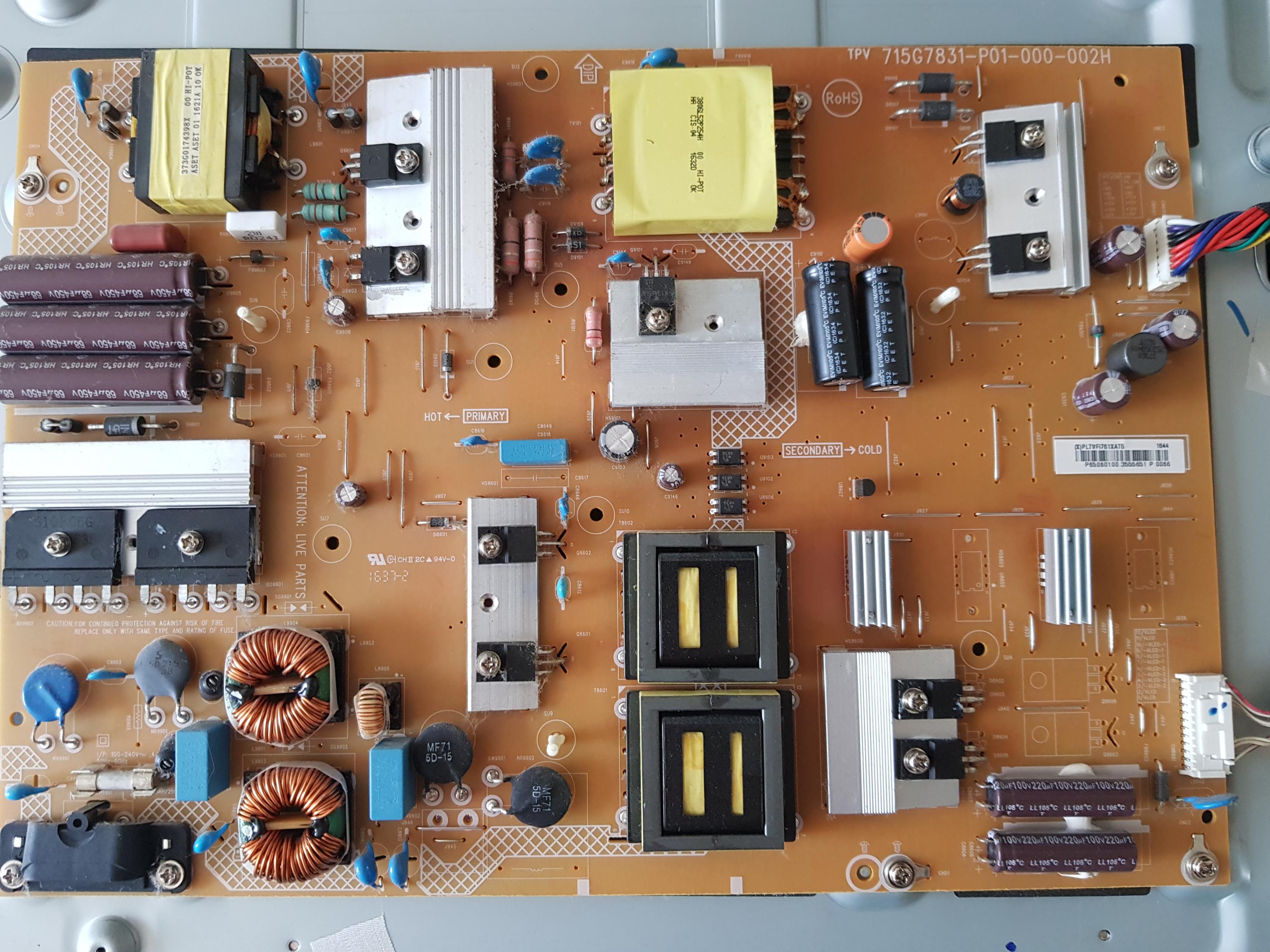

                                        If you want to test immediately the panel state then jump a 12v to the tcon fuse and disconnect the mb-tcon lvds cables, then turn on
