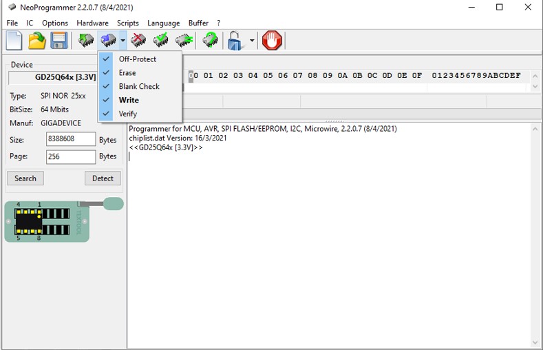

    I have the TV which is waiting for the standby light, it does not accept a command either from the remote control or from the button.
    The standby light is constantly waiting.
    I suspect it eeprom chip (25Q64CSIG)
    Where can I find the file to pass it?

    Read the contents (Dump) of this flash and put it here, I'll take a look, if anything, I'll restore it.

          Thanks for the file, which i went through but the problem remains. i used the ch341a programmer and the neoprogramer software after checking all the options in the programming button. what else could be wrong?

            Try this one, if it does not help, then replace the spi flash with a new one.
            And a newer Neo program ...

              finally with this version the file went through and the TV worked.
              thank you very much for the valuable help.
