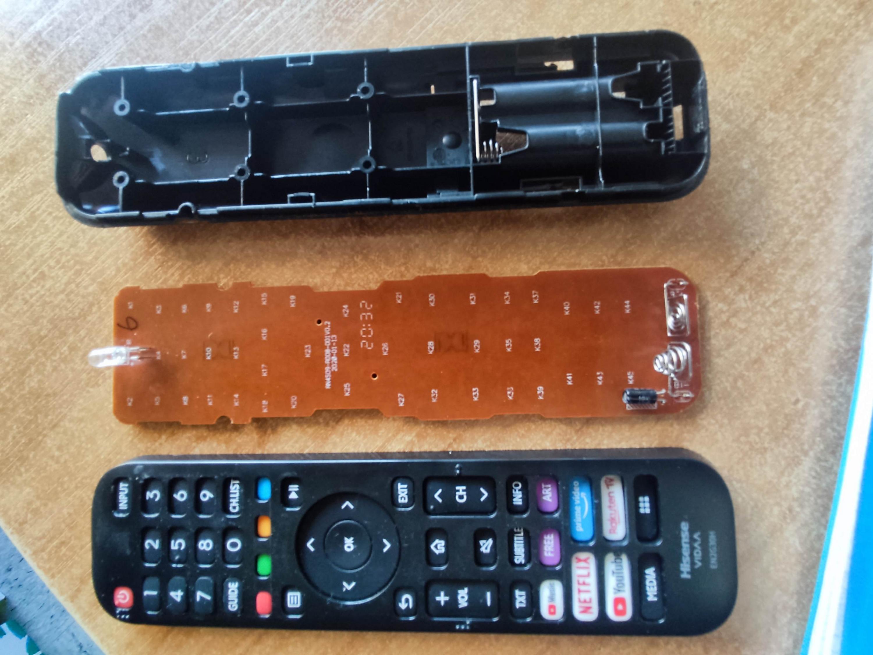

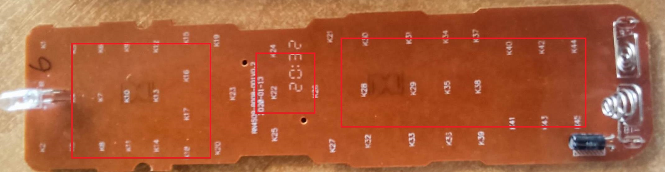

                    #29
                    Re: HiSense 55A7500F won't obbey to remote after power on
                    Ok here you have some pics of the remote board
                    • Diah
                      • Feb 2013
                      • 6357
                      #30
                      so from Photo 1 you can see the On / OFF had only 4 line . and the others 7-8
                      when the carbon taste didn't touch all line when you press the Resistances of the point will be less/ more as it designed at Chip script. so it will send wrong code.
                      photo 2 when you assemble back the RC put thin solid plastic on the area i marked. you can use one piece on all ( just be sure you didn't block the cover holes ) or use 3 pieces from same thickness and separate them on the plate. then put the cover. you need to repeat it until you are successful.. if this didn't help buy replacement RC

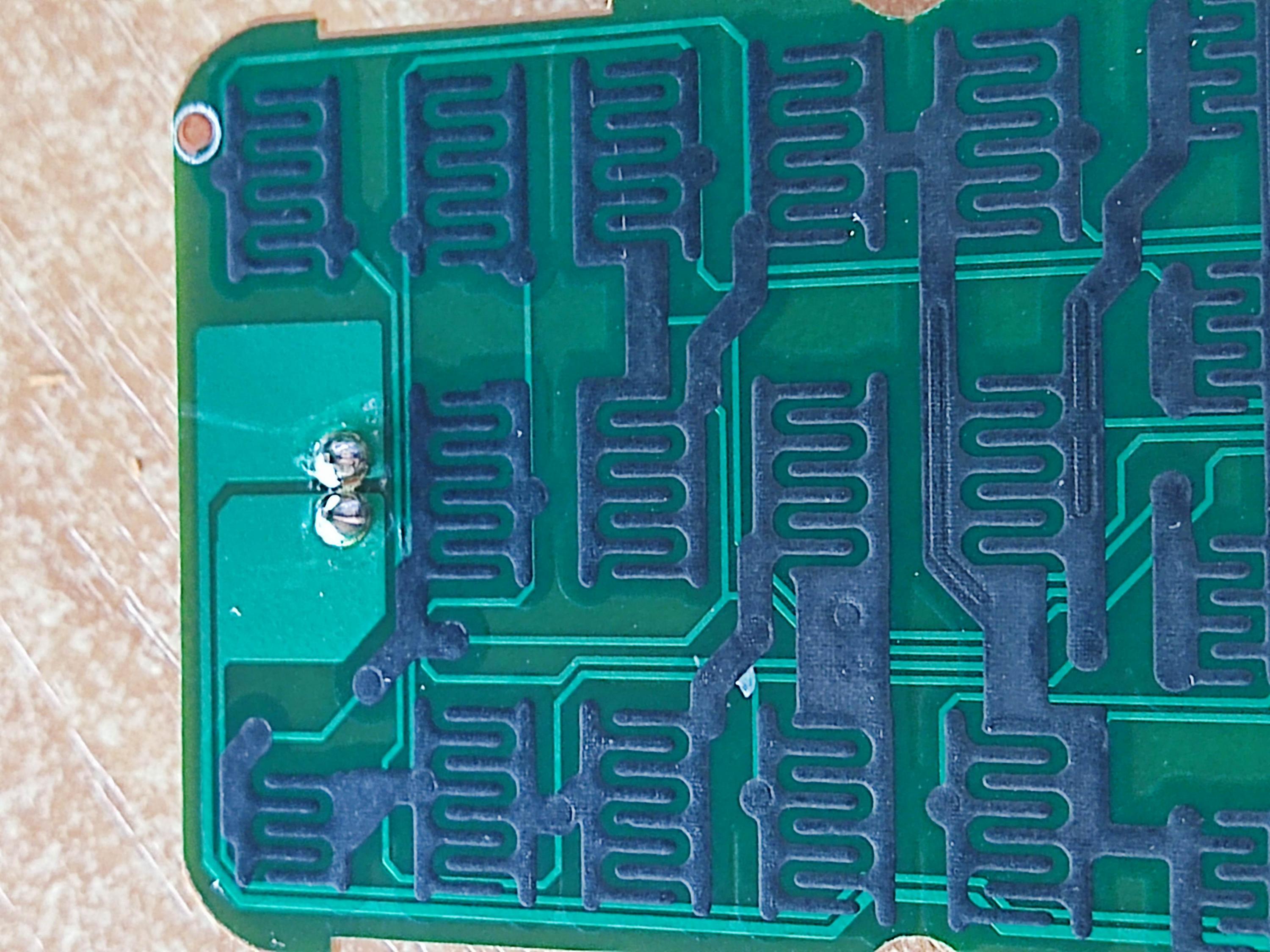

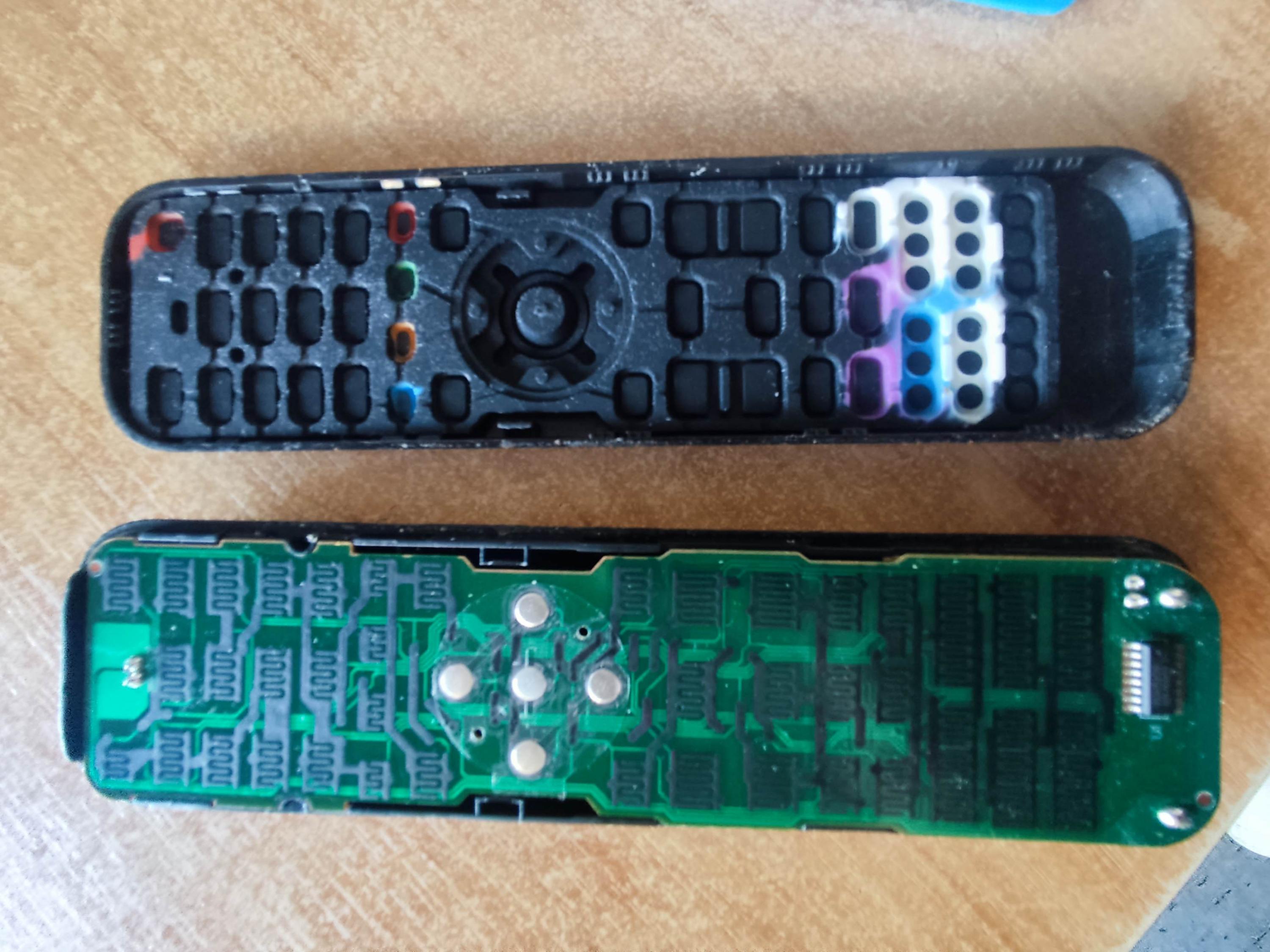

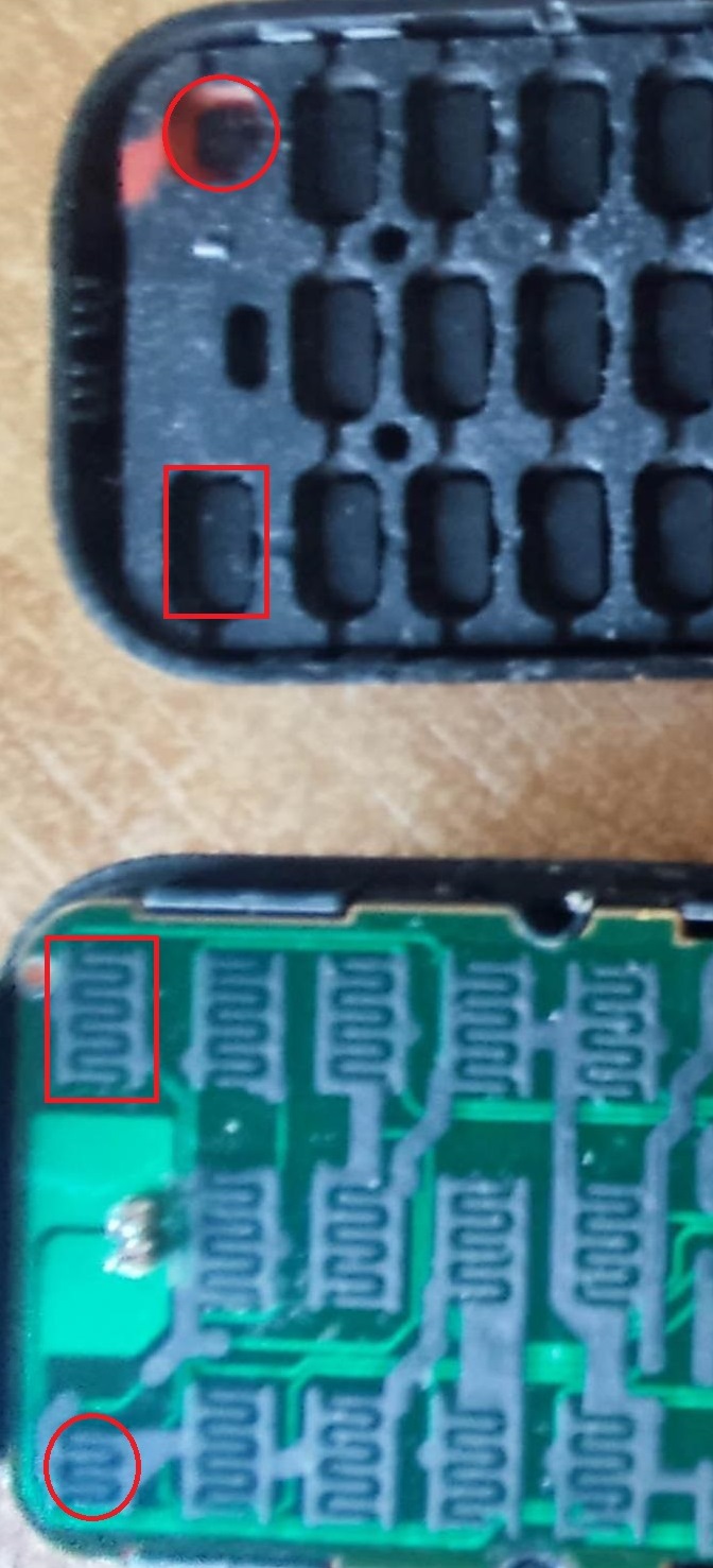

                        #31
                        Nah....verified. That's not the case. I tried with the top cover and rubber buttons removed (batteries still in place) using aluminum foil and it still made the power button work to turn tv on, but when the tv was on no button at all responded nor made any effect on the tv
