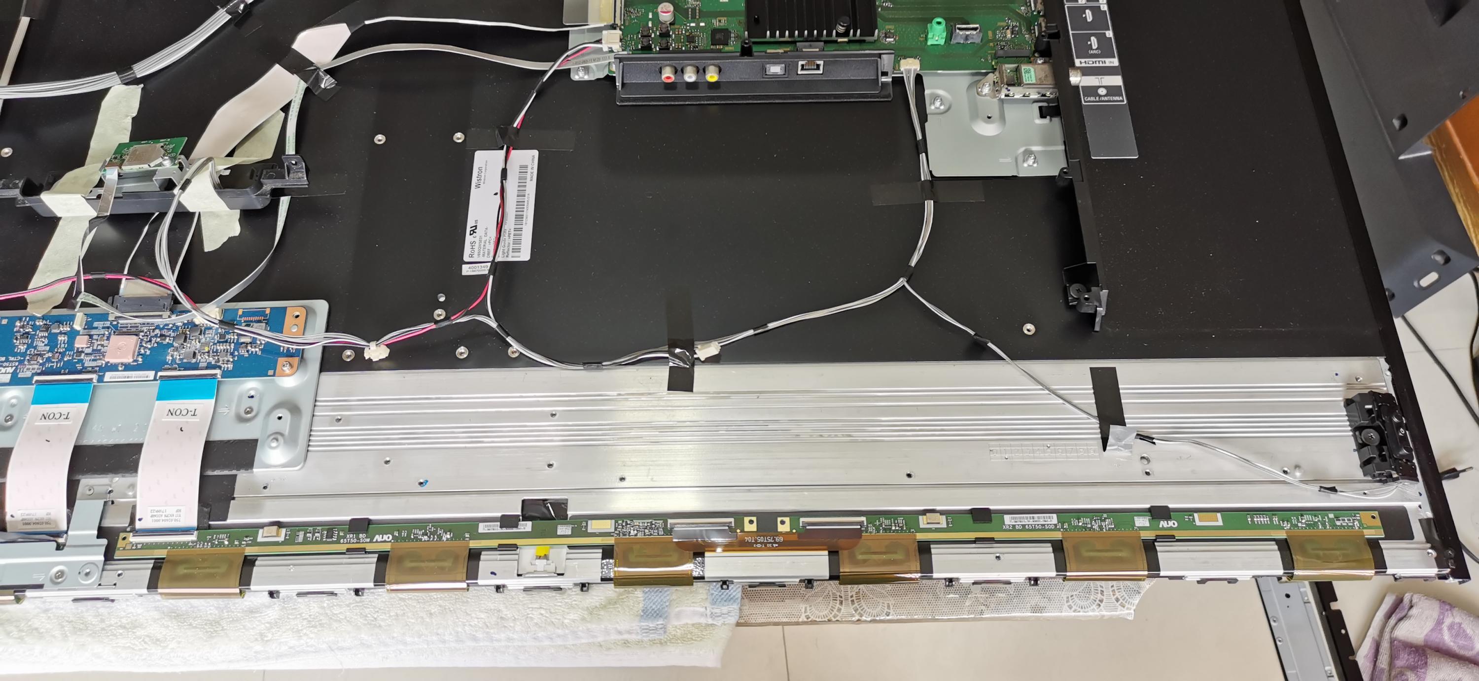

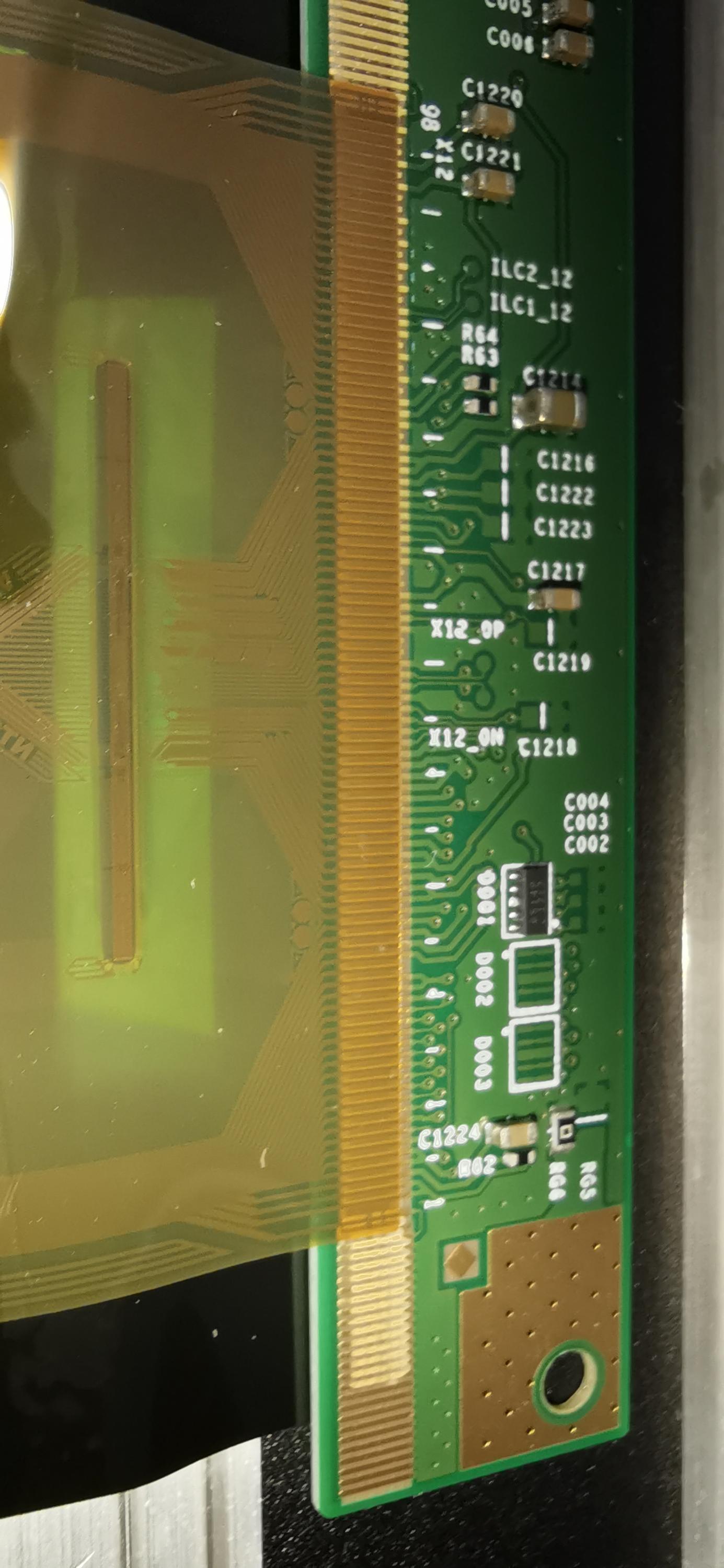

      Finally setup table-top space, opened and gained access to the left-side "faulty" driver panel.
      Long story short - after numerous trials and various method of tinkering with the cof bonding tab, absolutely no effort on the cold start double image...
      Also tried hair-dryer hot air directly onto the bonding tab and its' surrounding - no effect either. And DMM checked on all the tiny mlc capacitors - all read OK in hundreds ohm range.

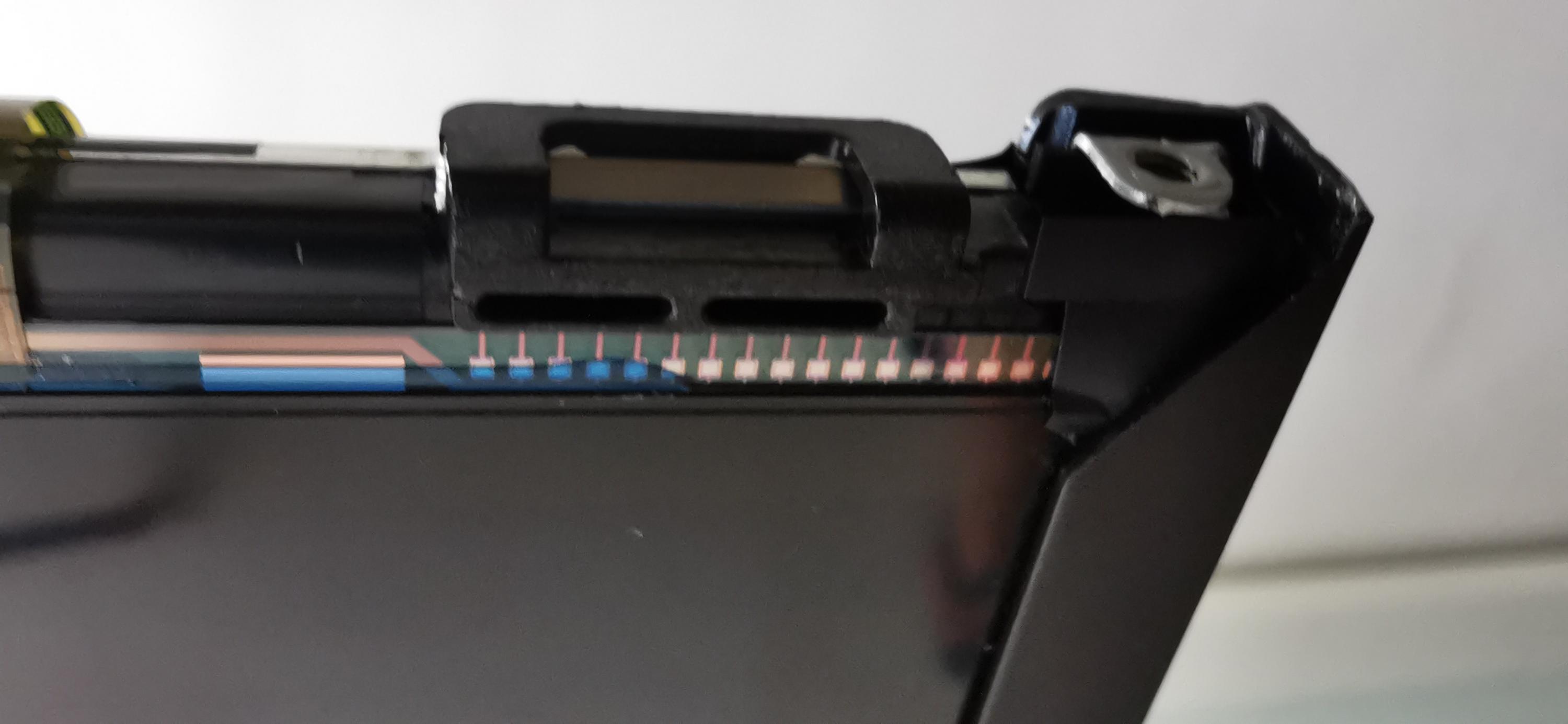

      I suspect the contacts in picture #3 attached just need time to heat up from within to get contact.
      Strangely - now with TV cooled off, then hot air on the corner area for 2-3 minutes also no effect on the cold start double image... could not get it to cold start with normal display anymore...
      So now the 2 options:
      1) Taped method - cold start with no double image but slightly sub-optimal display
      2) As it - cold start with double image, but get perfect display after 3-5 minutes
      I decided option 2 - few minutes warm-up for few hour of perfect display.
