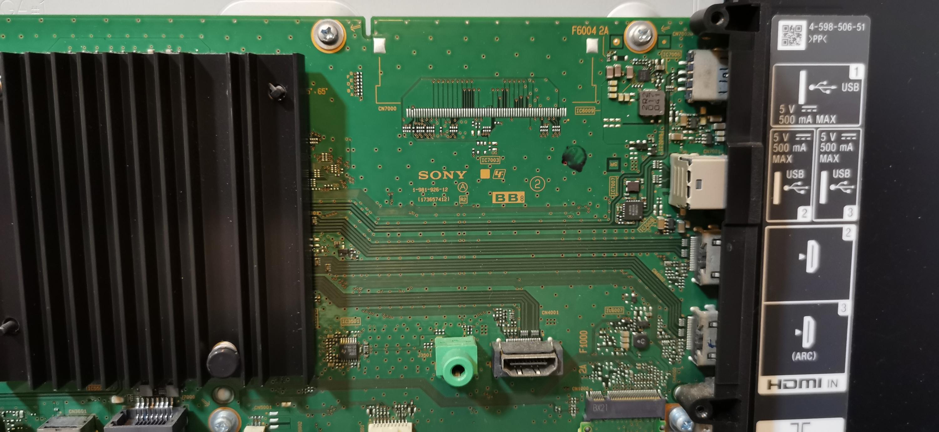

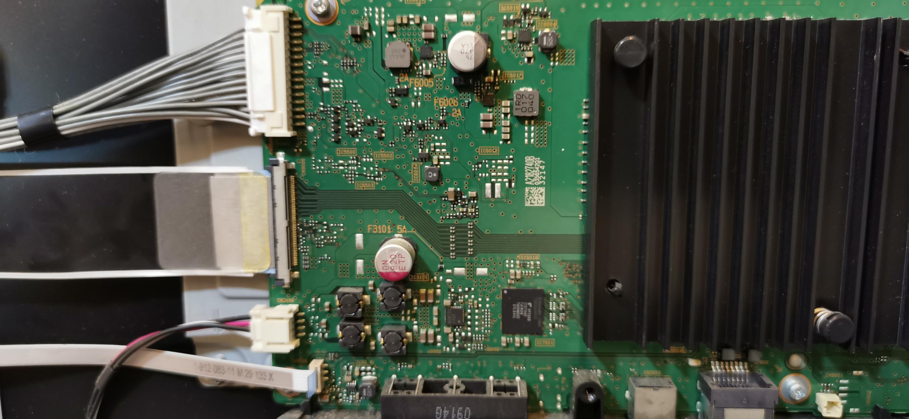

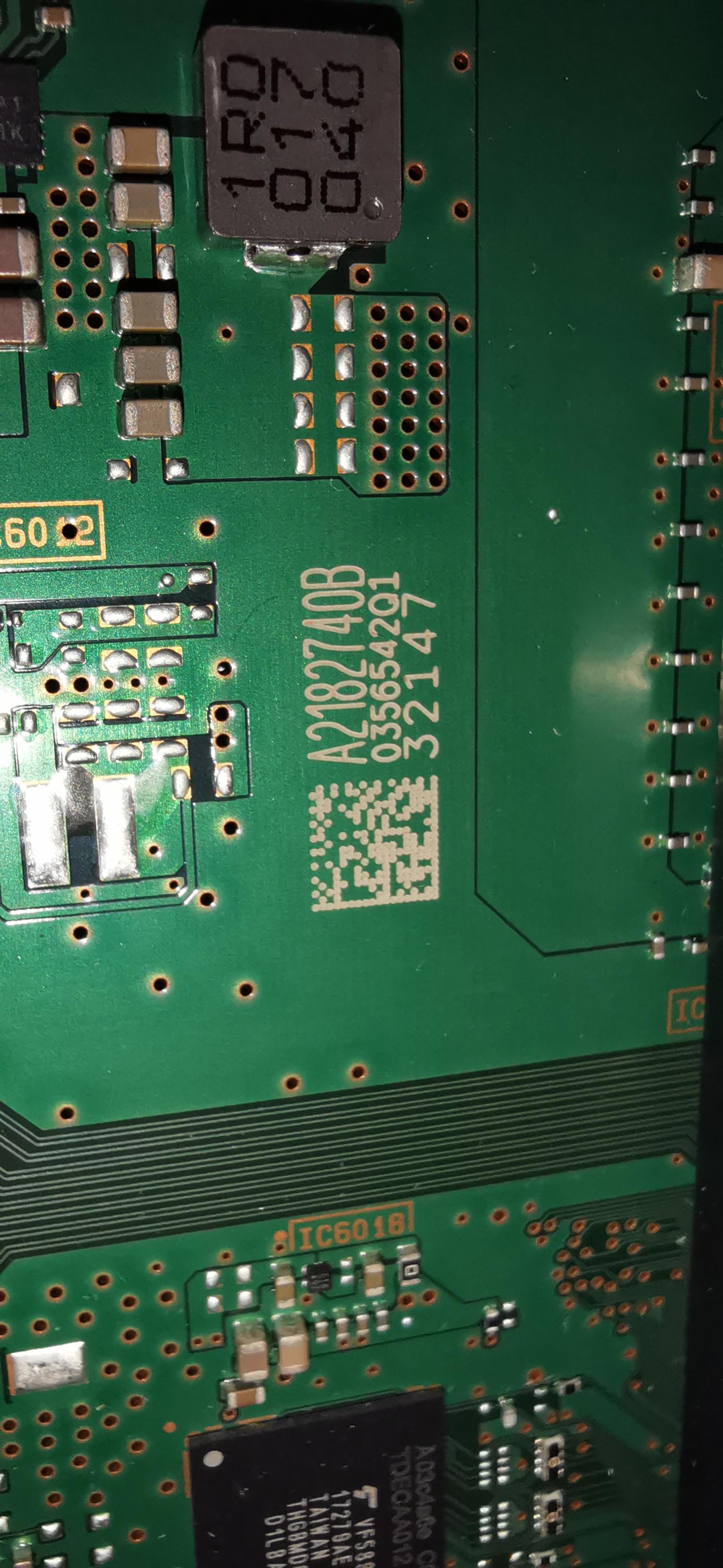

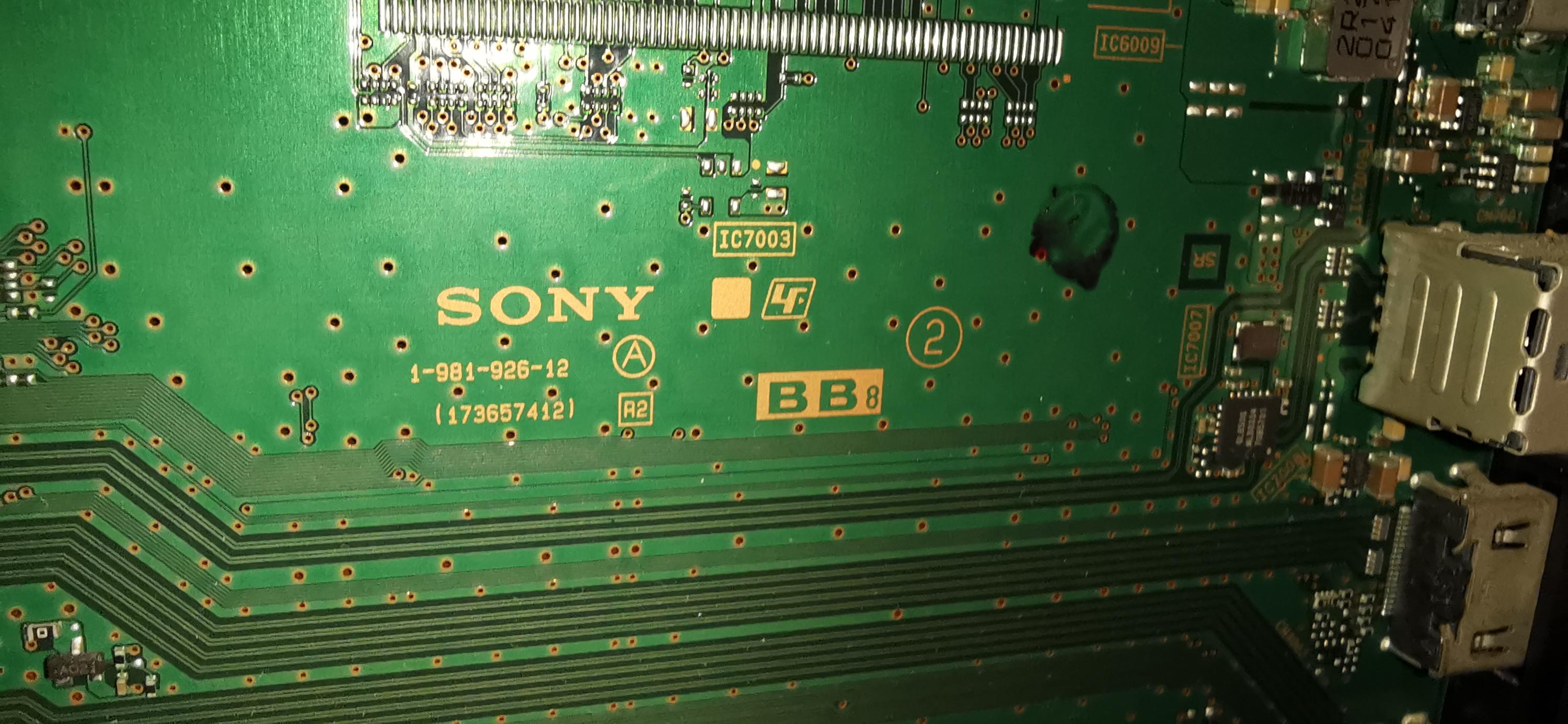

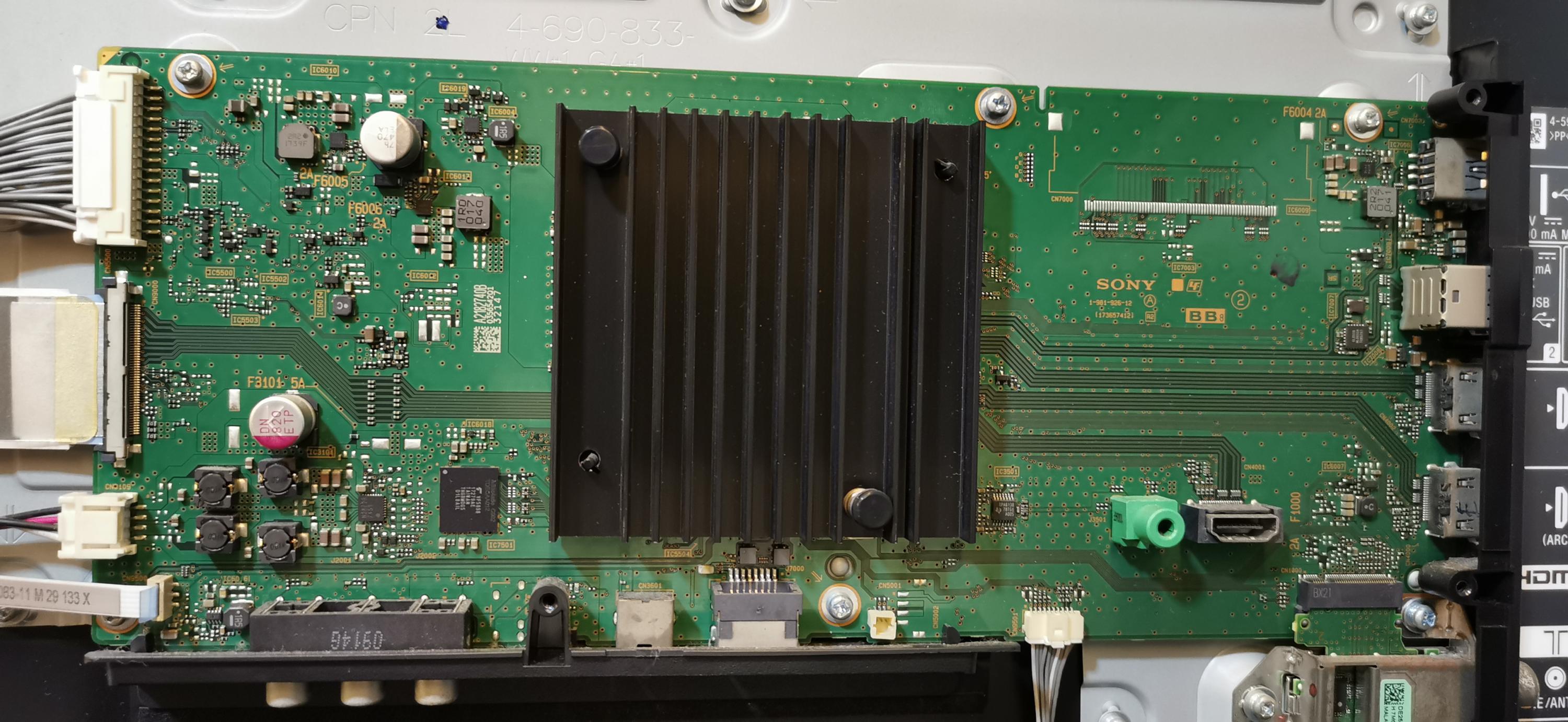

    Originally posted by Diah
    could you show us the mainboards?
    did you warm up the mb with hair dryer then turn on ?
    Hmm - I have not but will do try this later.
    MB attached.
