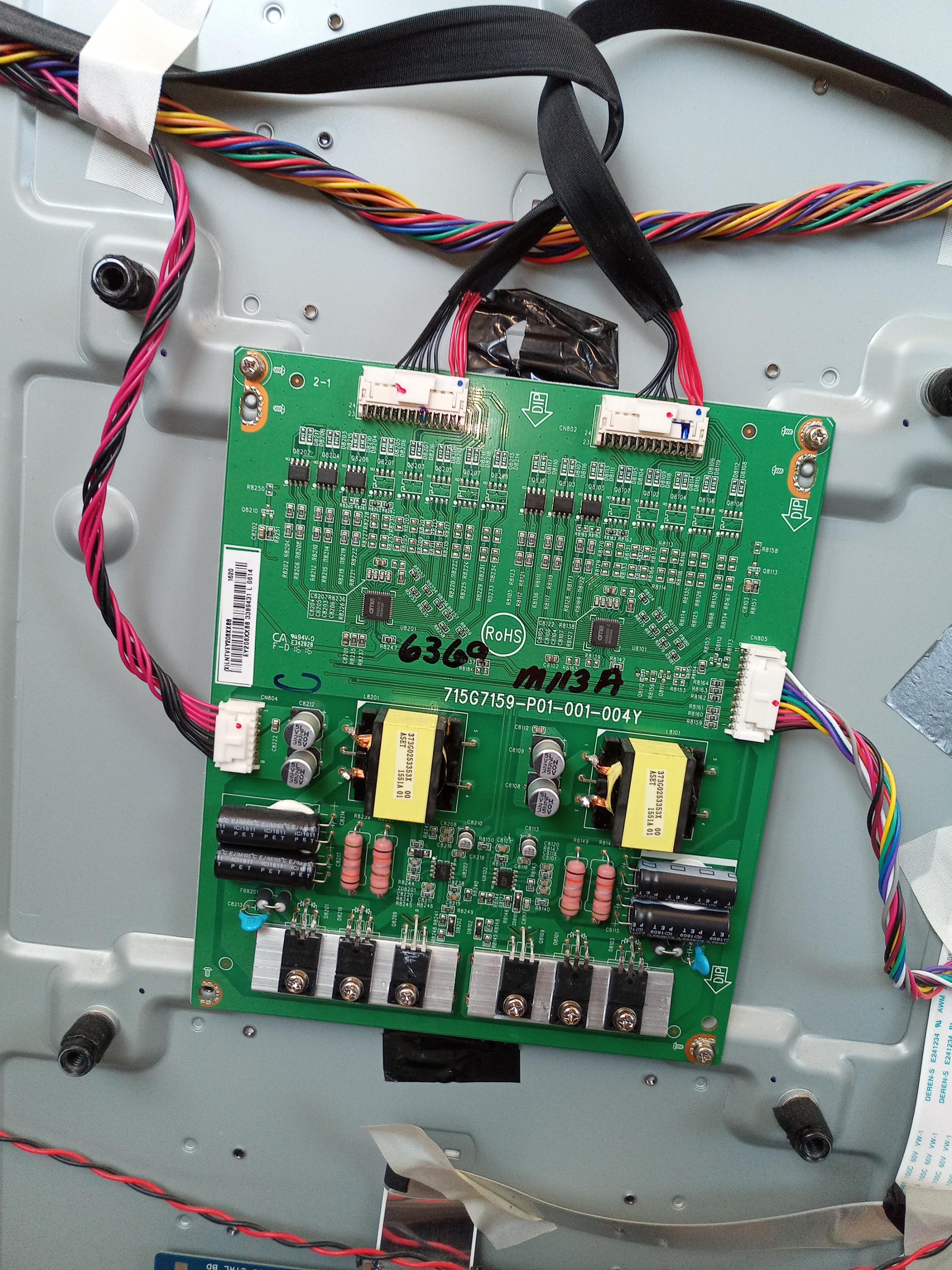

          well, this was rather anti-climatic... I received the replacement LED driver board, installed it and ... nothing. Same problem. I still have the replacement main board available, so I installed it along with the driver board and ... still same problem.
          So I'm running out of options...
          Here's a recap: The LEDs all work (tested individually), the driver board and main board have been swapped (the reliability of the replacement main board is questionable, mind you). Voltage on the power supply board seems ok (19.3v mislabelled as 12v; 22.1v for the 24v line). Remote control works to turn on the TV. Upon power up, the Vizio logo is displayed in full brightness. Flashlight test shows movement on the LCD. Connecting a DVD to the TV I can hear the sound track.
          But still, after a few seconds of displaying the logo, the LEDs turn off. I can 'listen' to the DVD soundtrack for 60 seconds and then the TV stops playback. The power LED blinks 15 times, the logo is displayed for a fraction of a second and the TV finally powers off by itself.
          I'm assuming the mainboard does a system check and if not everything is functional within 60 seconds, it just aborts everything and turns off. Pointing to a mainboard issue.

            Re: Vizio D50u-D12 damaged mainboards?
            If you have a moving image and sound, your mainboard could be ok, you tried a replacement and same result, go ahead and check those led voltages, maybe someone here knows how to test the leds on this one, check all connections of the leds, I don't think I would put the tv back together til the leds are working, too much trouble tearing it all the way back down.

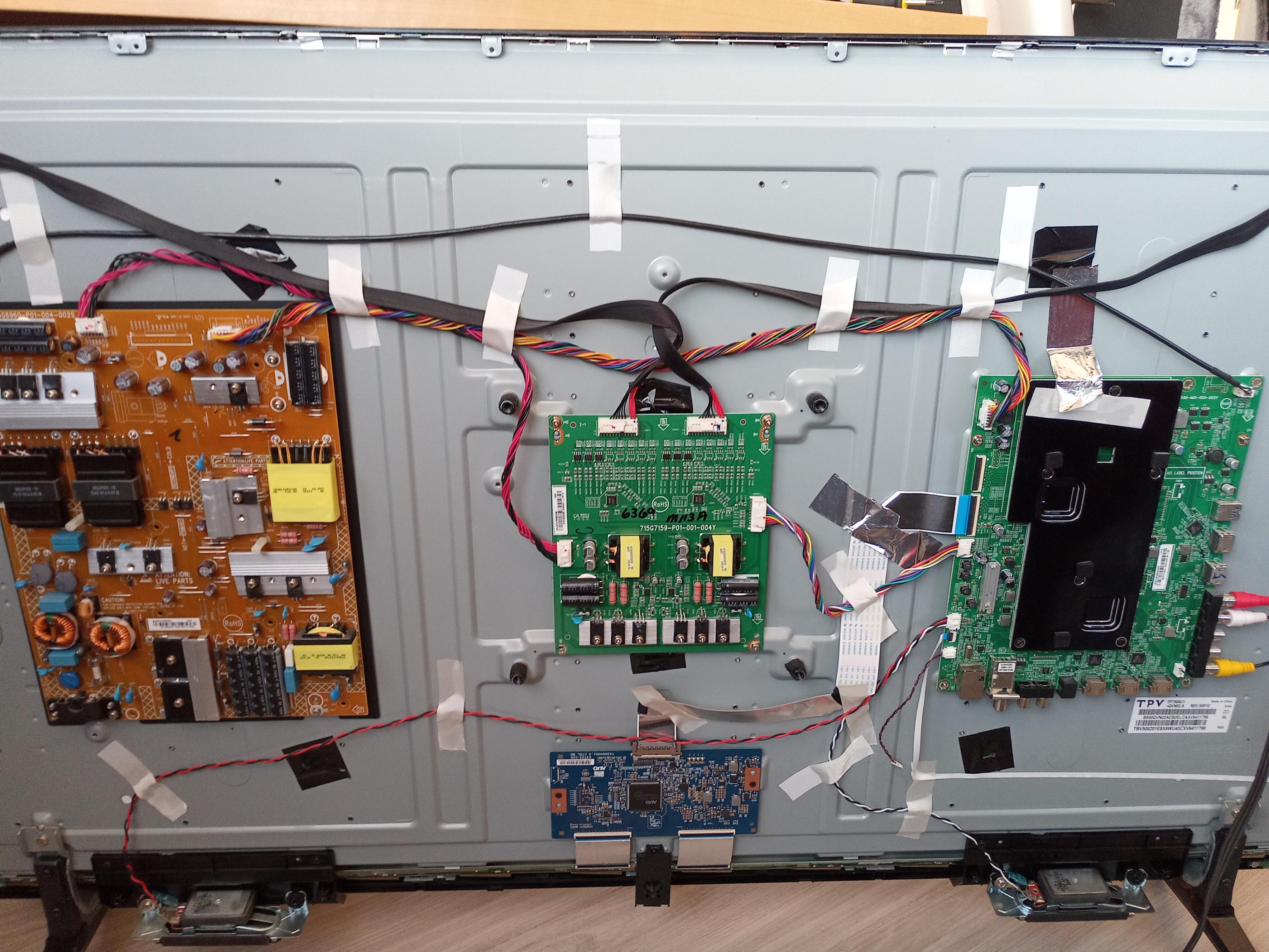

              Post some good clear straight on pictures of each board and one of the whole back as to see how everything is connected.
                If it isn't a issue in backlights, bad led/s or connection of leds, I would probably suspect the powerboard.

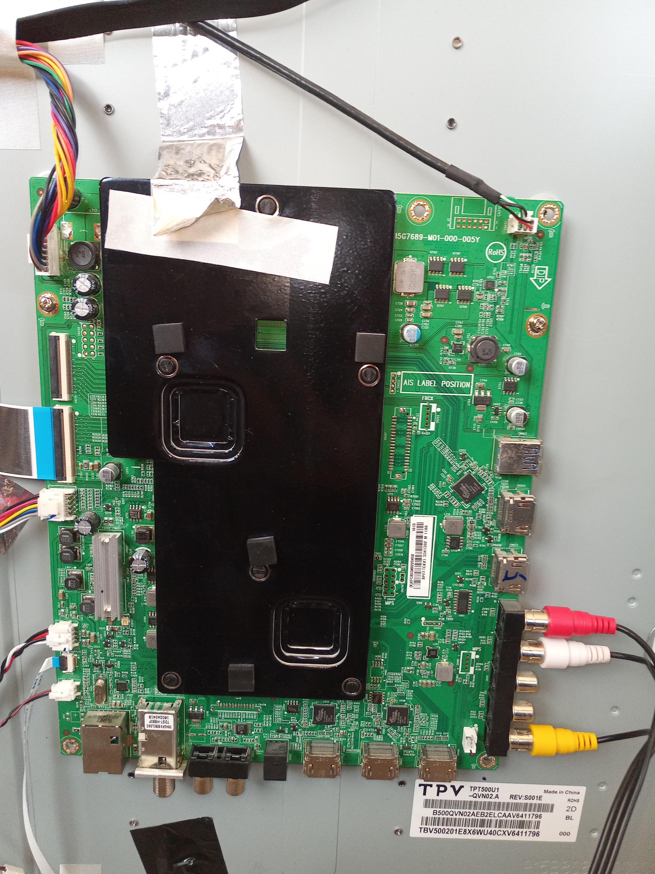

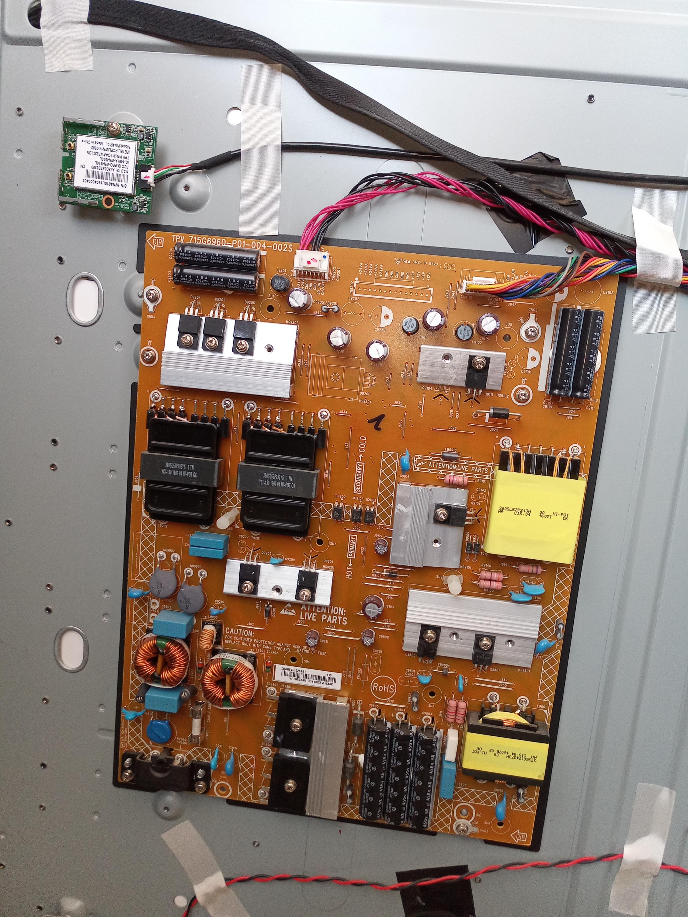

                  Here's a picture of the 3 boards and one of the back of the TV. Currently, the power board and main board are the original ones, and the driver board is the replacement (but it has the same issue as the original one)
                    Ok, lets test a couple voltages on the connector CN9101, with tv in standby put the probe on ps-on note voltage, leave probe where it is, power on take note, do the same with the on/off pin, what do you get?
                      Also see if you can locate U202 eight pin eeprom on mainboard, heat it up for a minute with a hairdryer, then try it see if there's any change at all.
                          CN9101 on standby:
                          pin# -- V
                          1~4 -- 0v
                          5~7 -- 19.3v
                          8 -- 5.2v
                          powered ON:
                          pin# -- V
                          1~2 -- 3.3v
                          3~4 -- 0v
                          5~7 -- 19.3v
                          8 -- 5.2v
                          (The lower row pins are the same voltage as the pins above)

                                      Re: Vizio D50u-D1 - Loose components
                                      That did it! Following your suggestion, I reflowed U202, U201 and U401 and the unit now works! Not sure which one was the source of the issue but the unit now works fine!
                                      Now, the question is how long will this repair last... I've seen comments that it works for a day or two, while others claim that it works for many months afterwards. Time will tell! Or at least my son will, when the issue resurfaces!
