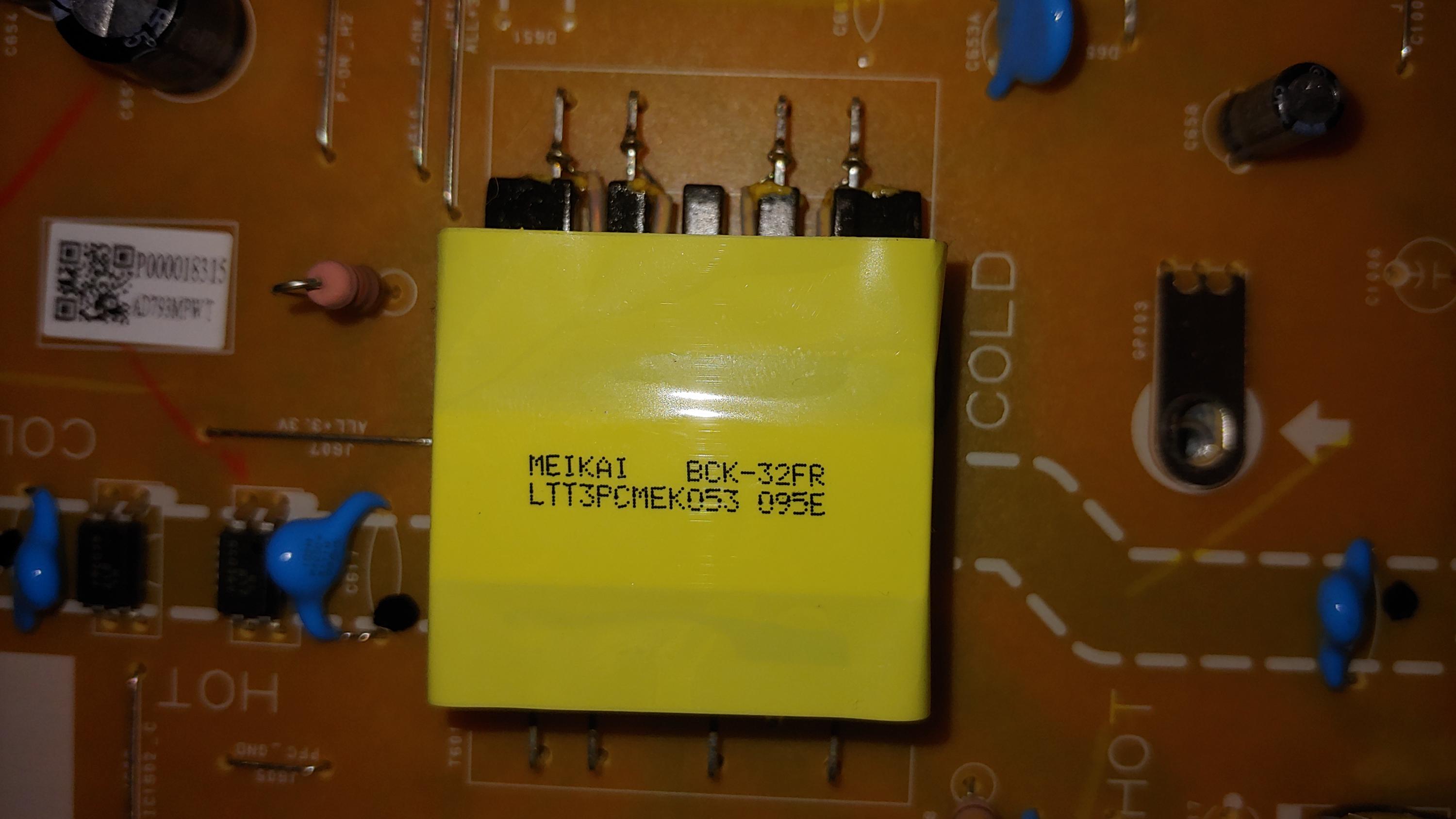

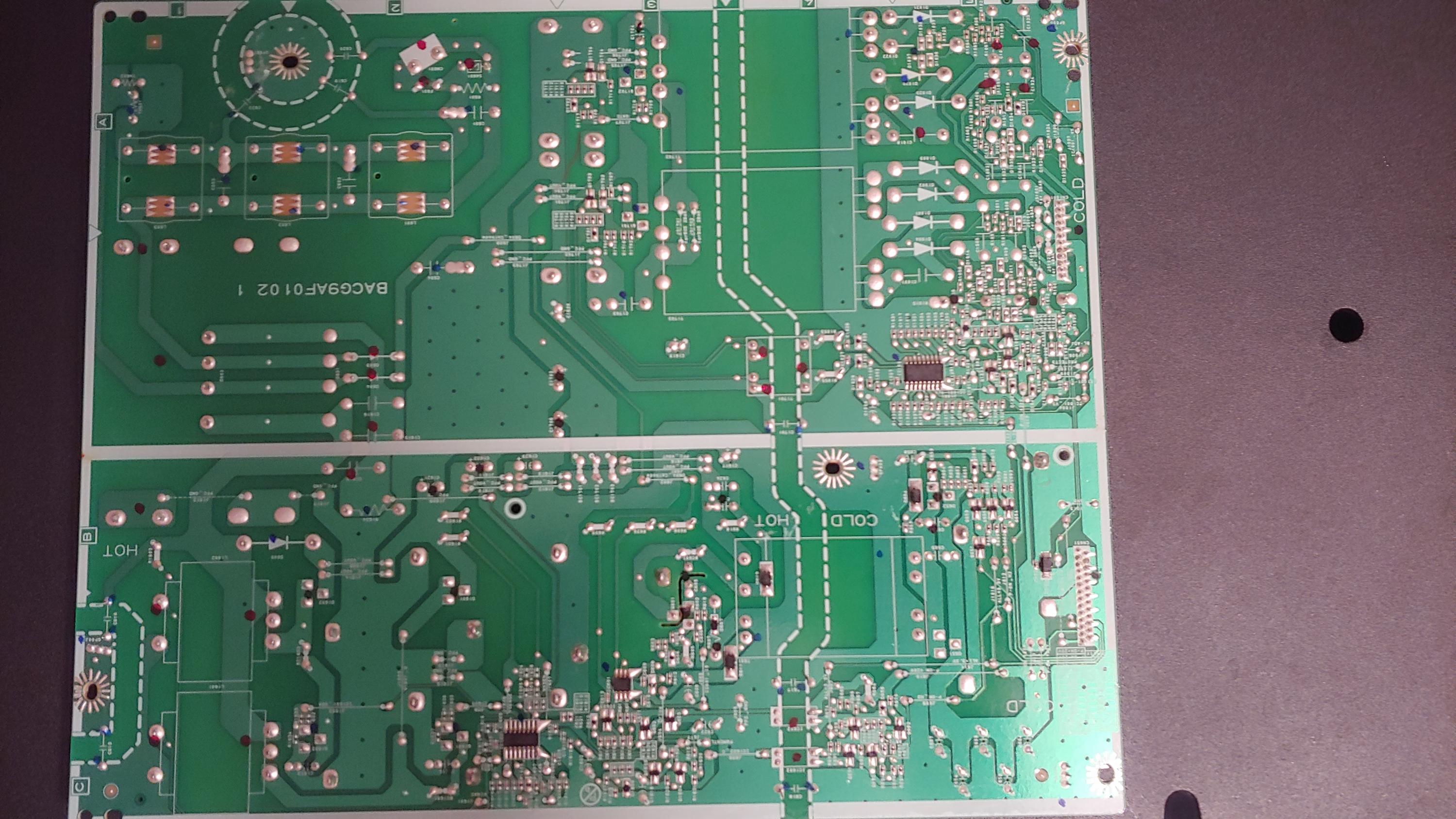

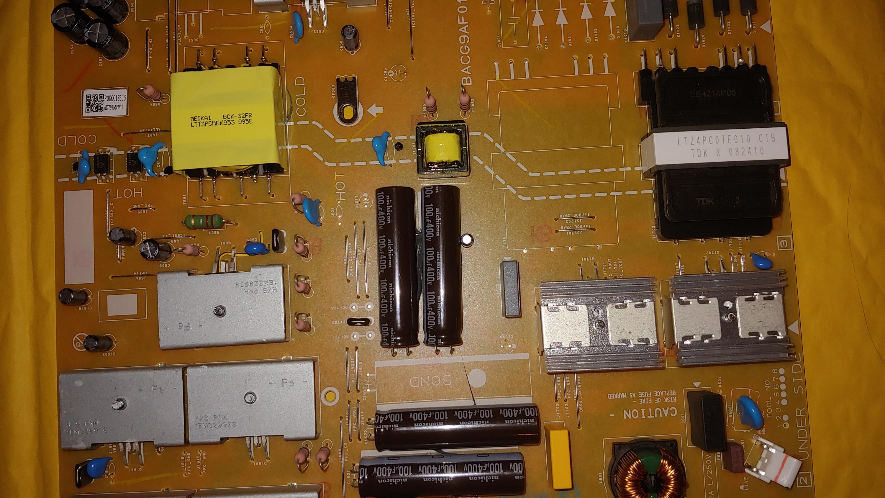

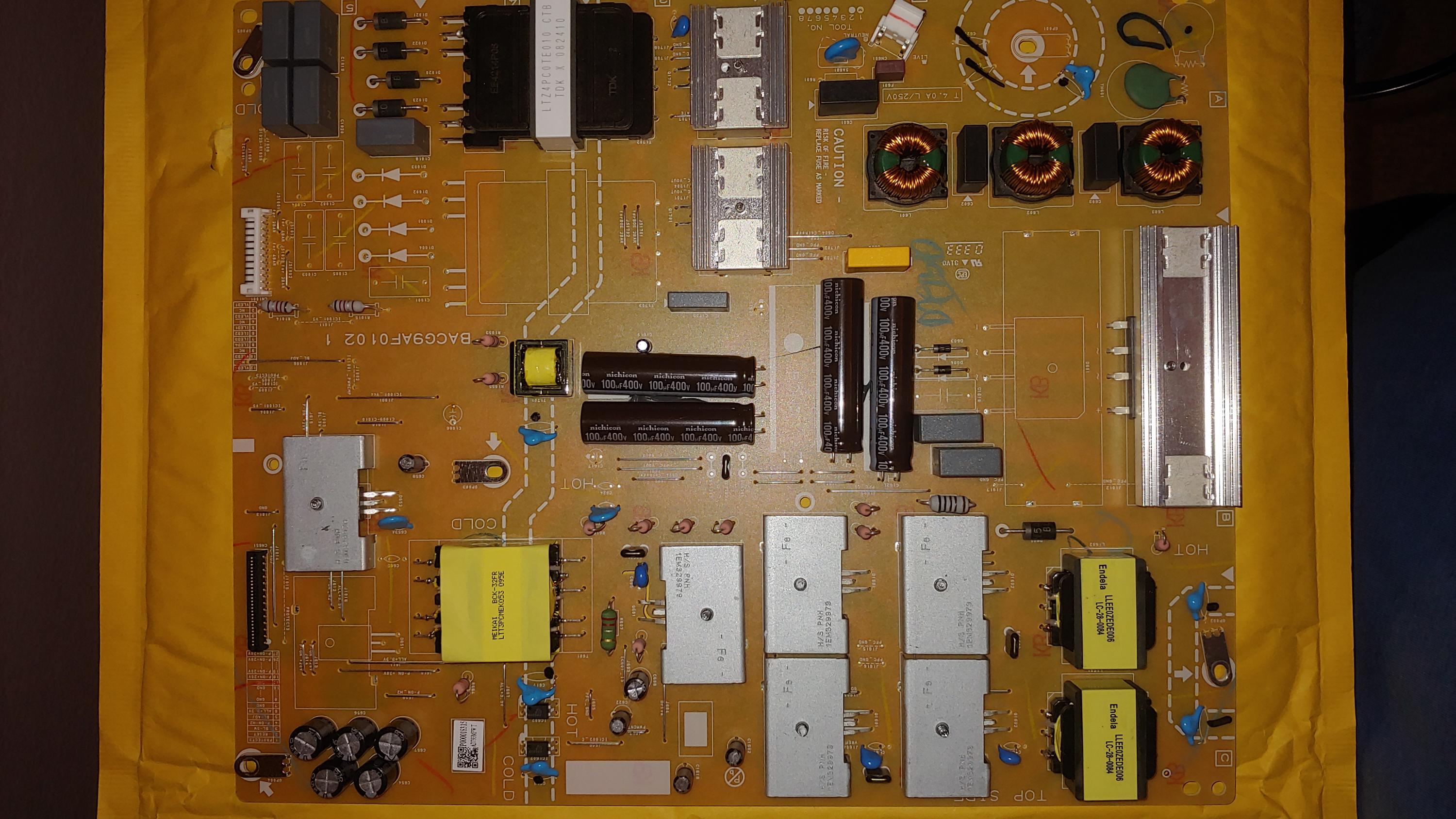

        Re: Philips 75pfl5704/F7 No sndby power
        I went ahead and purchased another board off eBay but found that one is also not supplying standby, which I assume is labeled ALL+3.3V since there is no other logical marking. This board in the pictures is my original power board. I have done some poking around however I have no idea if I'm testing correctly. Ive been going off youtube videos from TV repair channels and the like. I am testing using cold ground on Cold side, and using negative capacitor pins as Hot ground.
        I know the fuse is good. Main 400v caps all get power. Ive tested most of the FETs to ground and none seem shorted to cold/hot ground. (Saw someone do this on YouTube https://www.youtube.com/watch?v=x-fhJsV9V5E, no idea if it helps) all the P-ON+20 pins on the cable port are reading 12.5vdc. All caps look okay, no bulging. No holes or burns that I can see in anything else. I have tested some diodes to see if any read forwards and backwards. I think I found one (D1701 that connects to transformer1701 which powers the LEDs, it's tiny and on the back so it's possible I am testing it wrong too) but it isn't on the circuit for the standby. All others test 1 on a volt meter when reversed. Again, not sure if that's helpful.
        I'm trying to trace from power in, to the T601 Transformer since none of the cable connections connected to it are powering up.
        Let me know if there is something else you'd recommend or pictures you need.

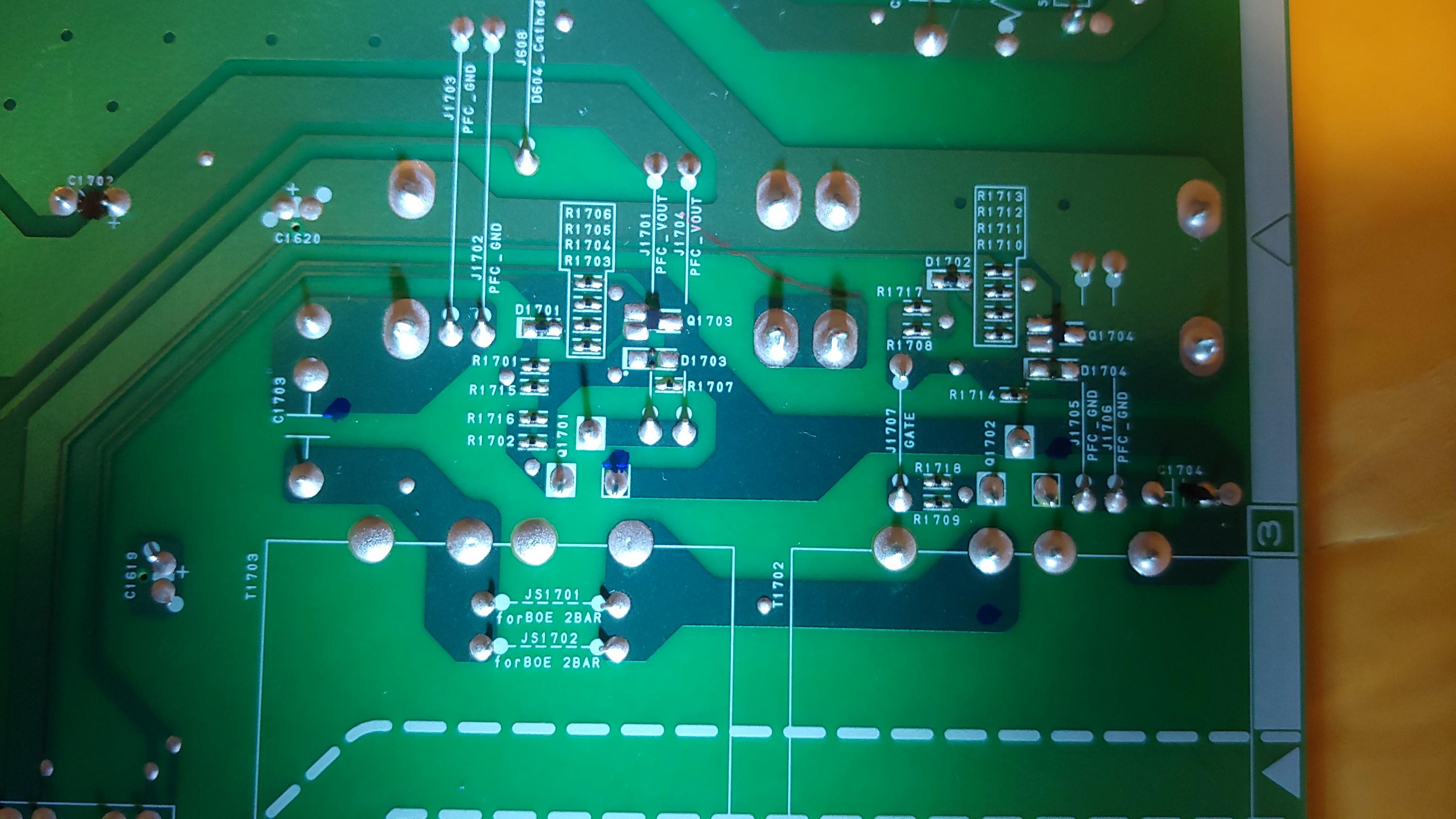

          Pictures are not quite clear enough to see it, can you give a good picture of that D1701?
          • CurtisC
            • Mar 2023
            • 16
            • US
            Here you go
            I'm reading 707 one way and 623 the other. Not sure which is pos and neg.
              Not exactly sure, maybe it's reading both ways because each side is leading to resistors, measured a couple diodes on a board, some read like you would expect, a couple read 100 both ways a couple read 30 both ways, I believe this board is good if I remember it's from a broken screen tv.

                  How can I test if there is power getting to the transformer on the hot side of the board? Do I still use a neg terminal of a cap for ground?
                  I don't want to do more damage.
                  • nomoresonys
                    • Jan 2013
                    • 12225
                    • U.S.
                    If the pins you are testing are on the hot side which should be clearly marked with the thick line, then yes. Now if the legs come out on the cold side then use chassis ground on that cold side.
                          I tested the transformer (T601) and it had around 400v going in from Hot but zero on the cold side. This was tested using cold ground on cold.
                          Is there anyone who knows by looking at the tech manual if this transformer may need to be triggered somehow? Or is this probably a failure point that I should replace?
