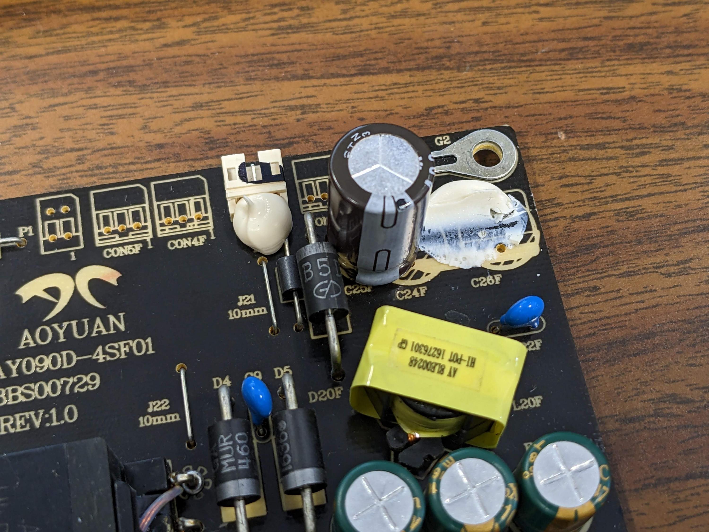

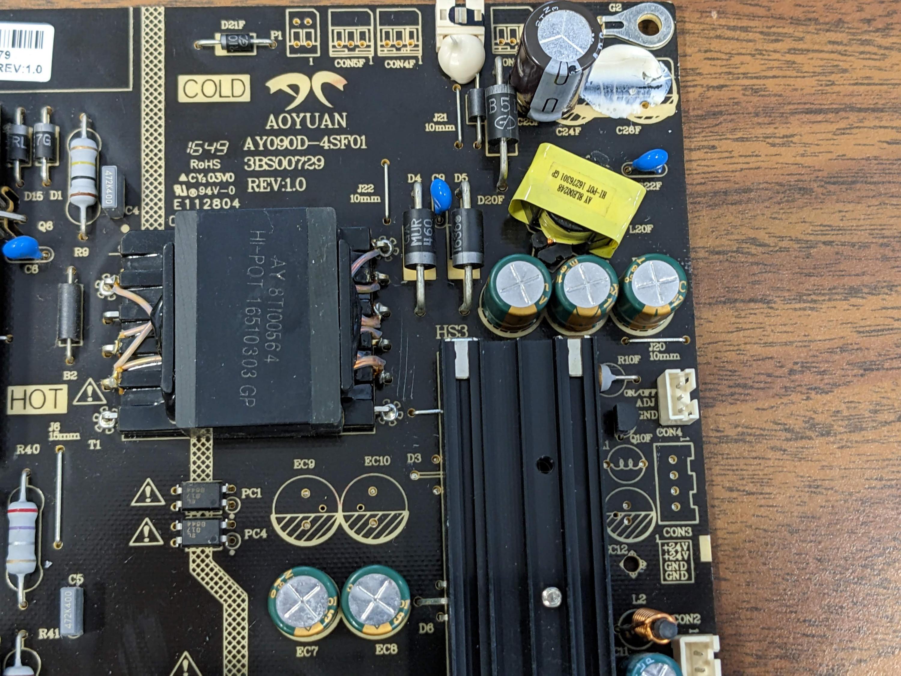

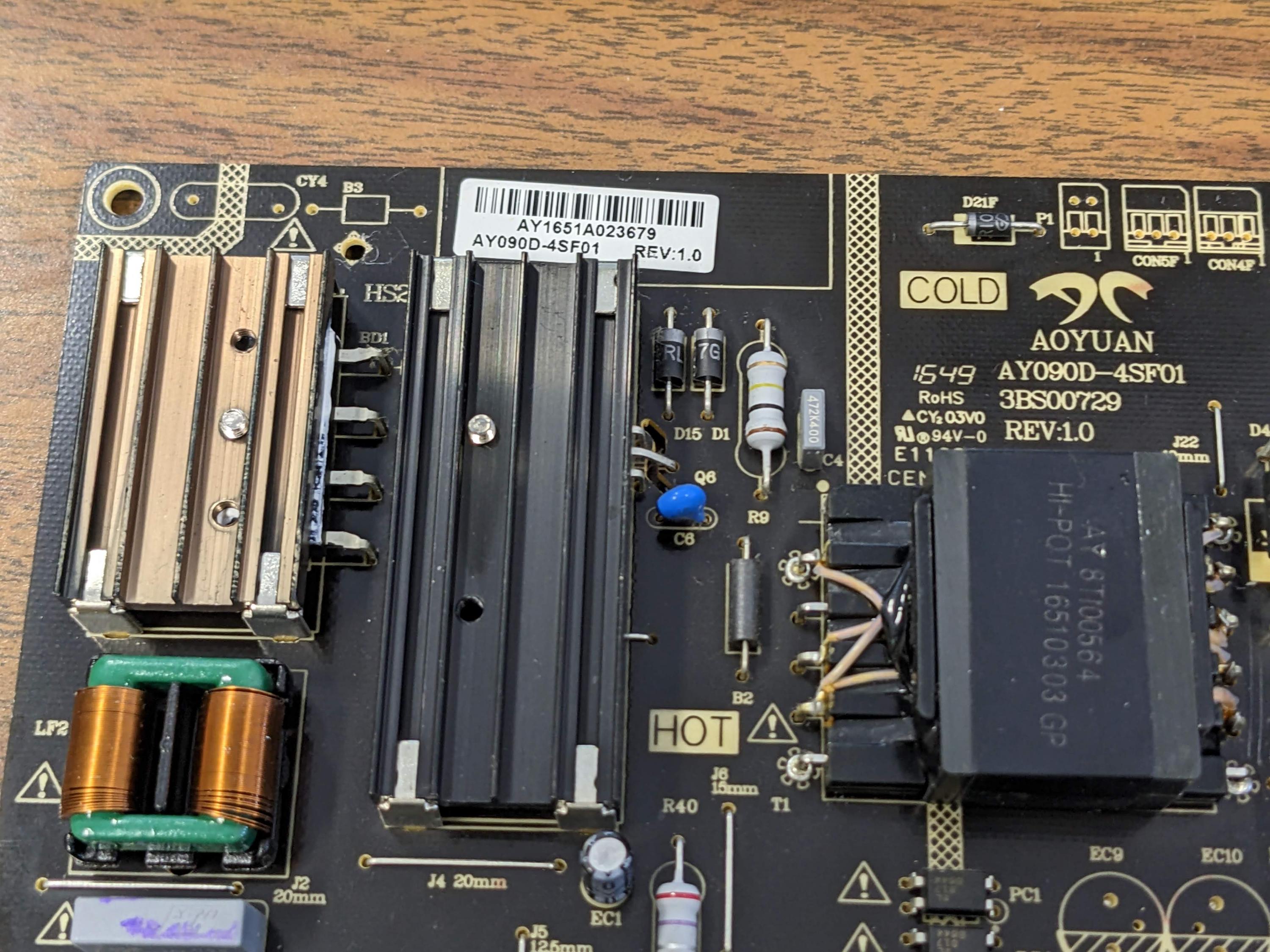

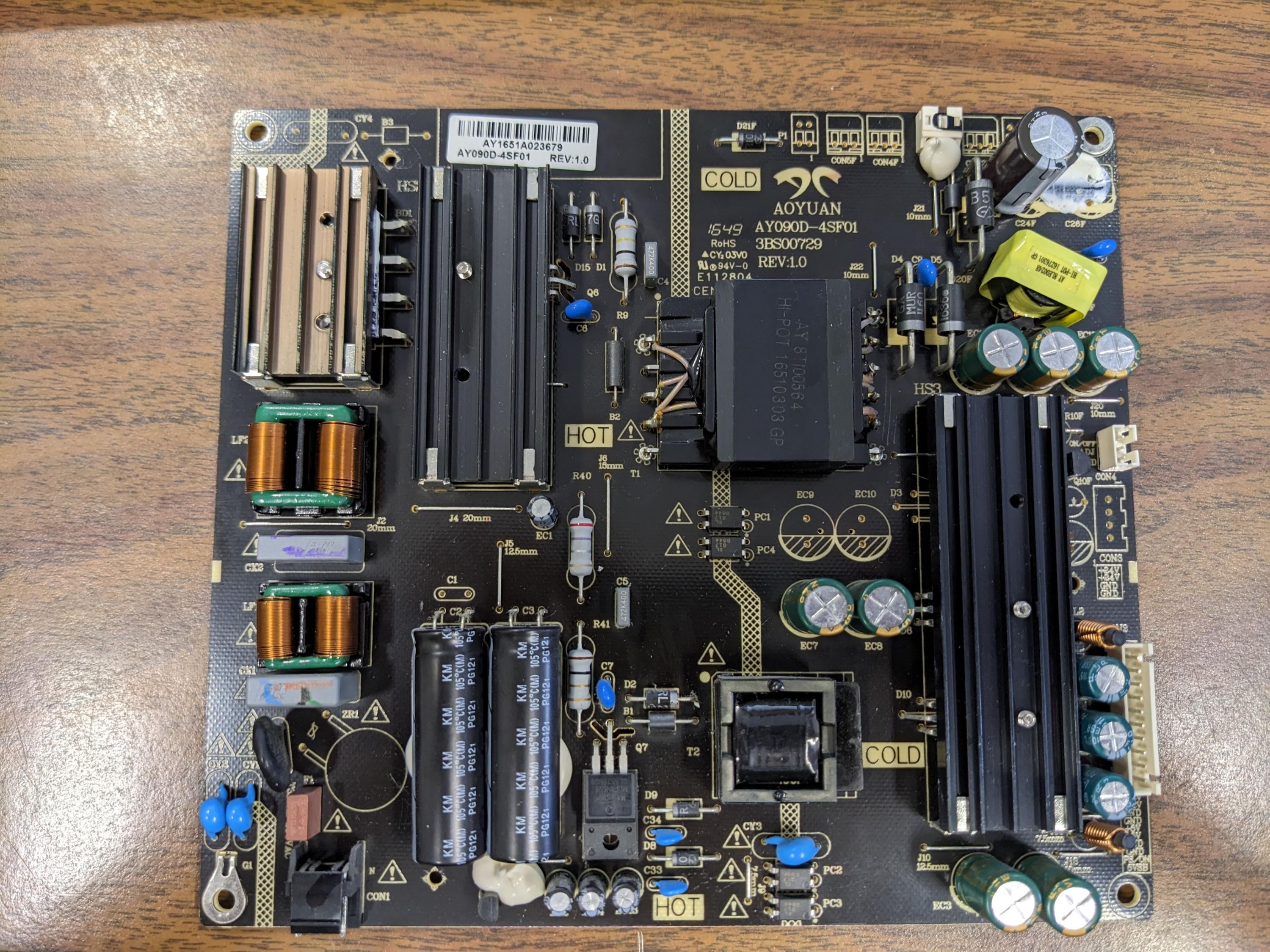

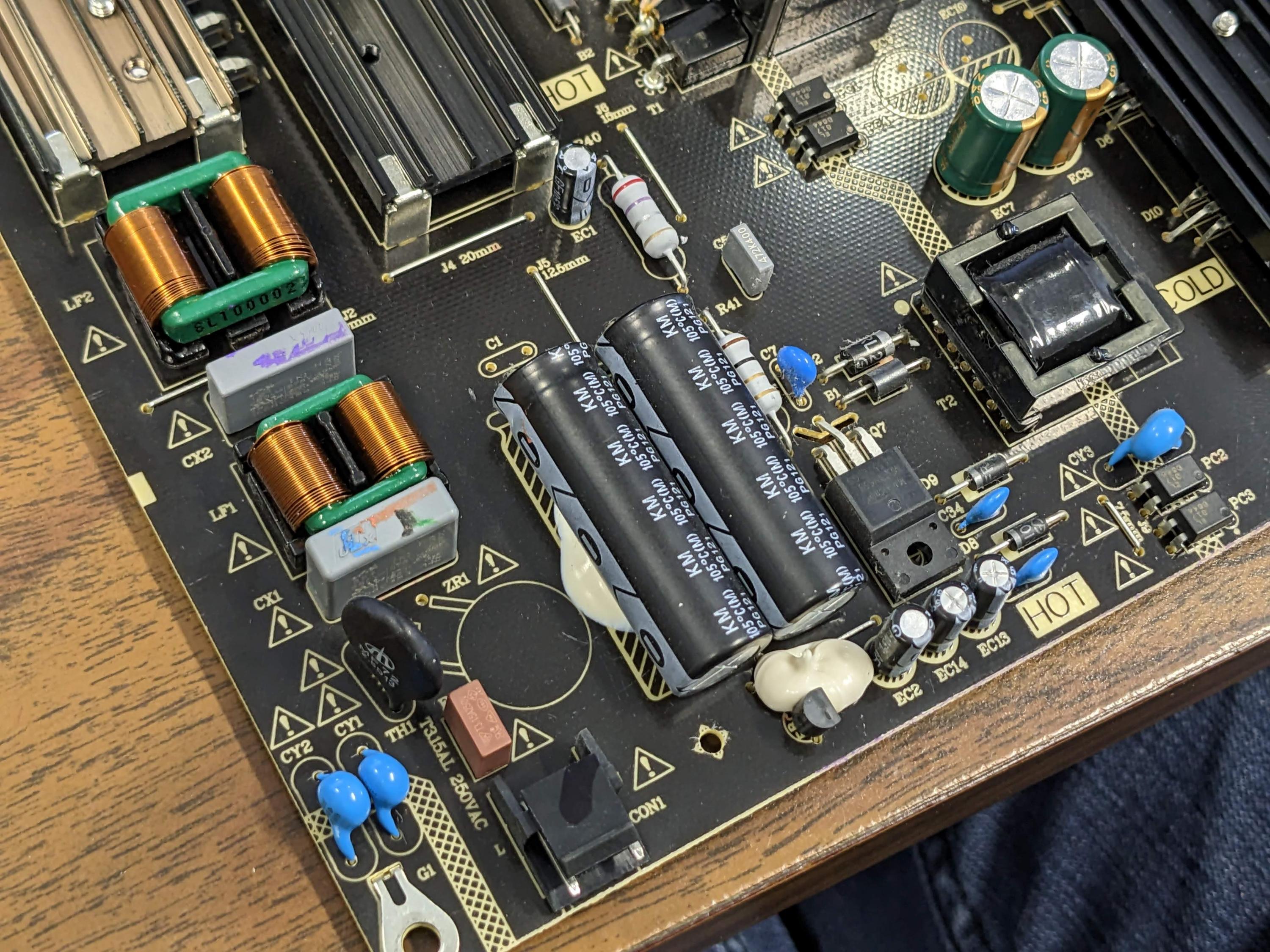

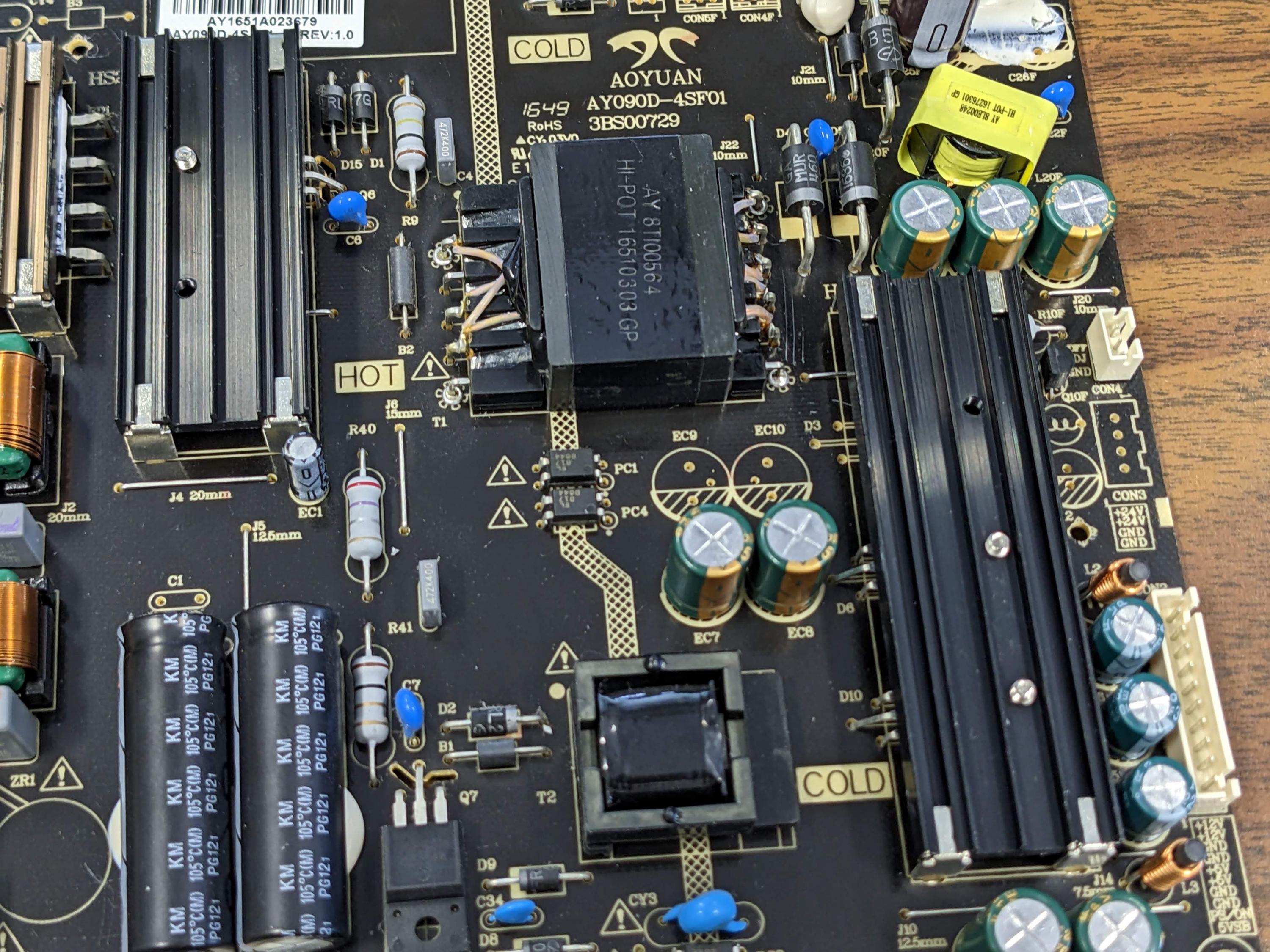

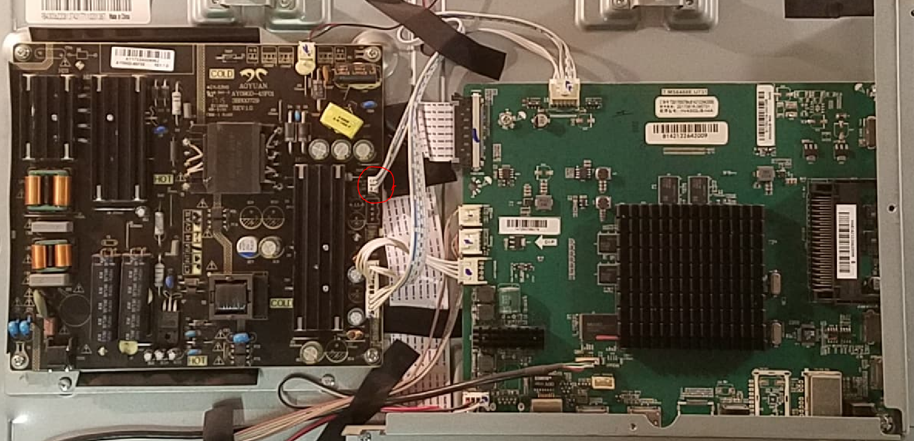

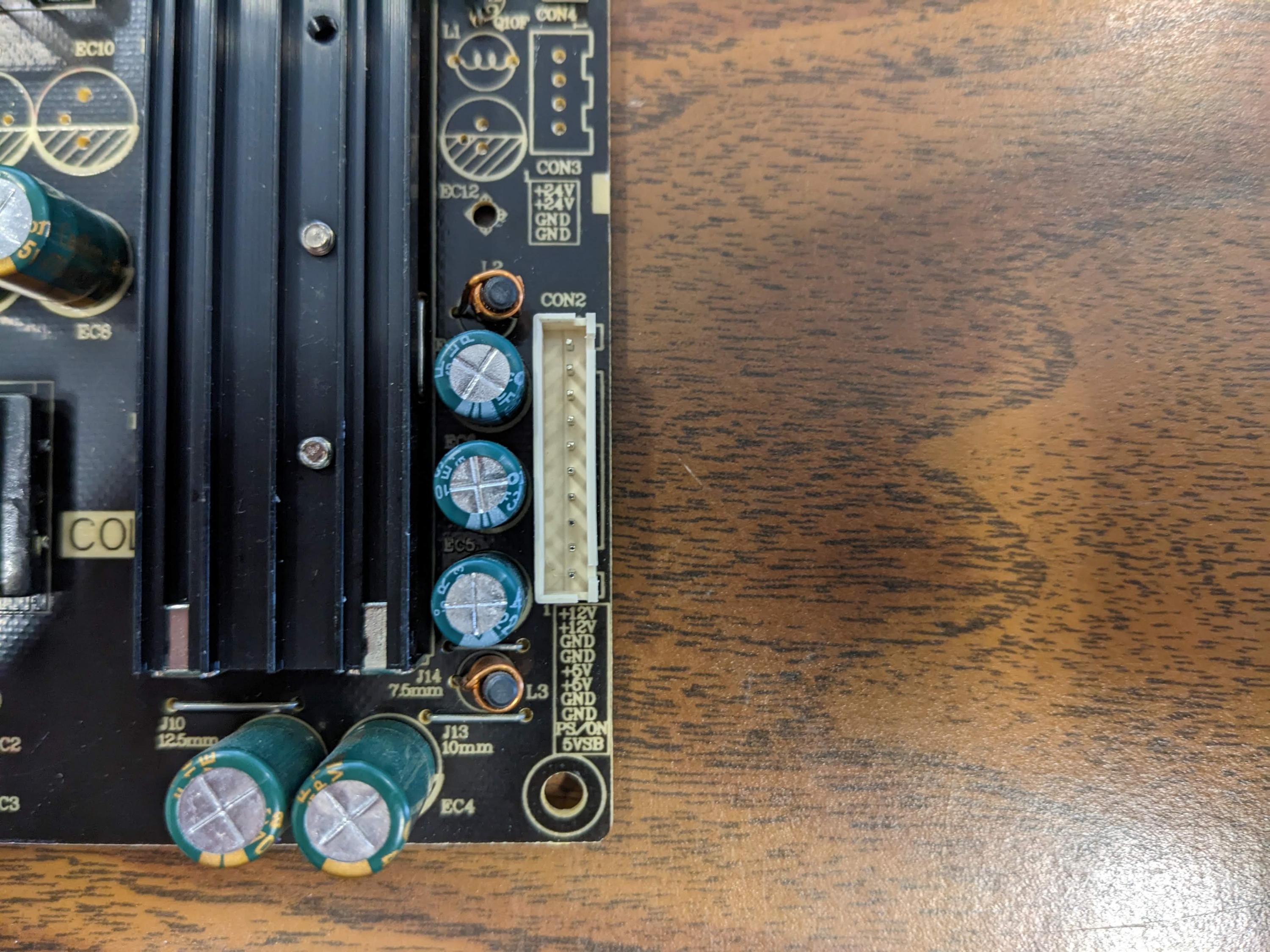

    Hey Everyone,
    I have this Haier 43" TV Power Board that is not supplying enough voltage to turn on the LED Backlights. When the TV is powered on, I get about 60 VDC at the connector for the backlights (CON3F) and this is regardless of the backlights being connected or not. I've tested the backlights with a tester and they all work (about 120 VDC for full illumination). So it appears I'm getting half the supply voltage. I've changed out the 22uF 200V cap (C25F) with a 22uF 450V that I had kicking around. No change and the original cap tests good and discharges normally.
    I've confirmed all voltages on CON2 are present and stable.
    I'm not sure on how to go about testing components further up the line from C25F, and I'm hoping for some advice!
    See attached pictures of the board.
    Thank you!

    Re: Haier Power Supply Board AY090D-4SF01
    Try checking CON 4, on-off, check it in standby, leave probe where it is hit power, what are the voltages both ways?
      Rather, you have a faulty backlight (a break, even one LED is faulty and the LED garland circuit will be broken) and there will be no current consumption at the output and the led driver will not raise this voltage.
        Ok, I will do that on the bench and let you know.
          Is that voltage supposed to generated on the Power Board or is it supplied by the Main Board? I don't remember if anything was connected to CON4, and I'm at work and the TV is home, so I can't check right now.
          For what it's worth, though, I measured 0 VDC in both standby and when I provide the PS_ON signal to fully turn on the P.S.
            Thank you for your reply, but as I stated initially, the backlights were tested and all work....
              Not exactly sure on this one but I believe thats the backlight on signal that goes to that pin and it comes from the mainboard.
                        Ok, so had a chance to hook the power board back up to the TV.
                        In Standby;
                        CON4
                        ON/OFF - 0VDC
                        ADJ - 0VDC
                        CON1
                        5VSB - 5.09VDC
                        PS_ON - OVDC
                        All supply voltages - 0VDC
                        TV Power Button Pressed (LED lights did not come on):
                        CON4
                        ON/OFF - 4.87VDC
                        ADJ - 3.12VDC
                        CON1
                        5VSB - 5.09VDC
                        PS_ON - 4.88VDC
                        All supply voltages - 12VDC, 12VDC, 5VDC, 5VDC
                        CON3F - 72VDC
                        LED Backlight Tester - 114VDC minimum voltage to turn on backlights.
                          Can you very carefully check the dc voltage of C2 and C3 with tv powered on, probe on each leg, careful not to touch it with your hands could be around 400 volts which can be DEADLY.
                          • nomoresonys
                            • Jan 2013
                            • 12272
                            • U.S.
                            Not sure about CON 3F but the rest looks ok, did you check all the diodes on top of the board?
                            • nomoresonys
                              • Jan 2013
                              • 12272
                              • U.S.
                              Maybe try heating those electrolytic capacitors with a hairdryer for a couple few minutes then try it, see if it acts any different, don't wait for them to cool off, try it while it's still hot.
                                C2 and C3 have 161.3 VDC each across them. Are those the ones you are suggesting to heat up? I have a heat gun.
                                D4, D5 and D20F are all about .4 VDC one way and open the other way. So good I think?
                                  I tried heating up the board with the heat gun and the only reaction i got was a slow decrease in the 72VDC output to the LEDs as i heated up the board in that corner (see attached picture 3). It dropped as low as 67VDC and when i removed heat, it climbed back up to 72 VDC.
                                    check backlight supply while tv is booting. if it goes up (more then 114 volt in this case) and drops then back lights are problem. if this is not happening then give 3v to 5v to Bl on and Bl adj pin on connector.
                                      No a heat gun could potentially get them too hot, a hairdryer for a couple minutes is all that's needed, heat them all, be sure to get the ones near CON 3F too, it's just a test that can temporarily lower the esr and make a weak cap work for a bit, usually just heat all the electrolytics and try it, it won't work if a cap is too far gone but your caps may be ok.
                                        Is the 161.3 in standby, is it the same when powered up? I would expect it to go up to about 400 volts or so when powered up.
