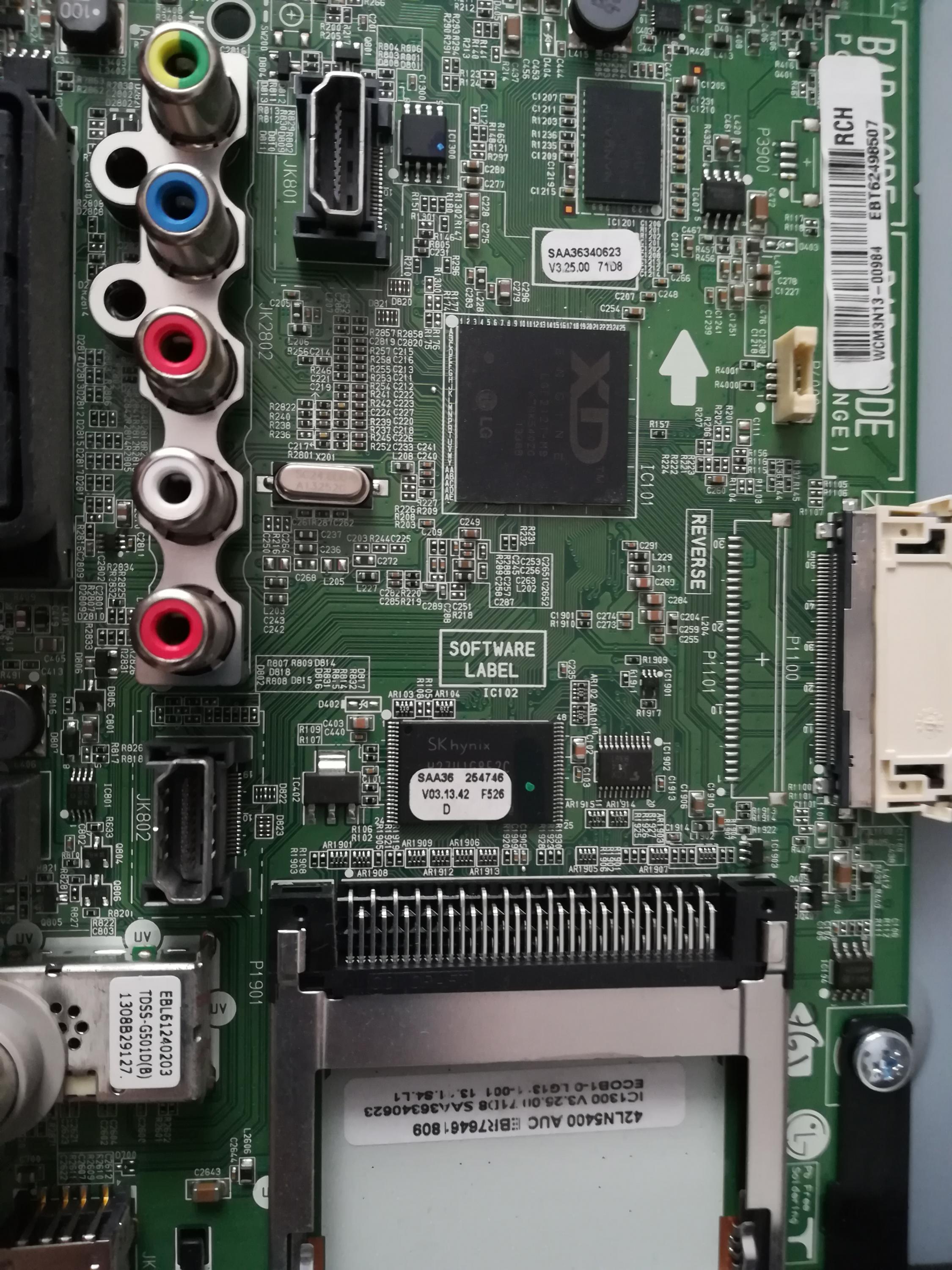

    I would like to ask for a little help with this TV. It belongs to friend of mines and he said, the TV is restarting. He uses TV only with HDMI as input.
    When I power it up without any video source, it actually works fine - I can see LG logo turning around with "no signal" label, I can browse settings, etc. I tried to hooked up HDMI cable from my computer, and it works fine too ( tested only short time, like 5 min ). But when I connect a USB flash drive, it restarts almost directly every 10 seconds. All voltages looks stable, both on power board and main board. When TV restarts, voltages just fall down to 0V. So no fluctuating or something like that.
    Any idea, what can be issue here? I thought firstly about eeprom firmware issue ( when I excluded power supply issue ), but I think, there would be no menu, no remote control reactions, etc with corrupted eeprom. I noticed, the main cpu is quite hot, can't hold a finger on it ( no heat sink on it from factory ), but it is probably normal I guess ( no restart during input from HDMI, so ). Or is this issue all about thermal protection? Will be glad for each clue, thanks in advance.

    Well, looks like I can't figure it, what causes these restarts. Can someone at least confirm, if it is mainboard issue? If so, which of these two board numbers is correct to find a replacement board? ( upper sticker, or the right one? ). Because I found some used one with number EAX 64891403 (rev 1.0) , but next number is EBR75890817.
    Thank you.

      Re: LG 42LN5400 - restarts every 10 sec
      What's on the USB ?
        Some data ( linux installation files ) and some movies in separate folder. Size of usb memory is 64GB. Anyway, friend said, it behaves the same with HDMI after some time.
            The TV understands jpg and mp3 off a USB stick.
            How long does it stay on HDMI for you?

                I tested power supply only inside TV, so you recommend to disconnect power supply board, bridge PWR_ON pin to 3.3V via some pullup resistor ( to power the board on ) and load each power lane with some external load?
                @diif: oh, I thought that TV can play some movies too. Nevertheless, TV shouldn't act like this even with USB full of unsupported files. On HDMI it worked for me more than 15 min, actually didn't test longer. That's why I stick to USB, since here it crashes all time, and immediatelly.
                @dalek1967: there are no visually damaged electrolytic capacitors on the power board ( no electrolytic caps on main board, only ceramic smd ones ). And I measured all power lanes with an oscilloscope, during normal working, and during crashing. There was no weird waveform, no voltage drop, just nice stable DC voltage.
                // Forgot to say, sometimes TV freezes instead of restart. I started TV with usb plugged in, TV restarted itself after 10 seconds, and then it freezed. All voltages were present, and stable on power board.
                  Maybe unlikely solution on USB, I'm guessing your 64GB USB is formatted exFAT? Maybe try smaller USB formatted to FAT32? But hard to imagine TV firmware crash if not understanding USB filesystem.
                  I fixed one of these that would blank out its backlights after awhile a few months back. I forgot to post result which is rare but it happens and unfortunately don't remember what I did to fix it haha. I did reflow the main SOC. Can try that if you have good equipment or willing to bake main board in toaster oven @ ~400F for 7-8min (lift board up on 4 corners with aluminum foil balls so bottom doesn't sit on the tray) Often, toaster oven is best for people without good reflow equipment. Heat gun can fry the SOC/board if not careful, cold floor + heat gun can wrap and crack things etc.
                  https://www.badcaps.net/forum/showthread.php?t=108008
                    try it with a much smaller usb drive just to see what happens, like 4gb if you have one, can also try hook up your hdmi and let it run if it don't mess up maybe your friend just has a bad hdmi cable, did he try a different cable or hdmi device?
                      Well, I will try firstly usb with fat32 file system. Next will try to reflow and as last option I will buy replacement mainboard. So can someone help me with these board numbers, from my question in post #2 ?
                      @nomoresonys - he didn't try anything, just bring it to me. But since it happens to me with that USB, I believe, something is wrong with TV. But yeah, I can try, thanks for advice.

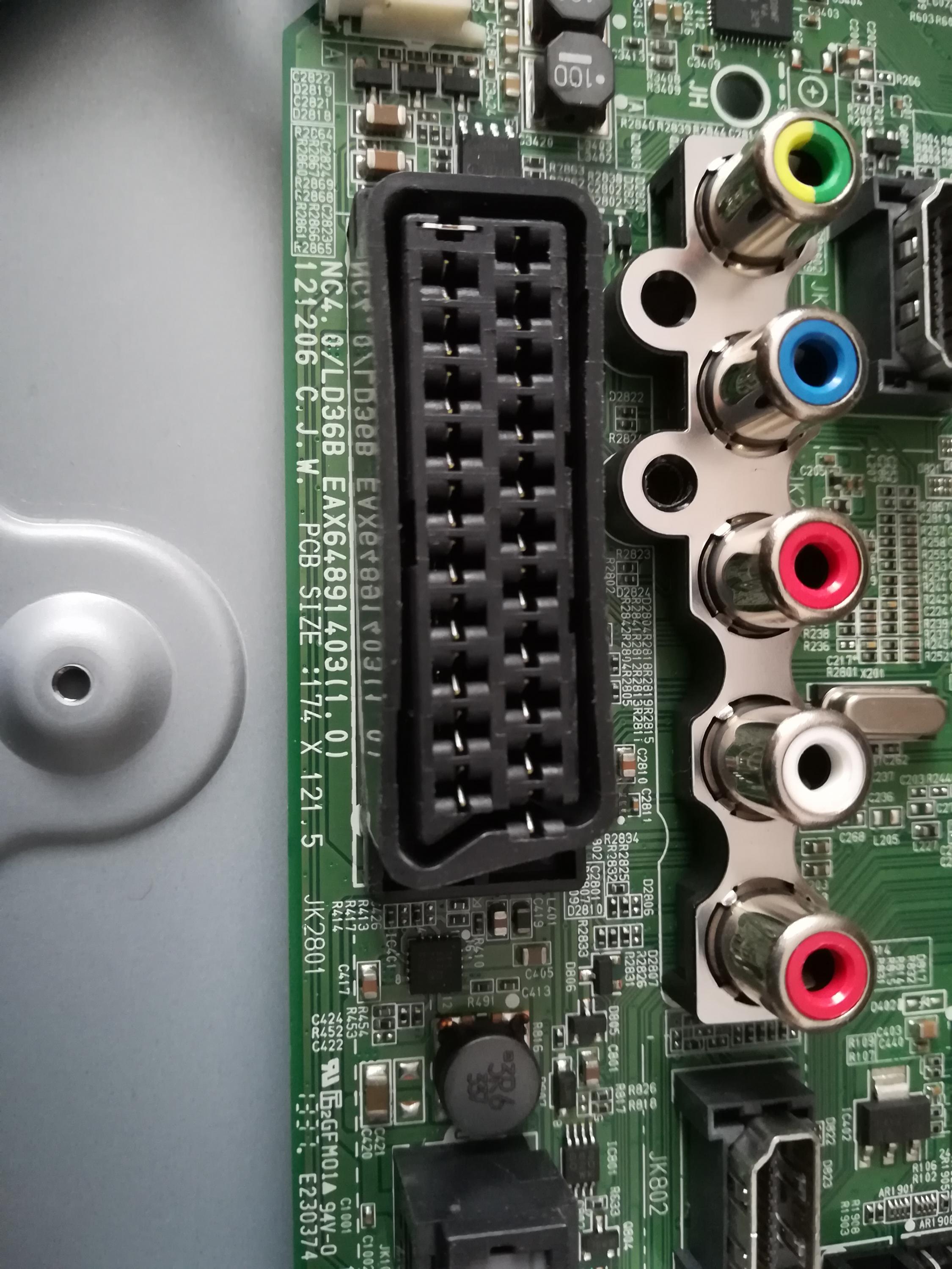

                        big white sticker EBT62498507
                            So the replacement I found wouldn't work then, even if it is from same model TV? ( only number, which fits is EAX 64891403. By a photo on internet it is exaclty the same board ).
                            Meanwhile I was thinking about one possible culprit: here on my desk, TV crashed only with that 64GB usb. I fix graphic cards more often than TVs, and this behaviour looks similar to VRAM failure in gpus. Is it possible, that this is also memory issue? Never met it in TV fixing.
                              not sure but they are selling eeproms on sj and ebay.
                                there are nothing wrong with TV... its the source problem.
                                however LG Tv had command IN_STOP.. this will repair and make hard reset to the LG .. in case there are fault at TV
                                  I reflowed the RAM memory module, still same. I think, no need to reflow cpu at this point. Do you think, that eeprom binary can be damaged? I mean, everything works, it just restarts at some point.
                                  @Diah: according to google, I was able to get inside hotel mode setup, but surprisingly, there is no Factory Reset option. So I will leave it like it is, try to use different source and cables in my friend's house, and if it won't change, ordering new main board is last chance.
                                    I bought a 32LN5300 main board for the 43LN5300-UB I was fixing. Worked. Board looked same but different PN (unfortunately I don't remember the PNs) I read somewhere (can't find post now) all LN main boards between ~32-50" are compatible. Pros would know for sure.
                                      Thank you very much for sharing this experience. And thank you all guys for helping me too. I will try to do something, and if I get some result, will update this thread ( if not, then it doesn't work ).
