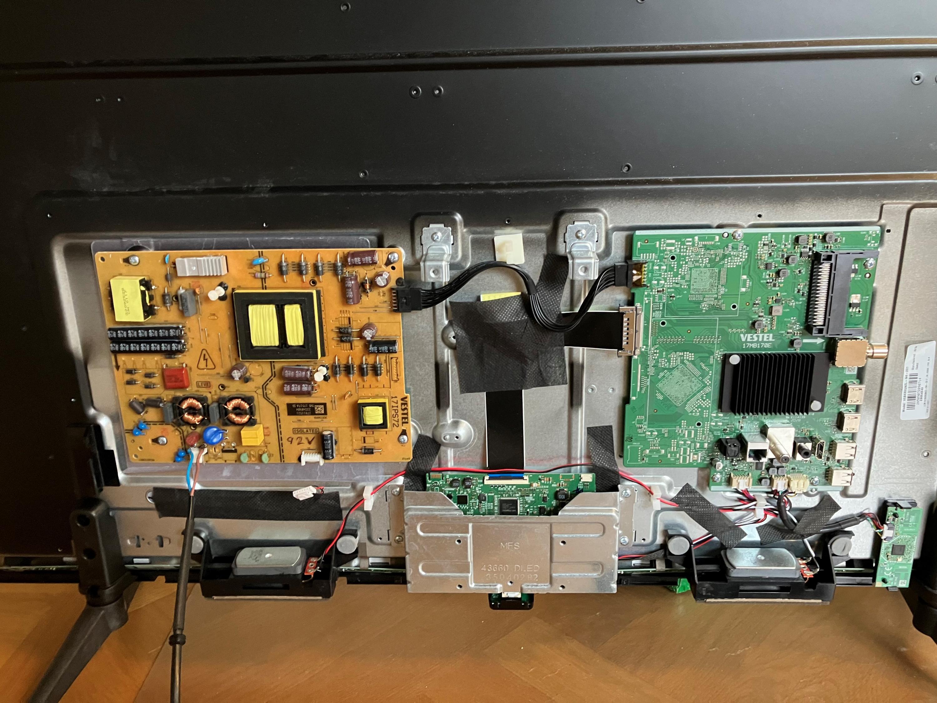

    I have an Andersson LED4345UHDA where the red led lights up when plugging in but doesn't start by the remote or the button on the tv. I have also tried a new remote.
    It has a Vestel 17IPS72 power supply and a 17MB170E board as seen in the picture. It seems like all outputs on the black connector are giving the correct voltage, 5, 12, 24v etc. However, when I load the 12v output with a 12v 5w lamp, there is no light and the voltage drops close to zero. I am no electronics pro but I looked at the capacitors on the board and couldn't see anything wrong. I haven't made any measurements on components. The voltage of the white connector(going to the background light?) is around 4-5 volts when its cable is not plugged in
    Instead of investigating the power supply more I bought a used one on ebay and installed it. The TV still don't start up and when testing the “new” power supply it has the same problems, good voltage when nothing is plugged in and the 12v out goes to almost zero when the 12v 5w lamp is plugged in. The white contact also has 4-5v when its cable is not plugged in. However, the power supply seemed to work for a few seconds when I pulled and pushed on the 230v wall outlet cable close to the power supply. The 12v lamp and the backlight lit up for a short time. Then I thought that the 230v cable or its contact to the power supply was bad, so I changed to another one. To rule out the contact I soldered the new cable directly to the pins of the power supply, but it didn't solve the problem. I have two theories about this:
    1. The “new” power supply wasn't functioning and has similar problems as the old one. How should I continue troubleshooting the power supply?
    2. There is a shortcut on the main board which broke something in the “new” power supply when I plugged it in, maybe I have to troubleshoot the main board too?

            I have now tried the backlight with 9v batteries in series. I have demounted the screen and all LEDs is working fine when i power the backlight with around 80v(from batteries) from the main cable on the power supply.
            I have tried turning the tv on both from the button on the tv and the remote control, nothing happens. The backlight only gets around 5v(should be 92v). There is both 12v and 24v output from the power supply to the main board.

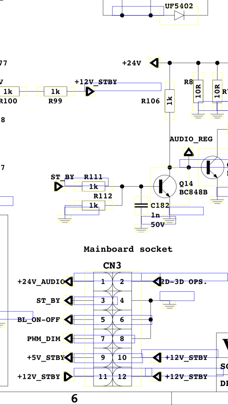

                        The power supply boards give both 12v and 24v but no 5v when I test the output pins, maybe 5v standby is not needed?
                        Check if Q18 is populated on the power supply board, if it is not then the power supply does NOT provide the +5V_STBY
                        This is an always on power supply so it provides +12v & +24v at low current in standby mode, (the main board will provide all the lower voltages)
                        These power supply boards are a universal board and can be configured many ways depending on the manufacture who uses them.
                        There should also be a number on the power supply board 17IPS72-Rx where x is the revision number
                        The ST_BY pin (CN3 pin3) is the power supply ON/OFF signal coming from the main board, does this voltage change when the power button is pressed?
                        BL_ON-OFF is the backlight control pin

                          Re: Andersson TV LED4345UHDA not starting
                          Q18 is not populated so the power supply should not deliver 5v. The ST_BY pin does not change voltage when I try to turn on, neither with remote or button on tv.
                          • R_J
                            • Jun 2012
                            • 9588
                            Your fault is likely with the main board, The reason you can't test it with your 12v5w lamp is that the power supply is in standby, so the pfc circuit will not be operating and the main smps will likely be in burst mode only, so only enough current is supplied to keep the main board alive and in standby.
                                I measured resistance between ground - ST_BY and ground - BL_ON-OFF, no shortcuts on them. With everything connected and plugged in the outlet, I applied 3v from a stand alone power supply on ground - ST_BY and then ground - BL_ON-OFF with the following results:
                                3v on ground - ST_BY: the red led on the optical sound port shuts down
                                3v on ground - BL_ON-OFF: backlight is switched on
                                3v on ground - ST_BY and ground - BL_ON-OFF: no backlight and the red led on the optical sound port shuts down

                                  When I made some measurements on the main board, the backlight suddenly came on and now it's on all the time.. I plugged the 230v cable out and then in again, the backlight is on all the time when it's plugged in. It seems like I triggered something on the main board since the BL_ON-OFF now gives 5v. I don't get anything on the screen except backlight when trying to turn it on.
                                  The red led on the optical sound still turns off when applying 3v on the ST_BY pin, but the standby led under the screen stays on.
