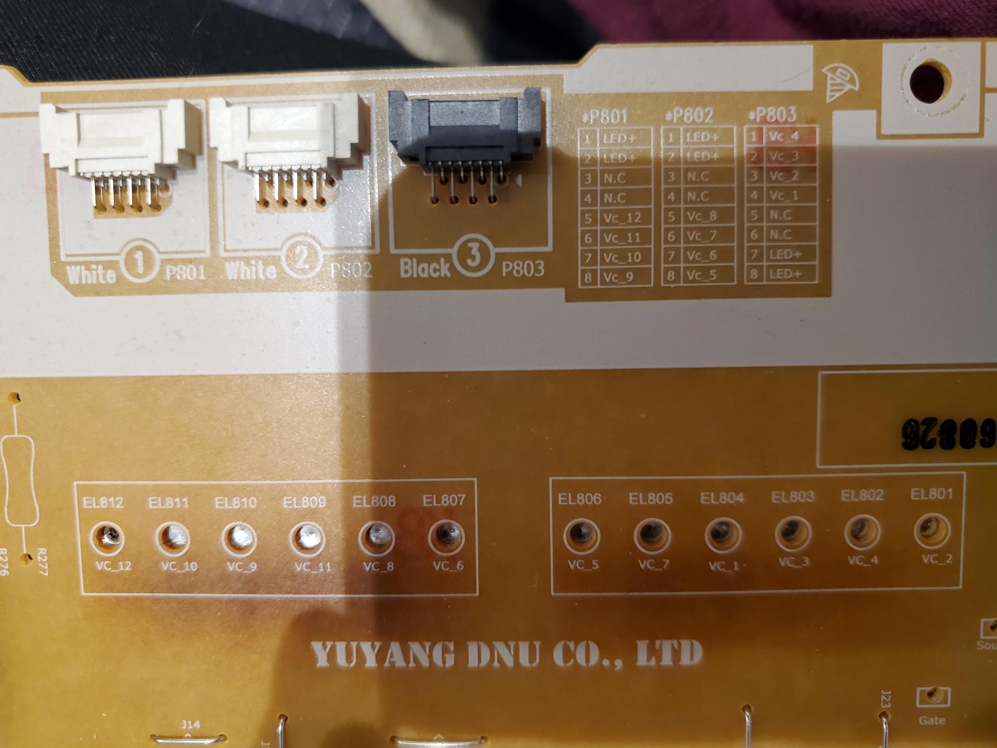

                                OK cool thanks. Would you mind explaining what and how to exactly test sorry?
                                I think you will have me test with the BL ribbon connectors connected but use the pins of the connectors to test (I have some hook leads.) But not sure what I'm testing just the LED+ pins while tricked on?
                                • Diah
                                  • Feb 2013
                                  • 6439
                                  #76
                                  Re: LG 70UH6350 (UB.BUSMLJr)
                                  okay... first look at the PWB socket from down side.. see for example socket P801 if the LED+ 1 & 2 are connected together at circuit. or separated

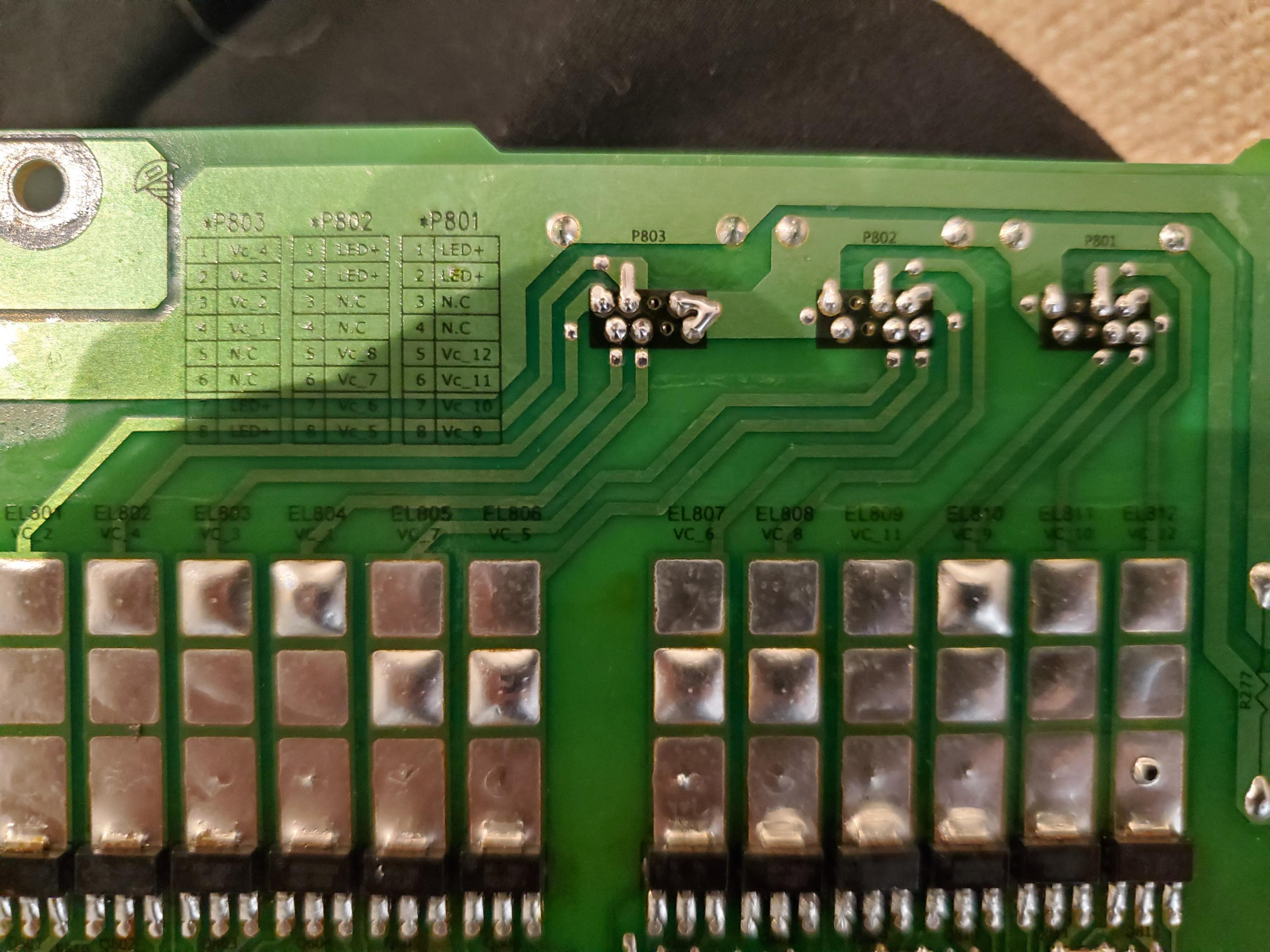

                                      #78
                                      So I am not sure how pins are numbered. I see from a overhead view oriented as picture that pin 1 on each is the upper right. But is pin 2 on the row under or would it be adjacent left?
                                      • Diah
                                        • Feb 2013
                                        • 6439
                                        #79
                                        Originally posted by nonsub
                                        Here pic. I will figure out the answer.
                                        they look all 3 sockets led+ are connected together
                                        if this case then take one as anode probe and measure all other vc .. write down the result

                                          #80
                                          So if I am reading right then P803 anodes are joined pin 7+8 right?
