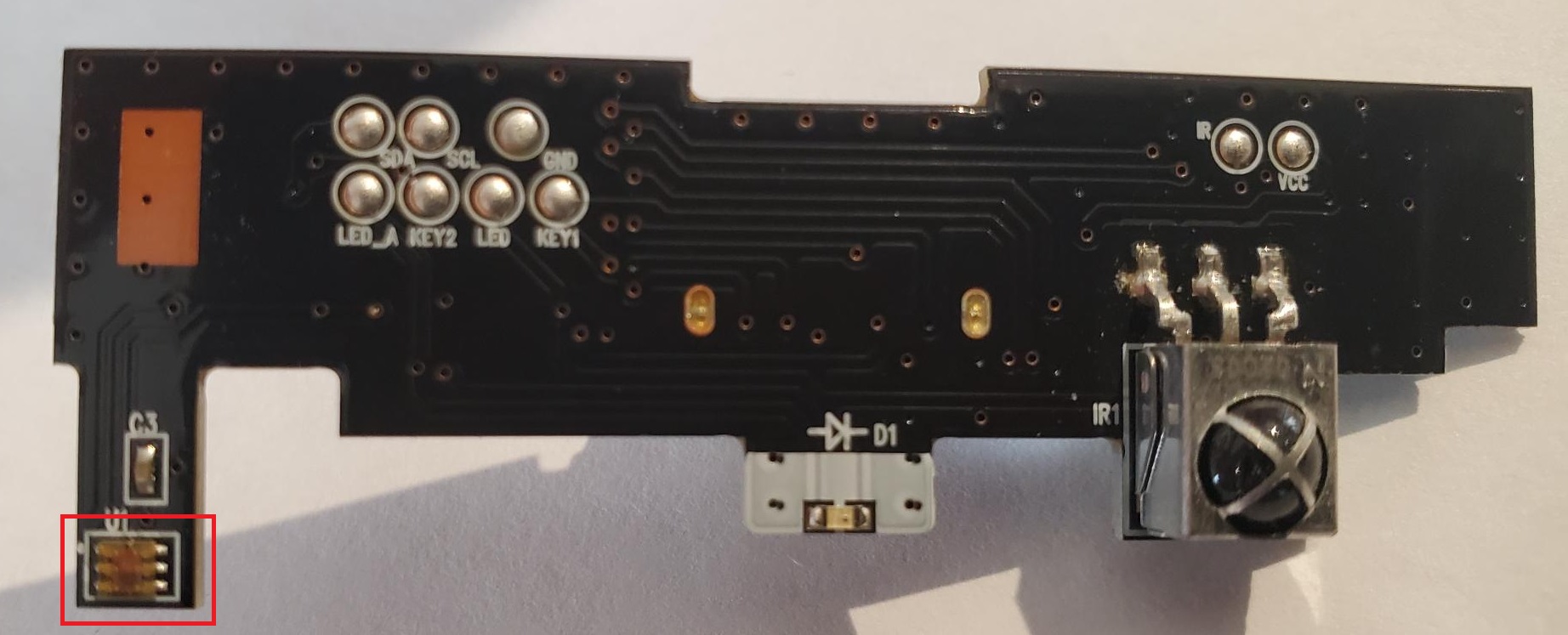

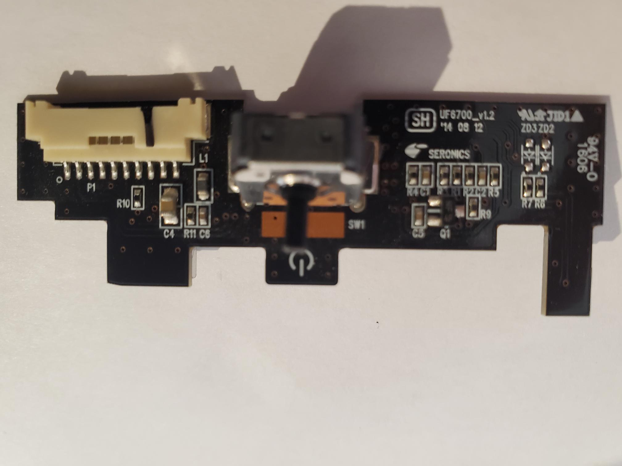

    Re: LG 70UH6350 (UB.BUSMLJr)
    Originally posted by Diah
    never left only the light eye section on the IR board could be shorted.. it share the 3.5V which MB DC to DC convert to use for eye and DRV_ON.. IR / Wifi / BT so you check if there at eye 3.5V or it dead some where
    But the eye is working fine... RC standby/standby exit so?
    Checked left and right pin of eye and yes 3.5v all the time in both standby and exit standby.
    Remember I said on PSU there is a wire bridge labelled FAULT. This is not useful for any test?
    thx
    • Diah
      • Feb 2013
      • 6357
      #122
      how do you know the light eyes working LOL and you don't have any BL ???
      eye for light are different from IR retriever
      remember you wrote before P-DM1 & 2 are very high.... if eye defect will tell MB turn off..
      the eye located at the right side of IR boards.. where at the middle the LED indicator and on other side the IR receiver

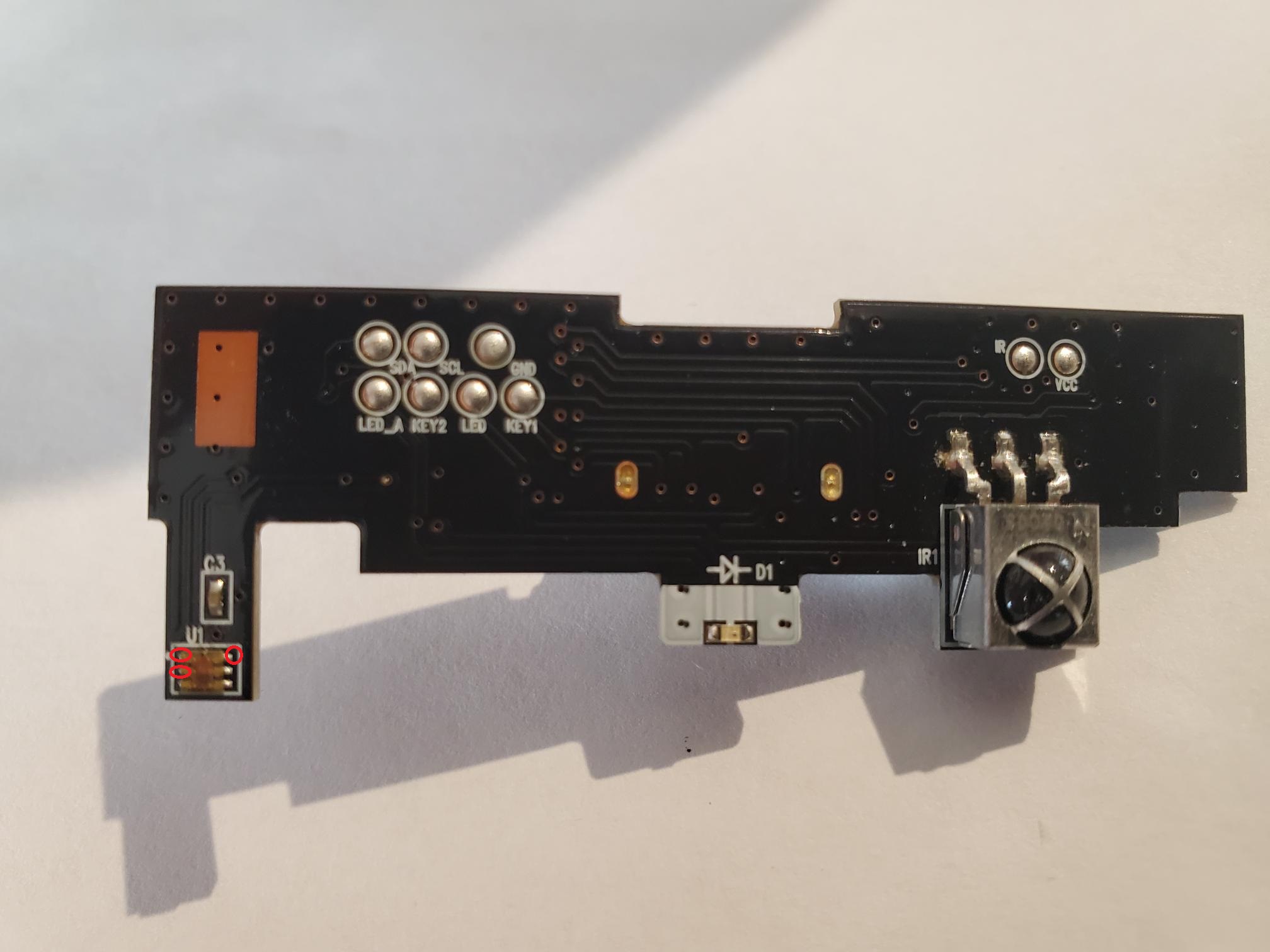

            #125
            this is the eye
            actuality it tested with oscilloscope signal Freq. but it could also work with Analog measurement device.. same the way to IR receiver.. it will move little high or low regard to signal or light source..
            but we are now interested on the 3.5V on it.. if it exist or dead some where..
            • nonsub
              • May 2018
              • 84
              #126
              this is the eye
              So meter ground to chassis an red probe each of the 6 pins?
              • nonsub
                • May 2018
                • 84
                #127
                3.5V on 3 shown pins both when in/out of standby.

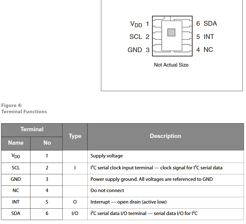

                  #128
                  sorry i cant answer this... as i don't have under hand the specification of eyes chip..could other member have experiences with this boards... but usual it should as i know and saw before at other type it will be only one side active with STB V. 3.5 here you show cell 1 go through however if you look at it in Microscope you will find the inside cell have same infrastructure of others
                  • nonsub
                    • May 2018
                    • 84
                    #129
                    OK I shaved off top of chip and viewed with electron microscope. Attached diag. What now boss?
                    • Diah
                      • Feb 2013
                      • 6357
                      #130
                      you are really Master at destroying
                      Important Note: Never measure Currents direct on the chip... you have soldering test points for SDA /SCL VCC. should be used for testing
                      so how you are going to test frame bit I2C signal ?? what kind of equipment's you have ? if nothings at this level... then i will explain it in simple words...
                      you wrote before V measurements at STB condition... where it show Normal just right now.... SDA high.. SCL high too...
                      when the TV at Start condition --------->
                      SDA line switches from a high voltage level to a low voltage level before the SCL line switches from high to low. ( so you need to watch this action... if both remain high ) we have here an issue with frame bits.)
                      on other hand... you have on the back side of the boards SDA/SCL.soldering test points.. follow them to the socket and remark the pins of them on IR socket.... and on MB side..
