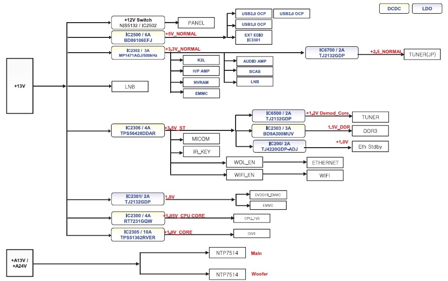

      #142
      Re: LG 70UH6350 (UB.BUSMLJr)
      you welcome
      any way if any face this model or you want to work on MB Hardware..... this is the power chart with IC NO on MB... must be checked the in and out.
      • nonsub
        • May 2018
        • 84
        #143
        Originally posted by Diah
        you welcome
        Yes before I measured some of these. I notice that ST_BY etc always 7.8V though not 3.5V as diagram but must be some models diff.
        • Diah
          • Feb 2013
          • 6440
          #144
          the diagram you posted at first page are made by some idiot.. yours UH7000 not as you wrote 6350
