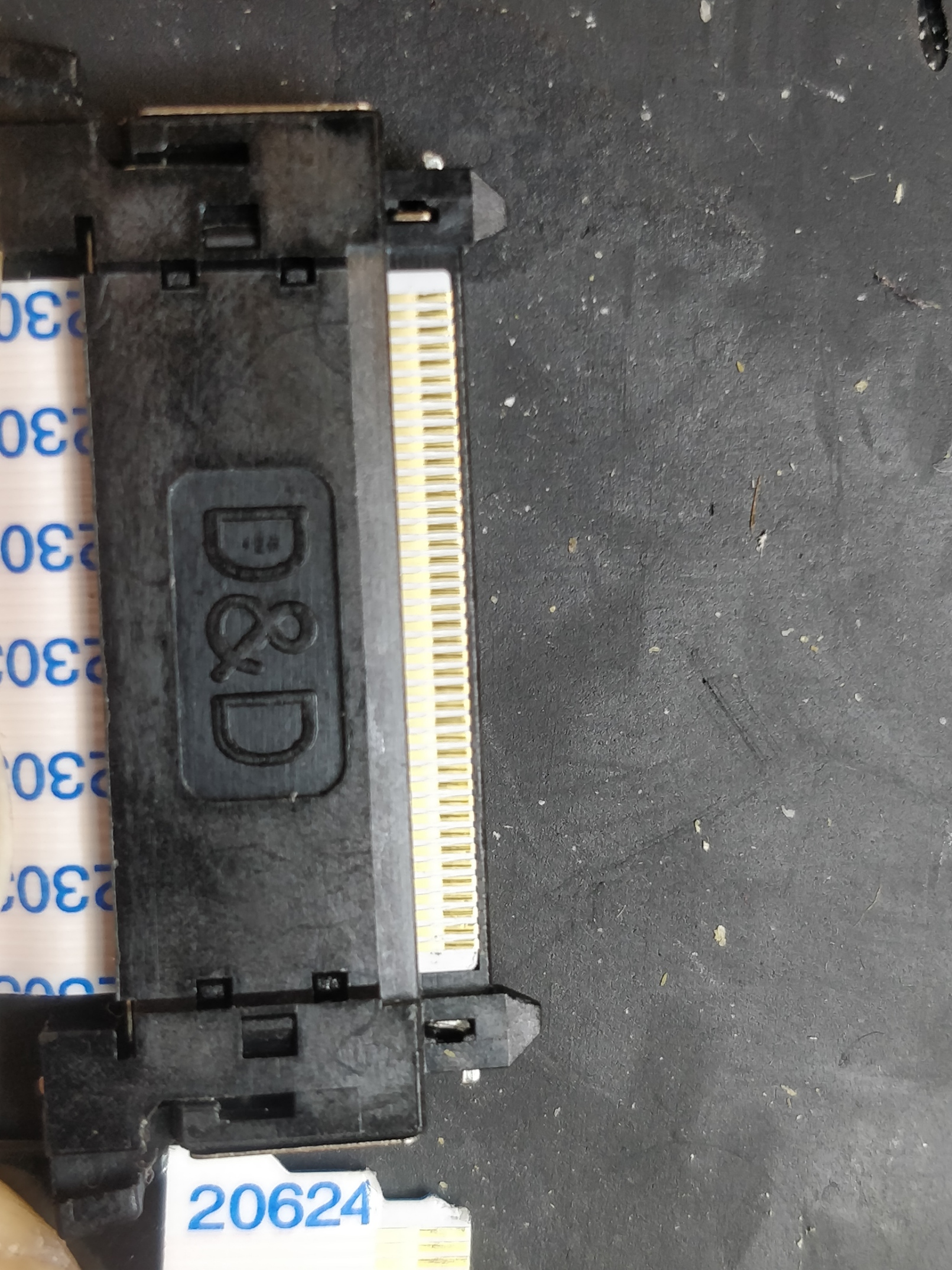

    Hello everyone!
    Does anyone have a dump file for this model of TV?
    Motherboard number is: 715G7772-M01-B00-005K
    EEPROM IC: 25L1606E
    My TV is stuck in cycling color mode and I can't get out of it.
    I tried to erase the IC but it didn't help.
    Thanks in advance!

                  I guess you have an LG panel with an open cell t-con, when there is no signal detected from the mainboard the t-con goes in a WRGB mode.

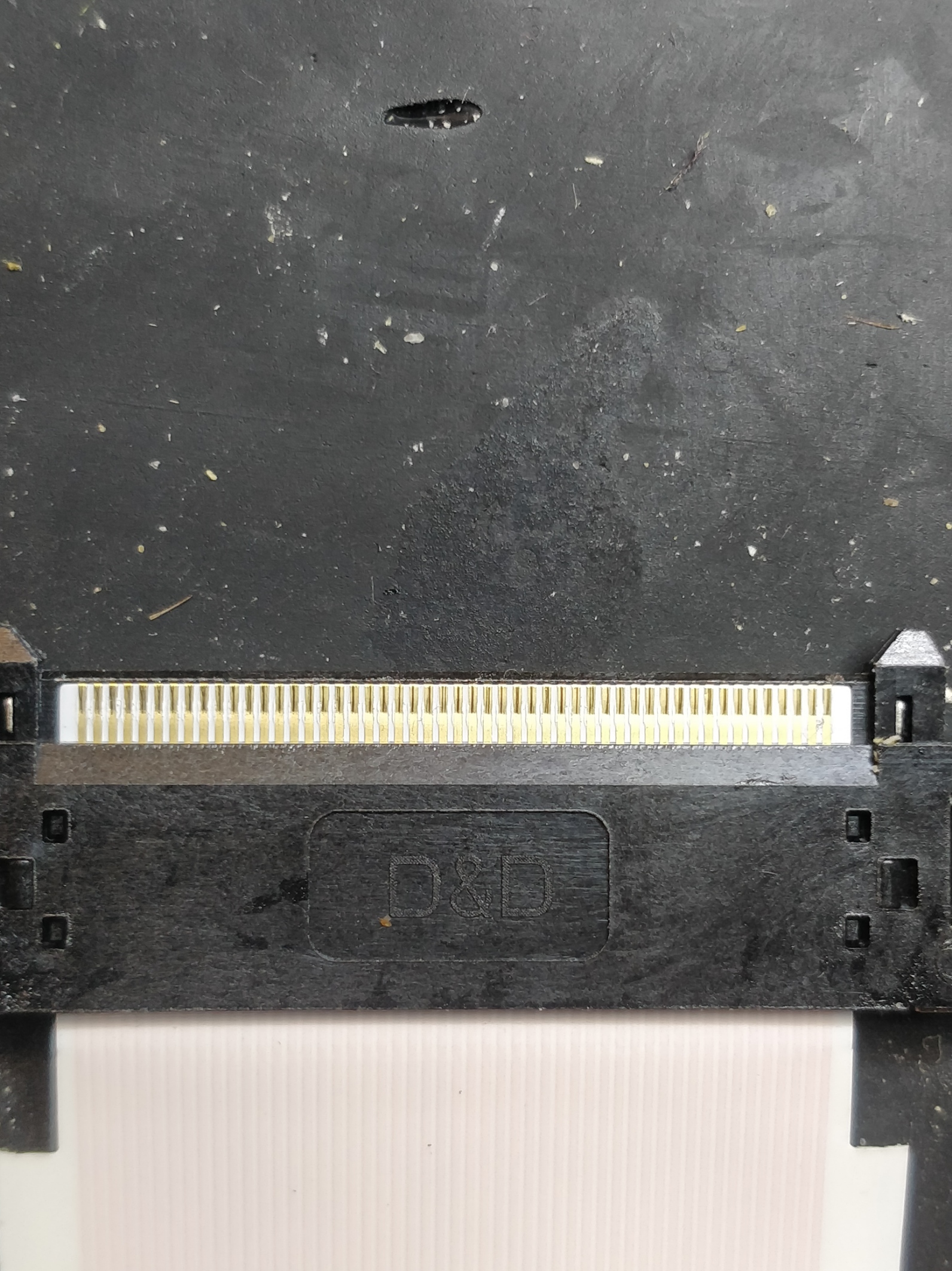

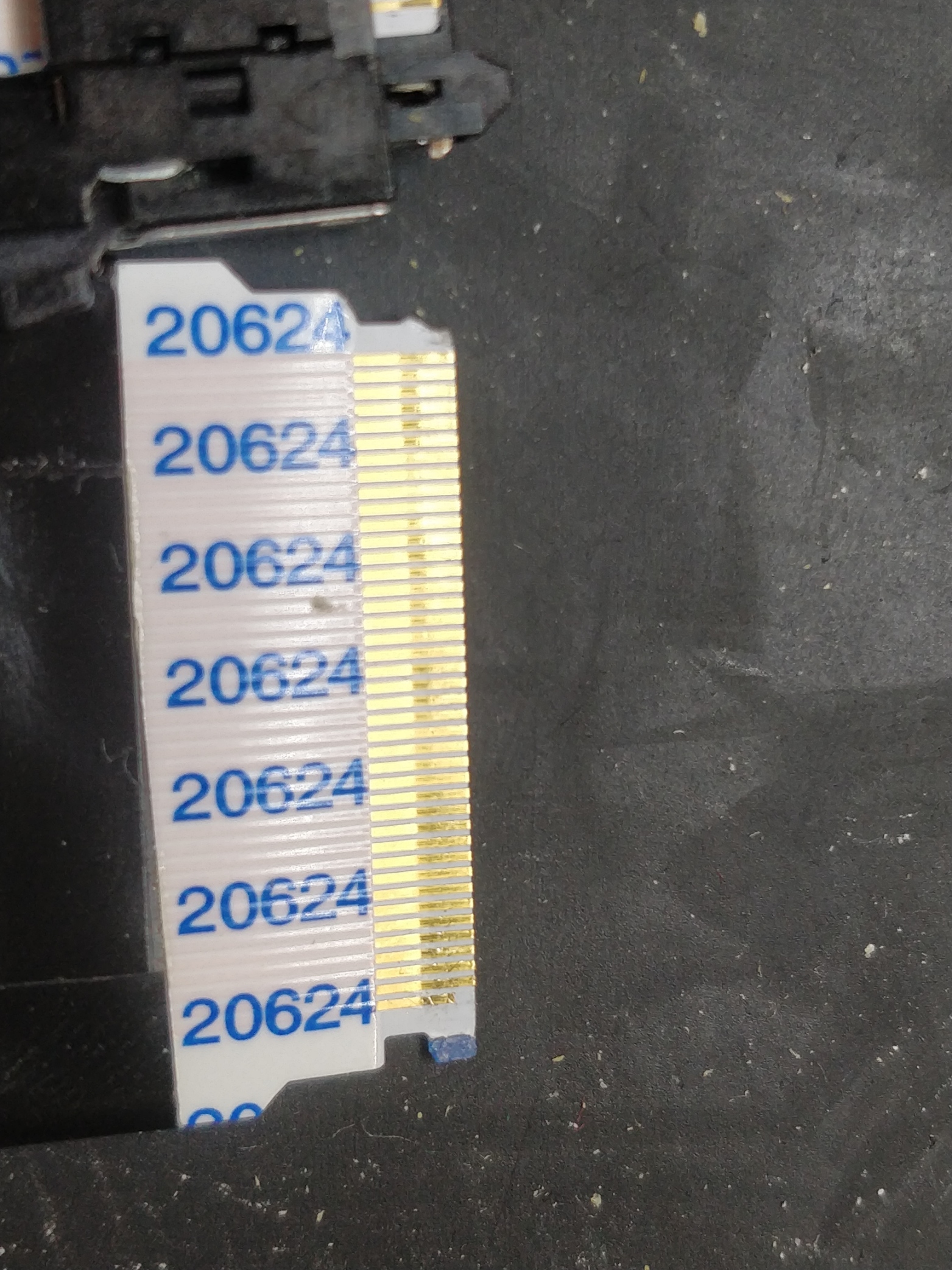

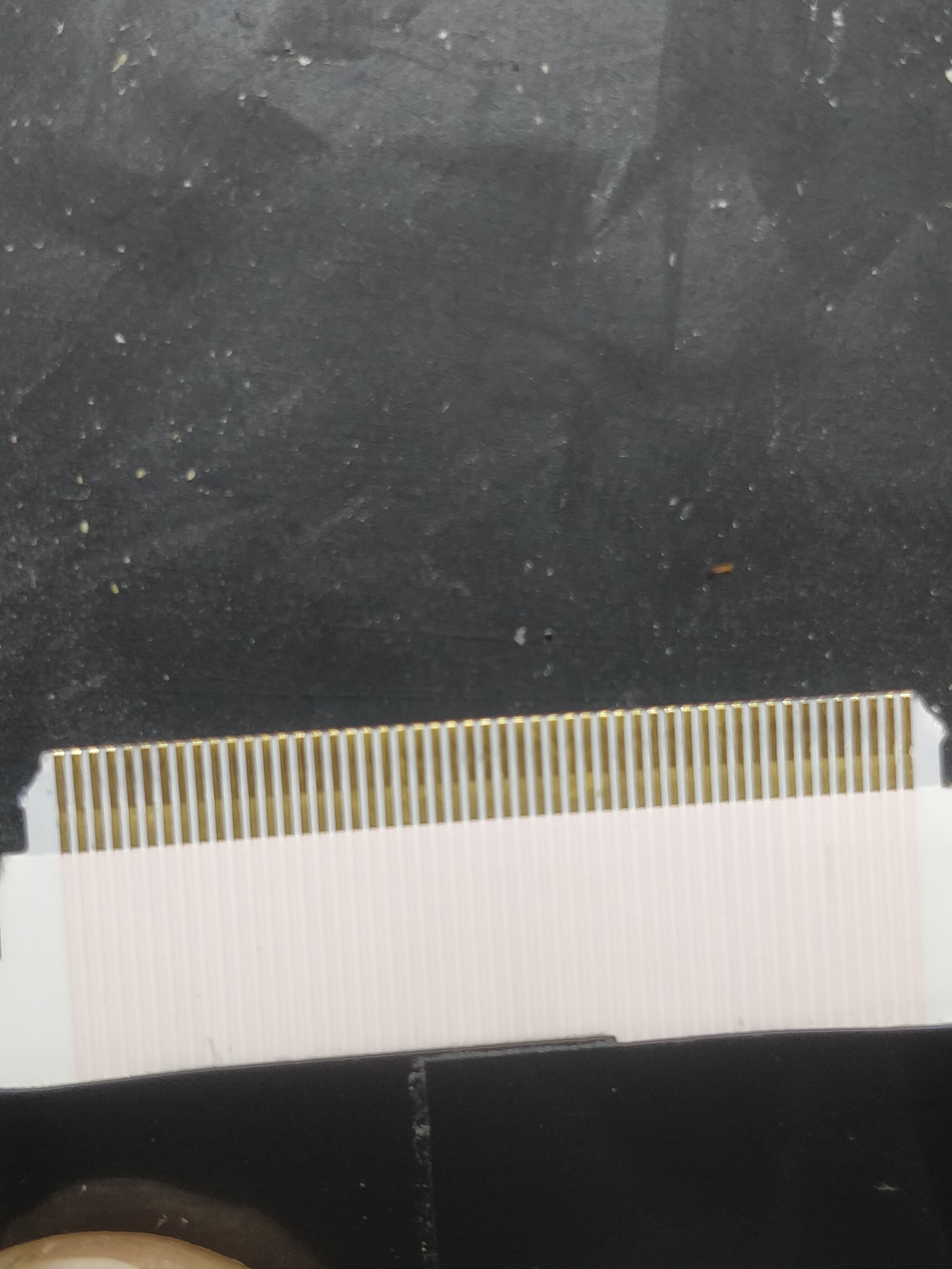

                    I checked on the LVSD cable and the little notches on the side is torn off. The pins looks all intact both on the cable and in the sockets. Maybe without the notches its slides in the connector and by it makes it shorting/wrong contacts?

                        show us clear photo of yours LVDS End from both side

                          Here are some close ups. I noticed a small bit of contact is missing from the smaller cable end.
                          • Diah
                            • Feb 2013
                            • 6399
                            Re: Philips 43PUS6501/12 EEPROM request.
                            try Jumper the lost pin with extra thin cable from board to board. and clean the socket.. it could be the reset of the pins doing short some where

                                Thank you for the advice, will try it with some enameled copper wire If I can find some.

                                  Replace both cables and never use cables without the nodges!!! If not placed correctly centered there could be a S/C.

                                    plus 100, don't risk shorting things out, just get some new cables.
