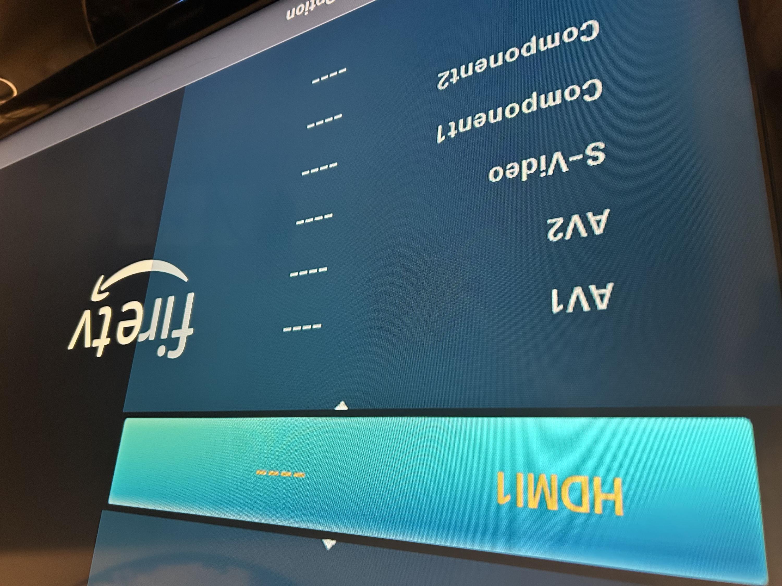

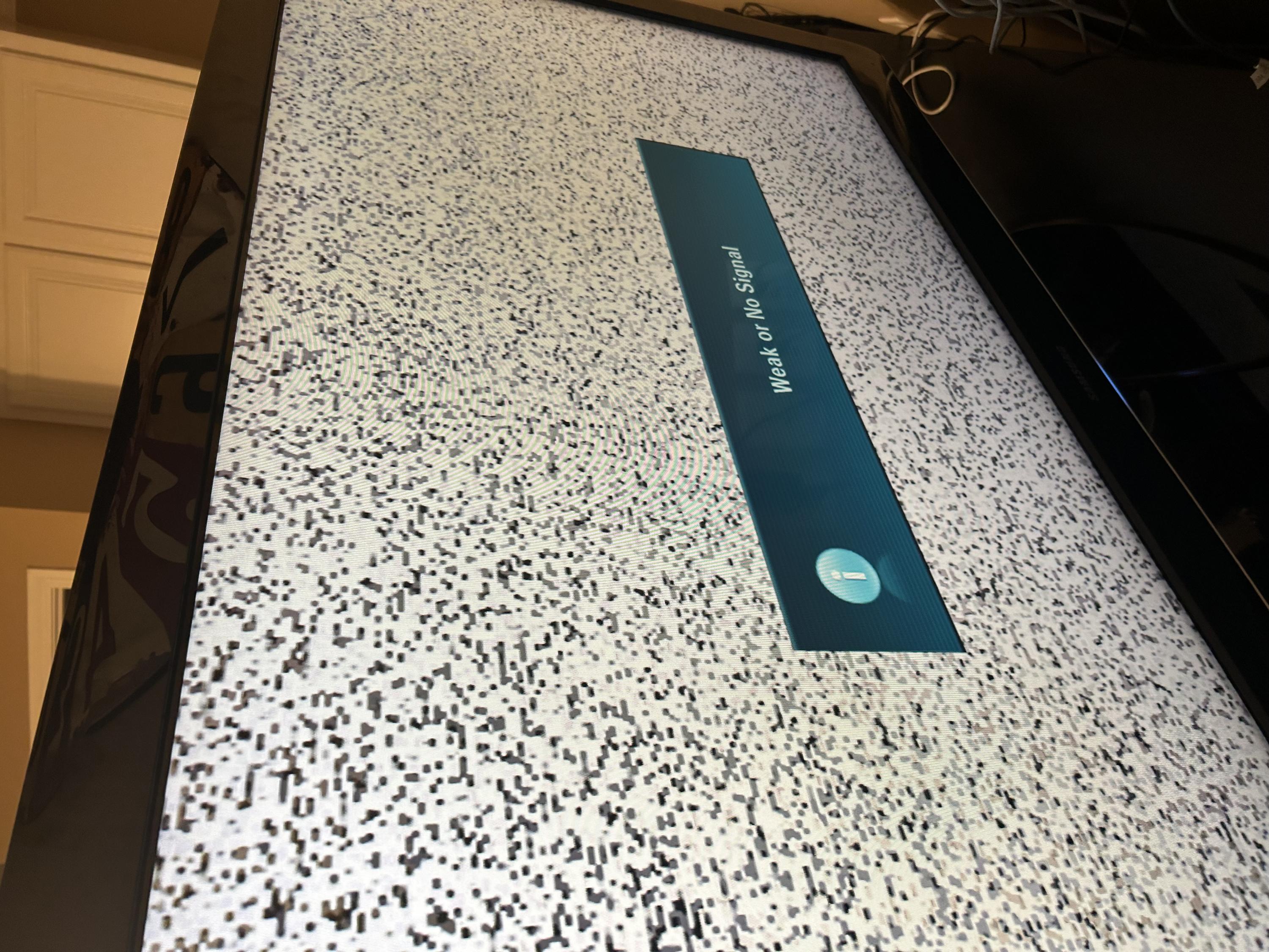

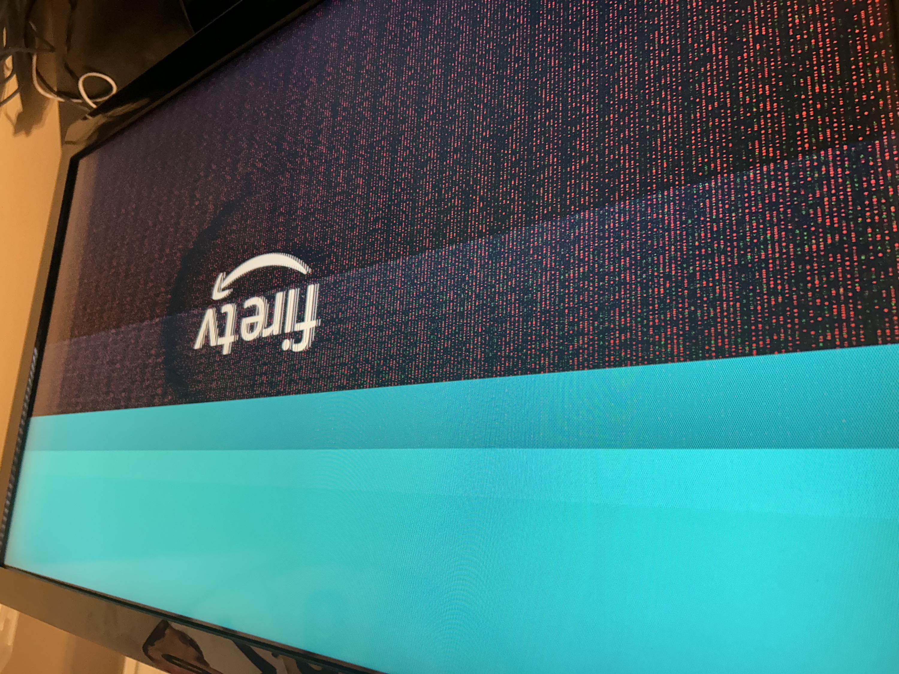

                              Okay, I have the latest firmware already installed, but went through the process of checking down to the update level. Here are some pics after the factory reset was done.
                              the first one is showing air/cable input, the next I put in the firestick and went to HDMI 1, which shows the Fire TV logo, and then, before the profile screen can display, it goes to the chaos screen.

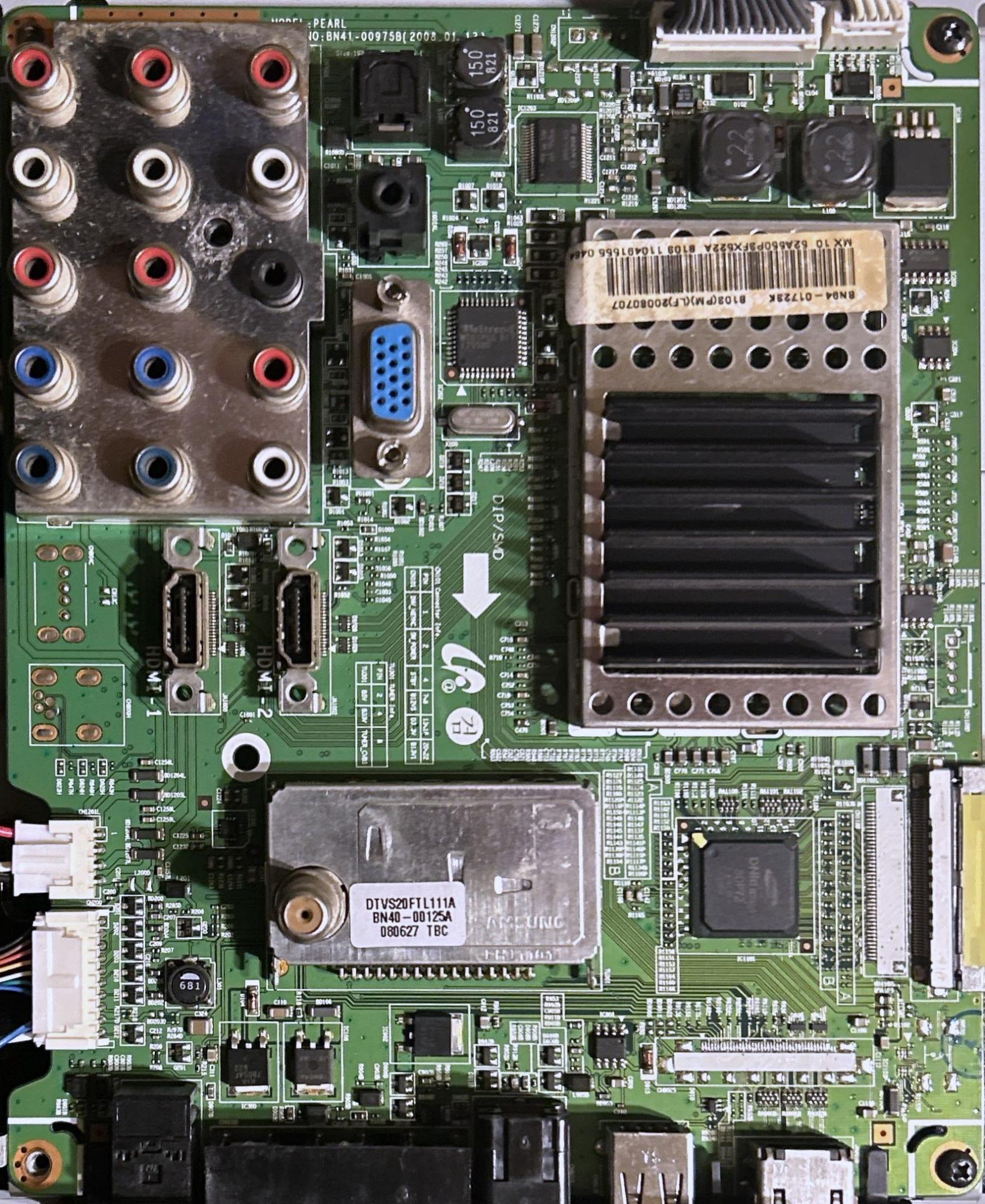

                                ok, if i recall its a mainboard issue, you can do some simple tests, you will need to take the back off.
                                • nomoresonys
                                  • Jan 2013
                                  • 12328
                                  • U.S.
                                  Re: Samsung LN52A550 with HDMI issues
                                  prolly have to forget about schematic, we'll try to talk you thru it.
                                  • nomoresonys
                                    • Jan 2013
                                    • 12328
                                    • U.S.
                                    what are all the alpha numeric digits on the white sticker on the mainboard, top row?
                                    • nomoresonys
                                      • Jan 2013
                                      • 12328
                                      • U.S.
                                      first look it over for anything obvious, next, easy test, find the 8 pin/leg IC and heat it for a couple minutes with a hairdryer, then test the tv, don't wait for it to cool down, test it while its still hot.
                                      • BretCraytor
                                        • Apr 2021
                                        • 11
                                        two stickers on the board, so Included a photo.
