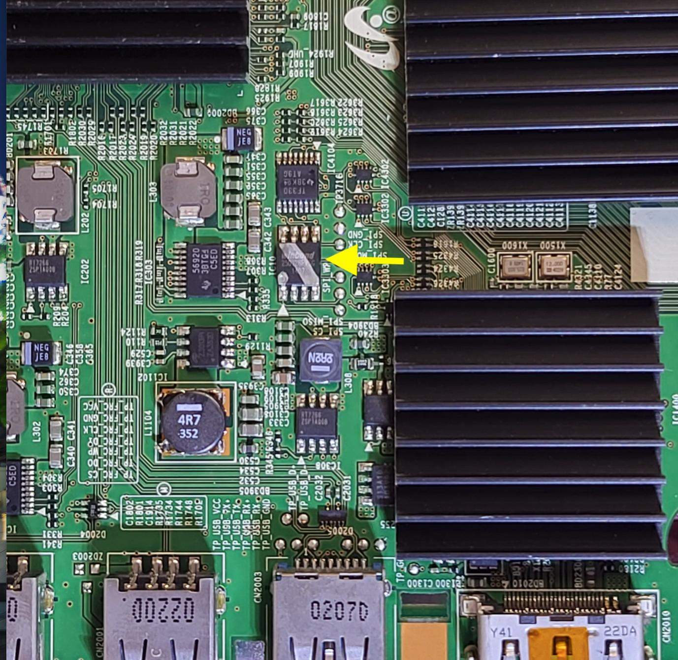

                      Well I had a restless night so decided to change out the backlight.
                      Everything went smoothly and the backlights DEFINITELY look better than it did before but the TV is still exhibiting the same bootloop/restart/reboot behavior.
                      The t-con has 4 flex cables going to the LCD panel boards and I may remove them 1x1 to see if that makes any difference but Im starting to think this is a EEPROM/firmware issue to at the very least something to do with the mainboard.
                      I am reading a lot of ppl having success using a programmer to get themselves out of similar situations. I will have to look into this seriously.
                      Edit to add:
                      I believe I have found my EEPROM chip.
                      Its a W25Q128FVIG. I will try to read it tomorrow with my programmer and see if someone can help me with a good file.

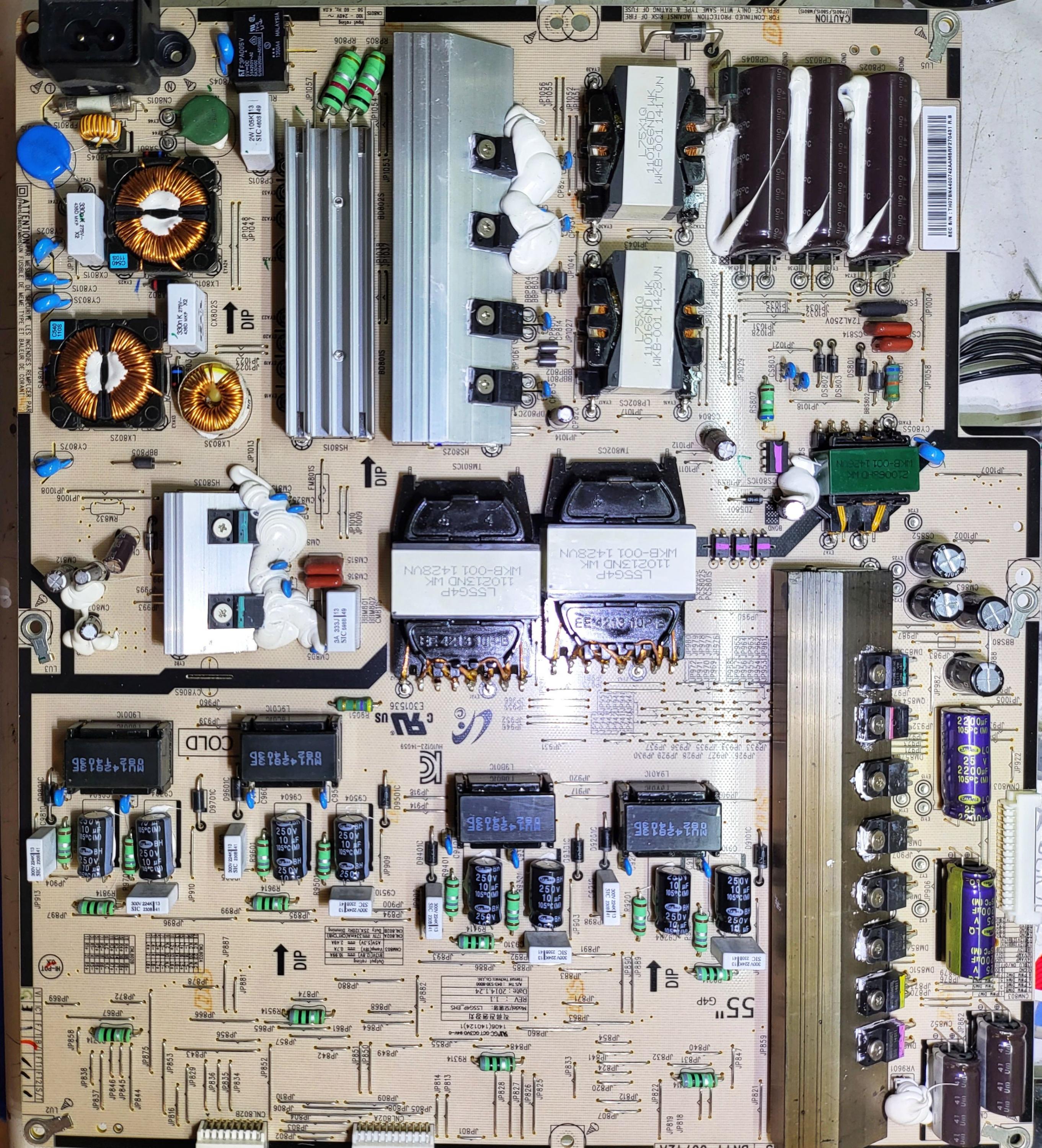

                        Re: Samsung UN55HU8550F - No picture, No sound
                        pretty sure that the powerboard should not be clicking repeatedly with the mainboard unhooked or with mainboard and or backlights unhooked, that's what makes me think there may be a powerboard issue, did you look over all the solder joints closely, examples of bad joints: https://www.google.com/search?q=bad+...ih=607&dpr=1.5
                        • nomoresonys
                          • Jan 2013
                          • 12332
                          • U.S.
                          #32
                          sometimes its as simple as one bad cap, can try heat up the electrolytic caps on powerboard for a couple minutes with a hairdryer, then try it while theyre still hot, see if tv comes on or stays on longer, no joy heat the rest of the caps including the ceramic ones and try it. see if the clicking stops for a bit.

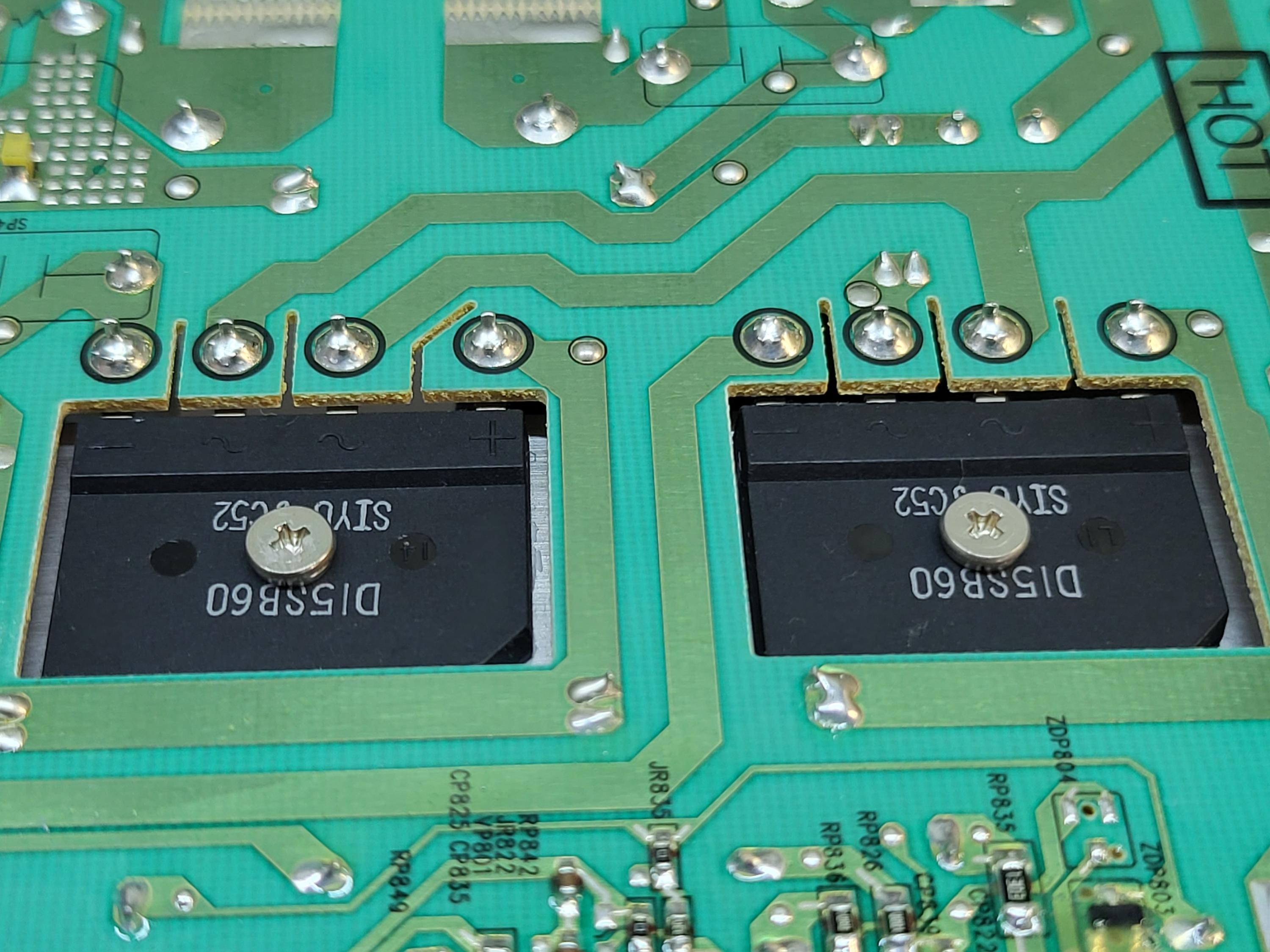

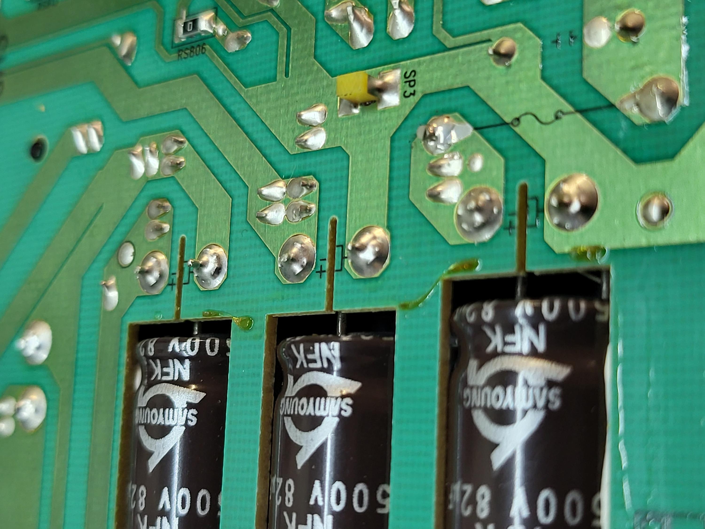

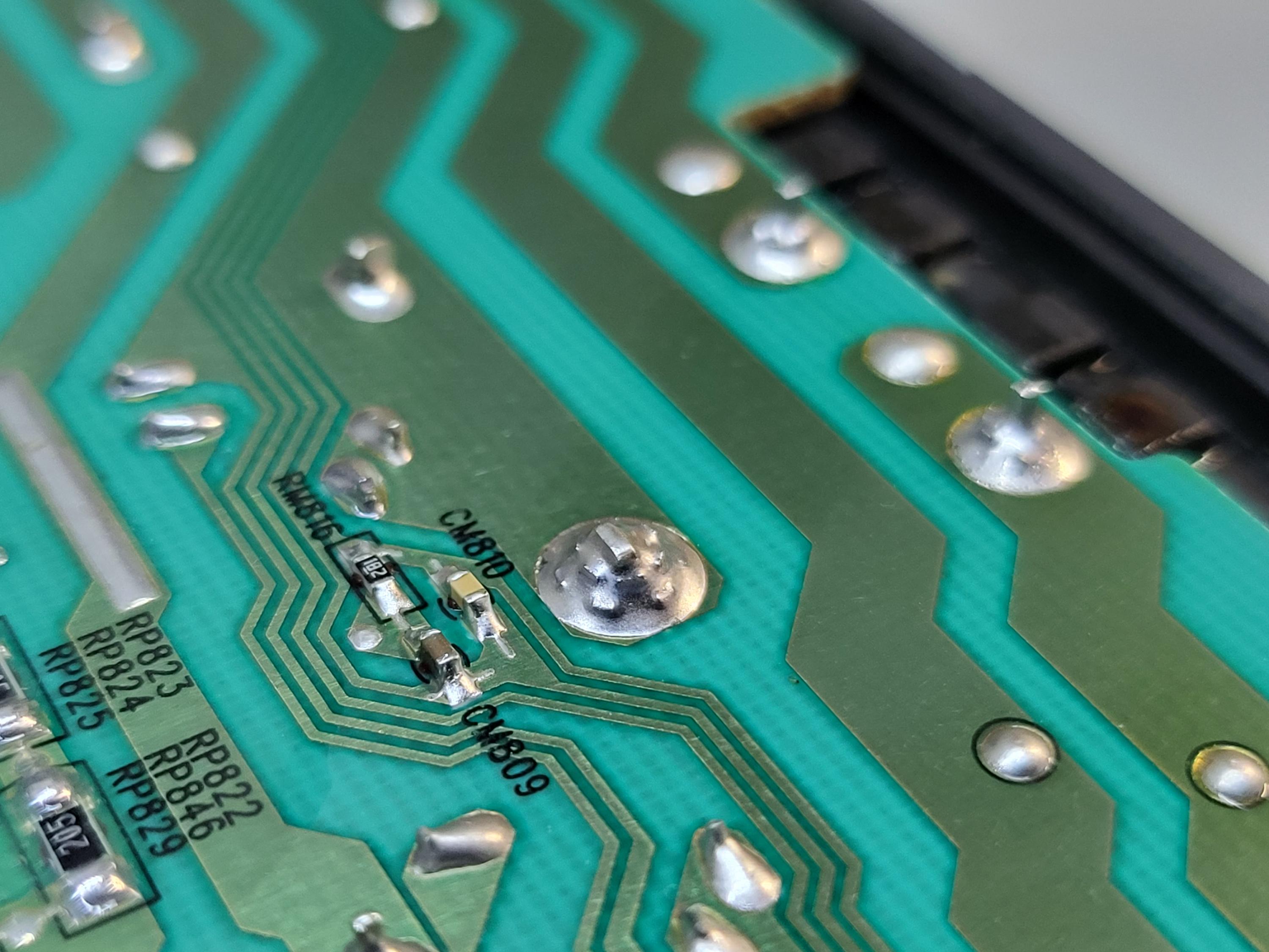

                              I went over the SMPS this morning looking for any cold solder joints but I really didnt see anything. I reflowed all the joints with my soldering iron (on the hot side) anyway. Attached are some pics of how the joints of the caps, bridge rectifier and transformers looked before I touched them up.
                              The boot loop problem still persists.
                              I then tried heating the caps (mostly the big ones on the hot side - right hand side in the photo) but that had no real effect unfortunately. I completely agree that the clicking relay is a strange symptom. Even with the power cord unplugged, the relay will click once or twice before finally falling silent. But this TV is too new and Samsung's quality and quality control is too good to have cold solder joints only after 8 years. That and these boards arent subjected to nearly as much stress as their plasma predecessors. But it is extremely curious nonetheless. There is only 1 relay and its right next to the mains so Im not sure what its clicking could indicate.....
                              I may pull all the caps out of circuit and test them for capacitance and ESR just to eliminate them, once and for all, as a suspect.

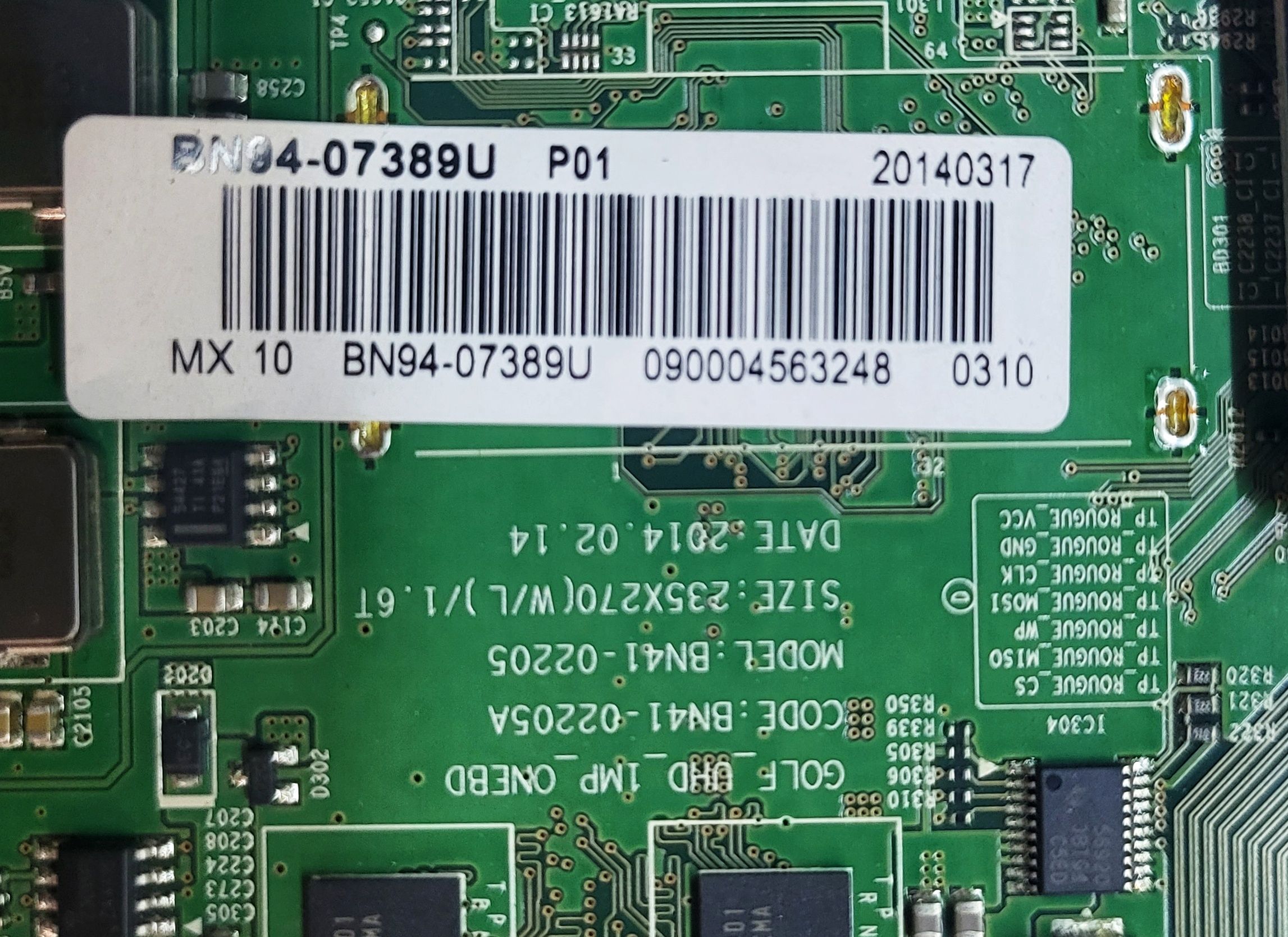

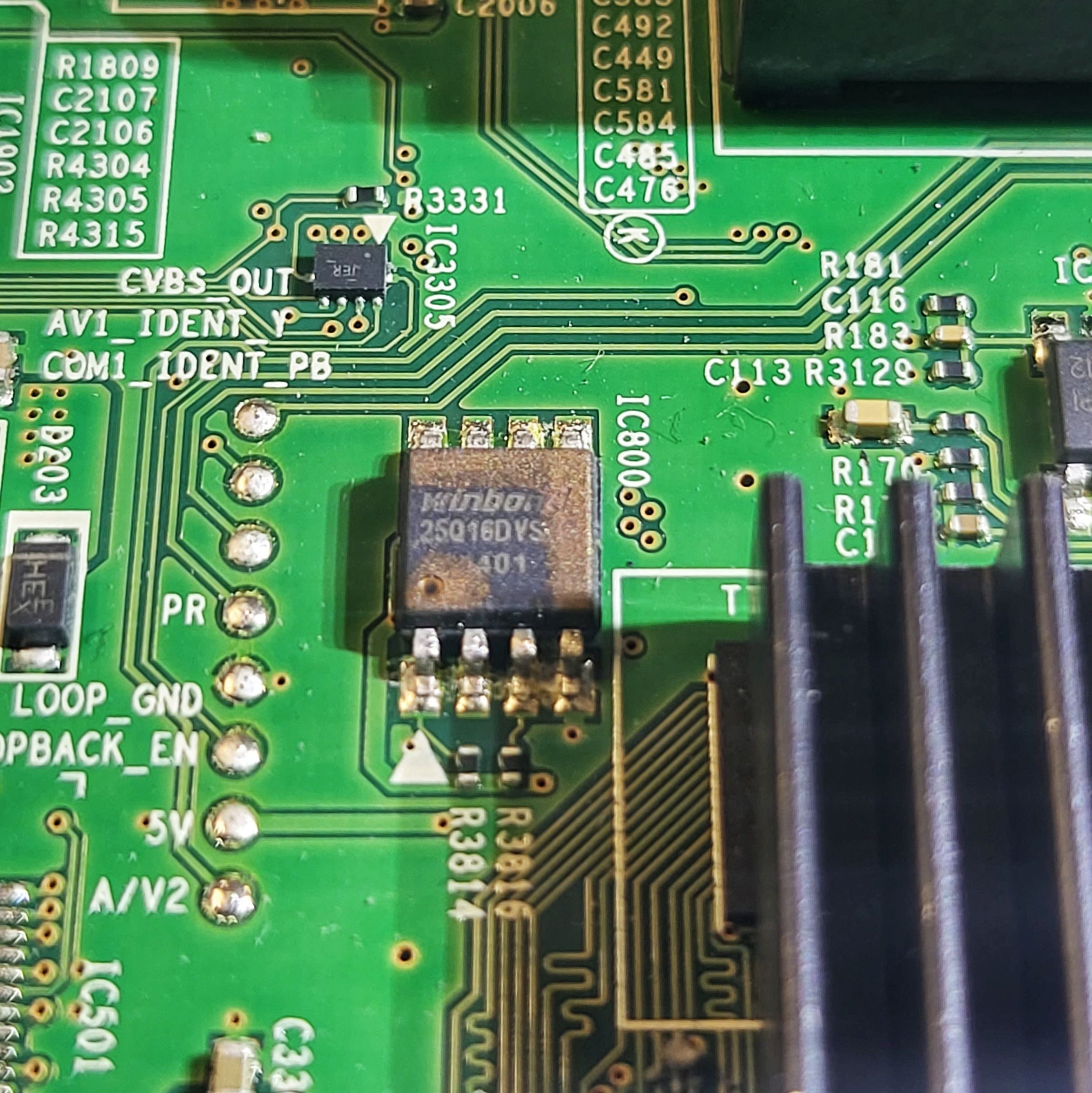

                                After touching up the power supply I focused my attention on the possibility that this maybe an EEPROM/Firmware issue.
                                I found 2 chips which could be the EEPROM which the firmware resides.

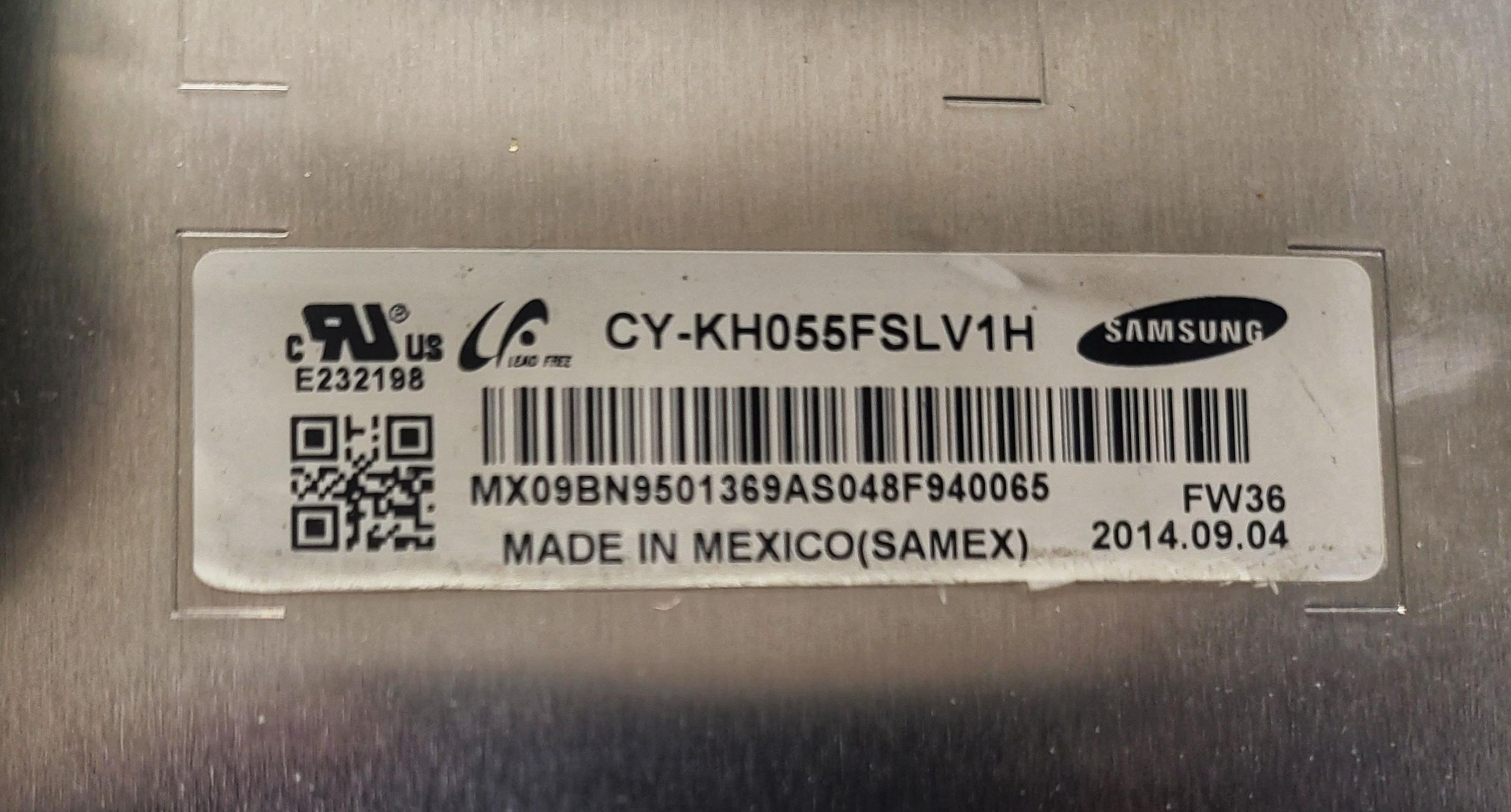

                                W25Q128FVIG located at IC10 (pictured in post #30) and W25Q16DVS located at IC800. Both are very close to the processor and both are marked with a highlighted marker by the manufacturer so they are obviously very important but I dont have enough experience to know which is which.
                                Either way i read both chips with the programmer and ask the firmware gurus for guidance.
                                The mainboard part number is: BN94-07389U
                                The panel's part number is: CY-KH055FSLV1H
                                Both BIN files are posted here as well.
                                Anyone have any idea what's what?
