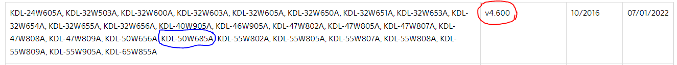

    Hello everyone.
    I replaced the mainboard on a KDL60w685a, and now it blinks green and yellow. I think i need to update the firmware. But it's not available from Sony website.
    Does anyone have the firmware for this TV?
  • lotas
    • Jan 2016
    • 4859
    • Russia
    Re: Sony KDL60w685a need firmware update
    Maybe all the same KDL-50W685A (50, not 60).
    • madyoyo
      • Aug 2018
      • 13
      • france
      Oops, i made a typo, its KDL50W685A, 50 inch panel
      • lotas
        • Jan 2016
        • 4859
        • Russia
        I understand that you need firmware 4.600?
        • lotas
          • Jan 2016
          • 4859
          • Russia
          sony_tvupdate_2013_4600_eua_auth
          https://drive.google.com/file/d/1gN9...3DhRfExSH/view
          • madyoyo
            • Aug 2018
            • 13
            • france
            Thank you. The mainboard in my tv was dead, so, i bought one on ebay. It now gives me a red and yellow light, from what i understand it needs to have the firmware updated to recognize the panel.
            Ps: i can't edit the first post, maybe a moderator can fix the model number, in case someone needs this firmware
                Sorry for the late answer, i hadn't much time to take care of this. The firmware worked fine, another TV saved from the landfill

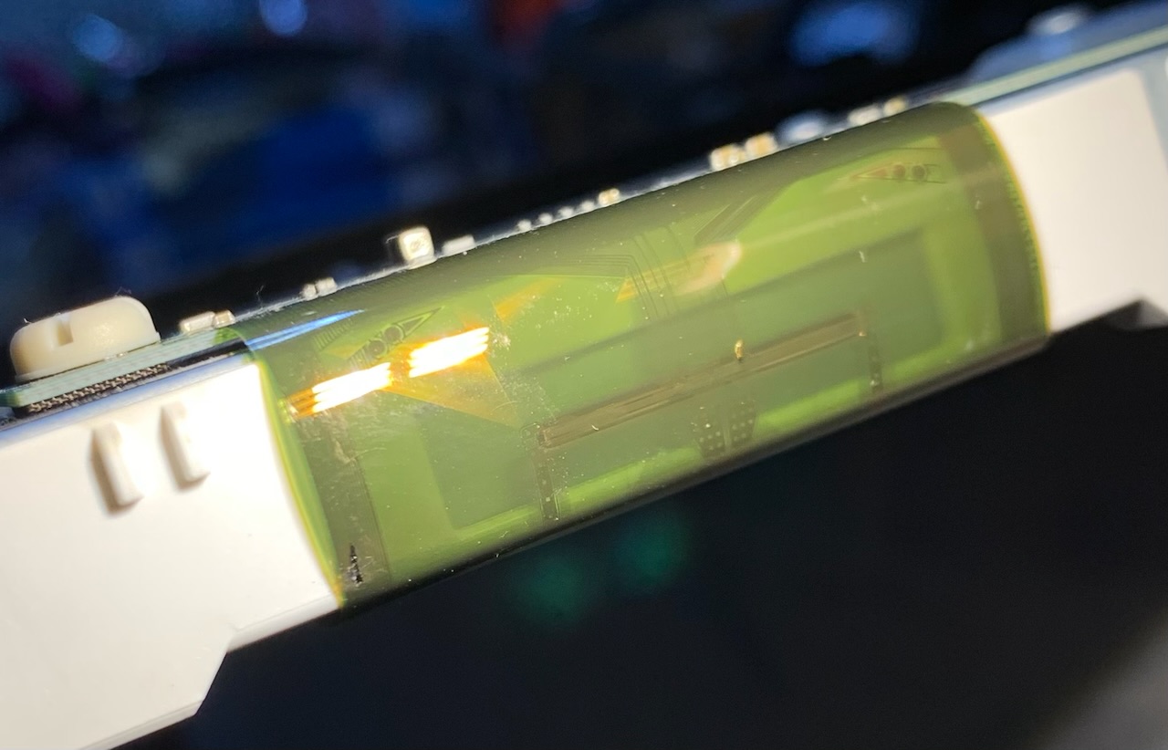

                        Thank you. I have put the file in a fat32 usb on the root folder but when I turn on the tv it does start the firmware upgrade. Instead it starts the 5 blinks.
                        Has anyone experienced the same problem?
                        I can measure the 12V on the t-con (which in this model is embended on the panel flex and I can't just replace it) that comes ON and after a second OFF. Any suggestions?
                            I had already test to start the TV without the T-CON cable with no luck. The same problem. How to put the TV into update mode? I also tried to reset the TV with Vol- and Power but it won't do it. I have a white light for 1 second only and then the red blinks starts. I have measured all the capacitor and the fuses of the T-CON and they are ok without any short on the capacitors and no blown fuses. I have seen in videos that the TV should starts normal (without video signal on the screen of course) but mine it starts the blinks immediately. If the T-CON was faulty shouldn't the TV started normally?
                                    I have manage to fix the 5 blinks. The problem was the tcon cable that the owner has destroyed when he opened the TV. And now I am dealing the original problem of the TV. It makes a noise on the tcon board and one of the flex of the panel is on fire and you can see it on the photo. I have found a video with the exact same problem. https://m.youtube.com/watch?v=MXWlbXeuyig
                                    Does anyone have seen this problem? If I remove the cable from the half of the screen the other half works fine!
