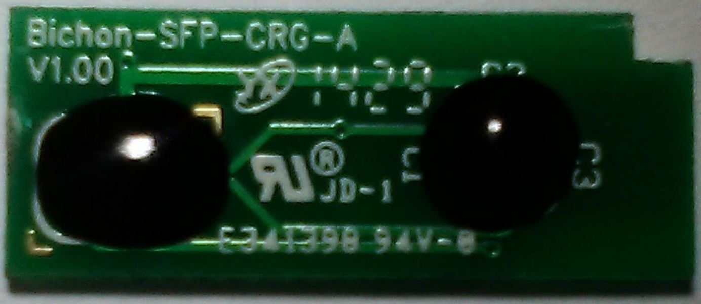

    I used 100KHz, but I'm guessing it takes in a lower frequency, as a brute force Read/Write approach at that frequency fails on all cases. So I'm going to bump it down to 20KHz. I'm going to write a different brute force code for the Arduino later today. I'll provide the source for anyone else who may want to try.
    If I were to take a guess, some of the open I2C addresses actually form a serial no., which the printer can then read off. This would make it harder to counterfeit.
    To further the study, If the brute and the sniff doesn't do anything, I'll hook my Arduino up to the printer as a slave and log the printer's commands.

        I hooked it up with an aduino.but only read 0's. Since it doesn't have the contacts for the address bits, how to proceed?
        remove the blobs?
        I refilled the toner, so now it still says that the toner is low.
          • 31262
          Re: Pantum P2502W Toner Reset Chip help
          blobs?
          those are chips.

                I know that the chips are under the blobs...
                Lighten up!!
                I unfortunately had to use the printer and the page count hit the max. It totally is dead and has no lights.
                I haven't had time to work on it for a while.
                Mine uses the same chip that is pictured in the first post. I saw chips for sale but the contacts were not the same.
                I want to try covering the data contact and wire another eeprom up (on the arduino) but have a lead from the data pin in the printer to the external chip.

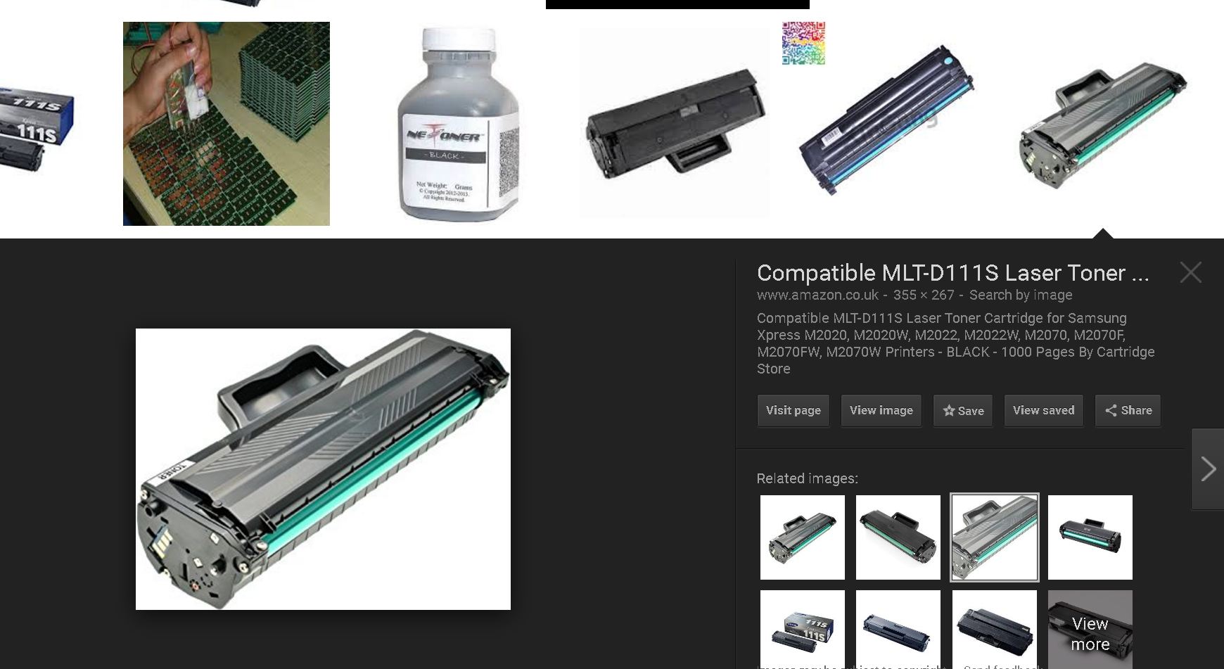

                      sleuth browsing has got me some hits of interest BTW
                      Pantum seems to be a Samsung clone.
                      Samsung chips ARE available.
                      Also my cell phone camera is junk.
                      I got a new printer like I mentioned.
                      printed a bunch - works good.
                      switched the old cartridge back in and - no go
                      put the chip from the new cartridge in the old one and viola!
                      Works good!

                                  Its cheap enough but we want to not throw out the printers that we got duped into buying.
                                  I kind of thought that particular samsung printer was too similar not to be the same thing...
                                  Does the cartridge fit in the pantum??
                                  Can you post pics of the cartridge? Particularly the chip and the ends with the fit posts...
                                  Im already researching a re-fillable color lazer to replace this with.
                                  Couple hundo and youre set for life if you get the right model BrotherPrinter.

                                      For anyone still wondering why we don't remove the blobs: The "chip under the blob" may not be what you think. The original idea was find markings on each chip for a part number to describe what protocol we need to explore. Problem is that blob *is the package*, not covering the package. Breaking into it is like breaking a DIP package open trying to read what's inside. The silicon inside will not have anything written and obviously, they haven't written anything on the outside of the package because they don't want to pay extra money so that their chip can be hacked robbing them further of their hard-earned income.

                                          II. The best Installation of chips:
                                          1.Take out the related cartridge which need to replace chip.
                                          2.Cleaning the cartridge and refill toner powder. Warning: the machine will
                                          be destroyed when the toner powder is lower or without powder.
                                          3.Put the new chip inside, please pay attention to the direction when take
                                          out the old chip.
                                          4.Please don't install the cartridge immediately, close the cover, turn on
                                          the machine.
                                          5.After the red light flash,the machine will show that no cartridge installed,
                                          then put the cartridge into the machine.Warning:Please don't turn off the
                                          electrical power on the process of installation.
                                          6.Warning
                                          If all new chips are installed when there a lack of toner it'll easily lead to the results below.
                                          1).falling short of initial capacity
                                          2).lack of printing pages
                                          3).destroying the chips
                                          specifically step 4-6. unfortunately their english is not good.
