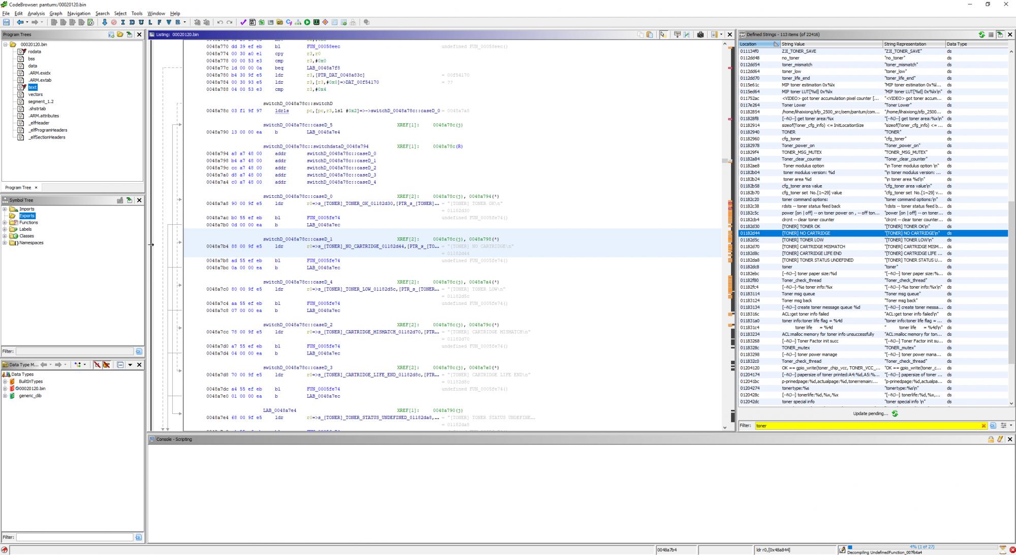

          Re: Pantum P2502W Toner Reset Chip help
          Originally posted by DJ_MIX View Post
          I believe it's version 1.1.3.4. What tools do I need to decompile this firmware?
          First you need to extract/decompress the firmware using offzip.
          offzip.exe -a "pantum toner empty.bin"
          You can then disassemble the generated "00020120.bin" ELF file with Ghidra.
            Thanks for the help, I was able to extract the bin file and working on getting ghidra up and running.

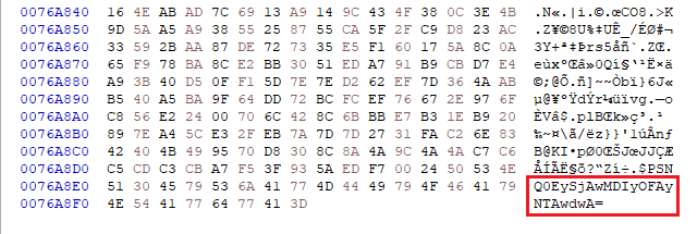

              File attached, Chipless firmware just need to figure how to modify for your printer ID.
                BASE64 decode that string and you get "CA2J000228P2500w".
                  Thanks once again, I think I got it.. Maybe during weekend will attempt.
                      Overwriting the serial number in base64 will not help, the rest of the contents are encoded by the firmware program.

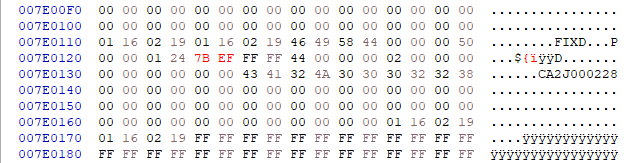

                              Need help with modding printer id in my backup bin file.
                              I tired to change to CA2J000228, but after flashing it reads AA2A000000.
                              I attached original and modify file.
                                There is a checksum somewhere I think.

                                  Do you think the printer id is also stored on another chip also? or only in firmware
                                    Probably not. You can change the serial number via USB by using the AclSetSerialNumber command. I also checked the code that writes the serial number to the flash chip, and it does calculate a checksum.
