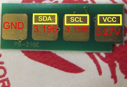

                          Just FYI, In some of the images of those chip, i see the STM 8 bit microcontroller (https://www.badcaps.net/download/?id=e020c74c) being used. This one has built in EEPROM, which must be storing the info. but use of uC suggests that there must also be some kind of "handshaking" going on.

                              I just ordered a P2500W. The toner chip communication is encrypted, according to the disassembled printer firmware, but I have all the necessary information (I think) to read/write the toner chip data using an arduino. If anyone is interested in a modified firmware that e.g. sees empty toner cartridges as full or wants to reprogram toner chips using an arduino, let me know.

                                The firmware on my new P2500W printer was encrypted, and the key to decode it was stored in 88PA6110 efuses, so I had to modify the bootloader to dump the efuse values via UART

                                  I reverse engineered the printer/chip protocol (including encryption), the meaning of the toner chip data (including encryption and checksums) and can communicate directly with the chip using a cheap CH341 USB programmer for reading out all the information.
                                  I should be able to manipulate/reset the counters but I don't think I will try this any time soon, since I don't know what kind of toner chip anti-tamper protection the printer firmware has and I don't want to destroy my toner chip.
                                  If anyone has a genuine chip that he/she does not need anymore, then please let me know.

                                        If your printer has an older firmware then it might be possible to reset the toner chip counters by sending a special command to the printer. I can probably help you with that. My P2500W has a "3.2.4.1" firmware (from 2020) and Pantum removed the "clear counters" command and added extra toner chip security, compared to a "1.1.9.7" firmware (from 2017).
                                        If you can solder and have a CH341 USB programmer, then you can interface directly with the chip and try to clear the counters that way. I can also help you with that.
