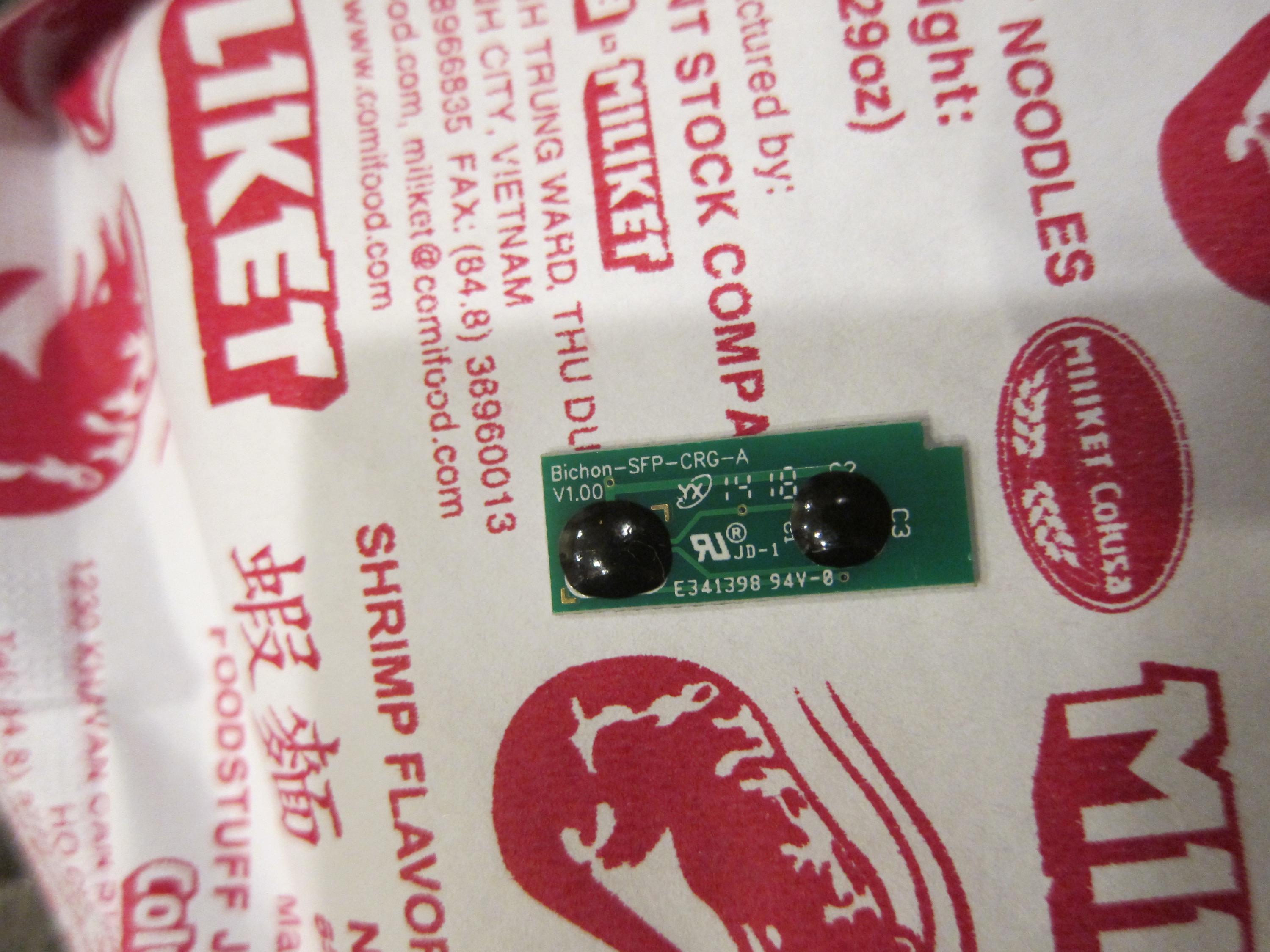

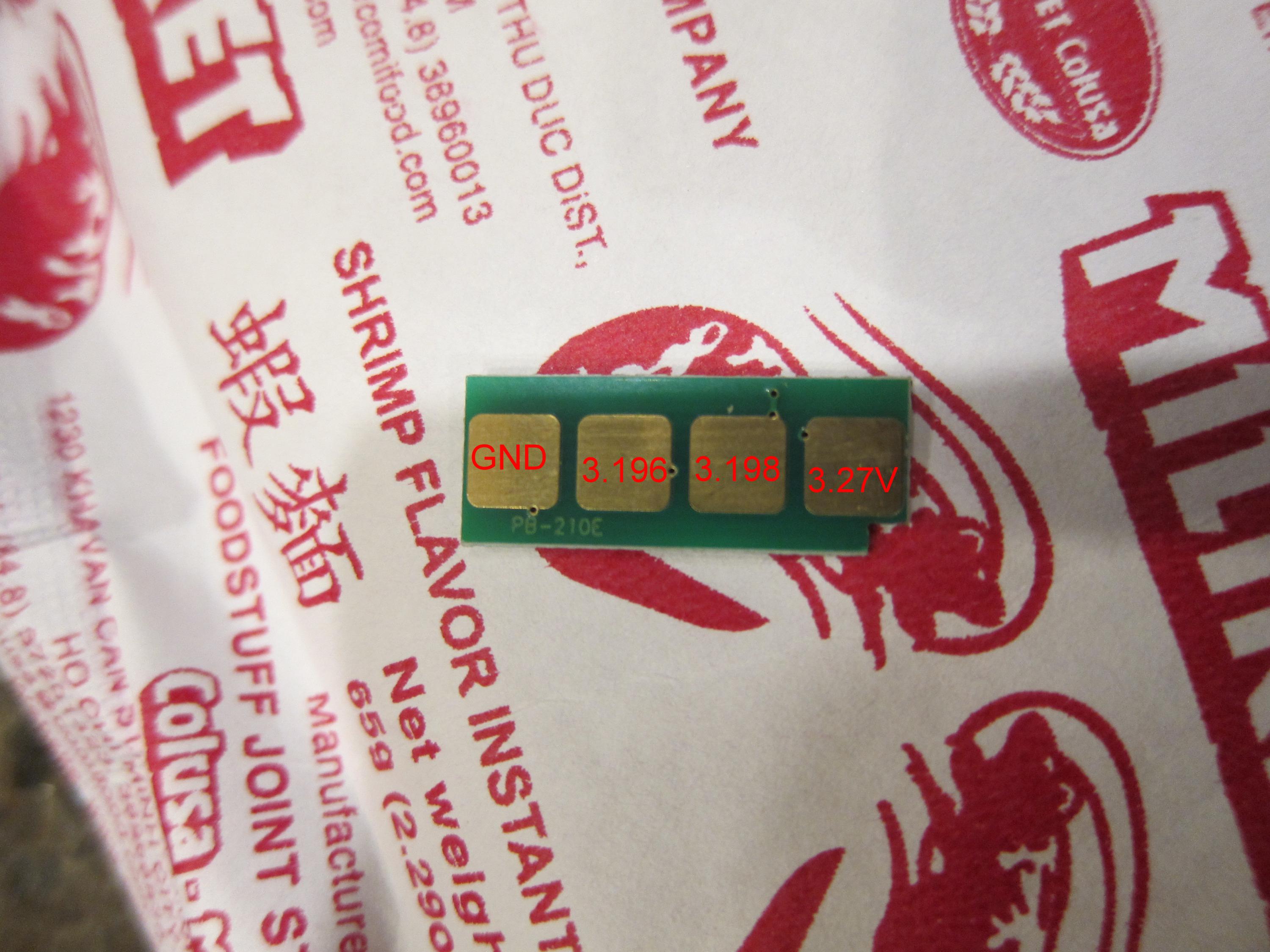

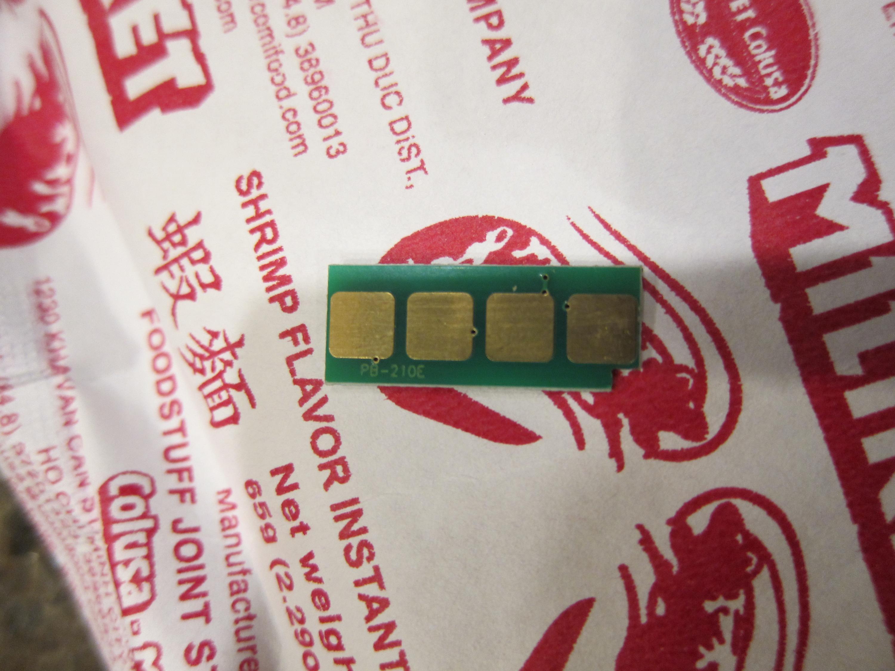

    Need help just bought this cheap Laser printer.
    They all now come with these chips to limit refilling.
    Anyway I remove the chip but it has this black blob over the chip. I was hoping to remove the black stuff off to see what chips it uses to read the contents.
    I tried heating it up with heat gun a bit and it does not melt at all, it's rock hard.
    I have a EETools Topmax programmer, but without any info on what the 4 pins do, don't know if I will be able to read the chip information.
    What I'm asking is has anyone have any ideas ho to tackle this.
    attached pic of chip

    Re: Pantum P2502W Toner Reset Chip help
    there is probably nothing but silicon under those blobs.
    if you want to do this, start by working out what the contacts are.
    find the ground, then find the supply voltage.
    after that probe the remaining 2 to see what interface it is.
    probably I²C
      I guess I can find VCC, and GND from the printer itself??
      from the pogo pins that touch the chip?
        exctly - maybe even follow the tracks back to the controller.
          Ok great Thanks.

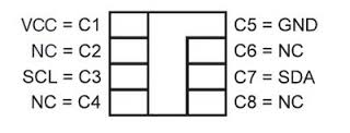

          I uploaded I2C Pin out. Most likely will need to find SDA and SCL.
          I should be able to this with my EETools topmax programmer. Never dealt with I2c chips, so all new to me
            OK got some voltages and found Ground.
            This weekend I will try to hook it up to my programmer and see what happens

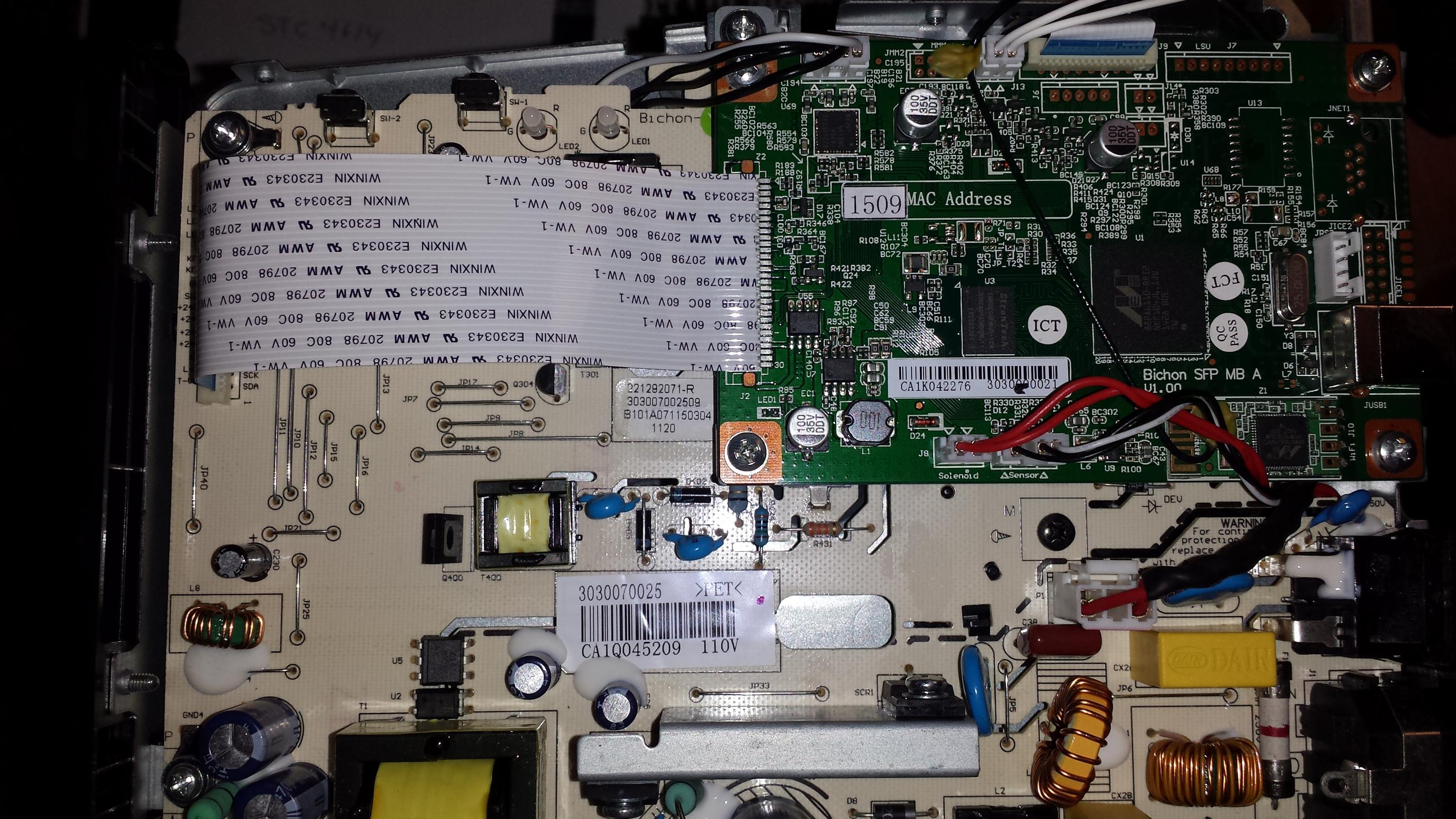

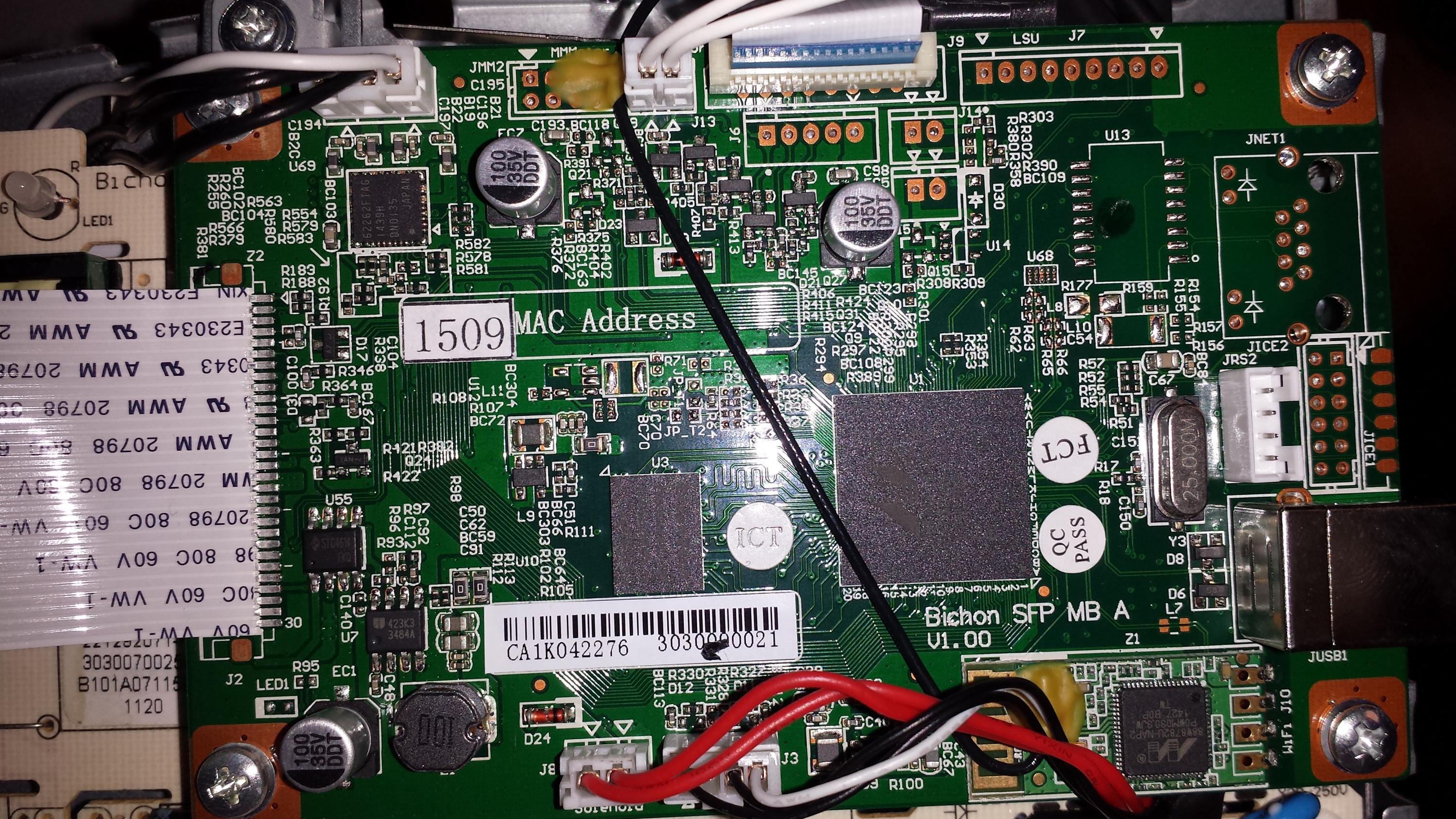

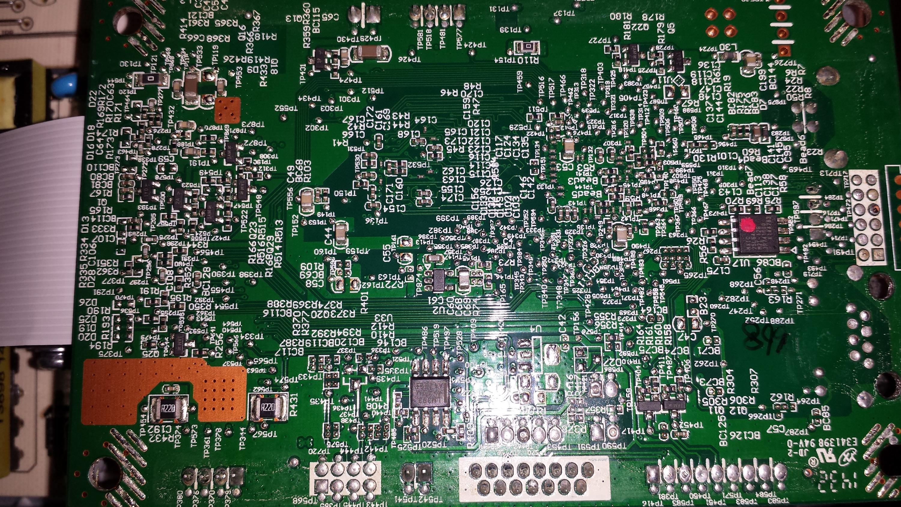

                  • DJ_MIX
                    • May 2005
                    • 118

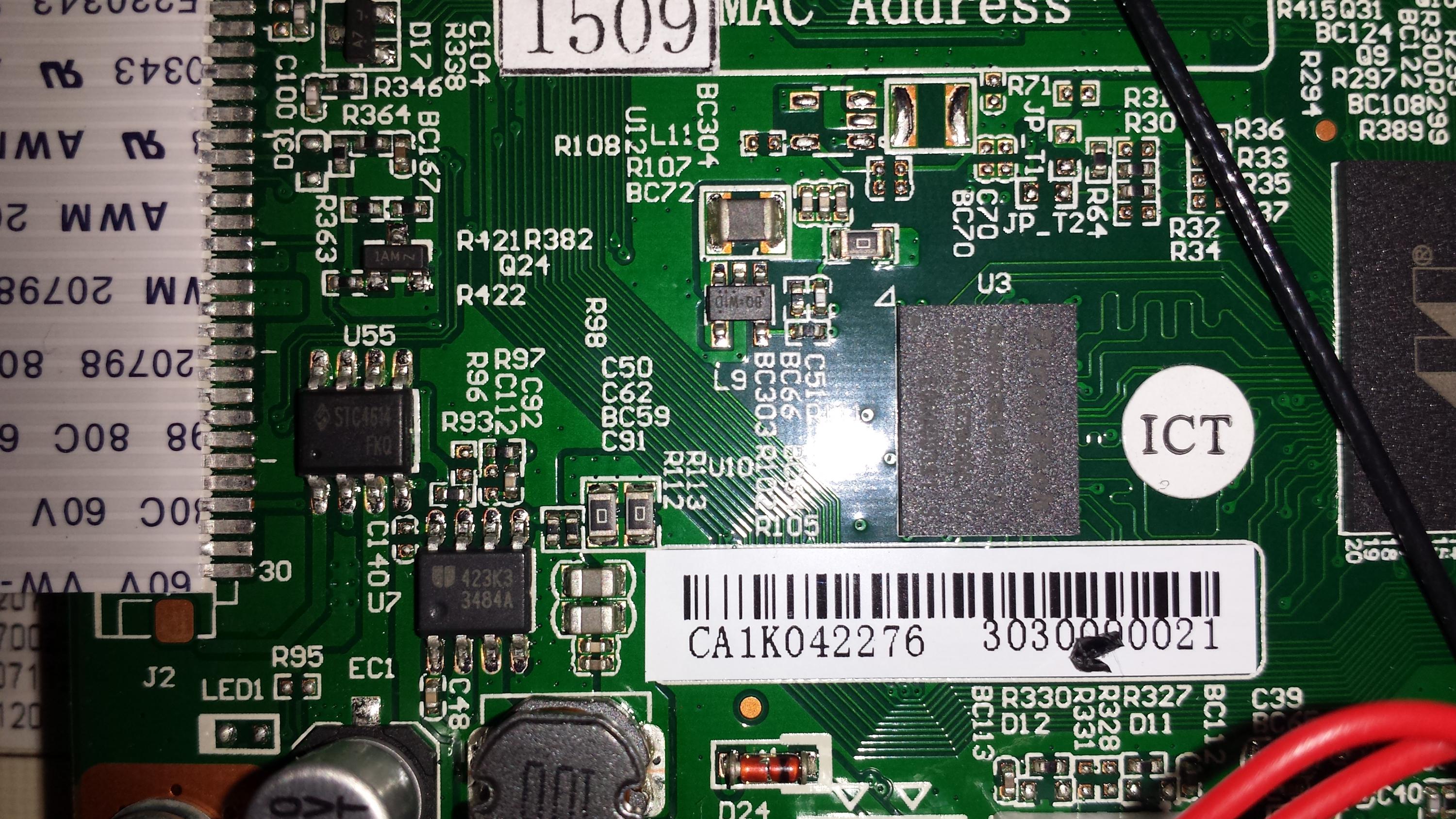

                    Added Pics of Printer Board. Can anyone identify what type of chip 423K3 is?
                    Only other chip I found on this board that may be helpful is the bios Chip MX 25L6406E.
                    Maybe the toner count is stored on this chip? Either way I plan to dump the chips contents. Maybe after the toner is empty I'm going to restore the dump back to chip and see if that sets the toner count back to original. If that works I will hard wire it with connector for future restores.

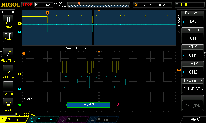

                                I'm going to hook up an I2C Sniffer some time today, and see just exactly what the printer is trying to do when it prints.
                                    the pinout of the chip is as follows:
                                    (corner notch)
                                    VCC (+3.3V logic)
                                    SCL
                                    SDA
                                    GND
                                    Here is an I2C device scan dump:
                                    I2C device found at address 0x06 !
                                    I2C device found at address 0x07 !
                                    I2C device found at address 0x0E !
                                    I2C device found at address 0x0F !
                                    I2C device found at address 0x16 !
                                    I2C device found at address 0x17 !
                                    I2C device found at address 0x1E !
                                    I2C device found at address 0x1F !
                                    I2C device found at address 0x26 !
                                    I2C device found at address 0x27 !
                                    I2C device found at address 0x2E !
                                    I2C device found at address 0x2F !
                                    I2C device found at address 0x36 !
                                    I2C device found at address 0x37 !
                                    I2C device found at address 0x3E !
                                    I2C device found at address 0x3F !
                                    I2C device found at address 0x46 !
                                    I2C device found at address 0x47 !
                                    I2C device found at address 0x4E !
                                    I2C device found at address 0x4F !
                                    I2C device found at address 0x56 !
                                    I2C device found at address 0x57 !
                                    I2C device found at address 0x58 !
                                    I2C device found at address 0x59 !
                                    I2C device found at address 0x5A !
                                    I2C device found at address 0x5B ! (Mentioned by khoalam
                                    I2C device found at address 0x5C !
                                    I2C device found at address 0x5D !
                                    I2C device found at address 0x5E !
                                    I2C device found at address 0x5F !
                                    I2C device found at address 0x66 !
                                    I2C device found at address 0x67 !
                                    I2C device found at address 0x6E !
                                    I2C device found at address 0x6F !
                                    I2C device found at address 0x76 !
                                    I2C device found at address 0x77 !
                                    I2C device found at address 0x7E !
                                    Turning up the dial, one notch at a time.

                                        What clock speed did you get for the chip?
                                        So 0x5B is the chip address in the printer?
