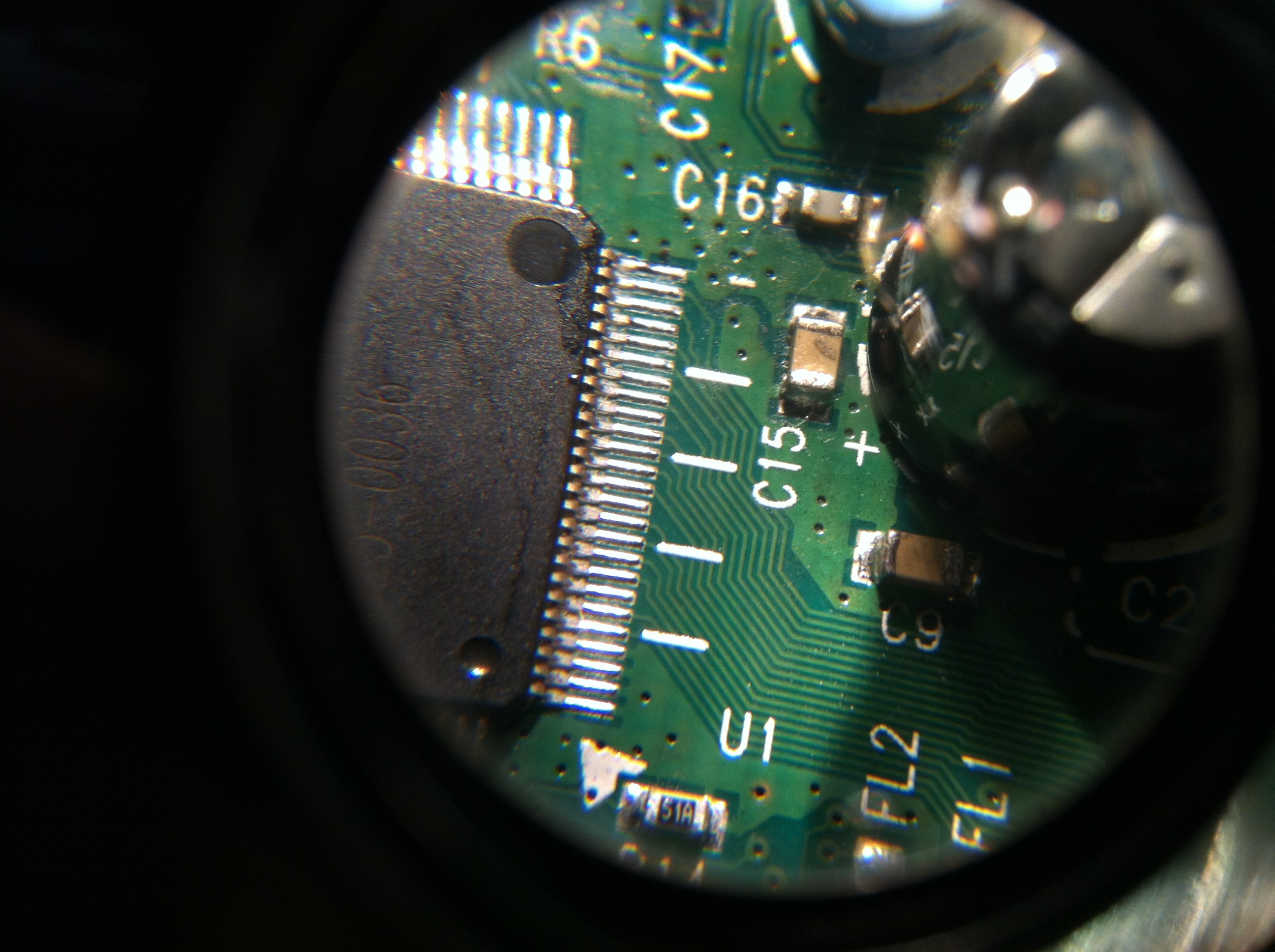

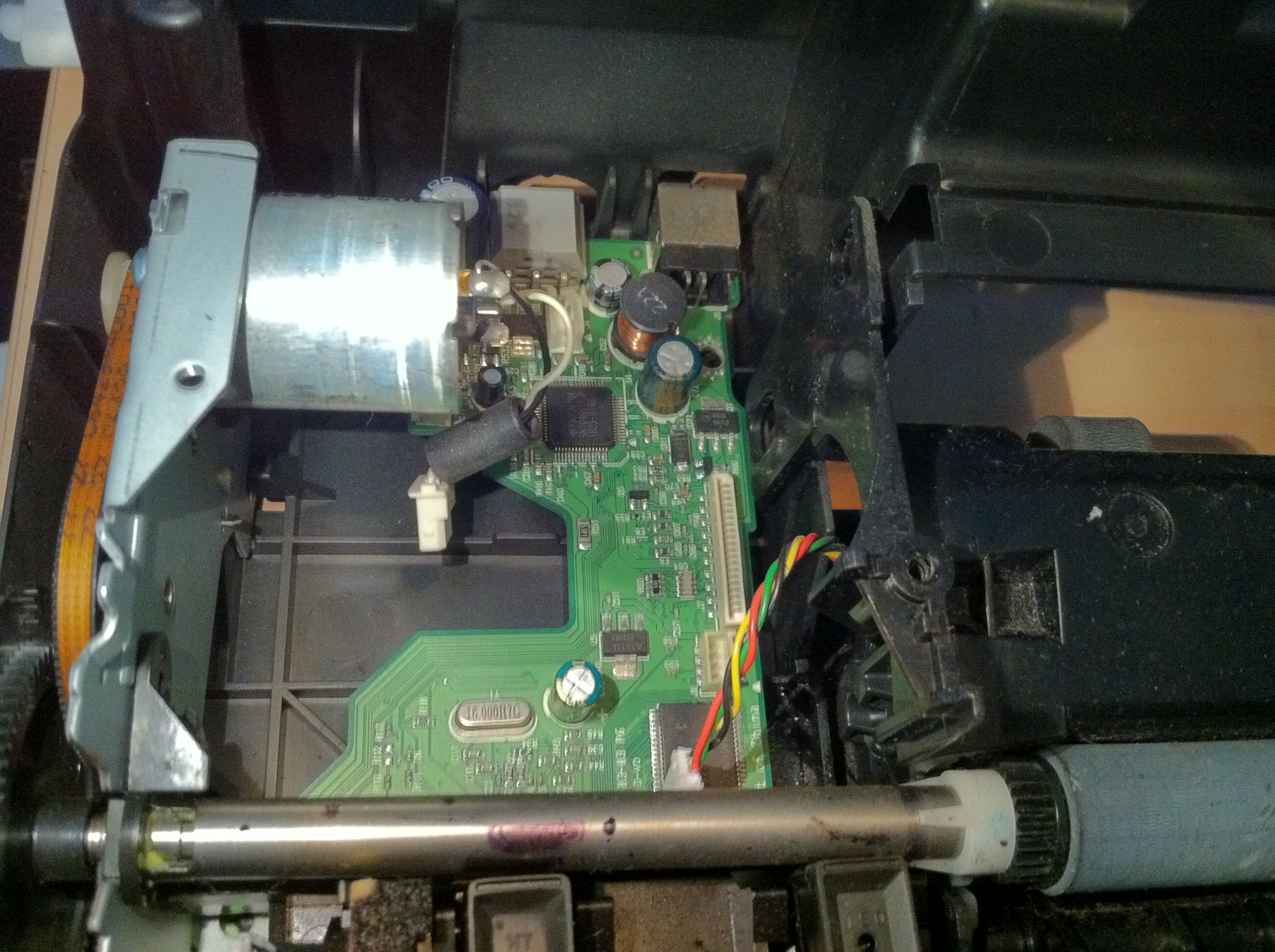

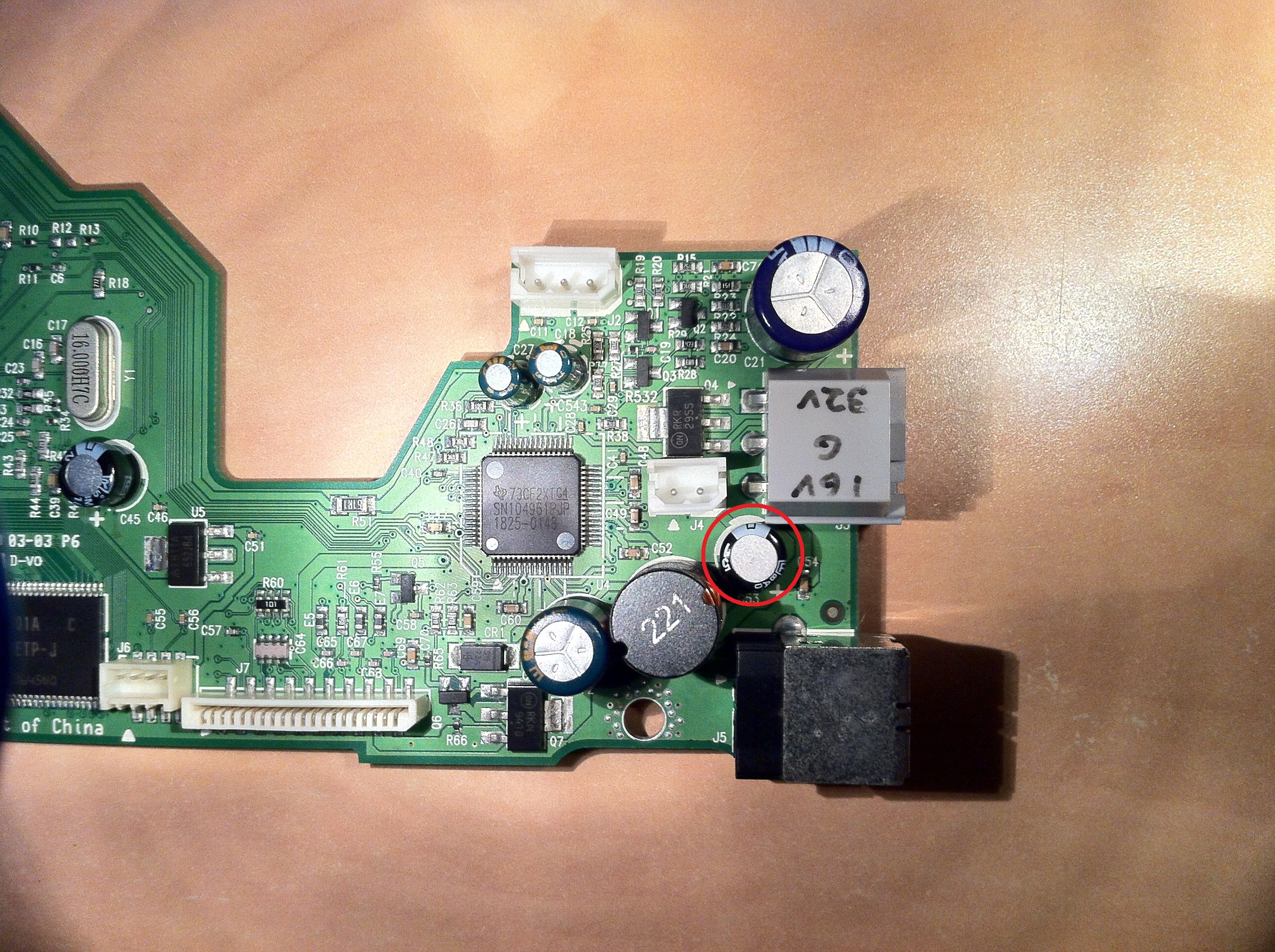

    I removed the three electrolytic caps on the print head board and they measure good.
    • flat-earther
      • Dec 2022
      • 127
      • palestine

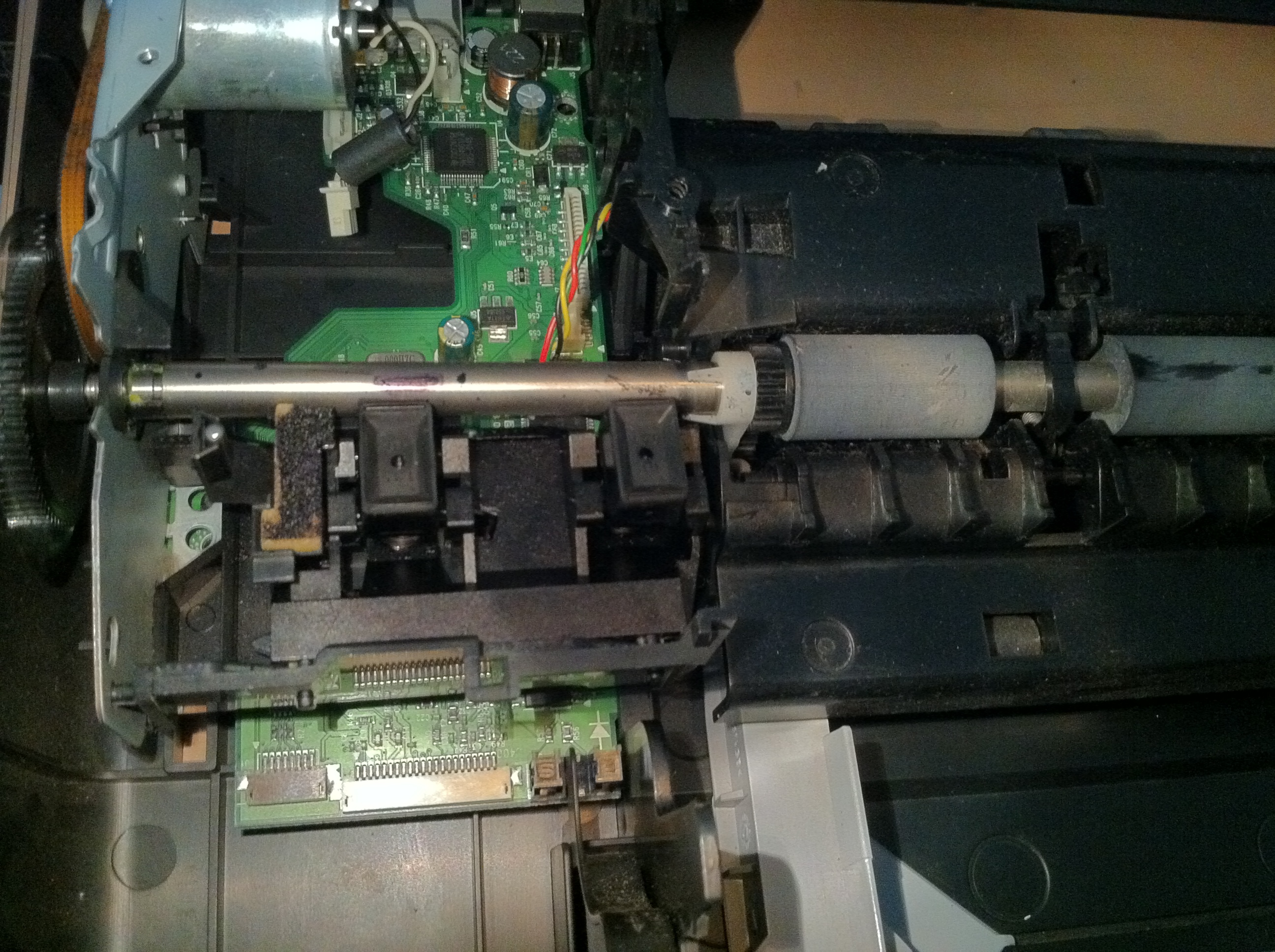

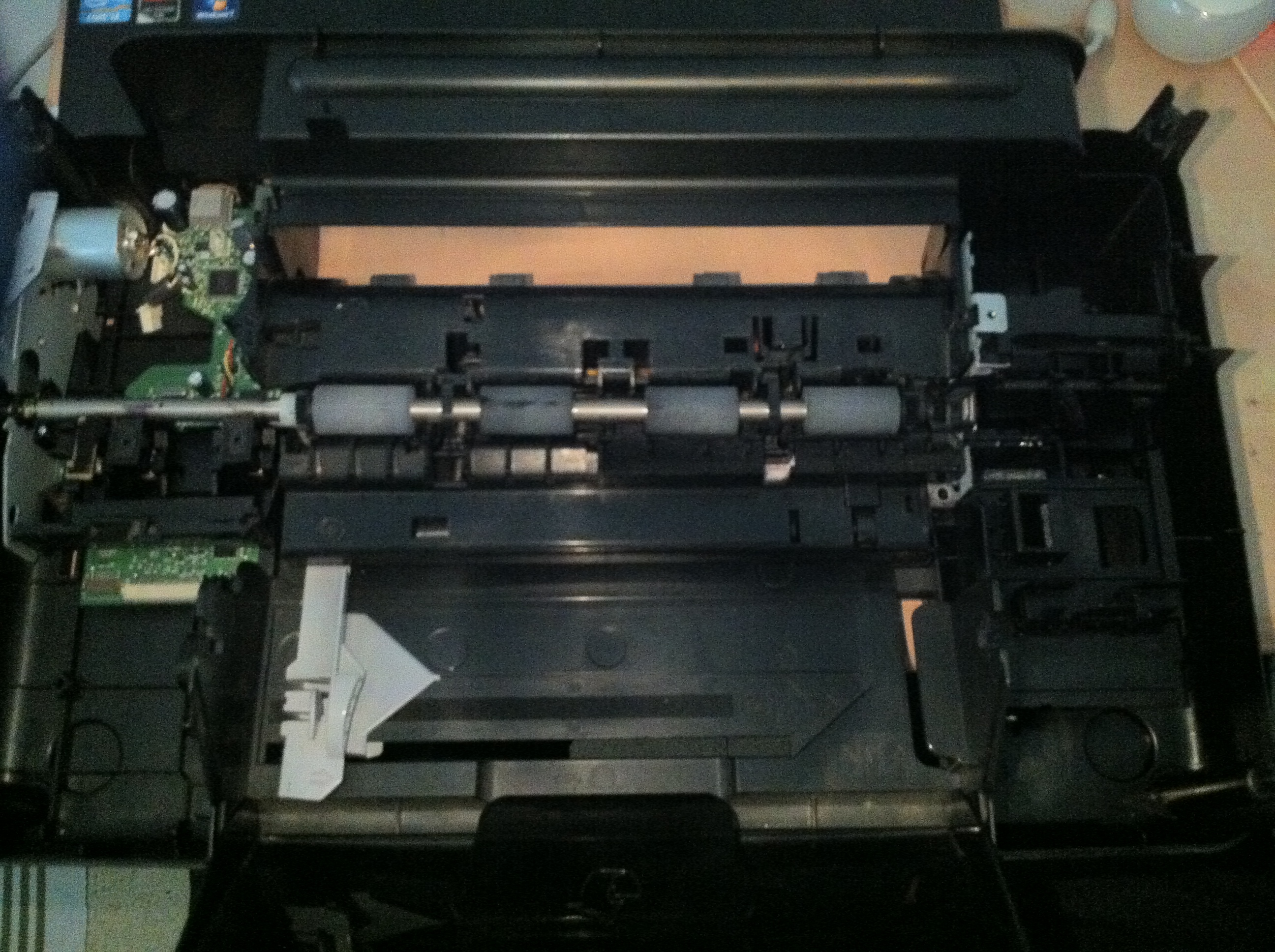

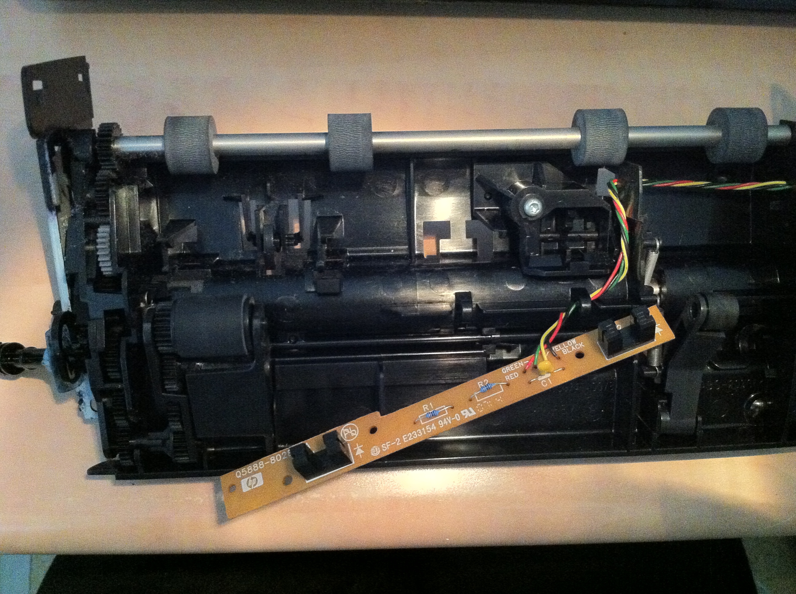

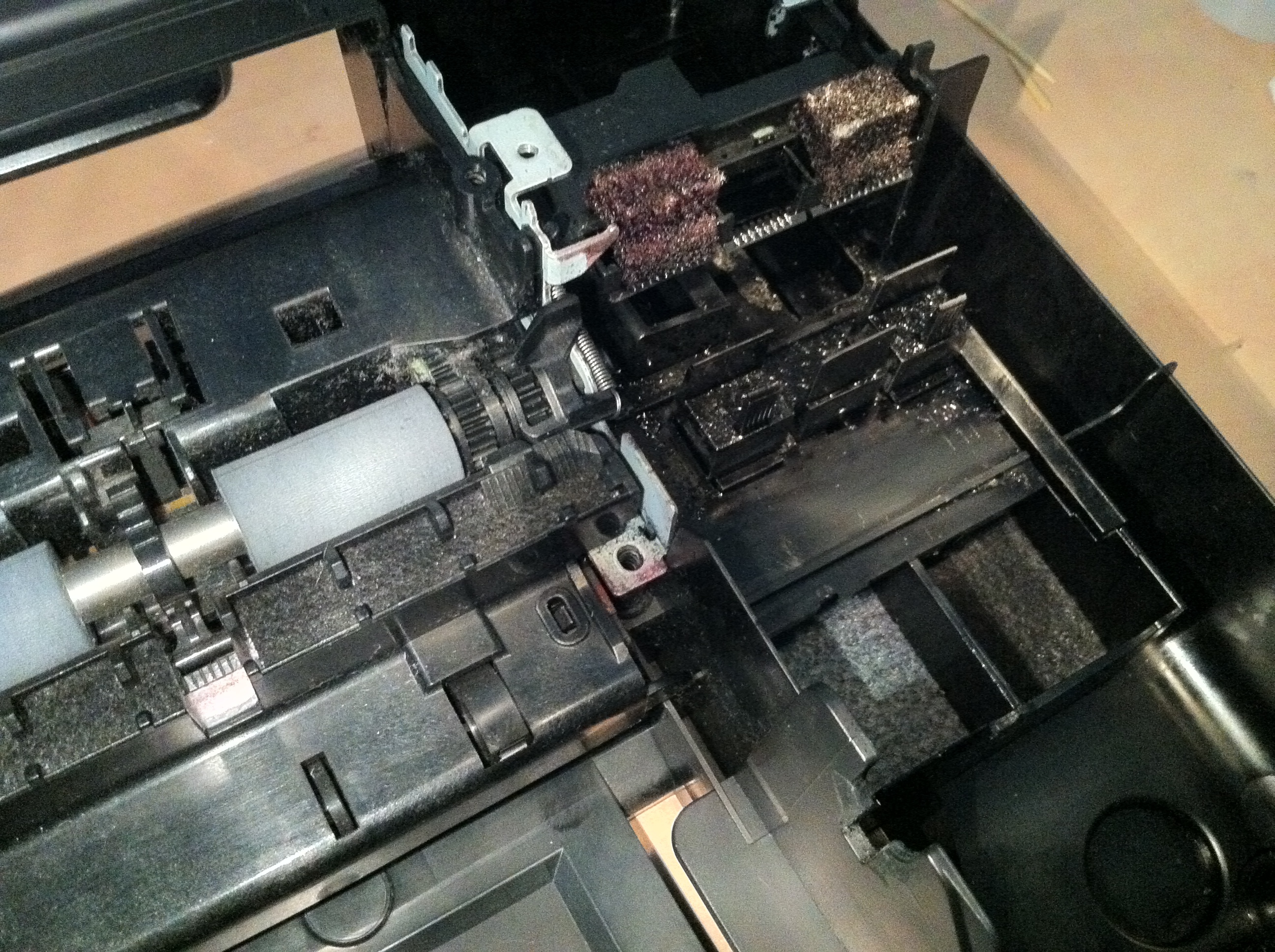

      I reassembled the printer, it was difficult because it has been months since I disassembled it so I didn't remember how to assemble it but I got it done and this disassembly video helped me https://www.youtube.com/watch?v=hgiCGBt-C3U
      Those ribbon cables are a nightmare, they are so thin and you have to push them in which makes them buckle, very bad design. I put silicone spray on one of them to try and make it go in easier.
      I sanded the cable and the plastic tab that fell off of two of them and superglued it back on.
      I powered up the printer and guess what, same error as before.
      Out of curiosity I measured the output(emitter pin) of the 16V NPN BJT while powering the printer up now that it's assembled, and it gradually went to -0.12V, what does that mean? I wonder why it went negative. at no point did it have 16V.

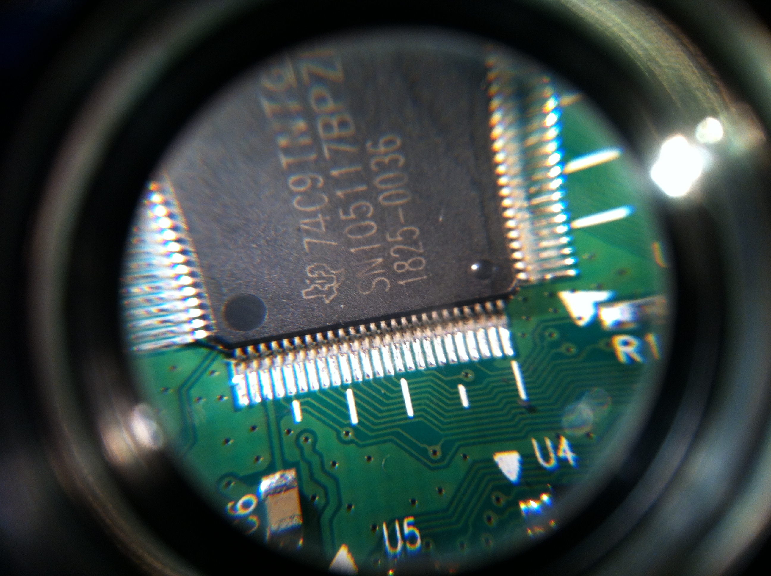

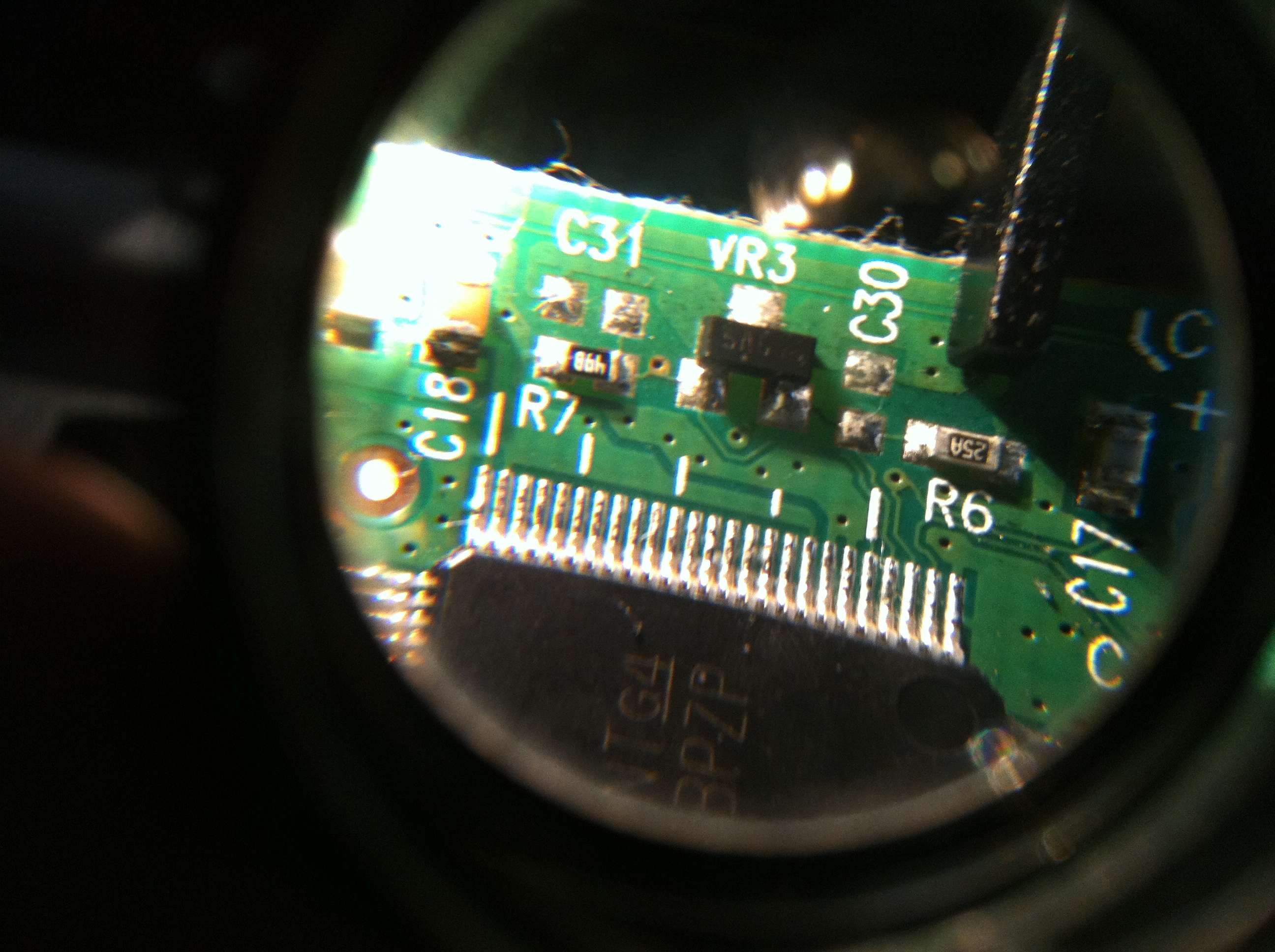

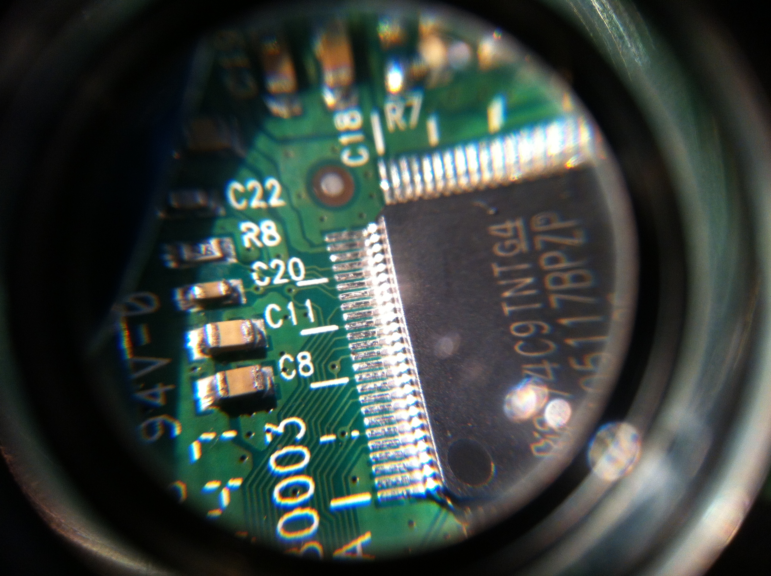

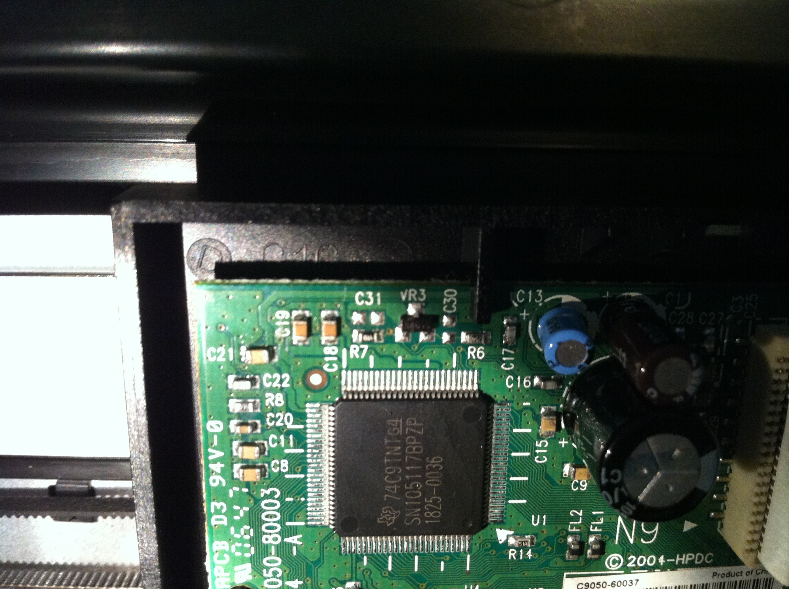

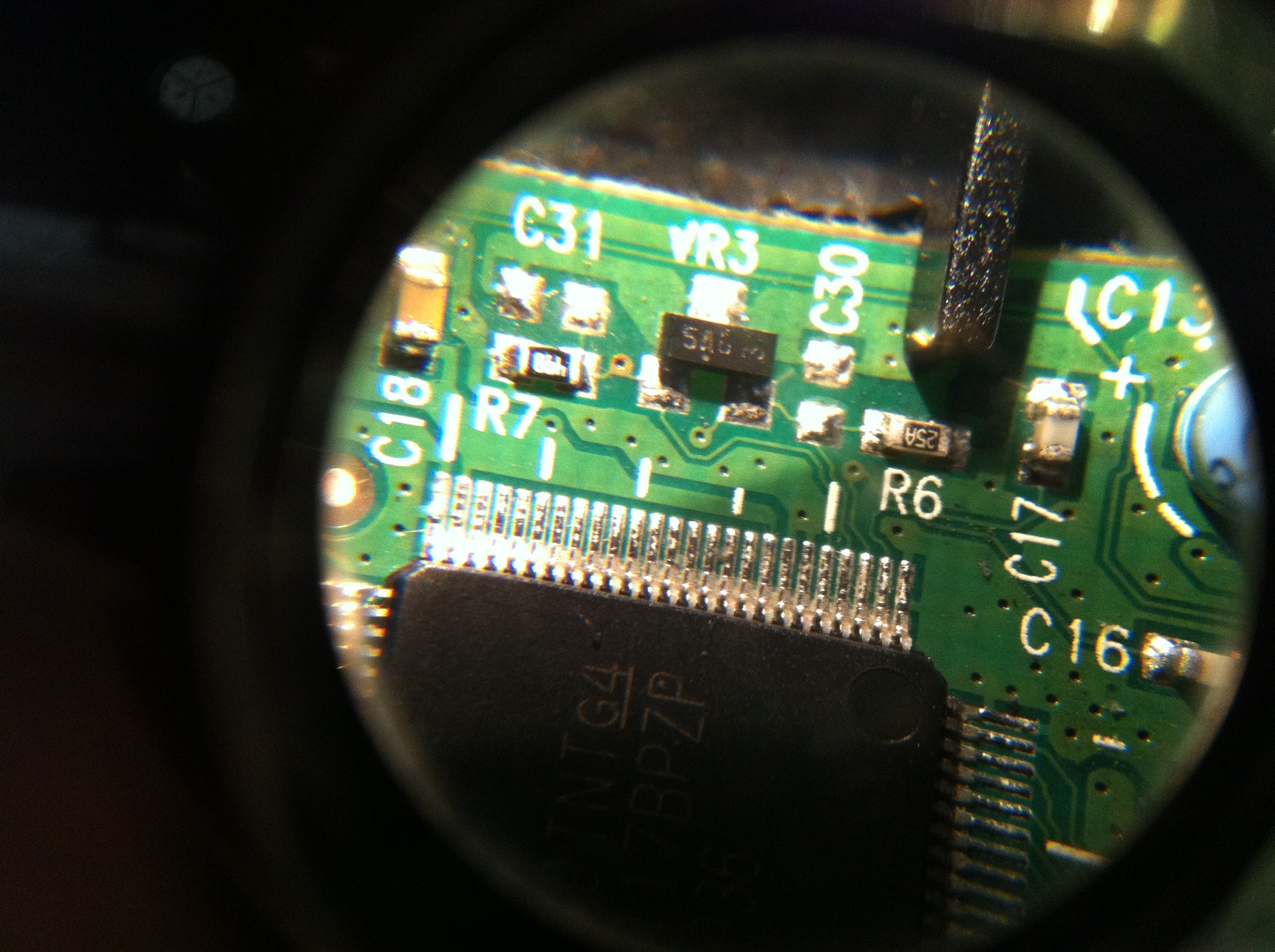

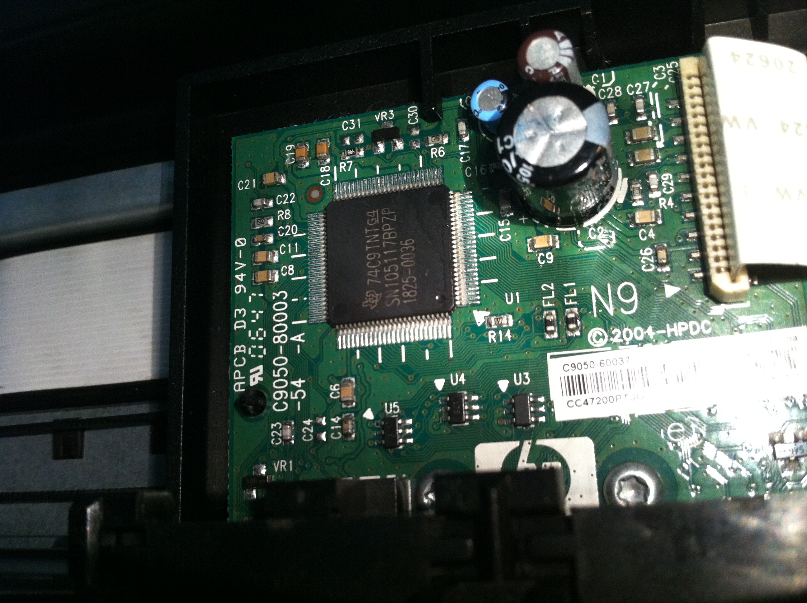

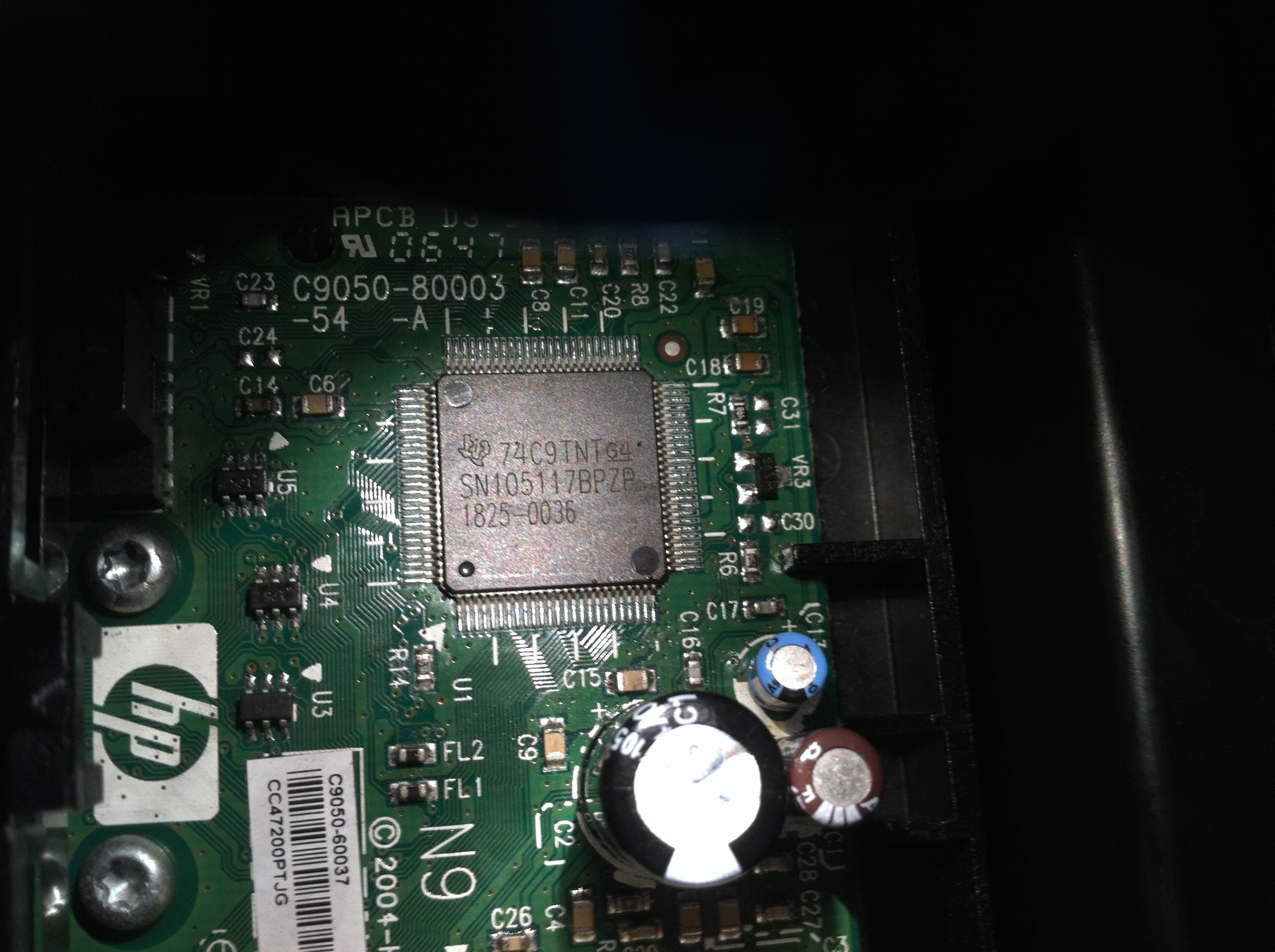

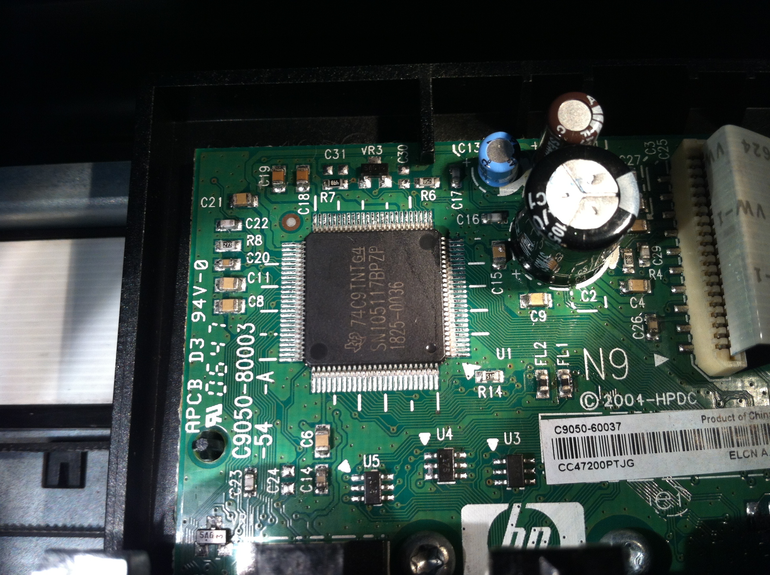

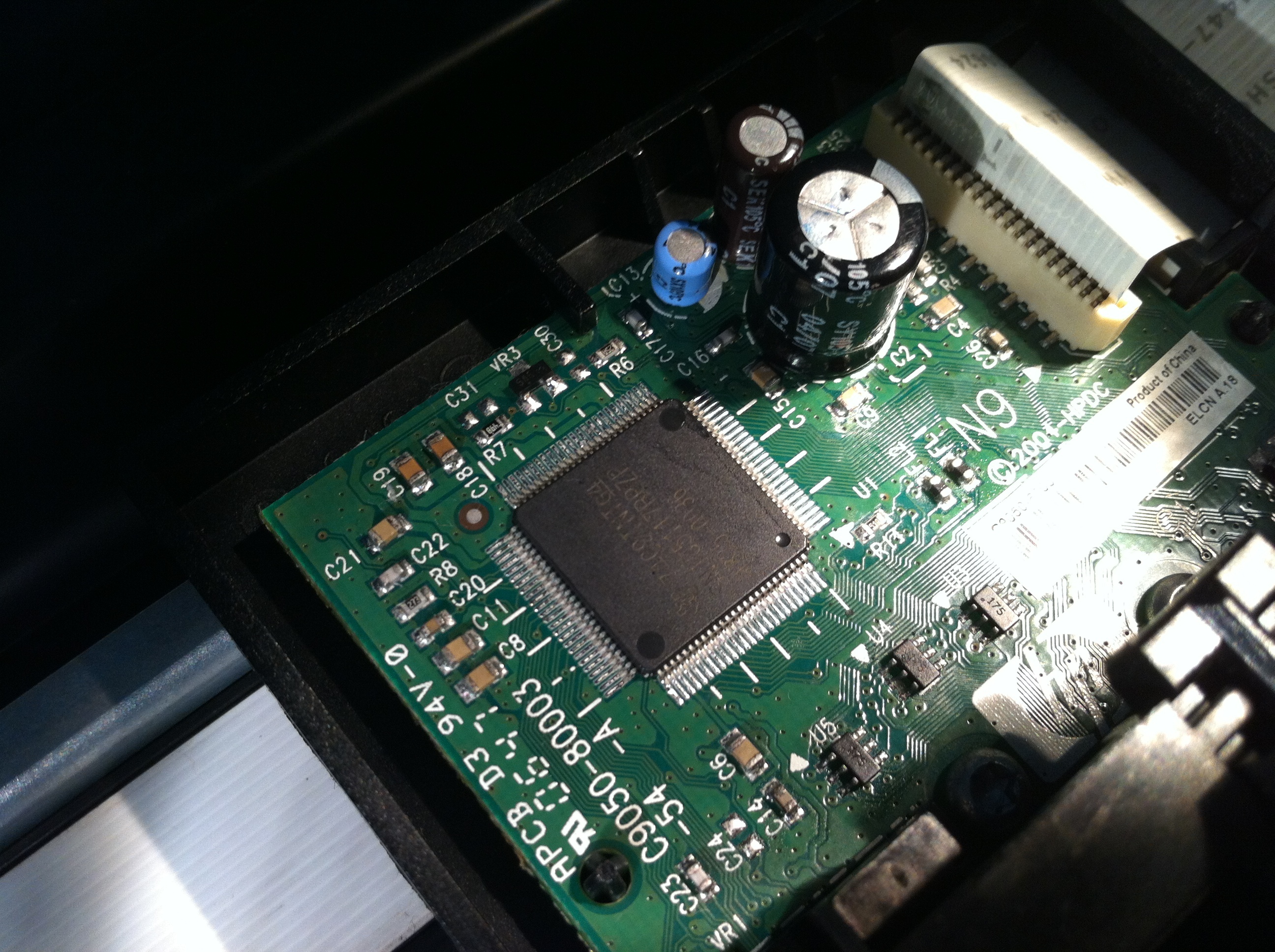

        I removed the cover on the IC that's on the print head PCB, here's photos
        74C9TNTG4
        SN105117BPZP
        1525-0036

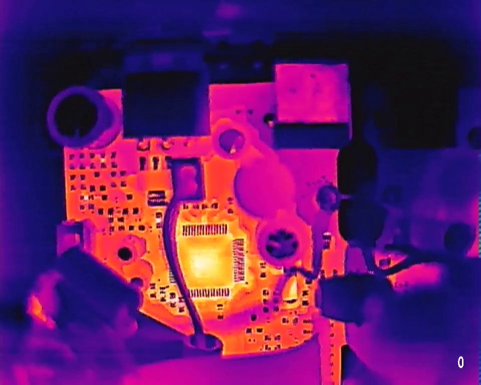

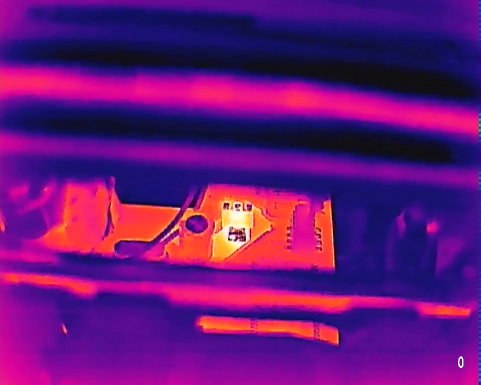

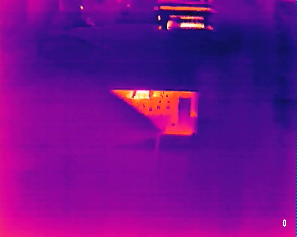

          New video in which the printer is fully assembled apart from the top part lifted away which is sitting aside (but with all cables connected) so I can see inside the printer.
          I show with a thermal camera what it looks like when powering up the printer.
          Can you see anything peculiar?
          https://rumble.com/v6ye2uu-faulty-hp...mera-view.html
          • flat-earther
            • Dec 2022
            • 127
            • palestine
            As seen with the thermal camera the Texas Instruments SN104961PJP is heating up.
            I hope that's not the problem because it's a custom chip.
            • flat-earther
              • Dec 2022
              • 127
              • palestine
              at time 1:50 in the video I see the voltage regulator EH11A 652J84 is heating up.

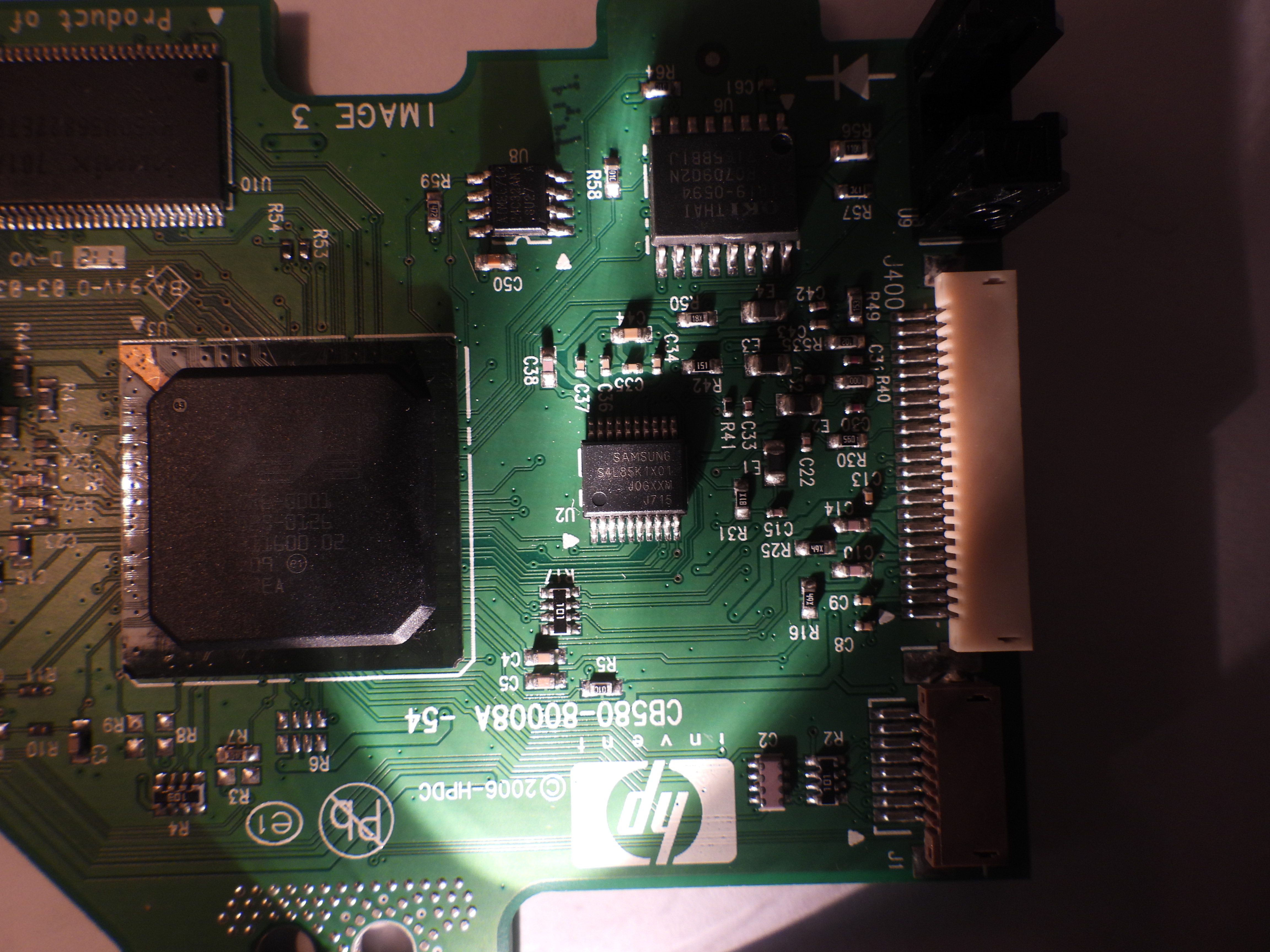

                at 1:26 in the video there is another chip getting hot.
                I don't know right now what that chip is as it's inaccessible without removing the motherboard and my old photos I posted here on badcaps of the motherboard are gone, actually all the photos I posted on this forum around may and june 2025 are gone.

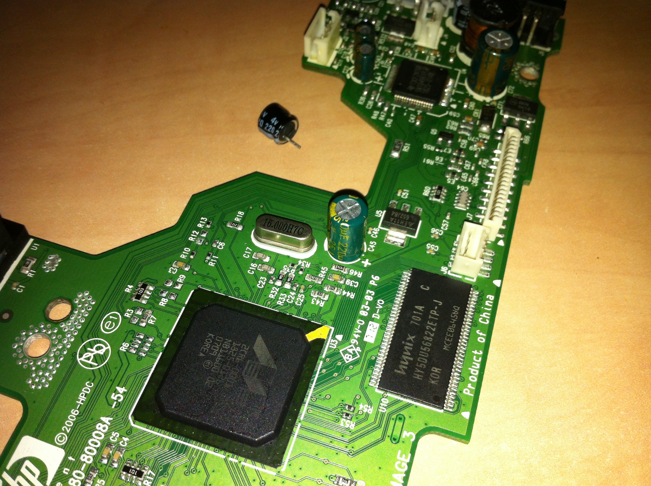

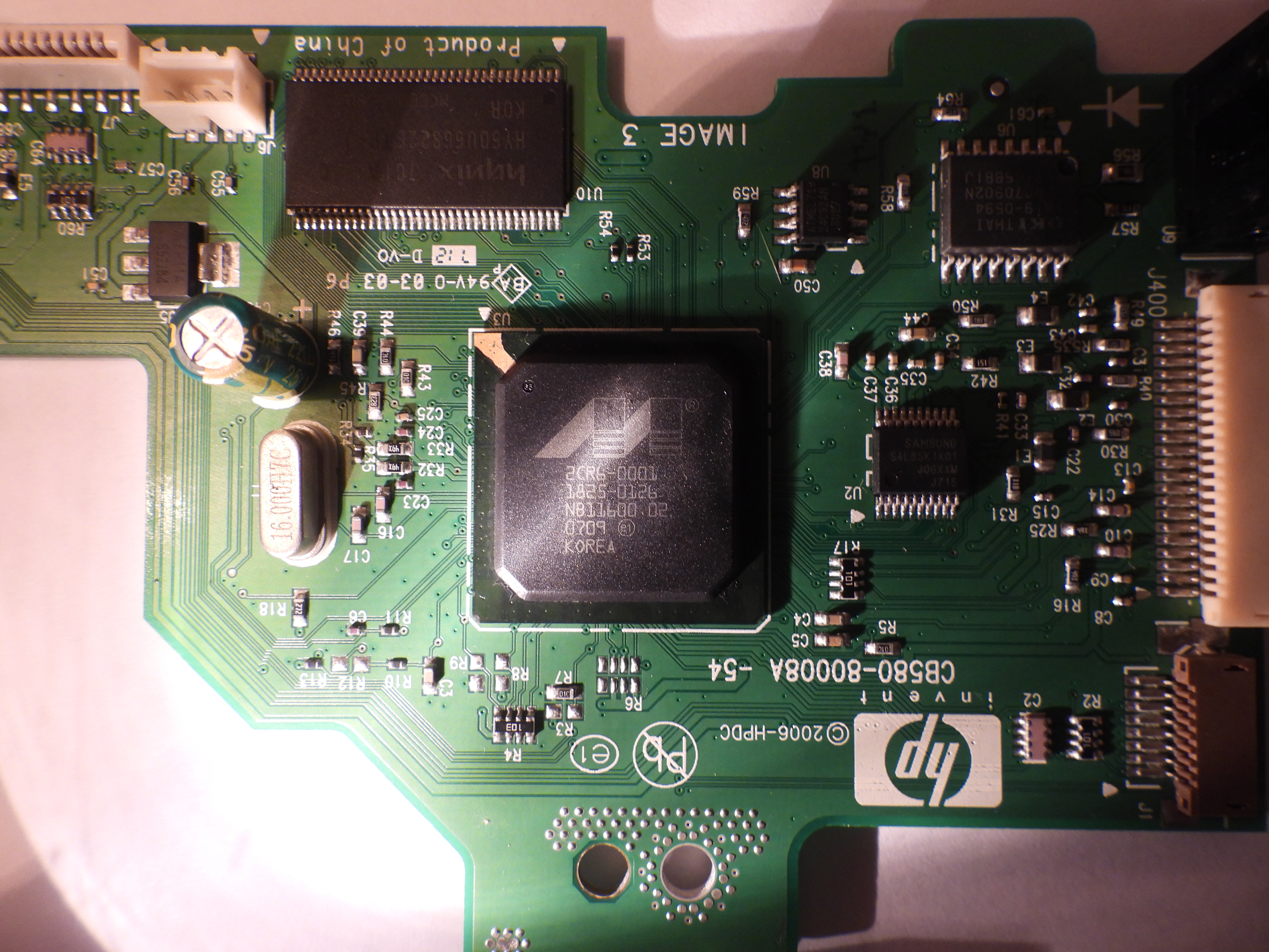

                  That chip is a SAMSUNG S4L85K1X01 J0GXXM J715
                  • flat-earther
                    • Dec 2022
                    • 127
                    • palestine

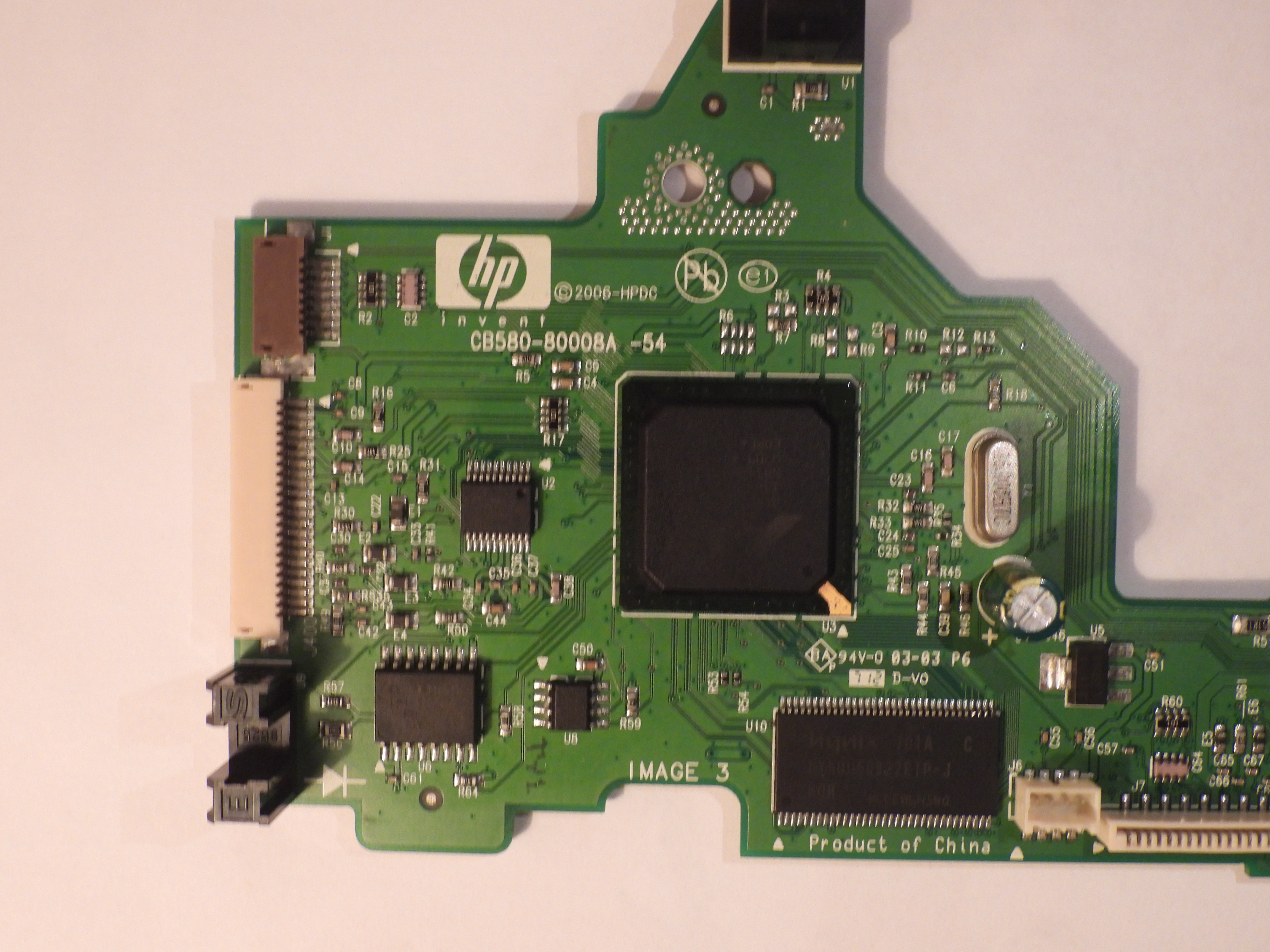

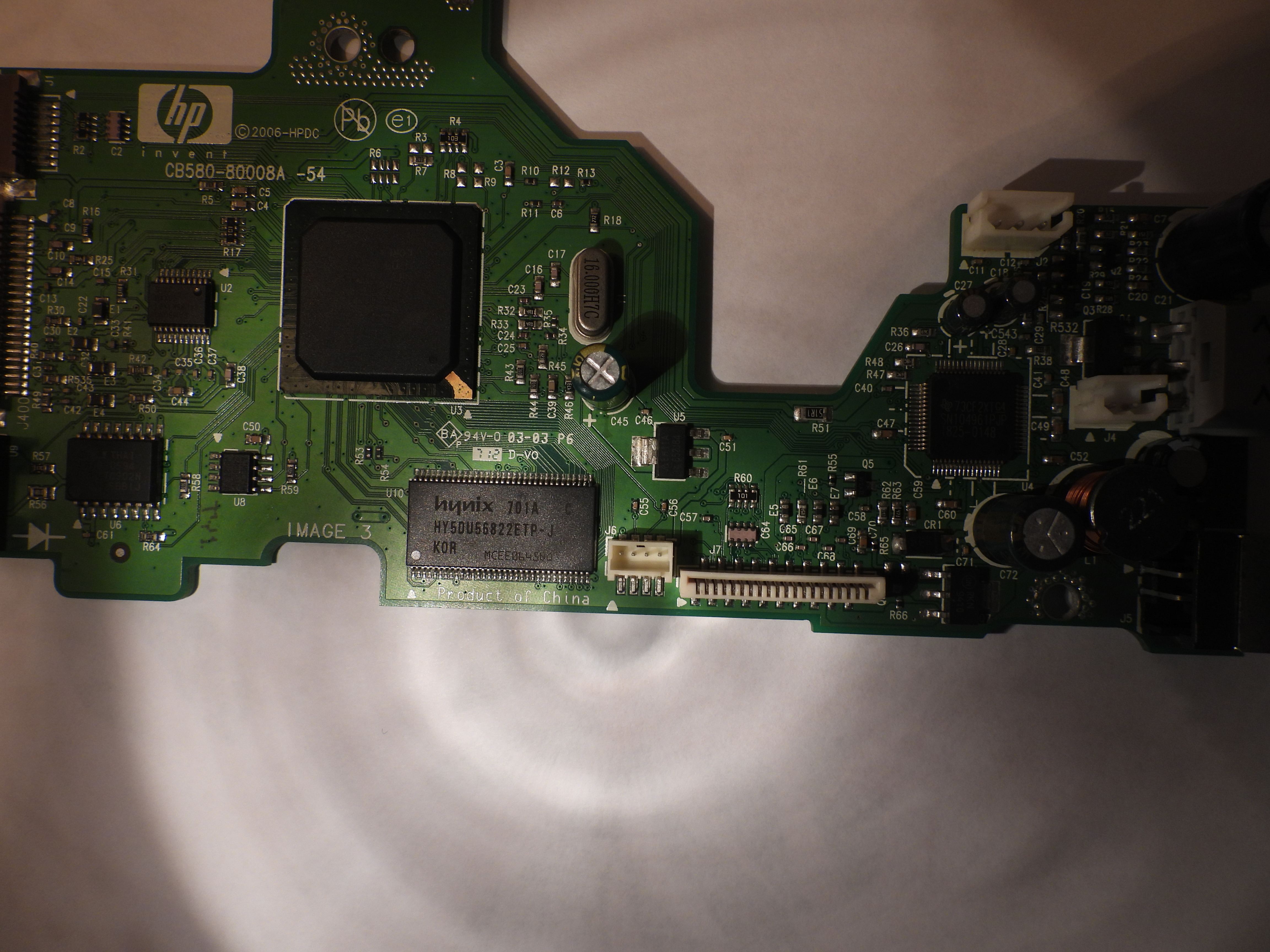

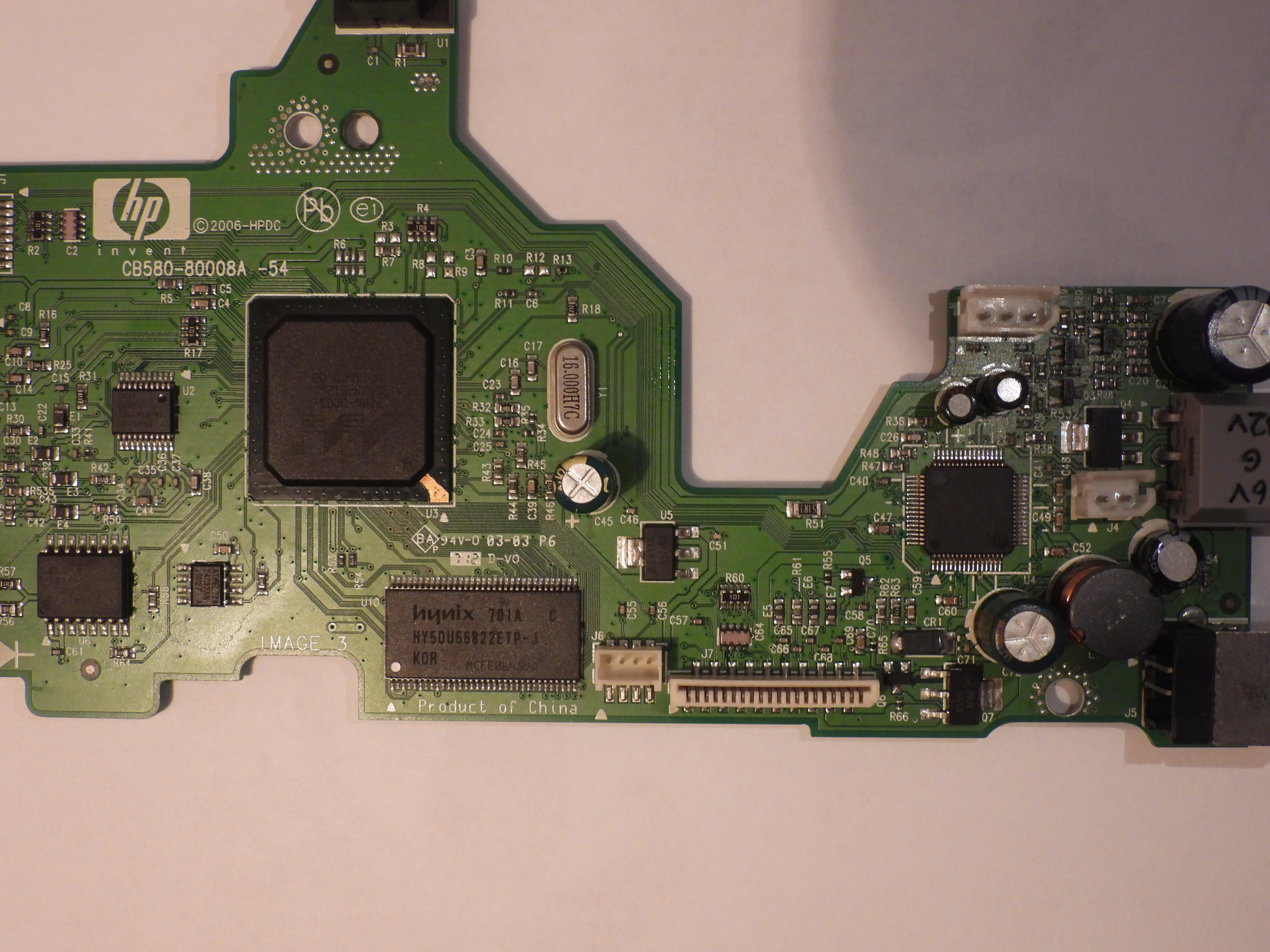

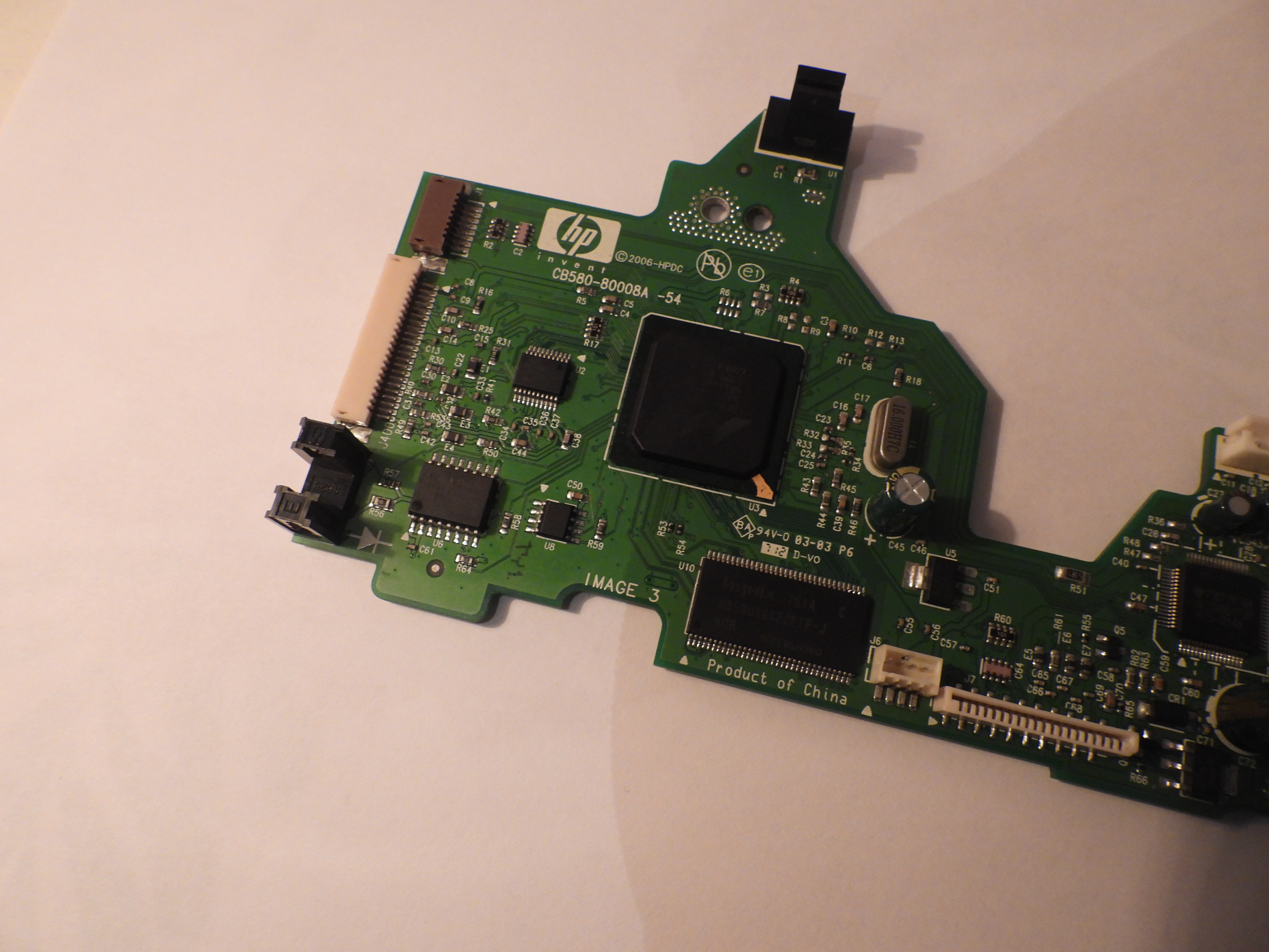

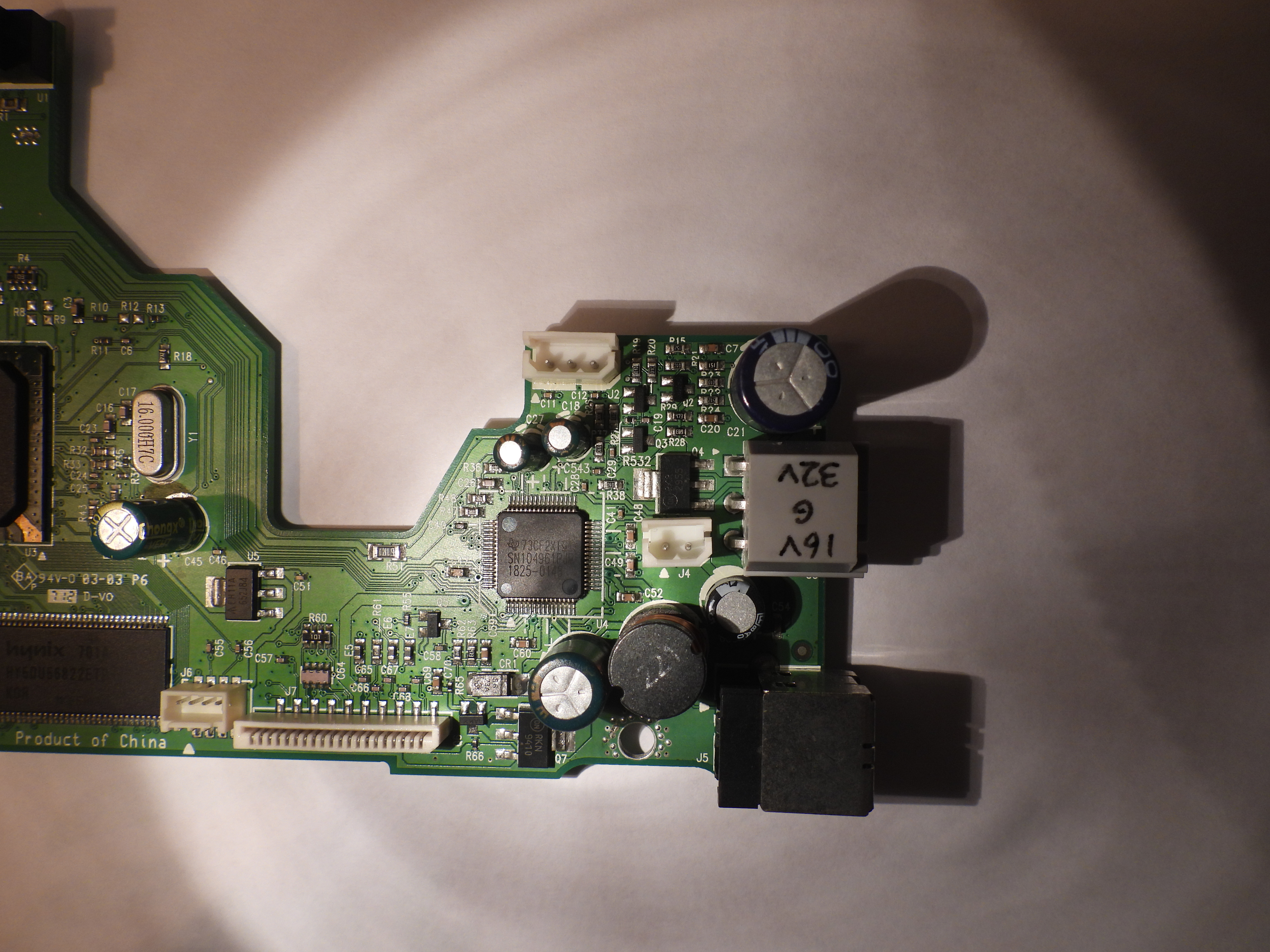

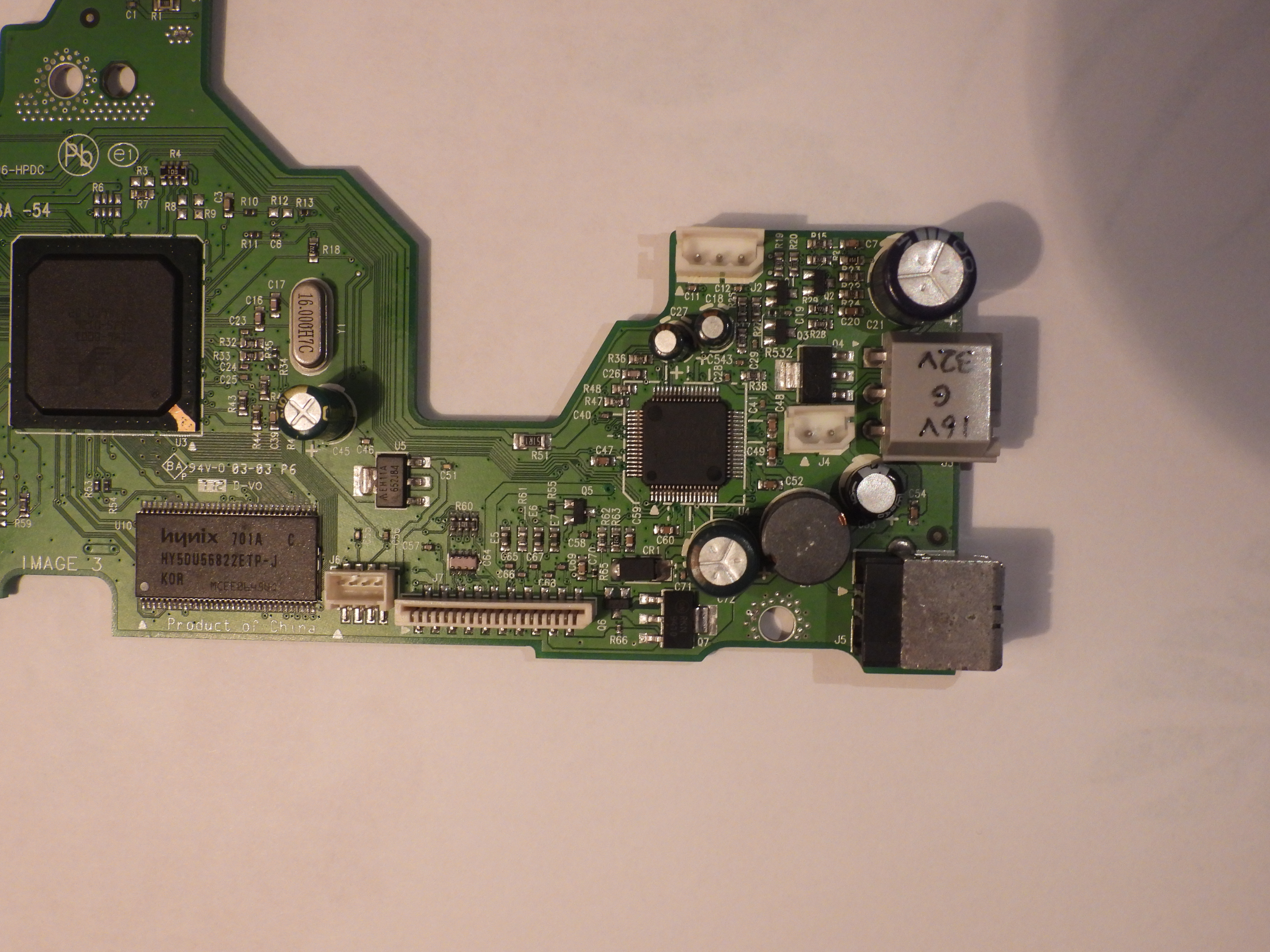

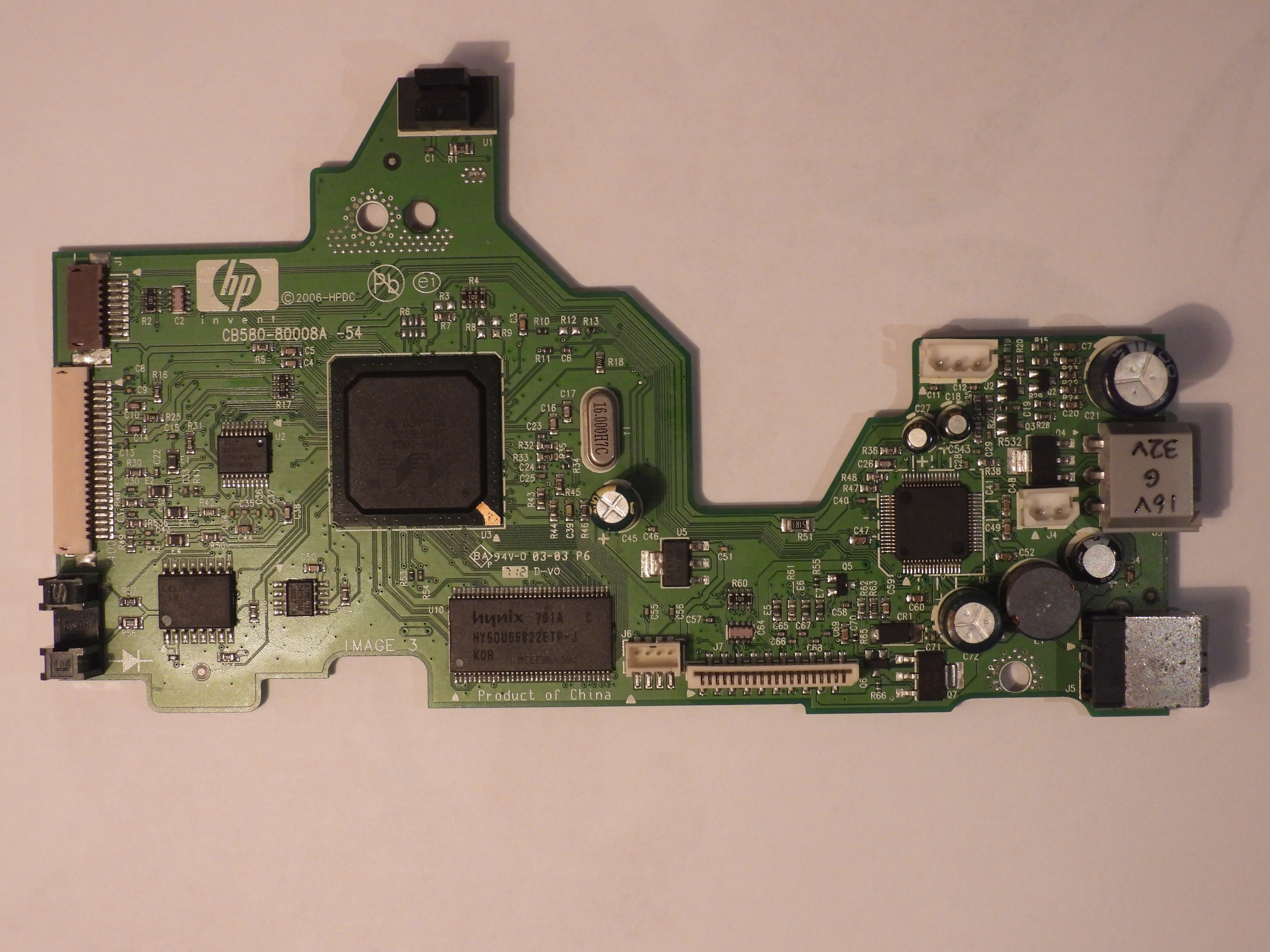

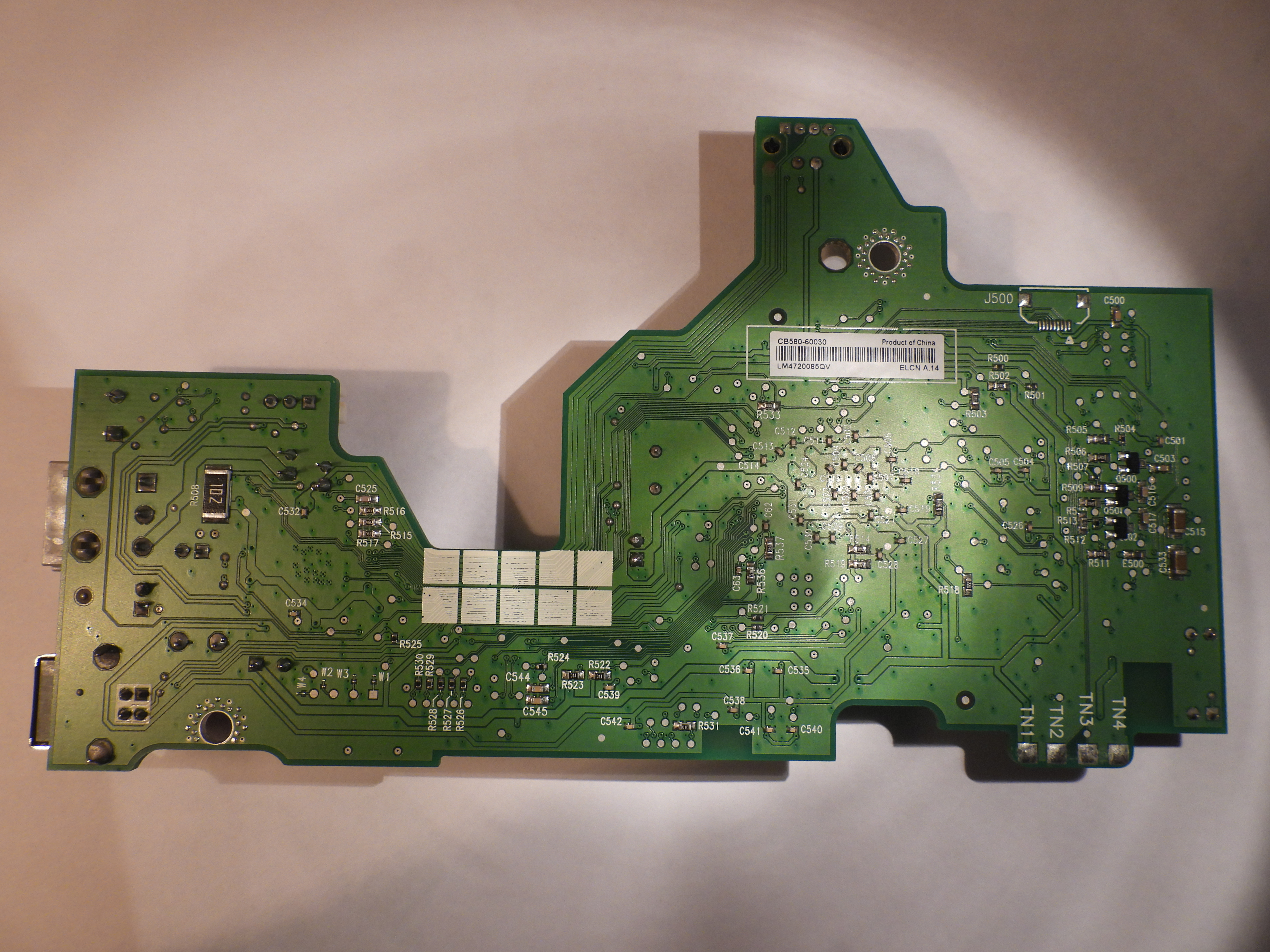

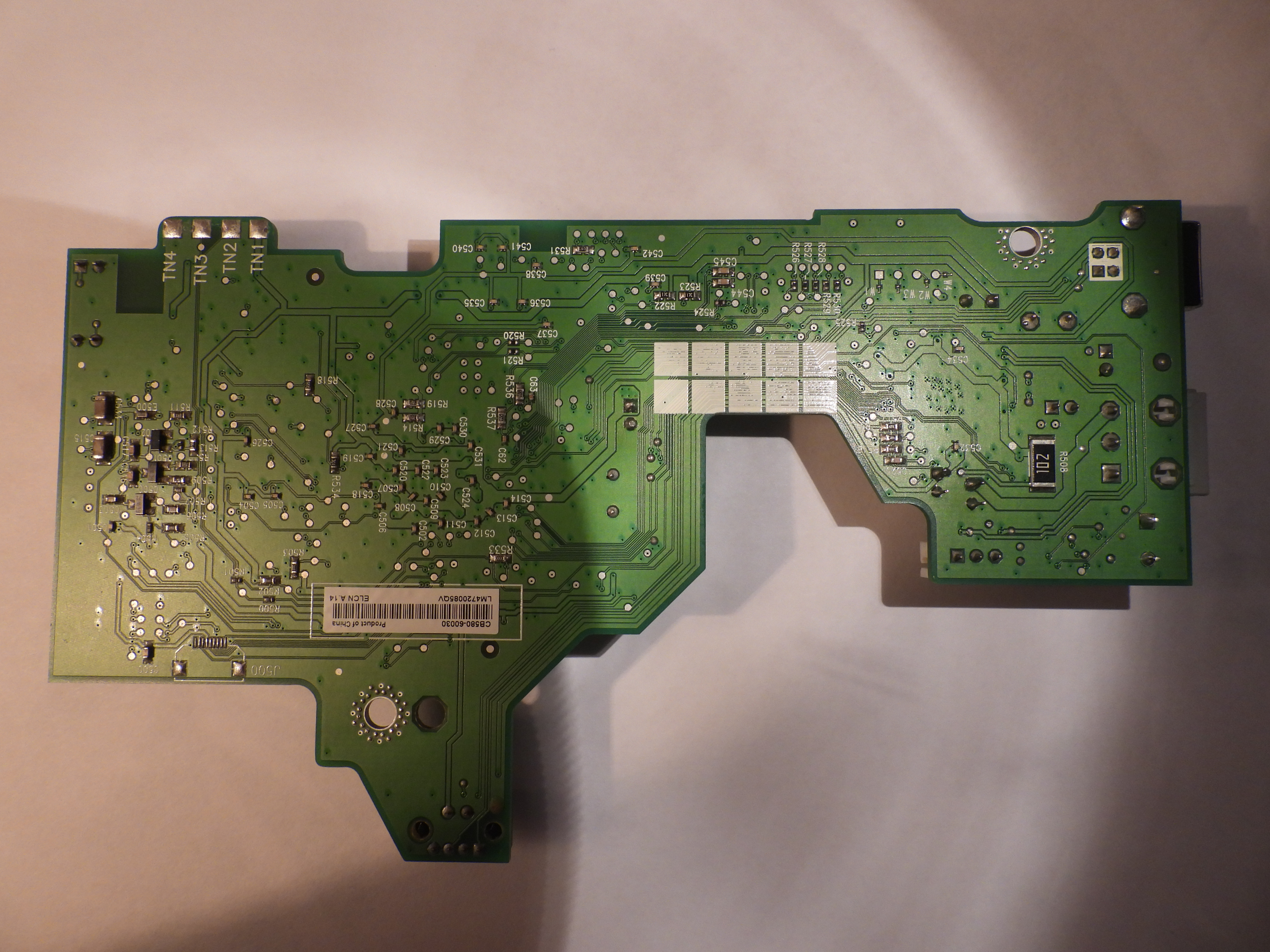

                    #29
                    I have removed the motherboard again.
                    I took new photos because my earlier photos were removed from badcaps.
                    • flat-earther
                      • Dec 2022
                      • 127
                      • palestine
                      #30
                      New thermal camera video powering up the motherboard itself on the bench. https://rumble.com/v6z954k-faulty-hp...rmal-view.html
                      What do you guys think is the problem?
