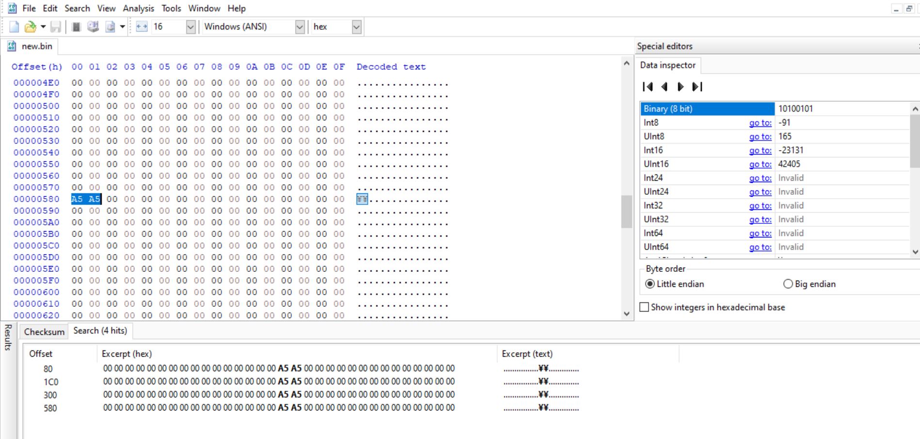

                  Re: MC-G01 Canon Maintenance Cartridge Rom request
                  Do you perhaps have the dump file in *.bin format? I would like to write it to the chip with a CH341 programmer.
                  Thanks for help.
                  • dillies
                    • Jun 2023
                    • 6
                    • south africa
                    use hex editor to modify dump. Insert only this info in attached picture. Fill rest with "00"
