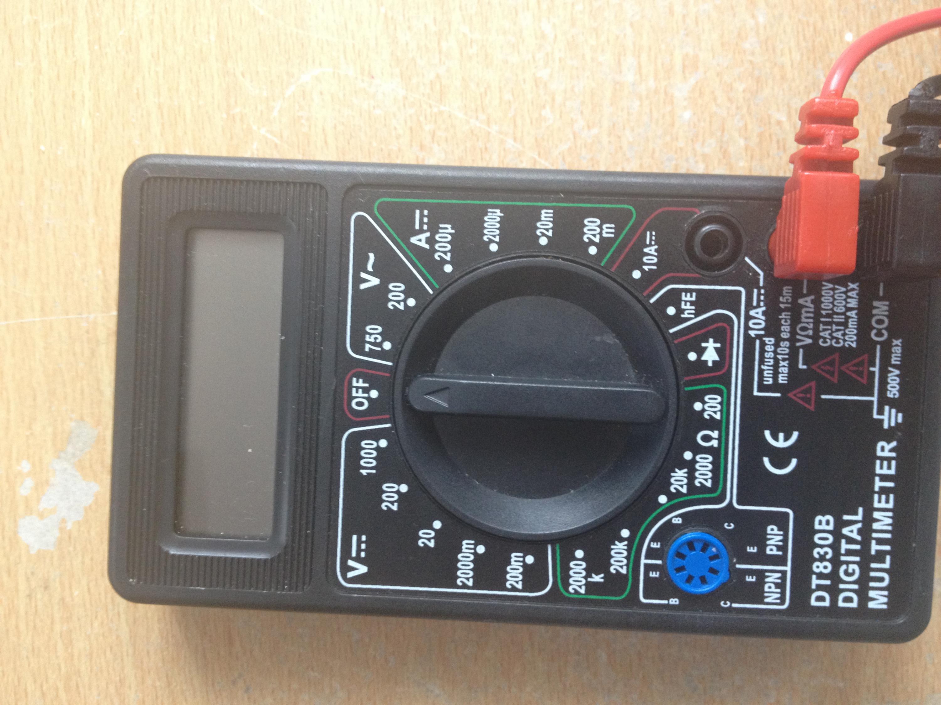

                            Also here's a pic of my meter, I can't find that setting?

                                      Use V flatline 3 dots 1000

                                        Thanks, have I got the probes in the right terminals? Com and VΩmA
