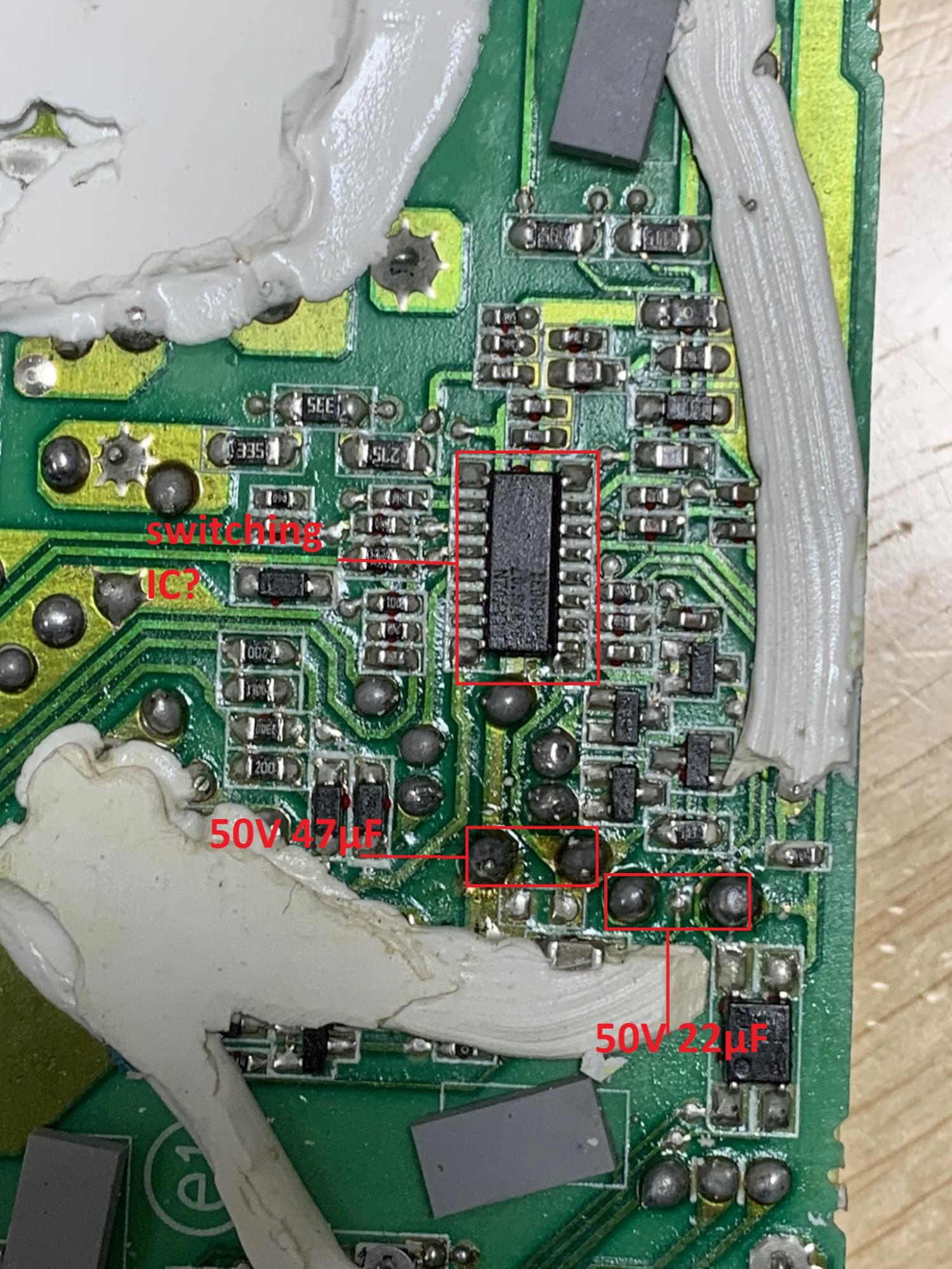

Please help to fix this PA-1151-03HS-ROHS power adapter

    Hmm. What part number is printed on the primary switching IC a that drives the mosfet?

      Re: Please help to fix this PA-1151-03HS-ROHS power adapter
      The part number is difficult to see. There are 3 rows. I can only see the last few numbers/characters on each row as follows.
      02N
      S107
      0031
        I don't think those small caps or the mosfets are the problem anyway. Your issue is strictly on the primary side, it's where the AC voltage comes in, get rectified to DC then stored in the 400V cap.
        Since the 19V DC output is only generated when 290V DC is present, and not when it's 170V DC, seems clear to me that either the bridge rectifier is failing or the 400V cap is.
                      02N
                      S107
                      0031
                      This is your LTA702N and here is the diagram with it.
