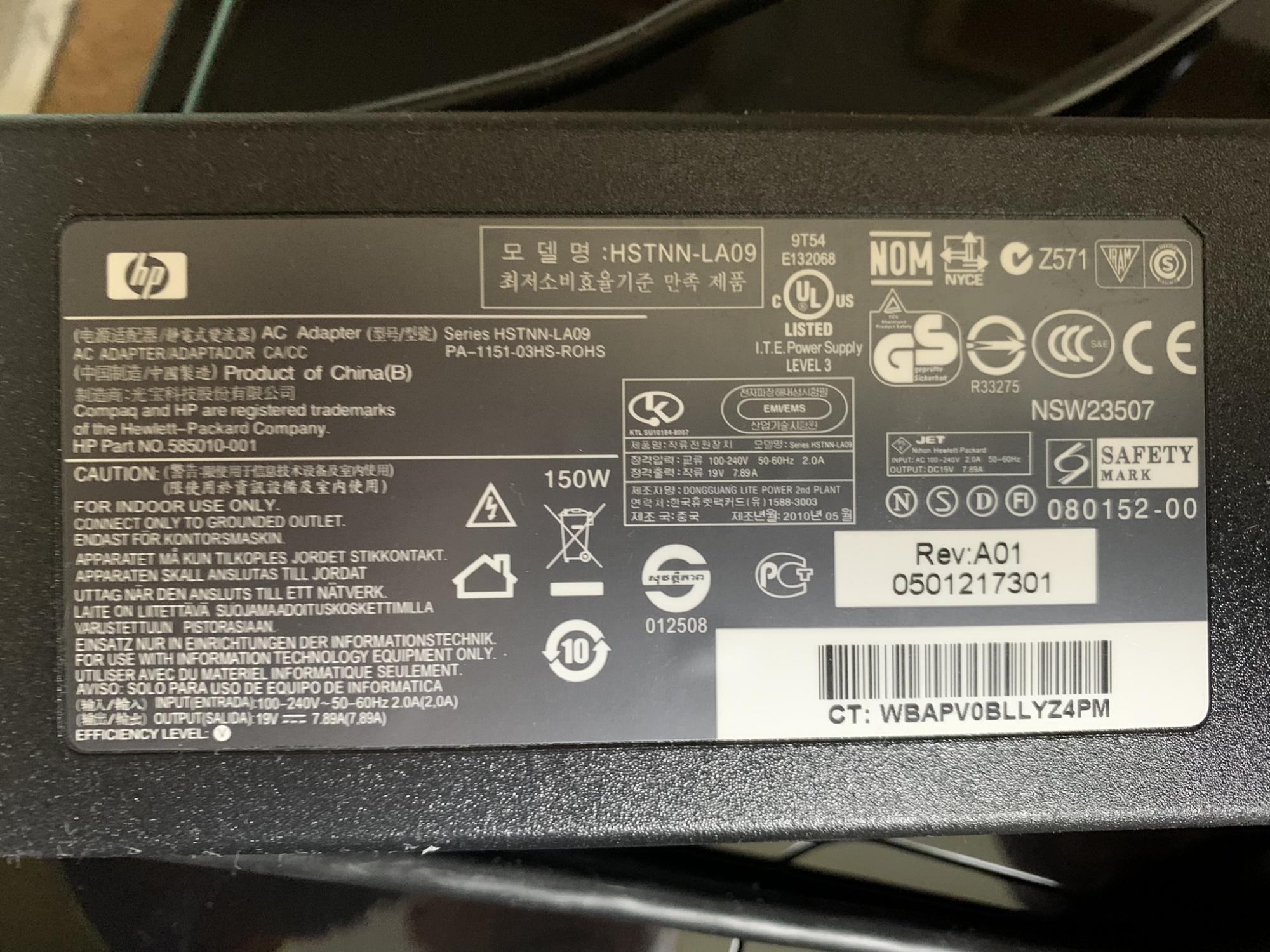

Please help to fix this PA-1151-03HS-ROHS power adapter
  • tmhobadcap
    • Apr 2019
    • 156
    • CANADA

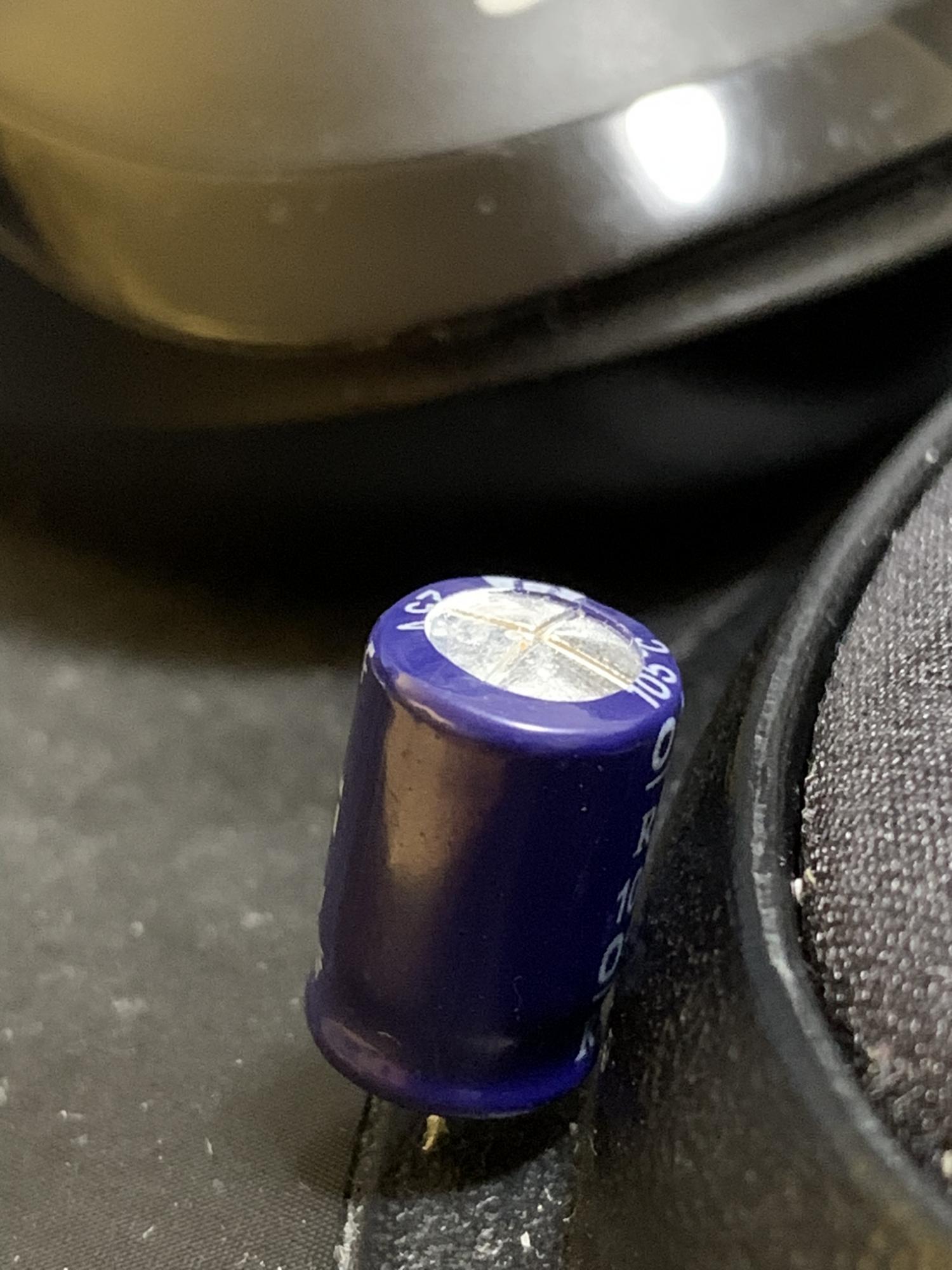

    The power adapter is for my HP 600-1390 Touch Smart All-In-One Desktop which could not be turned on recently. I found that the power indicator led light on the power adapter was not on and so I think something wrong with the power adapter.
    When I opened it, I found that the capacitor close to the led indicator light was with a bulged top. After replacing the capacitor, I still have trouble in getting 19V from the power adapter in order to turn on the computer. When I plug in the power, sometimes, the led (also the computer) does not turn on. But sometimes, the led (also the computer) turns on for a certain amount of time, which may be just a few seconds or as long as a few minutes.
    Because of my very limited electronics knowledge, I would like suggestions on checking which component first, since there is a lot of "glue" (the white color stuff) covering a lot the components and it is very difficult to clear/clean them before checking each component. Also, suggestions on how to clear/clean the "glue" easily are also welcome.

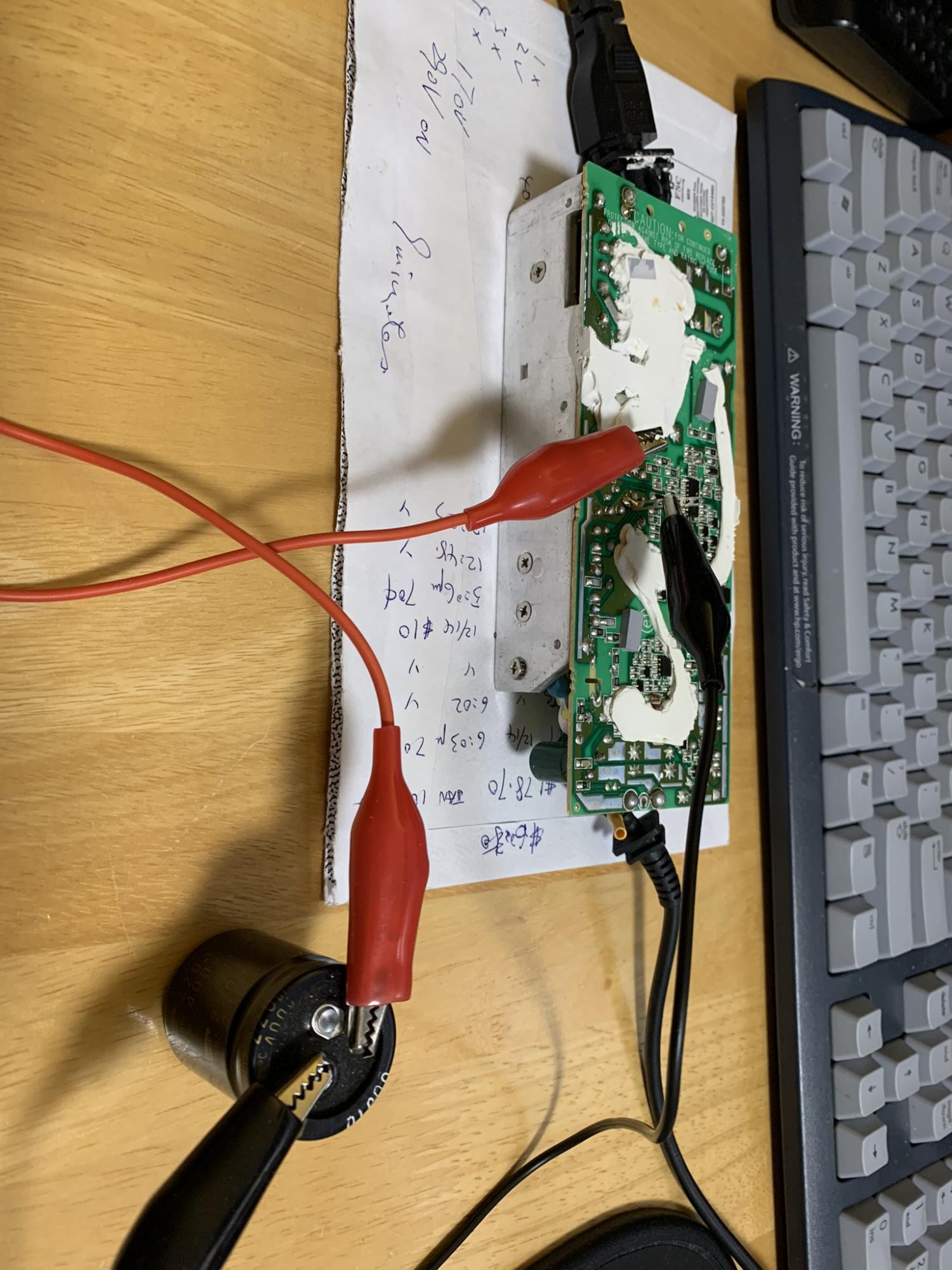

      Thanks for your comments.
      I followed your suggestion and ran the PSU with the covers off upside down. I tried four times to measure the voltage on the main filter capacitor (I think it is the biggest one which is 400V, 150 micro Faradays) with results as follows:
      First time
      I plugged in the ac power. The dc plug was not connect to the computer. The led did not light up. No voltage output. The voltage on the main filter capacitor was 170V.
      Second time
      I plugged in the ac power. The dc plug was not connect to the computer. The led light up. There was 19V dc output. The voltage on the main filter capacitor was 290V. I plugged in the dc plug to the computer. The computer turned on and ran for about 9 minutes and turned off. The led light turned off. The voltage on the main filter capacitor became 170V. I unplugged the dc plug from the computer. The led still did not light up.
      Third & Fourth times
      Same as First time.
      ps: The DC output cable was from a Dell power adapter. The is because at first I thought something wrong with the original dc cable and I cut it. I have checked that there is no continuity problem with the Dell cable. I have checked that there is no continuity problem with the AC power cable. Also, I have resoldered some of the suspected cold solder joints on the pcb.

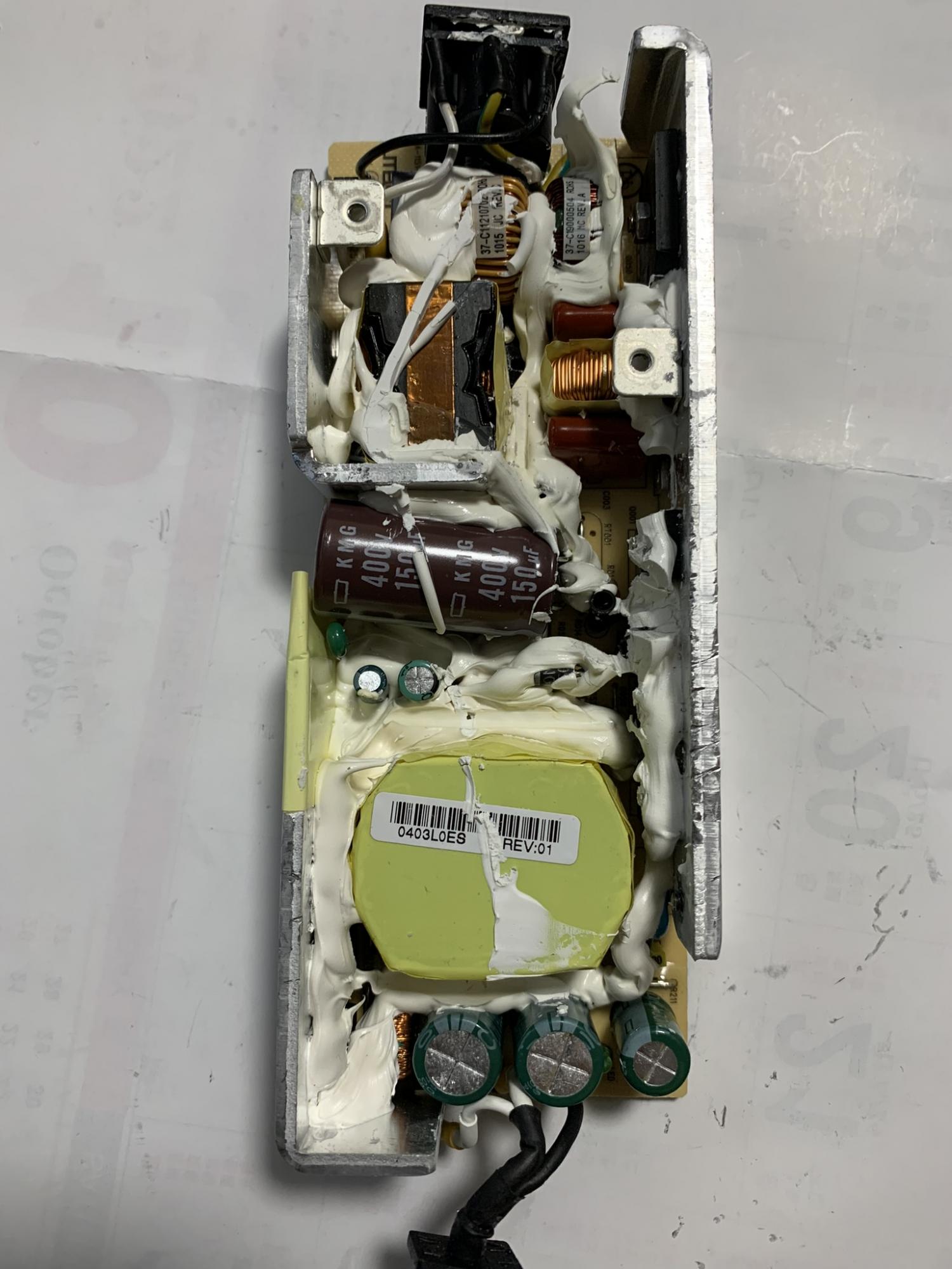

        The 290v is not an expected reading: with a line voltage of 120VAC you should see: √2 x 120 = 170VDC like you measure.
        However normally this voltage should be going through a voltage doubler: to get more useful energy storage in the big bulk filtering capacitor.
        That would bring the expected voltage to 340VDC (this is why it is rated to 400v).
        However you don't see that in any of your readings so I'm wondering if maybe the capacitor is bad.
        It would be good to have a capacitance meter and measure that it really is 150uF like the print says...

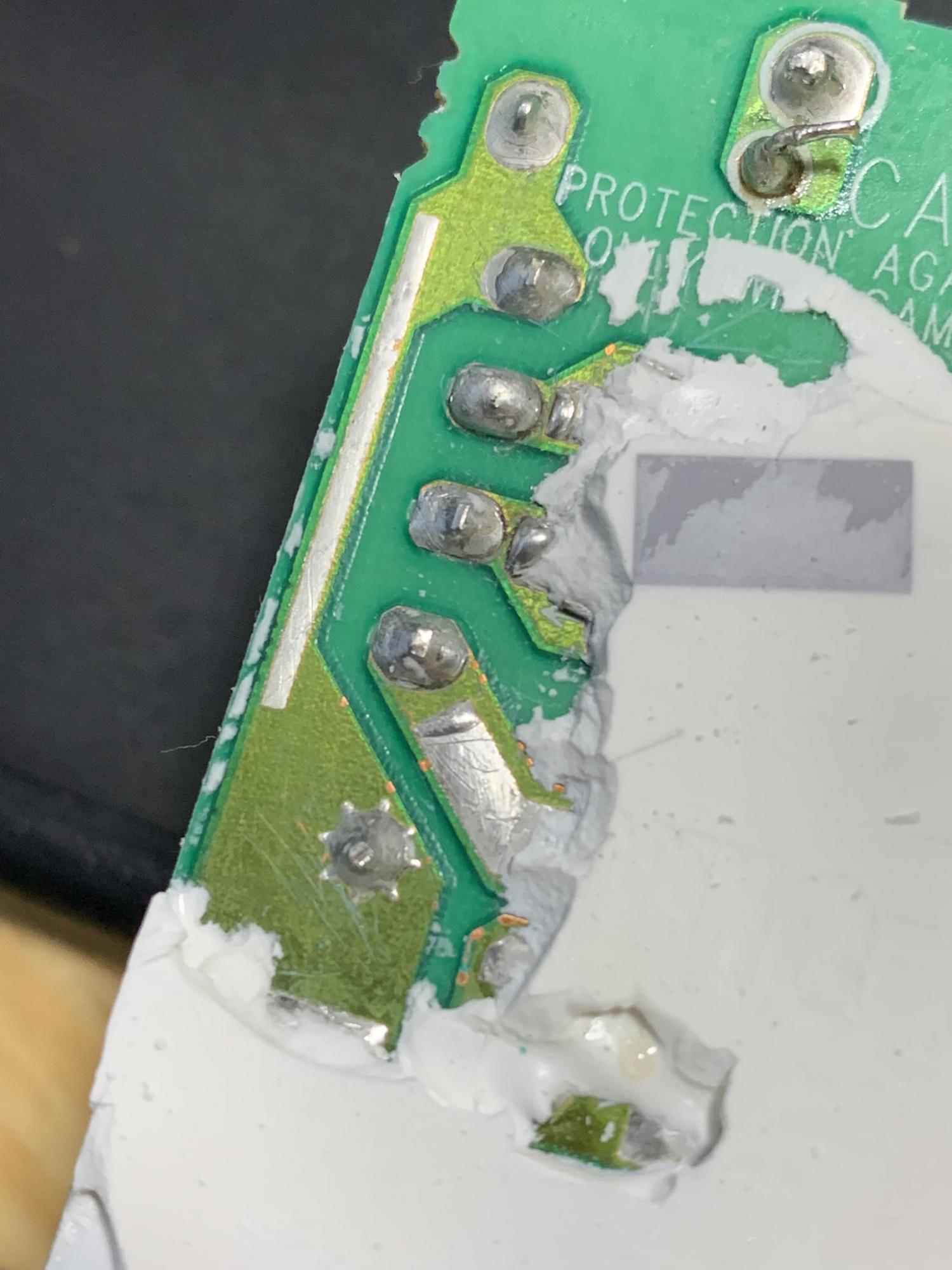

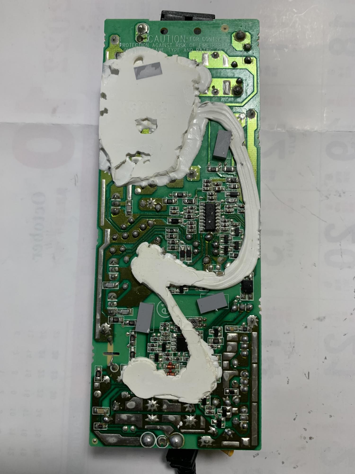

                I have both probes on the capacitor on the underside of the pcb. Will do more resoldering as per your suggestion after removing the silicone. Since the silicone has been hardened, it will take a lot of time and patient. Anyways, I will try to do so.
                I removed the silicone covering one of the components with heat sink. And then I resoldered the joints. Then I powered up the PS for the 5th time, the result is just like the 1st time.
                I will do more later.

                  Resolder everything that’s heavy or gets hot. Sometimes you need a microscope of some sort to see the rings on solder joints. It may look good to the naked eye, but yet it’s not. While you are at it, maybe your DMM has a min-max function. Put your meter to the output of the psu and let the DMM record what happens. I wonder if the output gets a bit unstable and the PSU in protection mode?
                  What PWM does it use in the primary?

                    I think of a quicker way to test relating to the capacitor. I have a 220uF 400V capacitor. I connected it in parallel with the existing 150uF 400V capacitor so that I do not need to remove the 150uF (removing it needs to remove some of the silicone first). In such case, the total capacitance will just be higher. So if the 220uF is correct in term of capacitance, then I can know if the problem is from the existing 150uF capacitor. Am I correct?
                    Anyway, I have added the 220uF 400V capacitor and done the 6th and 7th time of powering up the PS and have the following results.
                    6th time
                    Just like the first time.
                    7th time
                    I waited the voltage across the 150uF capacitor to drop to 0V and then plugged in the ac power. The dc plug was not connect to the computer. The led light up. There was 19V dc output. The voltage on the main filter capacitor was 290V. I plugged in the dc plug to the computer. The computer turned on and running. So far up to this moment, it has been running for about an hour. I will keep it running to see if it will turn off by itself. Also, I will turn the computer off before going to bed and see if I can turn it on again tomorrow.

                      Yes, I will do resoldering on all the joints after removing all the silicone on the bottom of the pcb. May I know why they add silicone? Just for gluing? It seems to me that no gluing is needed on the bottom of the pcb covering some of the soldering joints.
                      Yes, next time I will check if there is any sudden change on the output voltage.
                      Sorry, I do not know what PWM means.

                                  Look if there is a small cap next to the pwm. It’s called a start up capacitor. Change it.
                                  It almost sounds like when the PSU a is cold it doesn’t want to run. Try heating it up a bit with a hair dryer, then plug it in.
                                  I second this, try changing the two small caps next to the large 400v capacitor.

                                        Today, I removed the silicone and replaced the two small capacitors. One is 50V 22uF and one is 50V 47uF. I do not have 50V 47uF and so I used 100V 47uF.
                                        After that the computer was turned on. But unluckily, after running for about 3 hours, the computer turned off (the power supply light went off).
