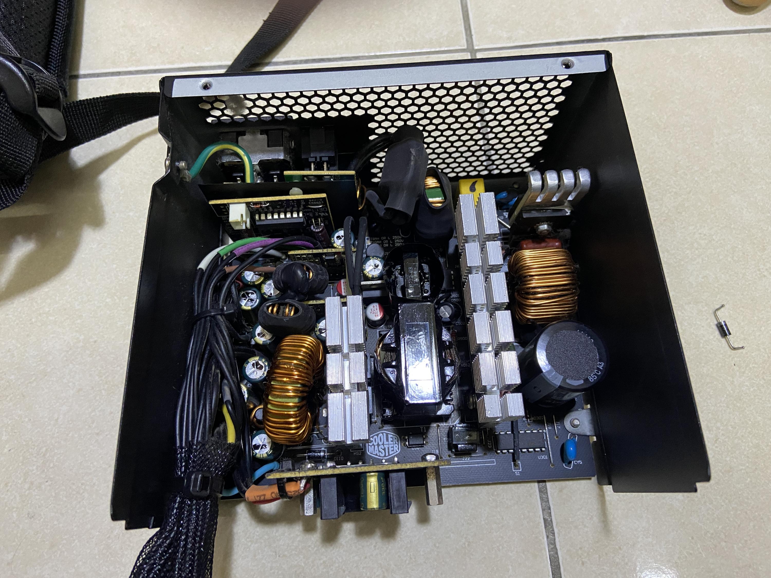

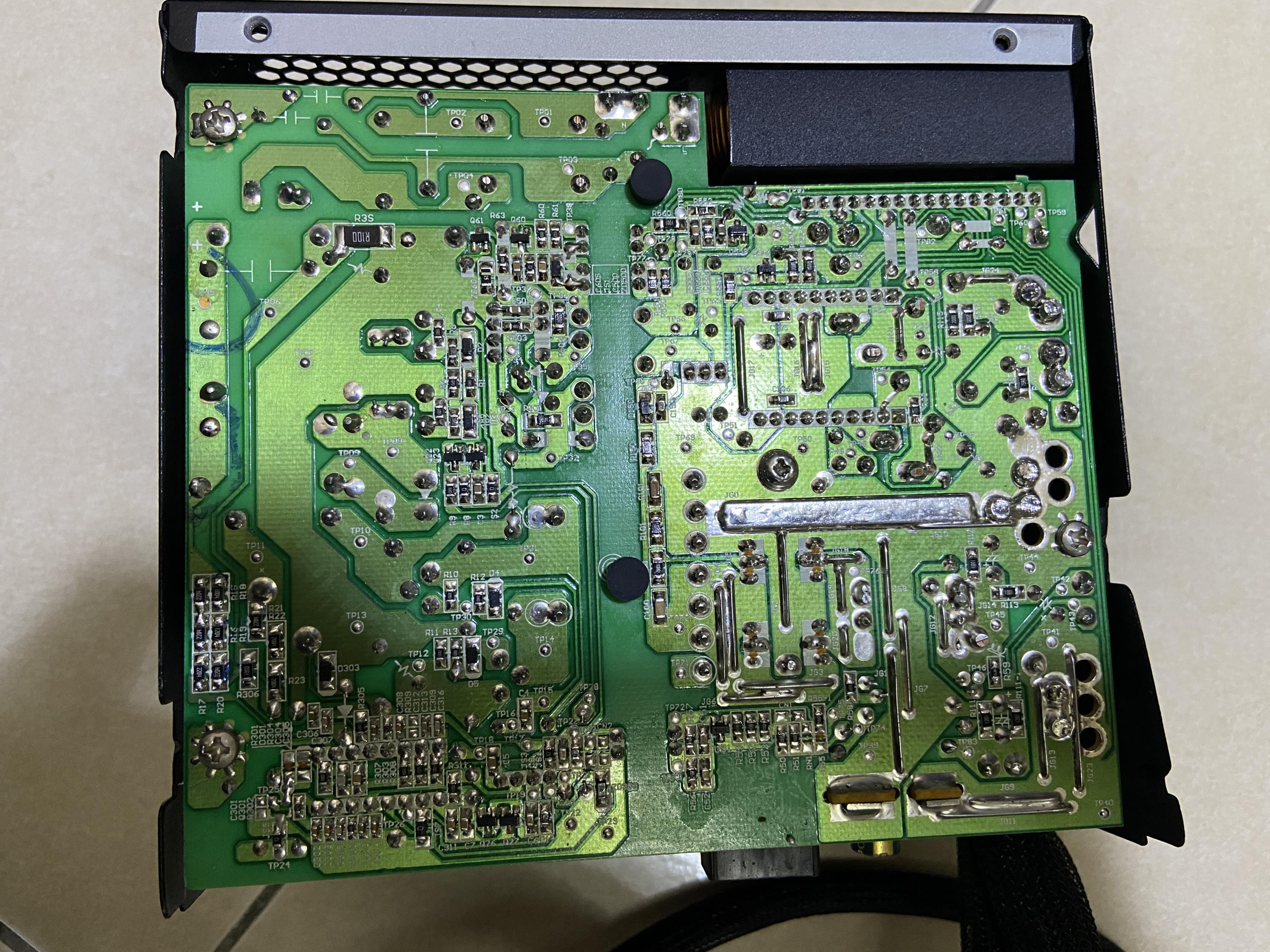

    Hi guys,
    i got this broken computer PSU with model number MPX5501AMAAB.

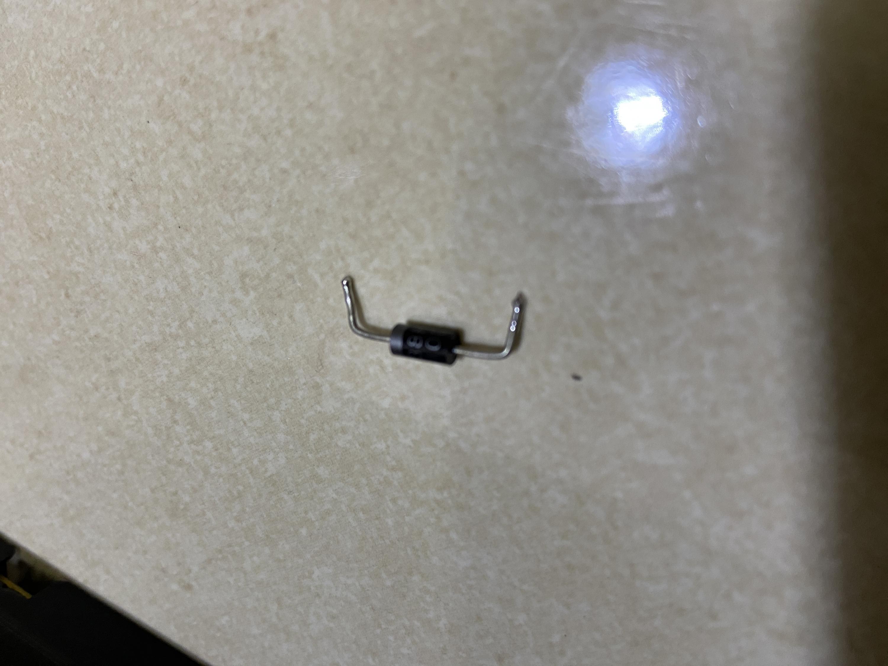

    i detected that 1 of the diode (model number: SB2100) was broken and replaced with a new one. but that not solved the issue as the problem is still persists which indicates that other components are also shorted. maybe someone can advice on what to do next?
    I attached some pictures for reference.
    on the other hand, i encountered quite a few PSUs with the same problem..i.e the diode is shorted/opened but replacing it not solving the issue..may this be a good indicator what is the real problem is? maybe some of you experience the same thing and can direct what should i be looking for for such situation.

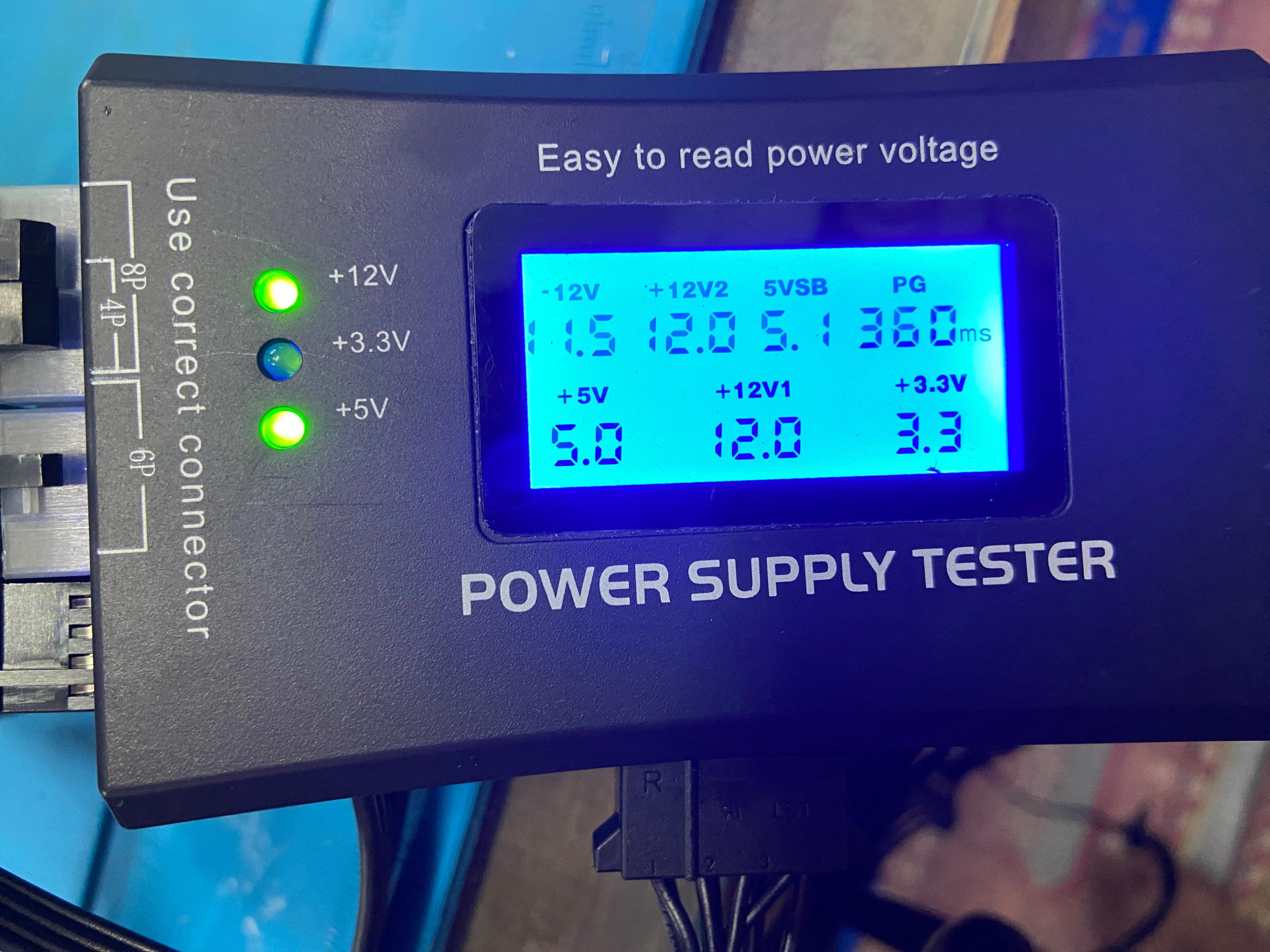

    Lets start at the beginning. Do you have 5 volts on the 5vsb output line?

      Re: Cooler Master 550 watt - fan spins few seconds and then stop
      hi everell, thank you for your reply. based on this picture i got from the psu tester showing that 3.3v is missing..the 5 volts is present.
          you have 3.3v - it's on the lcd.
          the leds refer to the extra cables on the left.
            i see. but the fan spins and stops after few seconds..i tested the fan and the fan is working well..what am i missing here
              • 31043
              remove and inspect the fan control pcb - it may be waiting for the heatsink to warm up, or monitoring the current being drawn.
                yea there is a small board that the fan is connected to it. i will desolder the board and inspect the ic
                    I learn that some atx psu need external load to come on operating state, dont judge on fan. Your tester shows all voltage present. If you connect motherboard, what happens?
