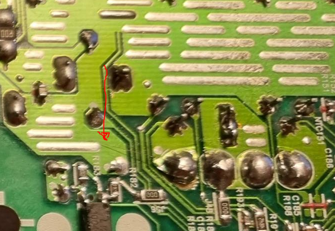

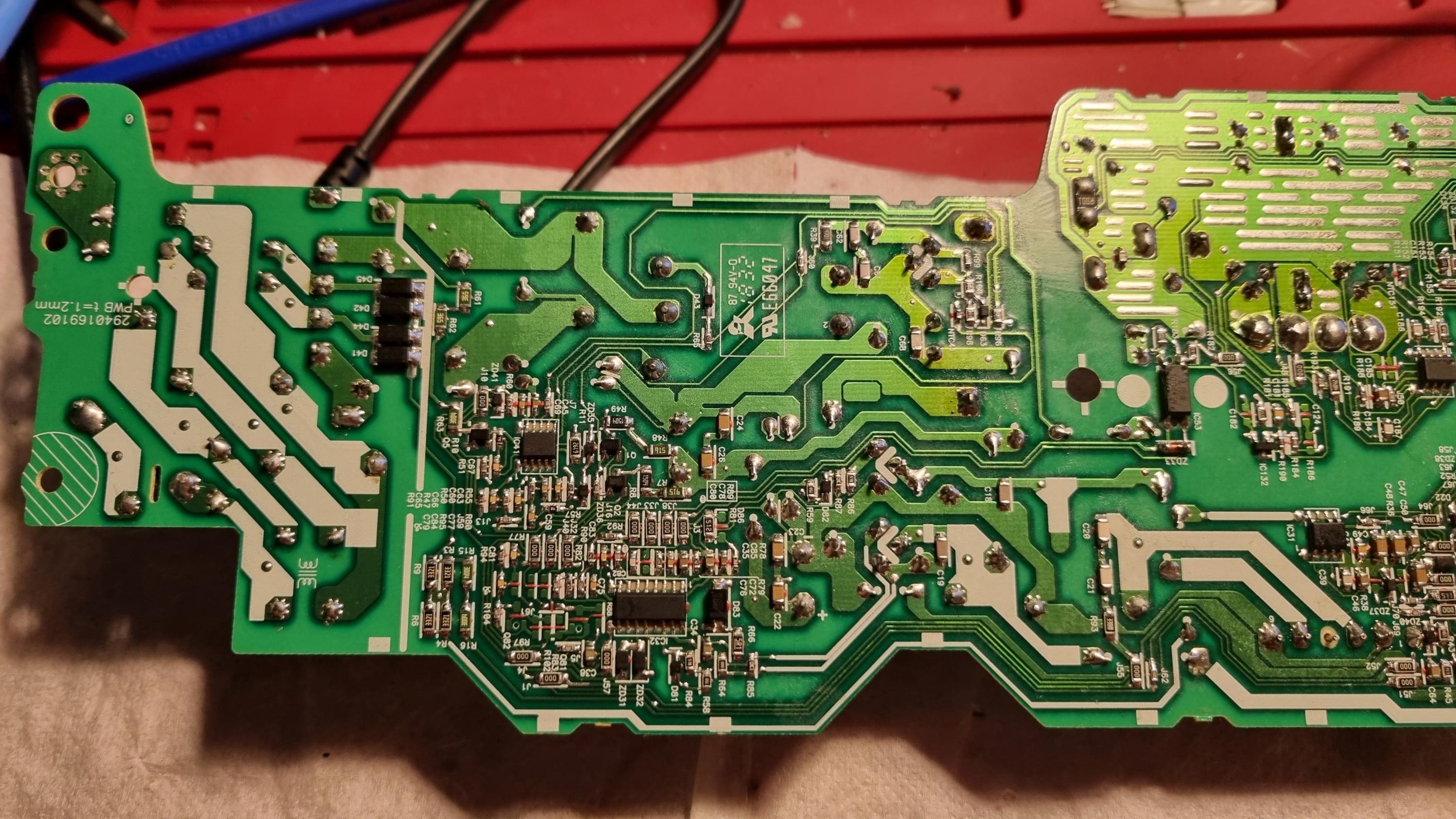

PS4 pro PSU (ADP-300FR) shuts down when turning on 12V
Hello, I have a power supply PS4 PRO model ADP-300FR.
The part around the fet is gone, I'm wondering if anyone has a picture of this part of the power supply to see the resistor R99 and diode D63 markings?
Thanks a lot.
Attached Filesif you find these attachements useful please consider making a small donation to the site
Leave a comment:
Re: PS4 pro PSU (ADP-300FR) shuts down when turning on 12V
Thanks for sharing this video information very informativeLeave a comment:
Re: PS4 pro PSU (ADP-300FR) shuts down when turning on 12V
https://www.youtube.com/watch?v=sx0oBXsueFk
Hope to help u
Leave a comment:
Re: PS4 pro PSU (ADP-300FR) shuts down when turning on 12V
The IC has finally arrived and I had some time to replace it.
The results are amazing, the PSU now works perfectly and even the PS4 starts with it. It displays an image mentioning that it could not find the storage. The HDD is busted (because of the same fall that damaged the PSU), not even my PC recognizes it.
Thanks for the help guys, I could not done it wothout you!Leave a comment:
Re: PS4 pro PSU (ADP-300FR) shuts down when turning on 12V
Nice catch
I have noticed this yesterday but seems like my edit didn't go through.
The shorted pins are:
10 - pfcOK (5 ohms to GND)
8 - DRV (1.2 ohms to GND)
7 - GND
The MOSFET isn't shorted, I have desoldered and tested it before.Leave a comment:
Re: PS4 pro PSU (ADP-300FR) shuts down when turning on 12V
The mosfet can be shorted too, all those 3 pins (6,7,8) go through low ohm resistors to the mosfet.
Or are you confused with pins (8,9,10)?Attached Filesif you find these attachements useful please consider making a small donation to the site
Leave a comment:
Re: PS4 pro PSU (ADP-300FR) shuts down when turning on 12V
I think I've finally found the problem!
The PFC controller IC (IC41 - "NCP1612A3") is shorted.
The following three legs of this IC are connected together (resistance is less than 5 ohms):
7th - GND
6th - DRV
8th - pfcOK
...and I don't think they should be.
I can buy this chip online but it will take at least a month to arrive.
It's also glued down so I have to be extra carefull when removing it.
I will report back with the results
Leave a comment:
Re: PS4 pro PSU (ADP-300FR) shuts down when turning on 12V
check the pfc fet(s) & diode for shortsLeave a comment:
Re: PS4 pro PSU (ADP-300FR) shuts down when turning on 12V
There isn't much progress I can report. Still trying to figure out why the power is cut when I try to turn on the 12V.
In standby mode, the PFC IC (IC41 - "NCP1612A3") has no power on the VCC leg. (0V) When trying to turn on 12V, it has something for a fraction of a second but the PSU turns off before I can measure it with the multimeter.
Also measured the output of "T2" on the low voltage side to see whether I have 12V for a short time after trying to turn on the PSU but nope. Nothing there.
I'm still not sure which IC cuts power and why. PFC is not running but I'm kind of stuck why. Would love to narrow the issue but I don't have the knowledge to do so.
Made a note of the ICs on the board. Maybe someone will find this useful in the future:
IC31 is "DAP046"
IC32 is "DAP049"
IC41 is "NCP1612A3"
IC101 is "MP6922L"
IC155 is "DNP012AH"Leave a comment:
Re: PS4 pro PSU (ADP-300FR) shuts down when turning on 12V
Nope, it's from the brush I have used to clean the flux
Scanned the board using my microscope and didn't find any micro cracks.
Just seen a video where the PFC circuit was faulty and indeed, having a fault in the PFC section could cause the issue I currently have.
The problem is I'm kind of lost regarding the PFC section.
When comparing it to the schematics of the other PSU (the only schematics I currently have), it has a different IC with a different pinout. Even the huge coil (L1) has some differences and with this many small SMD components, it's hard to know what supposed to go where.
The IC that drives the section is "NCP1612A3" (IC41). I've found the datasheet and attached it to this post.Attached Filesif you find these attachements useful please consider making a small donation to the site
Leave a comment:
Re: PS4 pro PSU (ADP-300FR) shuts down when turning on 12V
I will.
The schematics I've attached (in my first post) has a PFC section, not identical (as it is for a different PS4 PSU) but similar. I might be able to use that to know what components should be checked.Leave a comment:
Re: PS4 pro PSU (ADP-300FR) shuts down when turning on 12V
Well, if the power does not rise, then the PFC does not work, there may be a microcrack on the board, look at large, power elements.Leave a comment:
Re: PS4 pro PSU (ADP-300FR) shuts down when turning on 12V
Okay I have borrowed a multimer and made some measurements on the high voltage capacitors.
When the PSU is running in standby (= no pins on the small connector are connected), the big caps have 317V.
After trying to turn on the PSU (by connecting the pins), it stays at 317V...so either the PFC is not working or it is just not turned on in the first place?Attached Filesif you find these attachements useful please consider making a small donation to the site
Leave a comment:
Re: PS4 pro PSU (ADP-300FR) shuts down when turning on 12V
Yes, I wish I could test this but all 3 multimeters I have at home could only measure up to DC 300v
Even with the PFC turned off (when the PSU is only running in standby), those caps are over 300v.
I might be able to borrow a multimeter that measures up to DC 1000v and test this.Leave a comment:
Re: PS4 pro PSU (ADP-300FR) shuts down when turning on 12V
You checked that the PFC works for you, when you turn on 12v, the voltage on the large capacitors should increase by about DC 400v. If the PFC does not work, then the protection will work and the power supply will turn off completely.Leave a comment:
Re: PS4 pro PSU (ADP-300FR) shuts down when turning on 12V
Okay, I will check that section under a microscope tonight.
In the meantime, I have to correct myself:
The second track goes to the 4th leg of IC151 from the mentioned diodes through a 10 ohm resistor. The 12th leg iof that IC s GNDLeave a comment:
Re: PS4 pro PSU (ADP-300FR) shuts down when turning on 12V
thats the overload sensing - so thats a good area to be inspectingLeave a comment:
by JonnySHi,
I would like to ask for your help to troubleshoot a faulty PS4 pro power supply
I have a st_by voltage ane when i try to power on 12v line PSU shuts off
i measure lot of components but i don't fins faulty piece ,
when i try to power on 12v line voltage increasing to ~420v so it looks like PFC was working,
Now i have no idea what i can do more to fix it
and i will be very helpfully to help me in this case.
by прямоSo I have a cheap non working ATX PSU that I was learning to repair a decade ago. At the time, it blew the main fuse, bridger rectifier, NTC, and primary 9A 900V MOSFET. Replaced all except the MOSFET. 5VSB came back online. Then I poked around in it so much, measuring components one by one to a point I accidentally made the 5VSB circuit primary side went bang. Blown the AP8022 (Viper22A) PWM chip, along with a low resistance resistor and the PC817 opto isolator. I replaced them all.
In the process of poking around, I also lost a zener diode that stabilize the voltage coming from...3 Photos -
Finally replaced all of the shorted 4148's and resistors and an blown tl431 on my FSP300-60GTF after 5VSB going crazy and destroying it self. Those components also made the secondary transistors appear shorted (while in reality they weren't).
Powered it on through my dim bulb tester and they (bulbs) only flash once meaning primary caps are getting charged, but that's it. No 5VSB, PS_ON voltages.
I am sure I have replaced the components correctly and that there weren't any shorted/blown traces left.
Any ideas where to go next? -
by momakaFor today's thread, I have a KingWin ABT-650MM ATX PSU. Official web page with the PSU specs is still up and can be found here:
http://www.rmac.kingwin.com/products.../abt_650MM.asp
I just can't help it when I see a broken / for parts PSU on eBay that's listed for cheap and looks at least somewhat interesting. Well, OK, I won't lie – on the outside, this PSU looks anything but interesting. It's a plain gray box with colorful “spaghetti cables”.
What mostly drew me into buying it is its 2x PCI-E power connectors... -
by huzoThe model is 15ec-1061nm
Board number is DAG3EDMB8D0
SO i turn the laptop on , and as soon as it starts booting from disk, from usb, windows,linux,HBCD,anything i boot it just turns off....while in bios menu or in linux boot menu it stays on normally...It's like when it starts to use graphics it shuts down...But i measured 0.72V while working on the GPU power line,no excess heat is comming from GPU or CPU, i even removed the heatsink and turned the laptop on and everything worked fine, got a bit hot, fan span to full speed, but it worked like that for few minutes in bios...10-29-2024, 12:05 AM - Loading...
- No more items.
Leave a comment:
