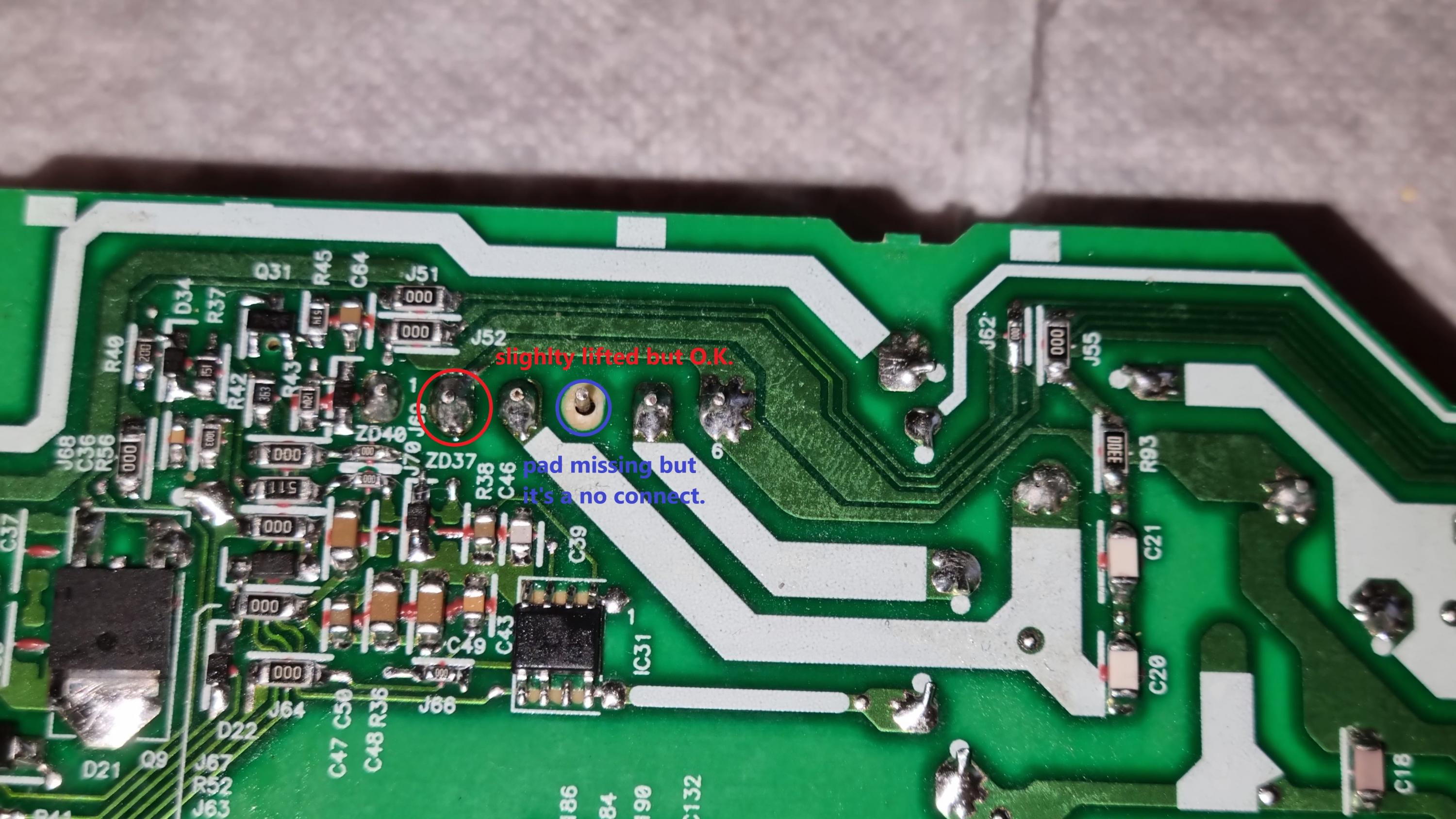

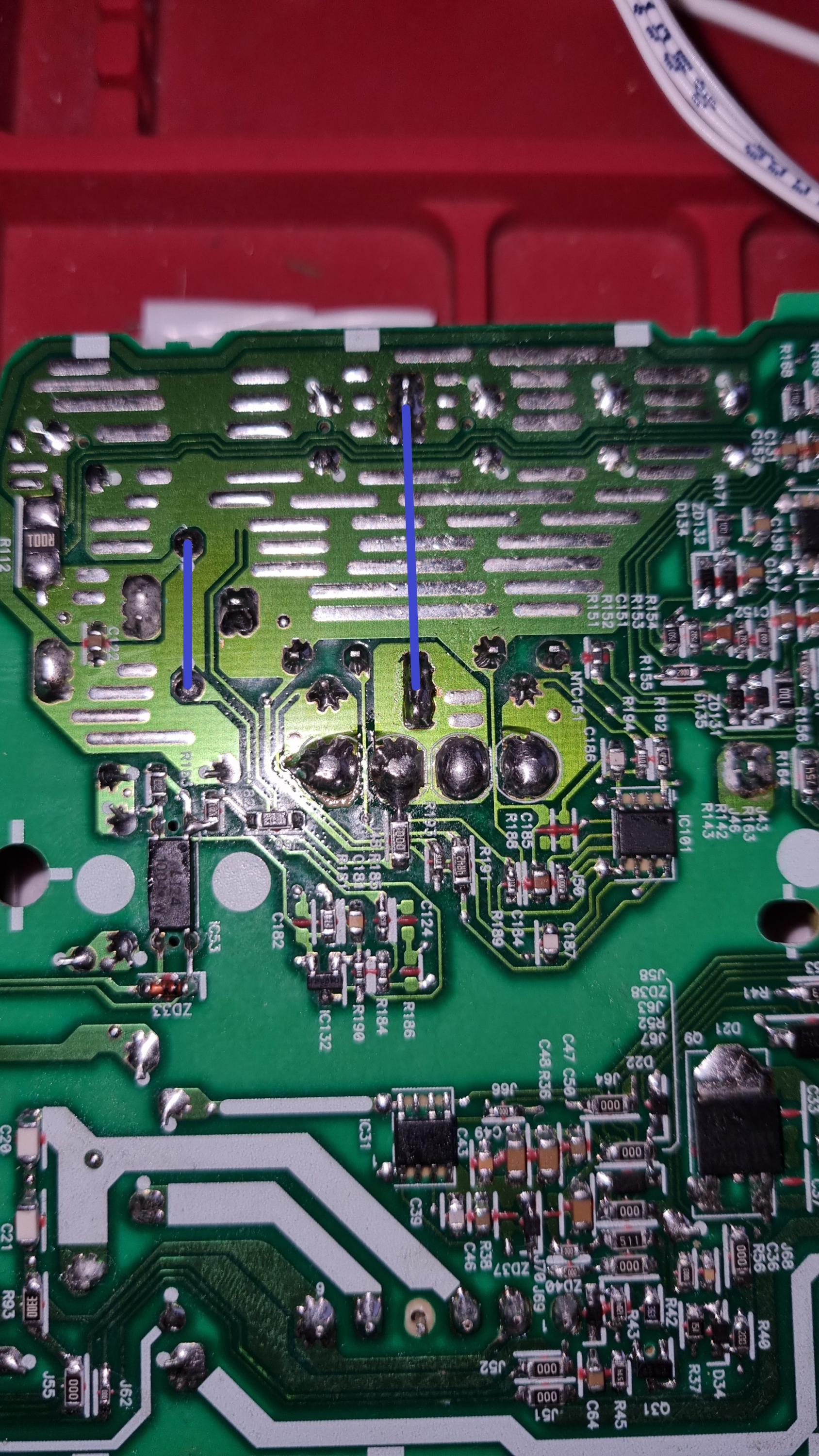

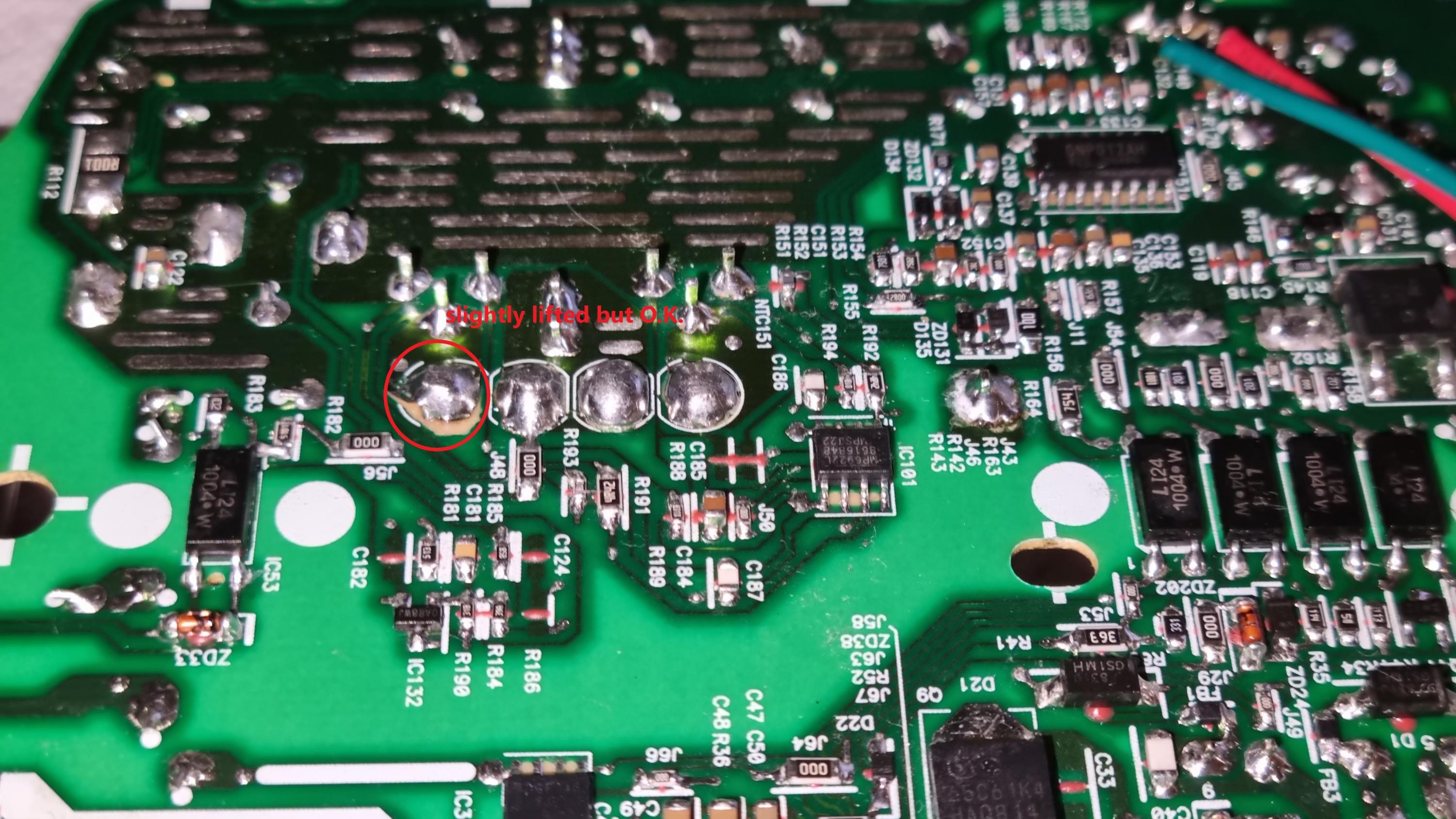

PS4 pro PSU (ADP-300FR) shuts down when turning on 12V
  • Norrecito
    replied
    Re: PS4 pro PSU (ADP-300FR) shuts down when turning on 12V
    Apologies, I've just realized that I have misunderstood your question.
    You meant the small tracks going from each pad of R112.
    The first one (farthest from the 12V connector) goes to R155 (280 ohm resistor) then through a zero ohm resistor, goes to the 3rd leg of IC151 (DNP012AH)
    The second track goes to D135 and ZD123 and the 12th leg of IC151.
    Both tracks are undamaged.
    Leave a comment:
  • Norrecito
    replied
    Re: PS4 pro PSU (ADP-300FR) shuts down when turning on 12V
    Originally posted by stj
    R112 underside, 1miliohm resistor to monitor current - where do those long tracks go and is the resistor and tracks o.k.?
    First of all, thanks for taking your time to help me
    Measured R112 and it's 0.2 ohm.
    The big tracks from R112 go to the middle 2 legs of T2 through a "jumper" on the other side of the board. (I drew it on the attached picture as well as another jumper that leads to a different section).
    The tracks are not damaged (verified with my multimeter).
    Leave a comment:
    replied
    Re: PS4 pro PSU (ADP-300FR) shuts down when turning on 12V
    R112 underside, 1miliohm resistor to monitor current - where do those long tracks go and is the resistor and tracks o.k.?
    Leave a comment:
  • Norrecito
    replied
    Re: PS4 pro PSU (ADP-300FR) shuts down when turning on 12V
    Originally posted by stj
    maybe it wont run without a load on every voltage
    Unfortunately this is not the case
    Every single tutorial I've found shows the 12V line working without putting any dummy load on it. All it requires is to connect the mentioned two pins on the small connector (which also supplies 5V).
    Leave a comment:
    replied
    Re: PS4 pro PSU (ADP-300FR) shuts down when turning on 12V
    maybe it wont run without a load on every voltage
    Leave a comment:
  • Norrecito
    replied
    Re: PS4 pro PSU (ADP-300FR) shuts down when turning on 12V
    Originally posted by stj
    did you test it on a dummy load and not in the ps4?
    I have tested the 12V line with a 12V ligthbulb but same result (didn't even lit for a second).
    Haven't tested the 5V line with any load just yet.
    Leave a comment:
    replied
    Re: PS4 pro PSU (ADP-300FR) shuts down when turning on 12V
    did you test it on a dummy load and not in the ps4?
    Leave a comment:
  • PS4 pro PSU (ADP-300FR) shuts down when turning on 12V
    Hello all,
    I would like to ask for your help to troubleshoot a faulty PS4 pro power supply (ADP-300FR).
    A couple of weeks ago, I've picked up a PS4 Pro (CUH-7216B) from one of the local flee markets. According to the seller, it has a "no power" issue and the PSU is most likely faulty. Based on the cracks on the housing, it was probably dropped.
    Tried it at home and sure enough, it had a "no power" issue. (Pressing either the power or eject buttons had no effect).
    I took out the PSU and opened it. Immediately noticed that both transformers (marked as "T1" and "T2") are damaged. Their legs on the low voltage side are broken. (Looks like fall damage to me) Some of the pads where the legs are soldered are slightly lifted. (One pad is missing but that's a "no connect") I saw no burned component or anything else that was out of place.
    Talked with several people who repair PS4 Pros and found one who was willing to sell these transformers to me. He took them out of a ADP-300CR PSU but both PSUs use these 2 transformers according to him and this seems to be right.
    Soldered in both new transformers and after reassembly, the PS4 pro finally showed the first sign of life. After pressing either the eject or power button, I can hear a beep and the blue light comes up for like 2 second and it goes off (without a second beep!). Pressing either buttons again results in nothing. I have to unplug it for a couple of seconds and plug it back in order to reproduce the previous behavior.
    Took out of the PSU again to make some measurements and came to the following:
    I have 5v standby and its stable. As soon as I try to turn on the the 12v line by connecting "5VSB" and "ACDC_STBY" (I have soldered two cables connected to a switch so I dont have to short them using a tweezer), the whole PSU turns off and remains off until I unplug it and plug it back. It's basically the same behavior that the PS4 produces so I came to a conclusion that its a PSU problem.
    Measurements on the small connector (when "5VSB" and "ACDC_STBY" are NOT connected)
    ACIN_DET: 4.8V
    ACDC_STBY: 0V
    GND: 0V
    5VSB: 4.83V
    When they are connected, both "5VSB" and "ACIN_DET" falls under 1V and keeps decreasing. (The PSU seems to shut down)
    Since then:
    -I have unsoldered and tested every single through-hole MOSFET (Q3, Q4, Q6, Q102, Q101) (and a diode: D11) and all of them tested okay (I'm using a cheap component tester from aliexpres).
    -Checked the through-hole resistors (R5, R103) and all of them are okay (AFAIK the big one acts as a fuse and all of them should have very low resistance. Both are 3 ohms in my case.)
    -Checked for shorts in obvious places (ICs, MOSFETs, capacitors, 12V, 5V connector) but found none.
    I could not find the schematics of this PSU (ADP-300FR) however someone made a schematics for ADP-240AR which has many things in common (including some of the ICs) so I have attached it.
    I've also found some YouTube videos where yet another PSU is explained (ADP-200ER) but I'm not sure if I'm allowed to link them here.
    Any help is much appreciated. I've already spent like 2 weeks trying to figure out the issue and it's driving me insane
  • JonnyS
    PS4 pro PSU ADP-300CR shuts down when turning on 12V
    by JonnyS
    I would like to ask for your help to troubleshoot a faulty PS4 pro power supply
    I have a st_by voltage ane when i try to power on 12v line PSU shuts off
    i measure lot of components but i don't fins faulty piece ,
    when i try to power on 12v line voltage increasing to ~420v so it looks like PFC was working,
    Now i have no idea what i can do more to fix it and i will be very helpfully to help me in this case.
    10-10-2022, 10:34 AM
  • прямо
    Viper22A 5VSB circuit
    by прямо
    So I have a cheap non working ATX PSU that I was learning to repair a decade ago. At the time, it blew the main fuse, bridger rectifier, NTC, and primary 9A 900V MOSFET. Replaced all except the MOSFET. 5VSB came back online. Then I poked around in it so much, measuring components one by one to a point I accidentally made the 5VSB circuit primary side went bang. Blown the AP8022 (Viper22A) PWM chip, along with a low resistance resistor and the PC817 opto isolator. I replaced them all.
    In the process of poking around, I also lost a zener diode that stabilize the voltage coming from...
    01-13-2024, 07:05 PM
  • kotel studios
    FSP300-60GTF - no 5VSB, PS_ON; 5VSB carnage
    by kotel studios
    Finally replaced all of the shorted 4148's and resistors and an blown tl431 on my FSP300-60GTF after 5VSB going crazy and destroying it self. Those components also made the secondary transistors appear shorted (while in reality they weren't).
    Powered it on through my dim bulb tester and they (bulbs) only flash once meaning primary caps are getting charged, but that's it. No 5VSB, PS_ON voltages.
    I am sure I have replaced the components correctly and that there weren't any shorted/blown traces left.
    Any ideas where to go next?
    02-23-2025, 11:47 AM
    KingWin ABT-650MM 650 Watt ATX PSU [PCB: SW8835REV:A]
    by momaka
    For today's thread, I have a KingWin ABT-650MM ATX PSU. Official web page with the PSU specs is still up and can be found here:
    http://www.rmac.kingwin.com/products.../abt_650MM.asp
    I just can't help it when I see a broken / for parts PSU on eBay that's listed for cheap and looks at least somewhat interesting. Well, OK, I won't lie – on the outside, this PSU looks anything but interesting. It's a plain gray box with colorful “spaghetti cables”.
    What mostly drew me into buying it is its 2x PCI-E power connectors...
    03-29-2022, 11:34 PM
  • huzo
    HP Omen shuts down when loading OS
    by huzo
    The model is 15ec-1061nm
    Board number is DAG3EDMB8D0​
    SO i turn the laptop on , and as soon as it starts booting from disk, from usb, windows,linux,HBCD,anything i boot it just turns off....while in bios menu or in linux boot menu it stays on normally...It's like when it starts to use graphics it shuts down...But i measured 0.72V while working on the GPU power line,no excess heat is comming from GPU or CPU, i even removed the heatsink and turned the laptop on and everything worked fine, got a bit hot, fan span to full speed, but it worked like that for few minutes in bios...
    10-29-2024, 12:05 AM
