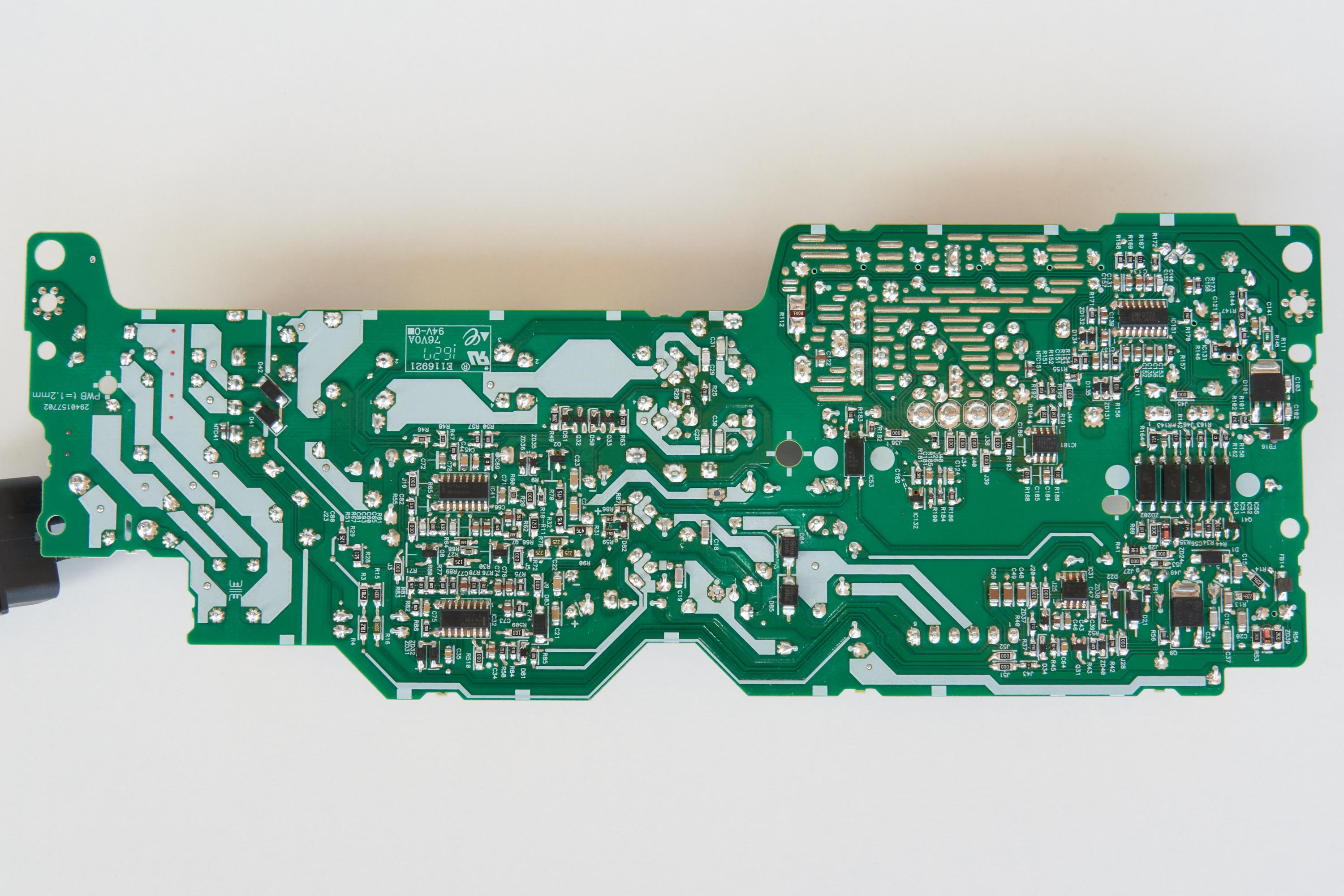

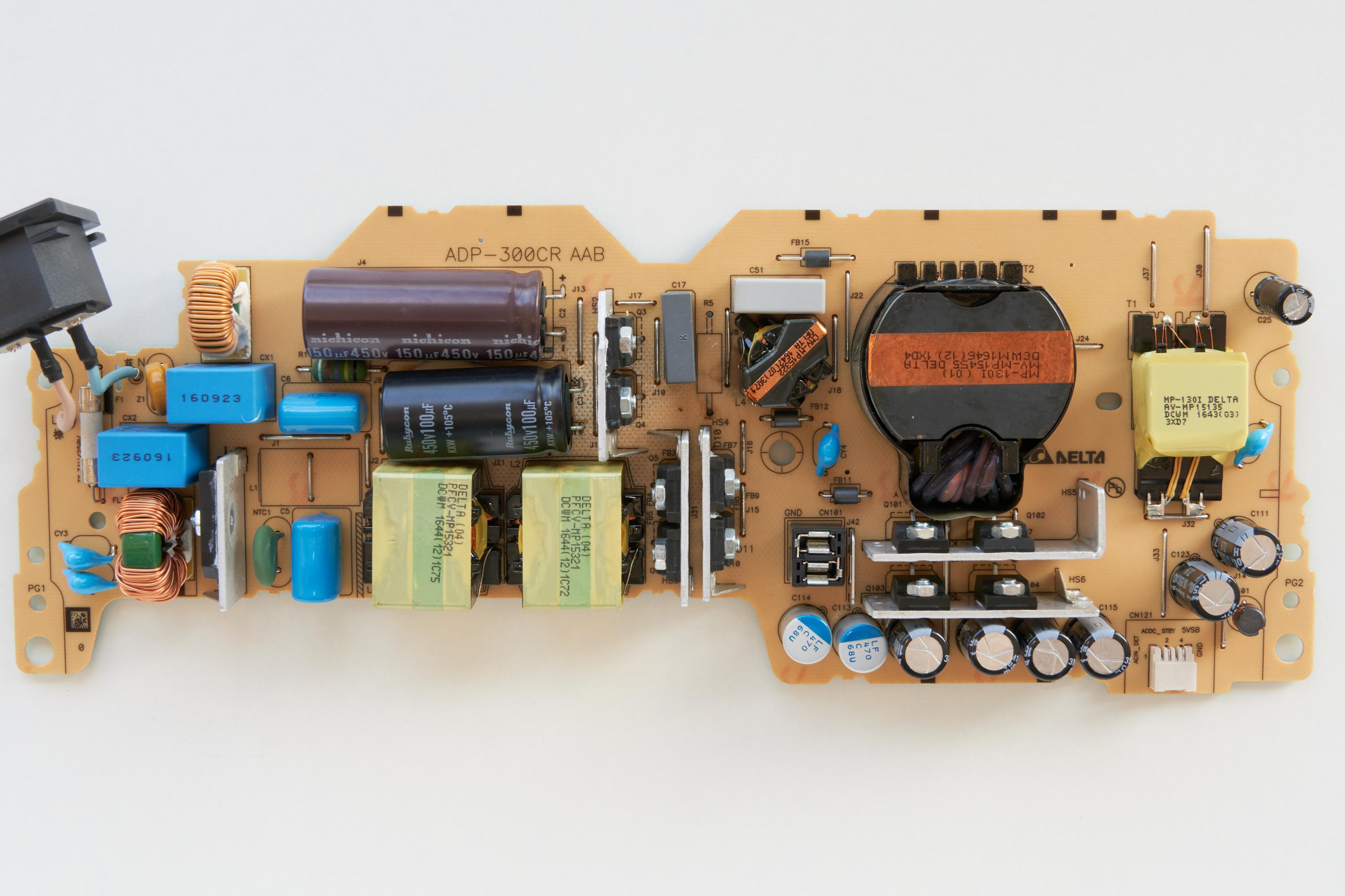

    I would like to ask for your help to troubleshoot a faulty PS4 pro power supply
    I have a st_by voltage ane when i try to power on 12v line PSU shuts off
    i measure lot of components but i don't fins faulty piece ,
    when i try to power on 12v line voltage increasing to ~420v so it looks like PFC was working,
    Now i have no idea what i can do more to fix it and i will be very helpfully to help me in this case.

    Re: PS4 pro PSU ADP-300CR shuts down when turning on 12V
    Need some pictures of the circuit boards in this device
        am sending the board photos
